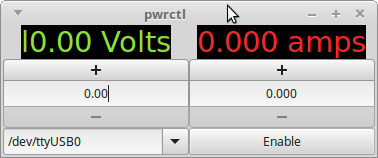

I'm writing a nice little perl gui, but if I can't come up with a software fix for the "don't know which unit" problem, it may go much further, as it really matters here, and no, I can't afford another few minutes of setup on every run especially if it requires physical presence to do it.

I'm coming up with a cute little GUI for this, but as mentioned, it might have to be in an ESP8266 web page and need one of those per supply to be safe for remote control.

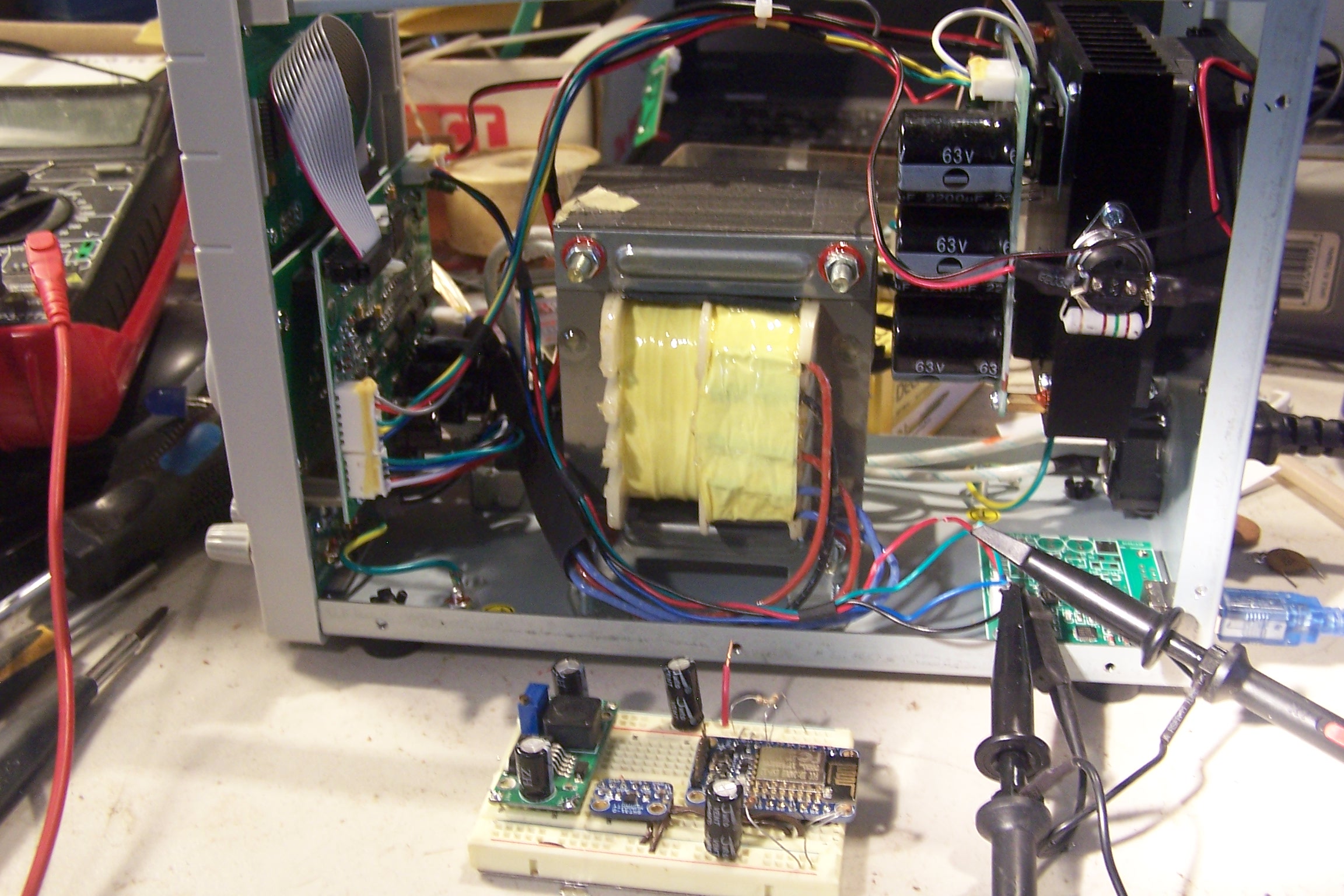

Here's a shot of the insides of this power supply, which I'm reverse engineering. The offending USB interface board has the scope probes on it. In front is a little prototype I'd done earlier with an ESP-12 module for another use, but that's roughly what I'm going to put in here once it works as a prototype. For the real deal I plan to use an ESP-07 module, which has an external antenna jack. That way I can put it inside the steel case and have the wifi antenna external for use.
But that module is kind of a pain to work with - it doesn't even have the amenities that the Adafruit Huzzah has - there aren't even any buttons to press to get it into programming mode, I'd have to lash some up.
So instead of doing that, I'm going to proto on the "easy" one, get over the air updates going on, burn the real target one ONCE the hard way...and proceed from there.
As you can see, it's not a crappy power supply, all the right stuff is there, it looks like a nice thermal design, there are relays to switch transformer taps as the volts are adjusted to keep waste heat down and it uses a microchip PIC 16f887 I've got the datasheet for. That last is a good thing as I was able to get the reset circuit so I can have the ESP reset the main processor and get rid of that "once you've set it up with a computer, you can't use the front panel again without a full power cycle" crap. I'll just have a command to the ESP to pull reset on the thing.
The guts of the tekpower

OK, here's some code that is close to, if not finished.
The perl contains the gtk3 definitions internally, but of course you have to put in GTK3.pm (I have a script somewhere if anyone asks, it's a pain otherwise due to dependencies).
The .ino assumes a network name of the last 3 bytes of the mac plus _TP2 so the perl can know which is which more easily.
This checks what the power supply is already set to, in case you should connect to one that's already doing stuff...but on reflection, doesn't yet check it's enabled state (easy to add).
On exit we reset the power supply which returns front panel control the the user if they are present.
