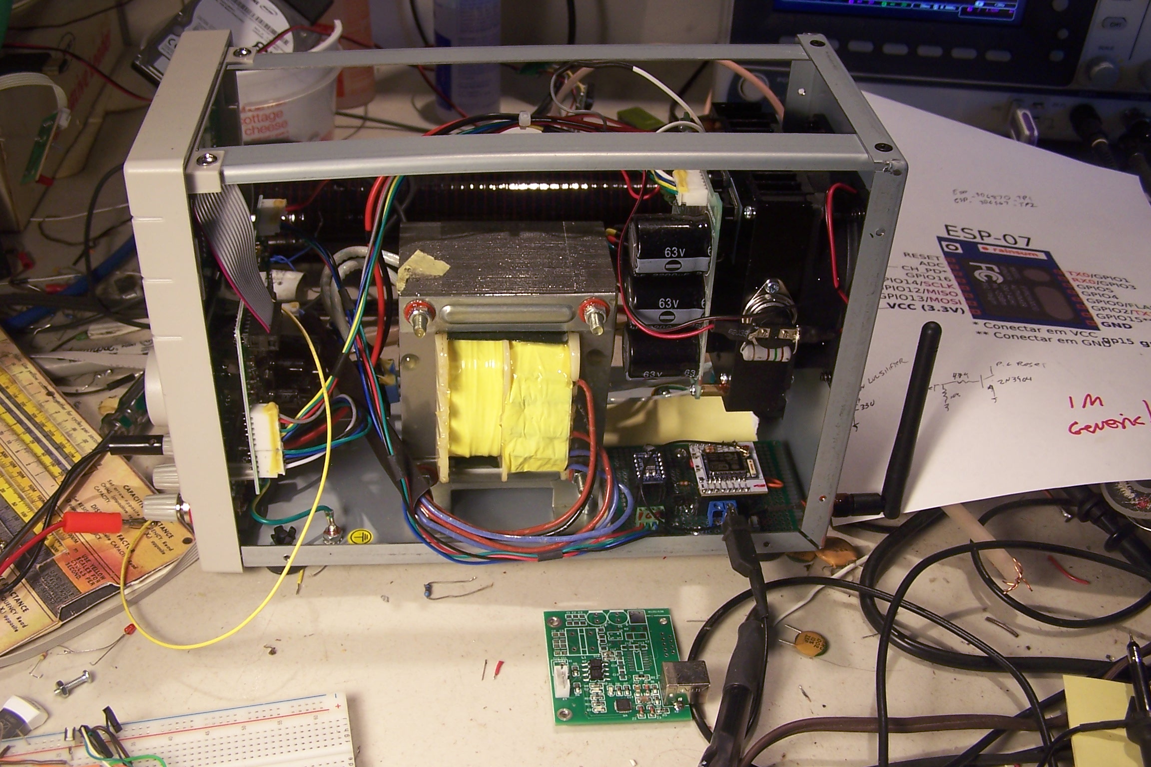

And I wouldn't expect Tekpower to give us detailed documentation on the PIC code - they have to assume they're selling a finished product and you're never going to crack the case as I am. And here's what it looks like with the case cracked, for reference. The lousy USB interface board I'm replacing is in the foreground here, the board I built is in the supply, lower right.

I must have been holding that wrong, I never noticed that pincusion effect from this camera before! The supply isn't bent up.

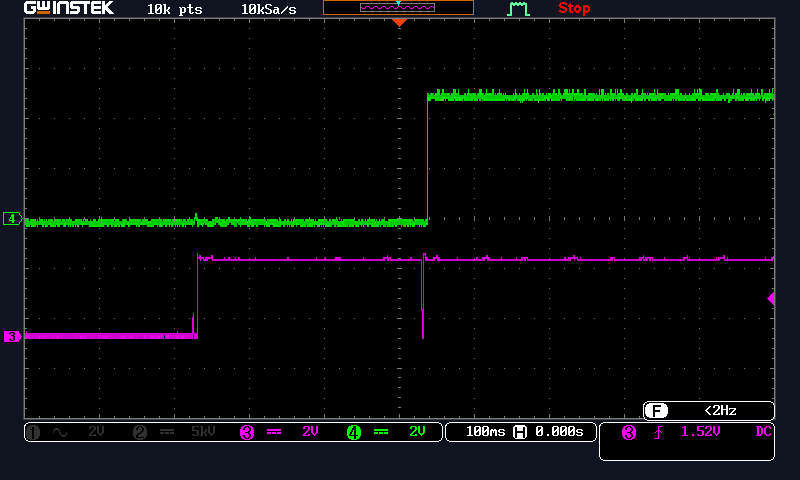

What they don't tell you is that the RXD INPUT isn't always an input during initialization! It needs to be allowed to "move" under the influence of weak pullups and adjustments to the tri-statedness of that pin for some milliseconds after power up. And if that isn't satisfied, you are utterly hosed - even chip reset or the powerdown pin have no effect, it's dead till the next power cycle where that RXD pin IS allowed to toggle some during initialization. This knowledge cost me a day of my life and considerable skull sweat and stress due to another co-incidence, which was that the PIC data output was also toggling during init - and sometimes did just the right thing to let the ESP work! So it was far from obvious what the issue was and a lot of things were tried till finally I just pulled the level shifter out of the socket and after that it always worked.
Here's the relevant scope traces during powerup. Note the toggling on what is supposed to be a pure input on the ESP. If this can't happen (almost as if it were being used to clock a flipflop or a counter) - we're dead till the next power cycle - nothing whatever short of that will pull us out of a locked up state.
Scope - green is the PIC output, Purple is the ESP input, level shifter removed.
Note the near-coincidence of some garbage on the PIC output signal...this timing is somewhat variable depending on just how fast the power supply ramped, and fairly often, coincided well enough for the thing to boot, making this one hell of a tough troubleshooting session. Hopefully I can save some readers that level of hair pulling/whitening.

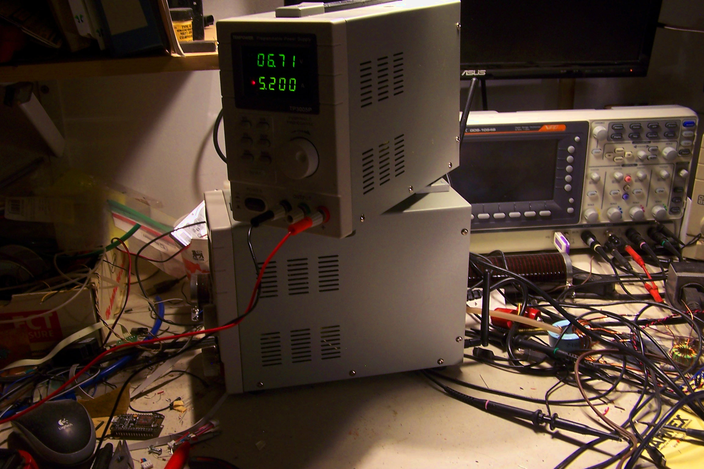

Second one was easy...
I have a nice little gui for this, and you can either run both from one instance, or just spin up an instance per supply, no sweat, they don't eat a lot of screen space. They just let you set settings, turn things on and off, and monitor actual voltage and current output.
