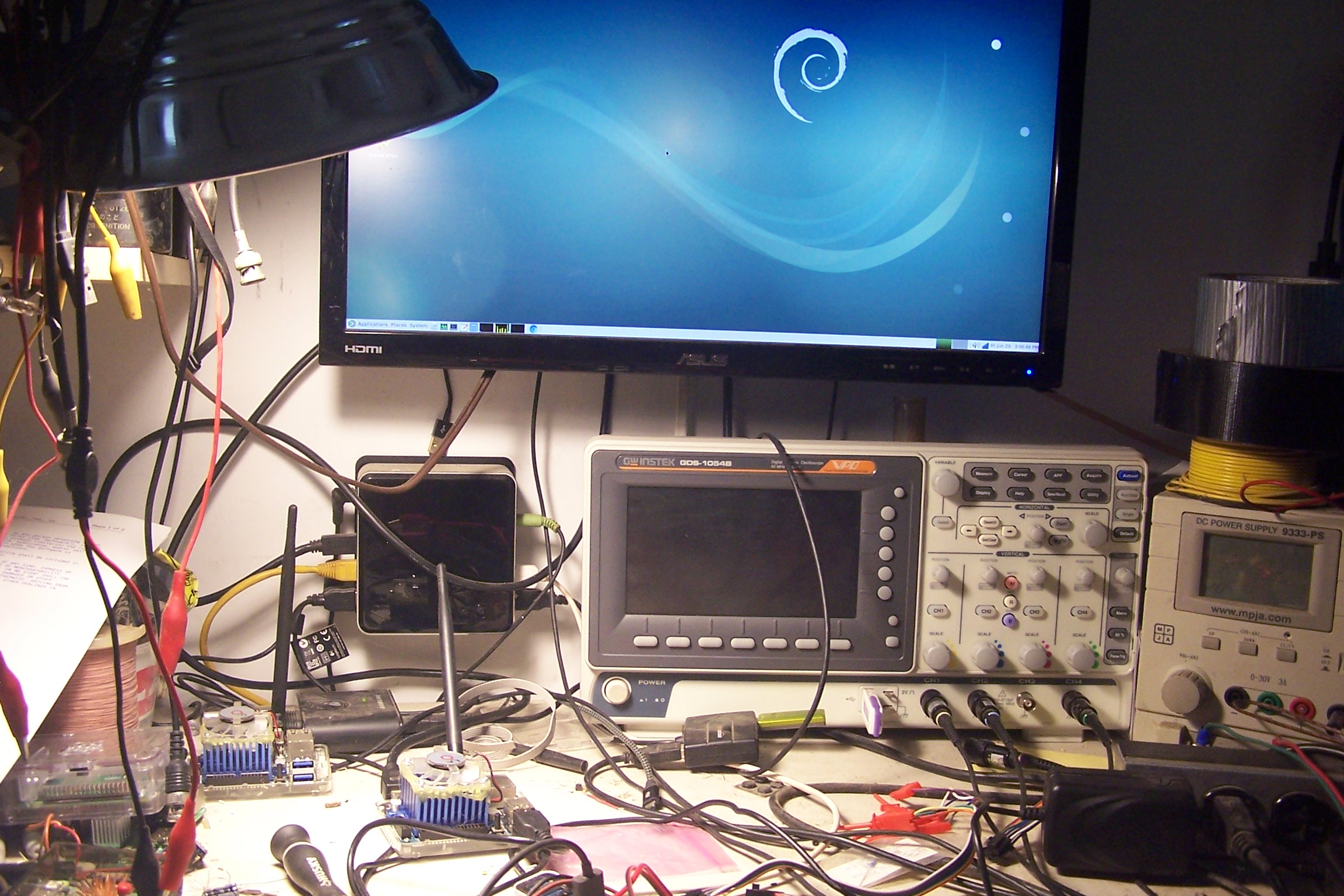

A messy desk...dunno about my mind
I used the big passive heatsink for the XU4, but had the fans from the other version, and put those on top - it's somewhat overkill, but let me tell you, there is NO throttling ever. The fans are whiney - but this alerted me to various config problems that were eating resources and making the fan run when there shouldn't have been a need.

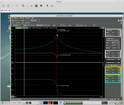

Screenshot of this in action - from my NUC couch computer, over VNC.
Running Waveforms on a series tuned circuit that looks like the fusor with a series L and no ions.

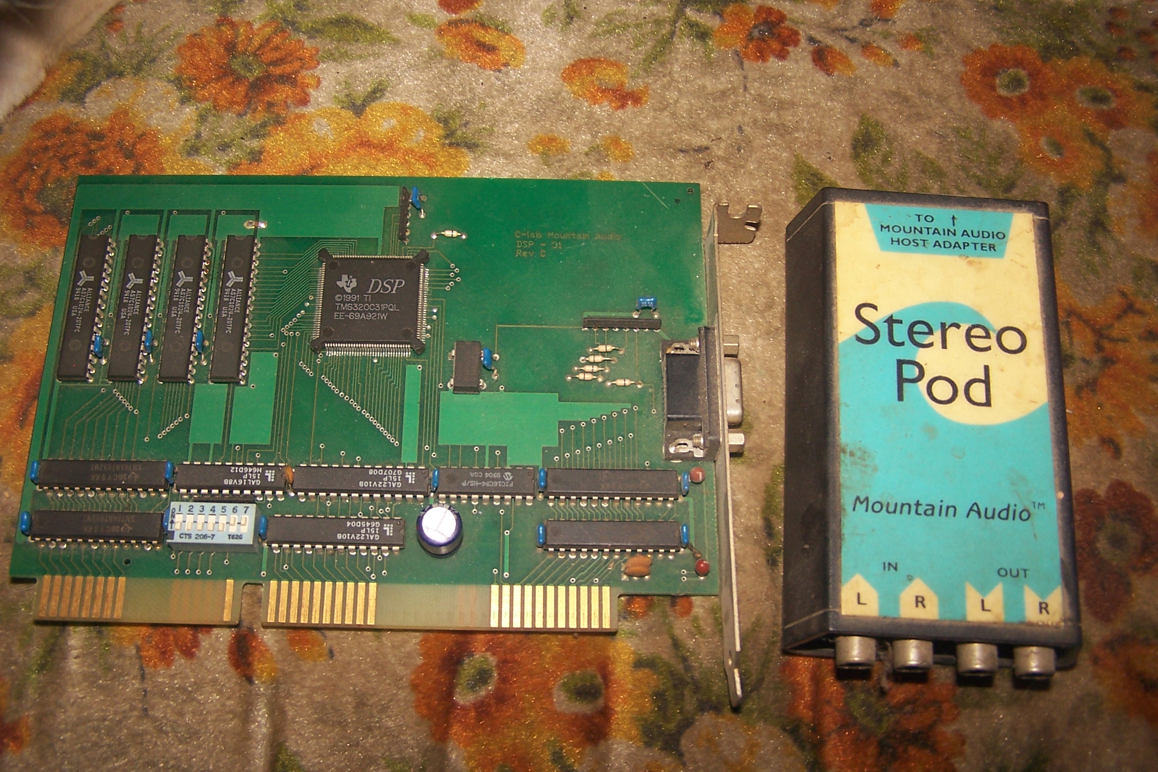

World's first really good full duplex soundcard - my design. (and how I retired a couple decades earlier than most)
