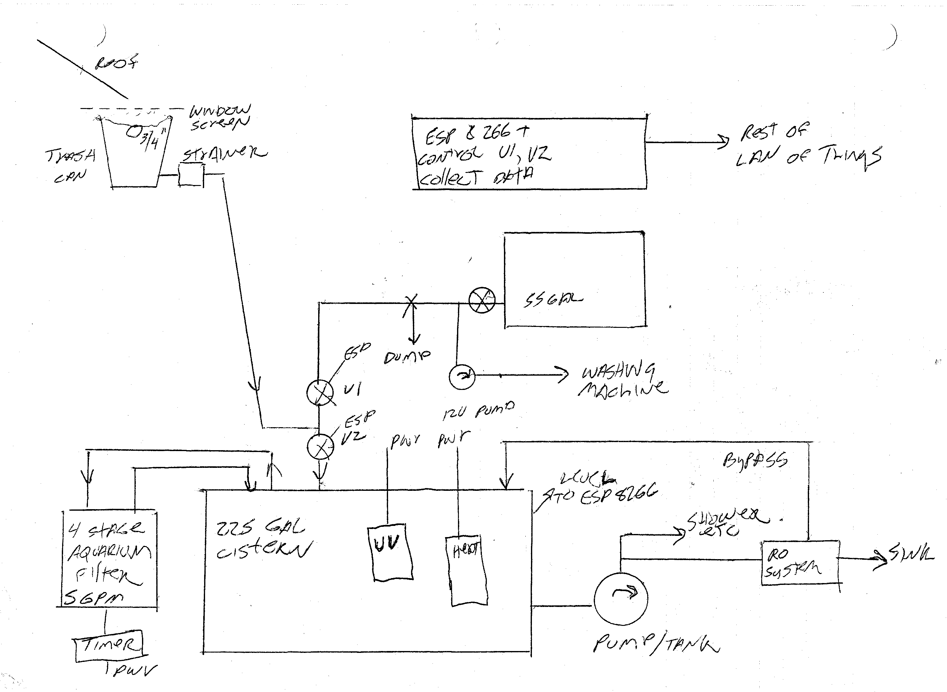

Here's a block diagram overview. Sorry for my sloppy drawing/writing skilz..I hope it's kinda obvious from the rest.

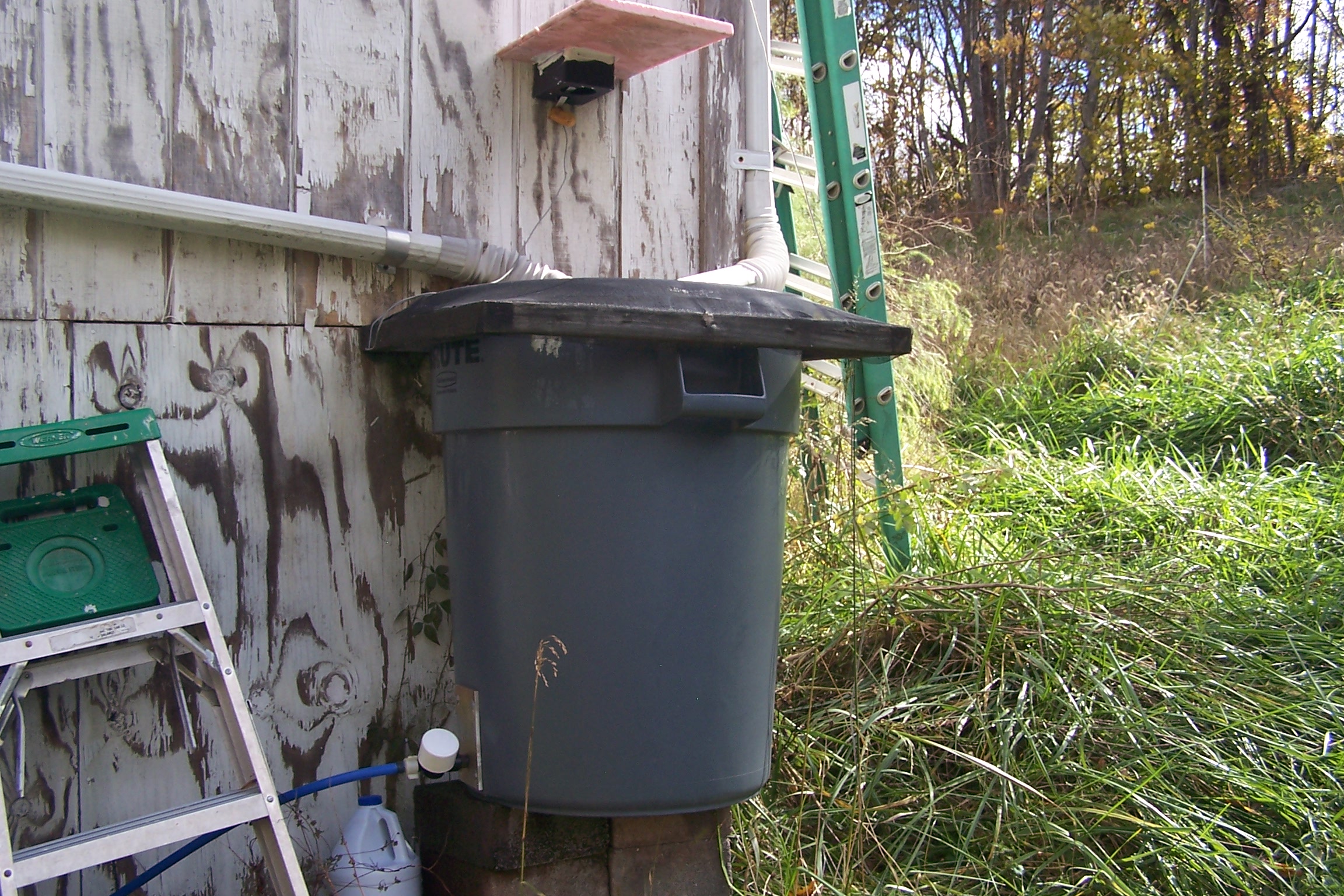

Collecting rain is theoretically trivial, but actually quite a trick if you want to use the water. Rain isn't pure already, and the collection surface - here a roof and solar panels, gets dirty with anything airborne - pollen is one of the worst, but tree seeds, leaves, bugs living and dead, little rocks from the shingles...you name it, also comes down, and sometimes it's so nasty that you'd not even want to clog a filter with it. And if you keep that crap, even post filtered a little, in a rain barrel, "stuff" is going to grow in there and render it really nasty. So, you first have to choose how big to make the barrel, so you don't have water sitting around in it for too long no matter what (or handle this some other way, but clogging filters isn't practical long term, nor is keeping it out of the sun so well algae won't grow).
I'm just one of me, and pretty frugal, so my initial barrel can be pretty small. There's another consideration in the pre-processing, in that having some overflow in every collection cycle is a good thing - my top filter uses overflow to self-wash, and any floating junk also comes out of the small overflow hole in the side of the barrel (about 3/4"). When things are scaled right, as here (tuned after some years experience), the system can be really low-effort maintenance.

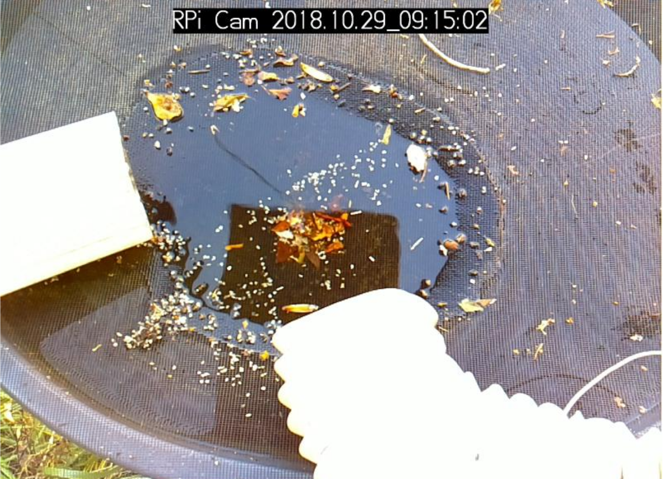

The barrel is set up so there's a window screen on the top that keeps big junk out, the pickup is off the bottom so stuff that sinks will not be brought further into the system (you clean it out about once a year, easy to just tip the thing over), and so we start with fairly good stuff. The ratio of collection area x average rain amount to barrel size that gives you this overflow on any decent rain both solves and creates some problems...The coarse filtering becomes almost no maintenance, but there are times when you'd like to get more water during a big rain than one barrel full, so you need a way to see how good the water you have is, and can't always just wait a day for things to settle (if they will, pollen doesn't - it ferments...).
So, what is actually the last step I did was to make it so I didn't have to go look at this - it's in a building a little uphill from the one I live in so I can use gravity feed, but when you really want to check it, it's raining or cold and not fun to go out and look. So....raspberry pi to the rescue:
At the moment, the barrel is full, and so is my cistern which IS in a crawl space away from the sun. Showers and clothes washing day! But the intake system first, I'll get to all the other details. Not shown in this picture is a little medium mesh filter on the takeout line that's easy to clean. Needs cleaned every few months, shaded from the sun, and kinda protected or removed in deep-freezing conditions, though I've had them live over a year without dealing with that one.

You can see the screen over the top which has caught some stuff. What you can't see without a movie (coming later after I do some editing) is all the junk that the high flow just washed off the top - this is pretty self-cleaning, a real boon. If you look carefully, you can see junk on the bottom of the barrel too - mostly little rocks from the shingles. OK, this is fine at some times of day, but what about others, or nighttime? I built a little submersible light with some high brightness LED chips out of a home LED light bulb that had a failed power supply and a piece of glass tubing, a few resistors, and some hot glue. The pi can blink this light source, which sits at at the bottom of the barrel, in the field of view, and shows me the turbidity of the water. Not that easy to automate, but a human can judge instantly. Commercial turbidity sensors, at least those you can afford, start at "way too nasty" and go up from there...this shows you how many feet you can see through the water, not how many millimeters, and doesn't need flow to self-clean, or at least not so far.

So, after 3 way pre-filtering at the first stage (at least 3..) we get into a buried pipe (1/2" qest/pex stuff used throughout) down to the home office crawl space.
The prefilter is that screen over the top, the ability to let things settle to the bottom, and the strainer inline with pipe cap over its head to keep the sun off - algae is the enemy here, we're not doing aquaculture (at least, not on purpose). Luckily, it appears to be the main enemy and that only for a week or two twice a year when things are making a lot of that. But you never know, so there's more to make this safe, and at this point, it's about as good as it can get by the time it gets to my kitchen.
Showers and toilets not as much, but it looks good and doesn't smell funny or stain anything - pH measures right at 7 almost all the time, rain is pretty pure with added pollen and dust, otherwise it's distilled water more or less. At least where I chose to live. YMMV.
I should also add that I have a backup on the backup, like everything else you do off-grid. I made a nice "Water getter" setup that uses a 55 gal plastic drum that fits in my truck bed, an inverter, and a really neat floating pump I can drop on any creek or lake (plenty of those around here) and get a fillup. The floating pump avoids eating sand and crud on the creek bottom, and the fact that it is slightly underwater avoids floating crud, while the noise scares the fish away (and yes, that'd been an issue).
Now for the balancing act. All this off-grid stuff is famine or flood. I'd have used a larger cistern ( a farm tractor sprayer tank was usedm HDPE) if a larger one would fit where I wanted it, but life is what it is. Like with solar power - or for that matter, my toy budget which competes with food, heat, medical expenses - you roll with it somewhat, and adapt. Use less when there's less, and pig out when there's too much. One gets used to it after awhile, it feels like being in tune with reality.
So, when it's very dry, I don't wash clothes or myself quite as often, but when there's too much, the challenge can be finding something to do with it all, and collecting as much as possible before it all goes to overflow and the storage tanks still not full. Some of what lands in that rain barrel (actually a big industrial grade trash can, plastic) isn't good enough for any use I have, so it wants to be dumped on the ground. Some is medium not so great, but fine for the washing machine. If it's good, the crawl space cistern being full is priority 1. Whew! First thing any control system - even manual - needs to know is the state of everything - input quality and amount as well as storage capacity in the two places I have for that. And it'd be nice to know if it's going to keep raining or rain again soon as well.

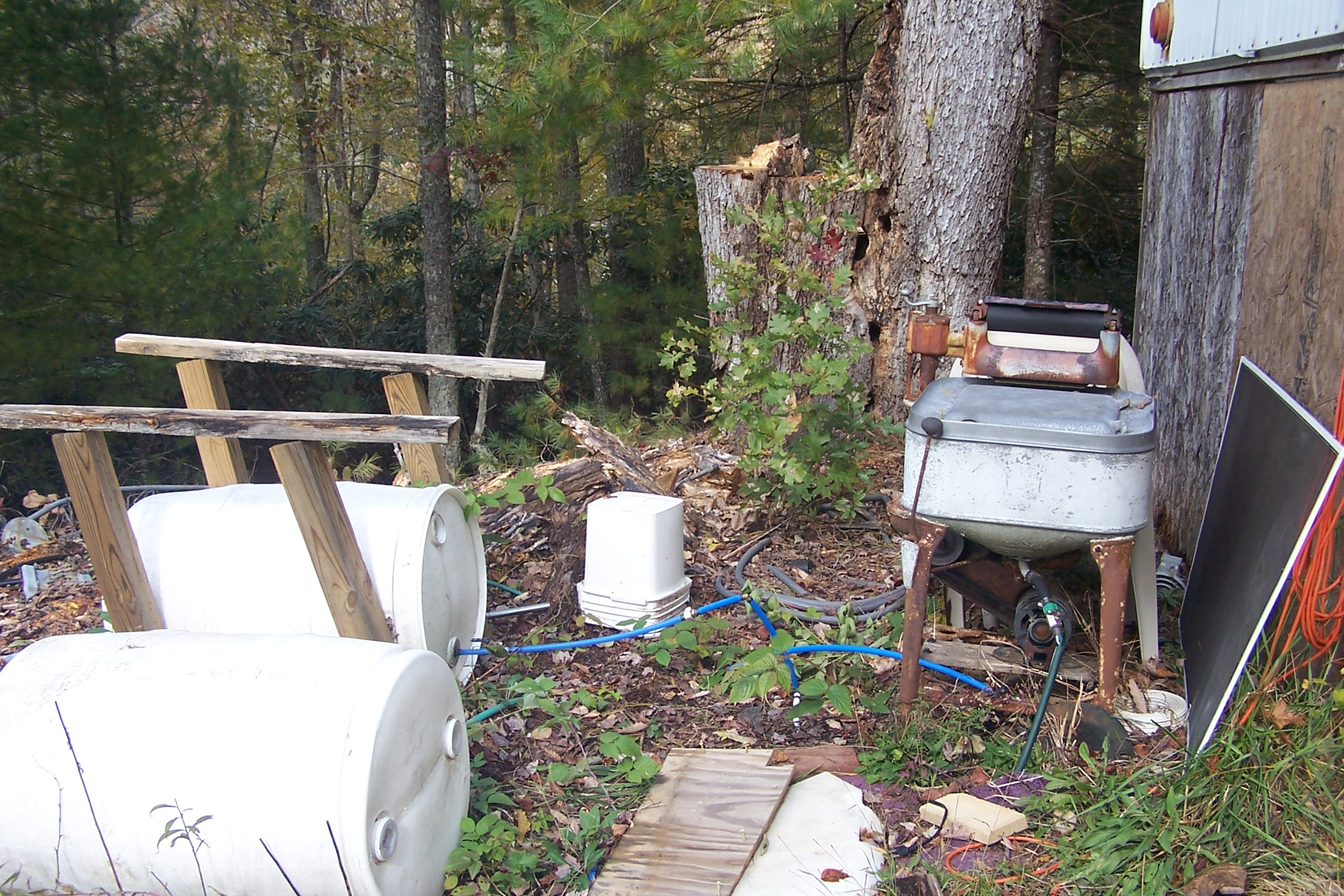

A little out of order, but since the water flow can be split, so can this. I put an extra 55 gal drum down by my ancient Maytag. This gets water when I have extra or if it's not good enough for the main house. The Washer does a really good job, still. I added an electric motor to it around a decade ago, and welded up and reground a worn cam and it's been good. I think this one is from the 1930's era. The barrel here has an open bung for overflow, I can see this out a window so no level sensor yet. If the water in the rain barrel is so nasty I don't even want to wash clothes in it, I can dump it by undoing a fitting here, or up at the rain barrel by unscrewing the post-strainer, which at that point would probably like to be rinsed clean anyway. The machine can get 2 or 3 loads out of 55 gal of water. More if you push things a little. Much more if you push hard. You can use the same wash/rinse water for more than will fit in there in one go if you really have to. I like the manual control here, it's more flexible than most new machines

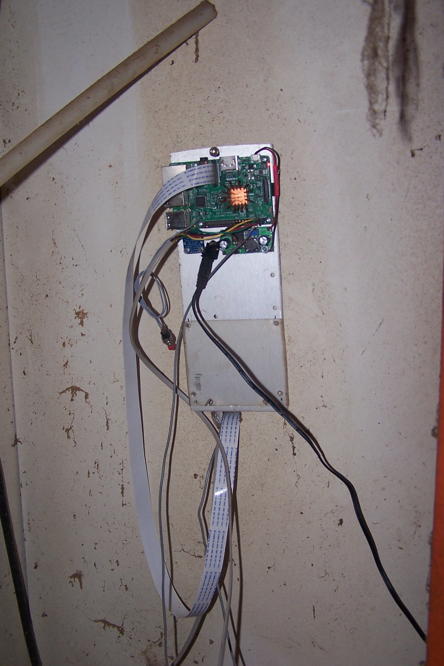

The rain-barrel pi. This is fairly simple. It's running the latest Raspian at time of writing, and [urlhttps://elinux.org/RPi-Cam-Web-Interface]RPi_Cam_Web_Interface[/url] for the camera. I diddled the php a little (and I see it needs a little more) just to personalize it and get the name of the host in there and so forth. I wrote a perl script to add the ability to blink the light at the bottom of the rain barrel, which is interesting on its own.
It also runs a little script I wrote to read two BME 280 sensors - one indoor, and one in the camera box, for weather data collection - so I can know if for example, I need to run over there and put wood in the woodstove, assuming I'm heating, or open a ceiling vent, whatever, should I care or plan to be working in the shop and want it nice over there.

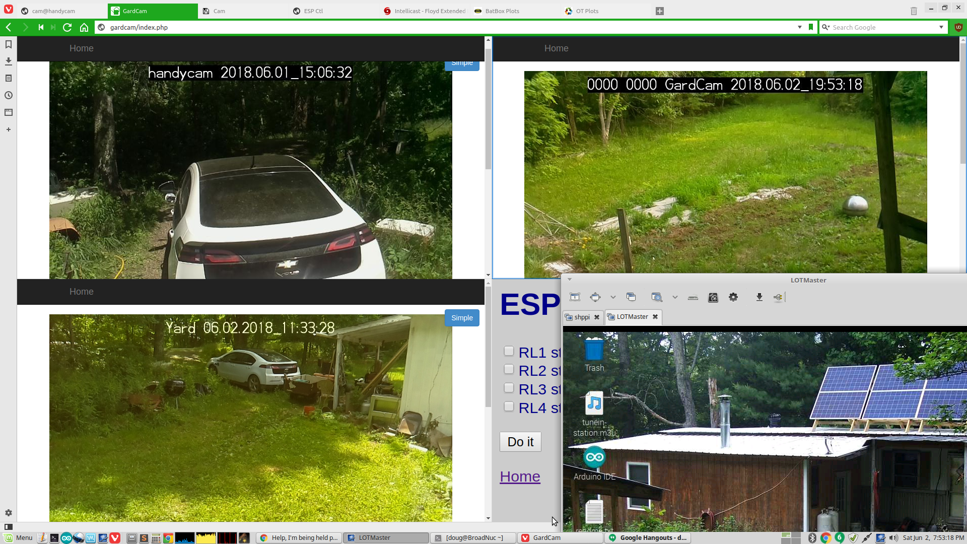

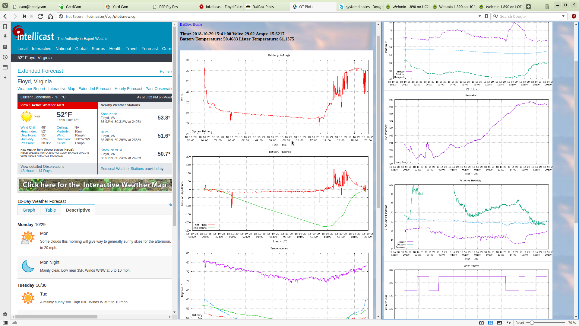

So here's a screenshot of some of my LAN of things in Vivaldi, which I run just to look at all this and the cameras I have around, keeping Chrome for normal (for me, anyway) browsing. I like being able to tile stuff in Vivaldi - it's the main feature that makes the bugs worth it. FWIW, even though it's based on the same rendering engine as Chrome, it has a bug that shows when a pi camera is stopped - it doesn't always stop trying to refresh at the frame rate and really hogs things...admittedly, it's a corner case and the pi software is very strange to allow for this to happen anyway - it's showing video by a fast refresh of jpeg stills....
