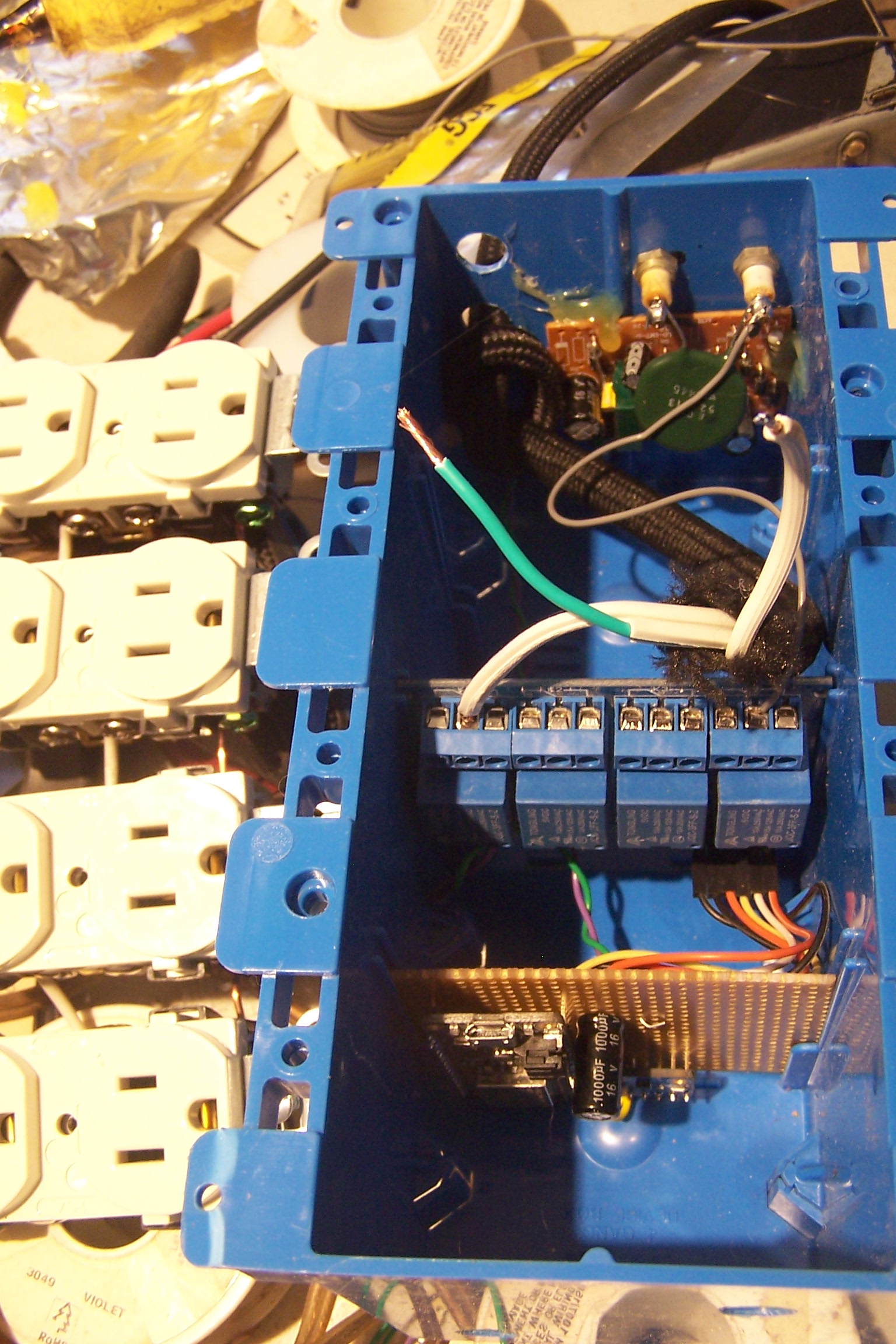

I found a fairly nice "work box" the right size at Lowes. The main electronics fit easily in this, and lo and behold, there's even PCB retention/guide slots in this thing! However, when casting around for an AC adapter to run it all, well, even the small ones are on the large size. I pulled about the crummiest small one out of my junk box, and when I cut it open to just use the guts, I got a surprise on how they did this. It appears to be some kind of Royer oscillator running right off the line! The output (there is no feedback) is just half wave rectified off the secondary of the transformer (ferrite core) so to get any regulation at all - it's rated for either 120 or 240v - it must be doing something slightly tricky using core saturation for more than one thing.

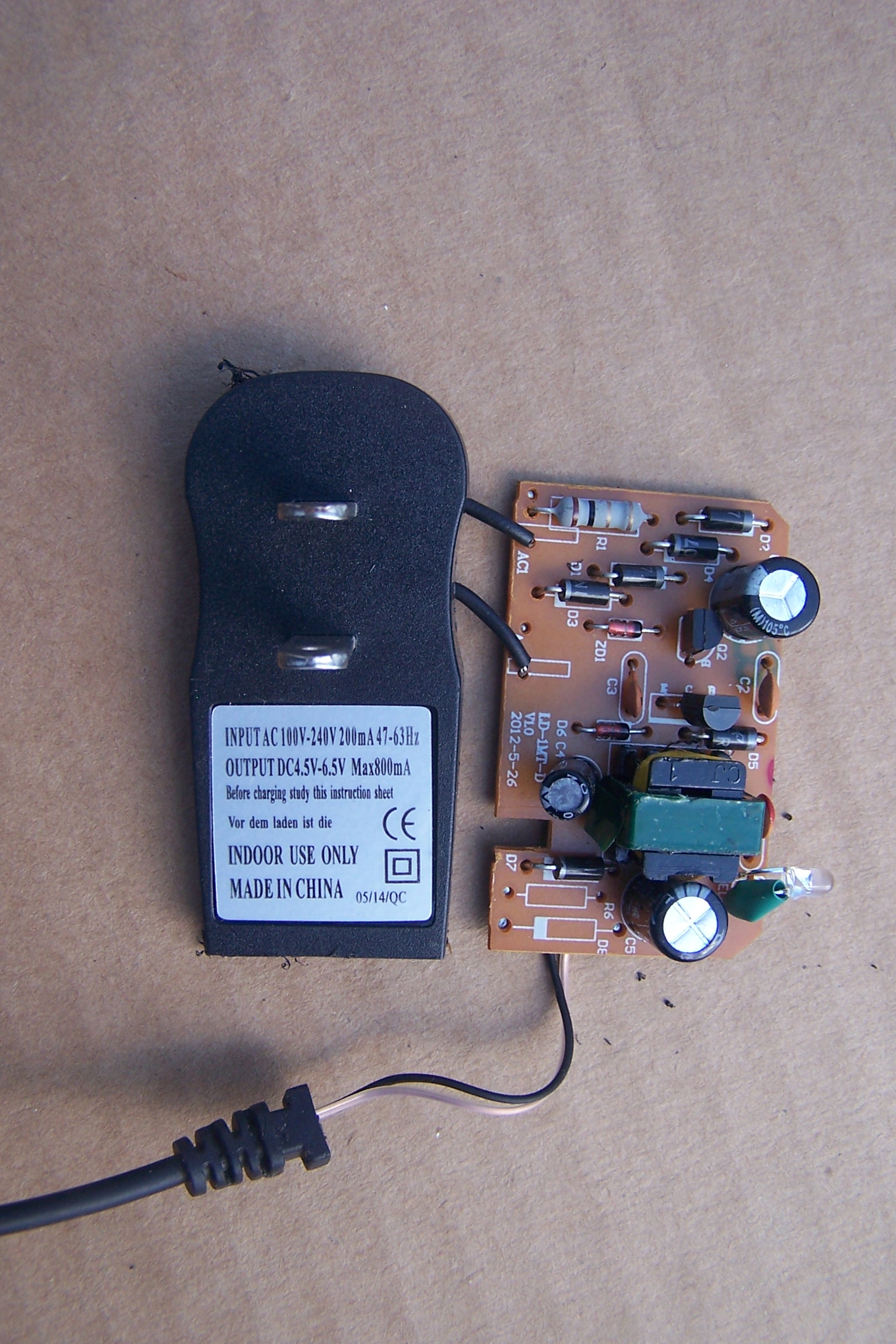

There are just no parts there. The one diode marked zener is on the primary side of things. Here's a picture for your info. Whatever, the thing works for this just fine.

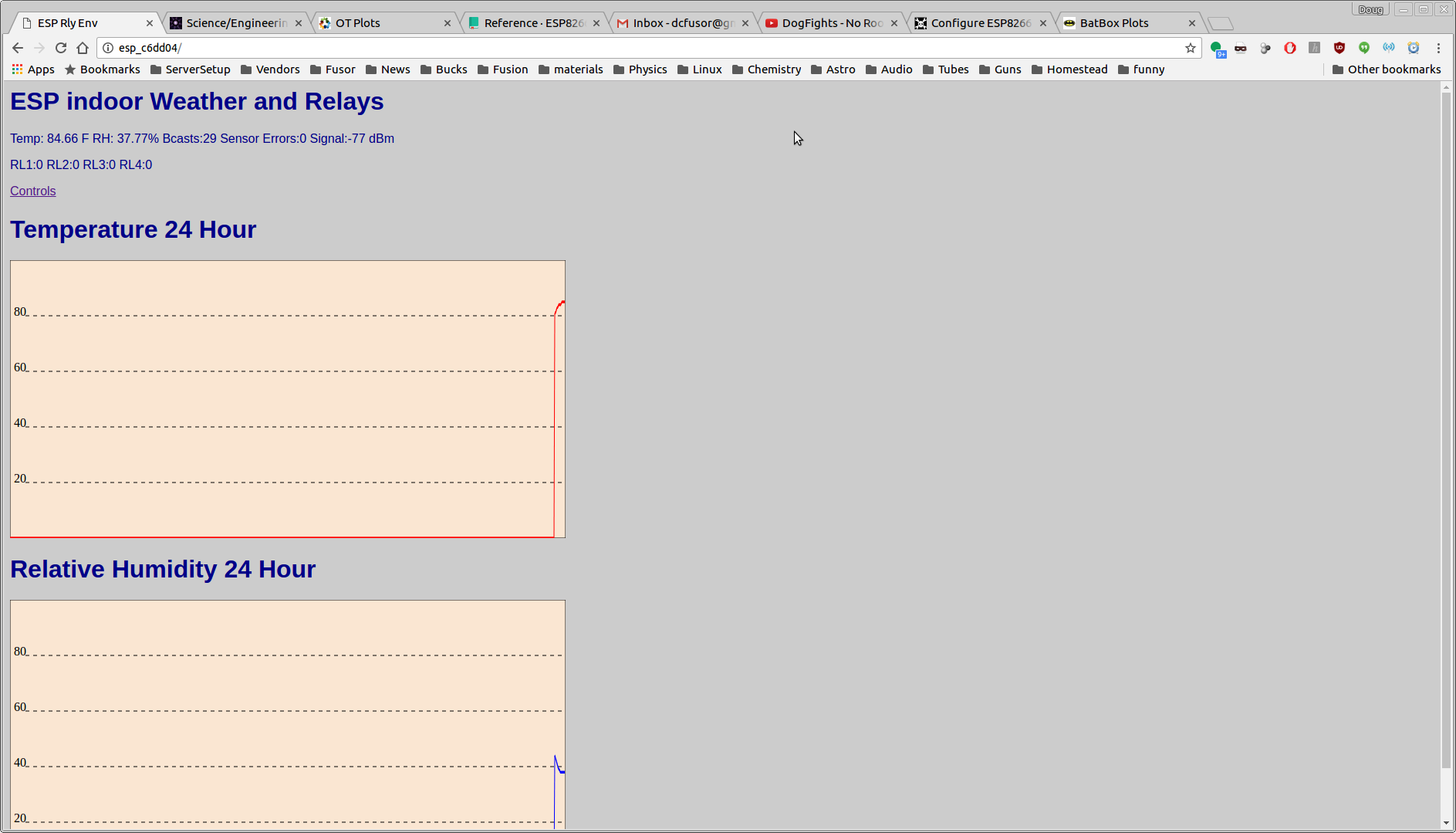

As far as the UI is concerned, it looks like this:
root web page
root web page

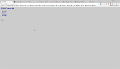

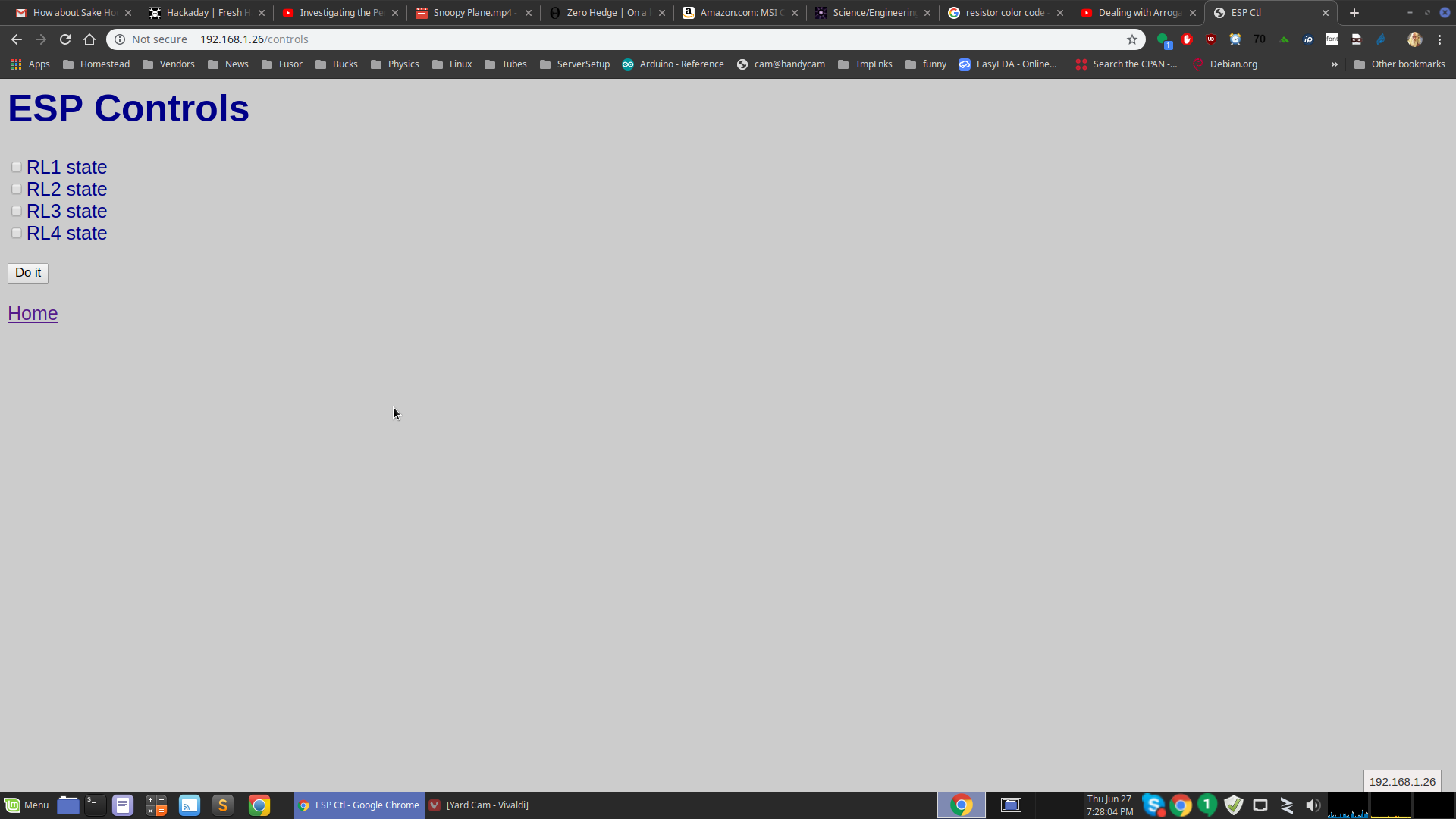

And the relay control/status page looks like this:
Relay control page CGI
The relay status is shown both on the main page and on this page when you navigate here - the CGI checks the boxes for the active relays.

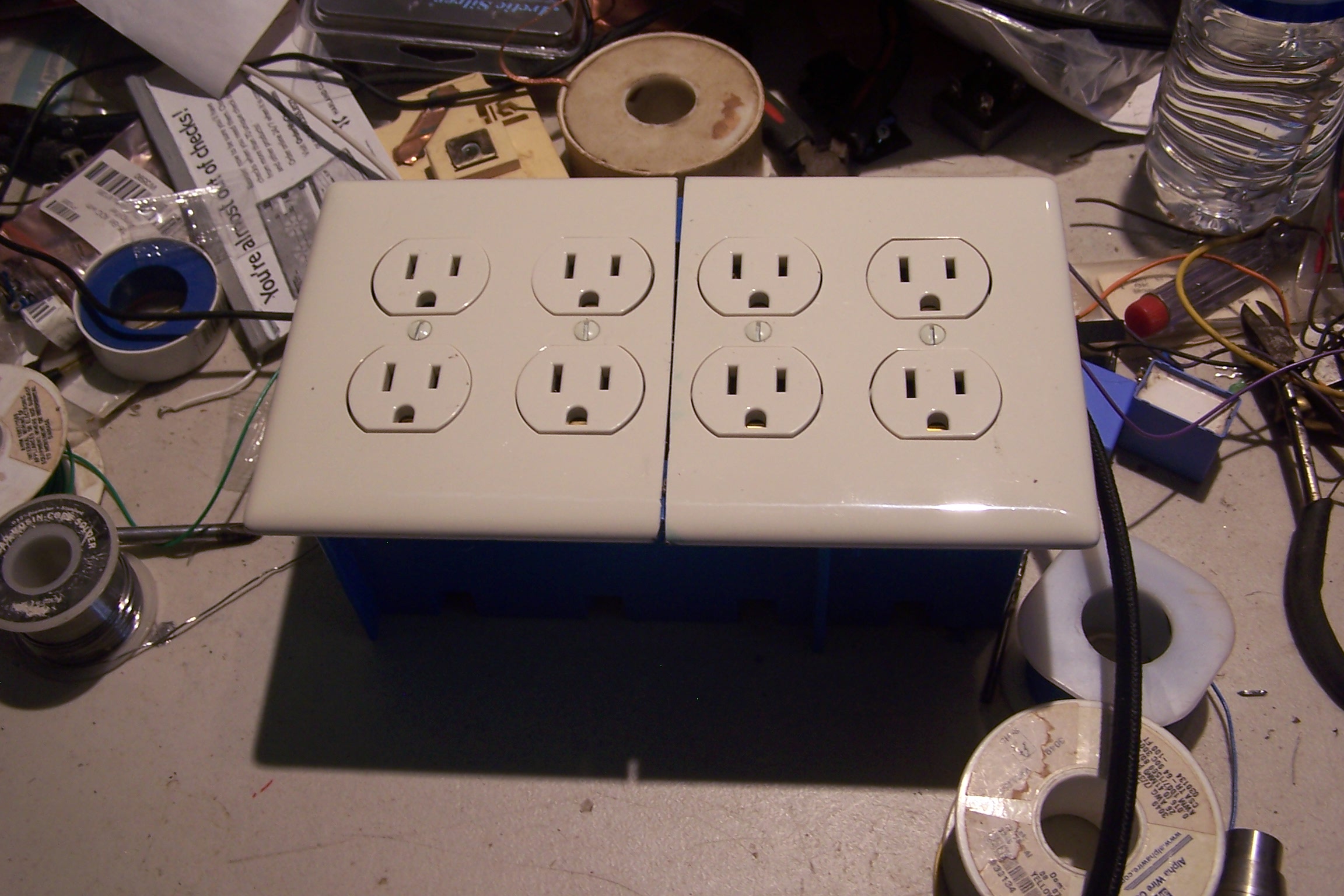

The box is from Lowes, as are the outlets and the wall plates I had to cut to fit this. The line cord was taken from some old piece of computer junk and I cut the IEC connector end off.

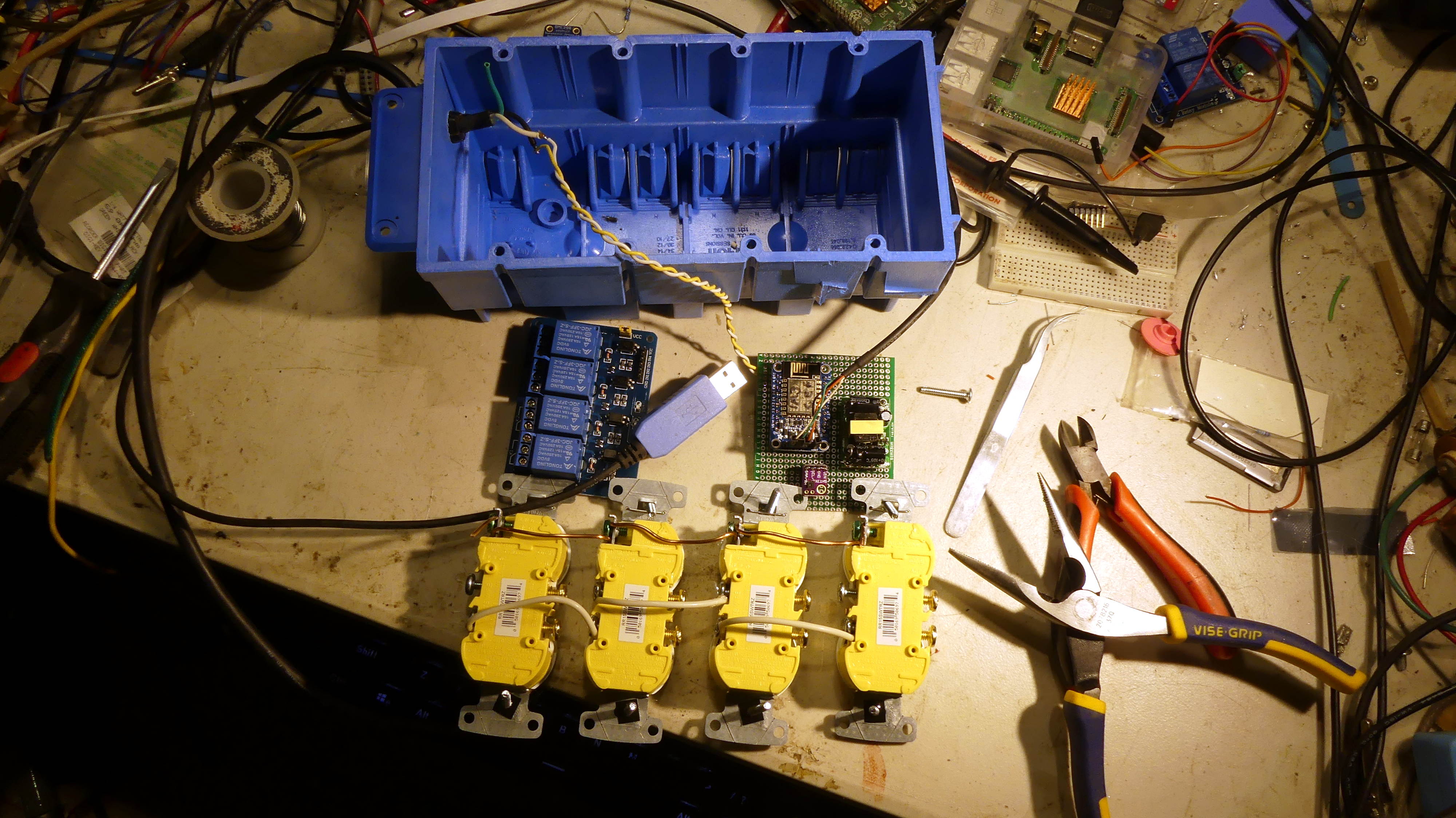

So, some pix of the new build, and the new code. Put it through a diff with the old stuff and instantly find out what to change for your own LAN, assuming its a type c with a base of 192.168.1.xxx.

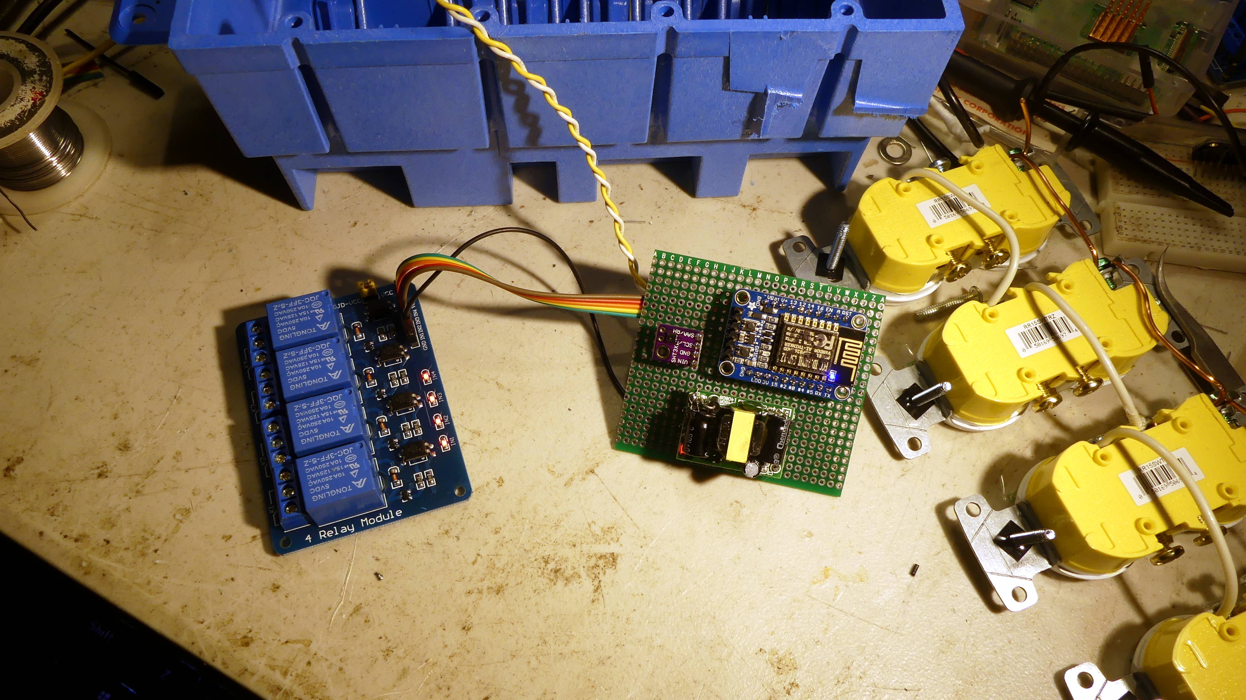

Top view, getting started.

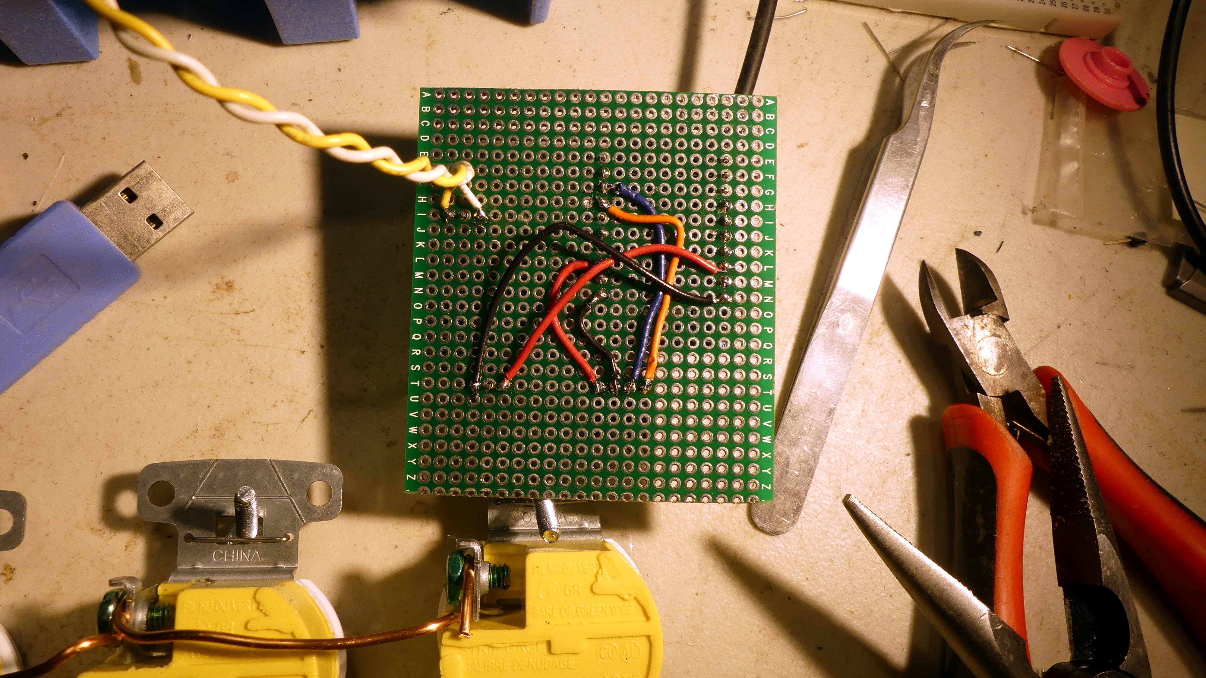

Wiring other than relay drives (which are just wires to the relay board header).  Note sht-31 runs from 3.3v from Huzzah board.  No extra pullups needed on the I2C bus here.

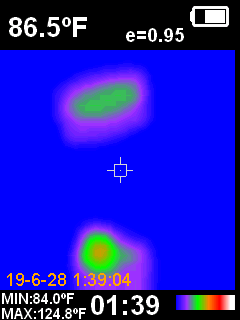

Power supply at bottom center, relays at top, all energized and allowed to equalize temperatures.  And yes, it's hot here in the summer.
Yes, the power supply gets hot at under 1/2 it's ratings. I might someday put in a better one, Amazon is now full of better looking ones.
All but the big power wired...the rest is an exercise for the student.  (yes, I hate it too when people say that)
I soldered a fat solid wire jumper between the commons of all the relays and wired that to the "hot" line of the power cord, along with the "hot" wire to the switcher power supply.
I used 16 ga speaker wire to do the individual wires to the relay and outlet hot sides, tinning the ends. The cheap computer line cord was 18 ga (!) and in this case, is the line fuse...(yep).
In the code package I added a couple useful pix of pinouts...I didn't happen to have one for the Huzzah, but the silkscreen numbers for the IO pins are the same. Here at the shop, I've printed these out and laminated them to make them stand out on the shelf from all the other junk I've printed and then lost in the pile of paper.

The green perfboard was cut to fit the board retention slots in the power box - yes, it has those! There was little hope of doing that on the relay board, but it fits in there diagonally in a helpful space provided and is a nearly perfect fit. I thought of adding a little glue to hold things down, but the tight fit serves fine for that...

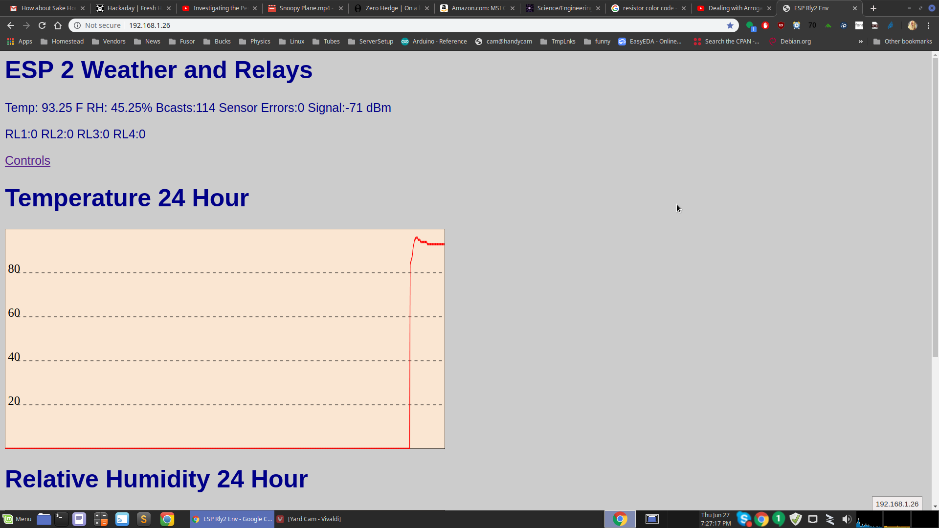

Oh, forgot to post screenshots of the rather lame web pages this emits. I wasn't going for commercial use, just enough to make it useful to me.
Writing fancy web pages with pure html and SVG in C...well, there are better uses of my time. The fancy frameworks used by others won't fit on this hardware.
The home page.  The graphics are svg, and yes, there's internal heating here.  Still useful once you know.

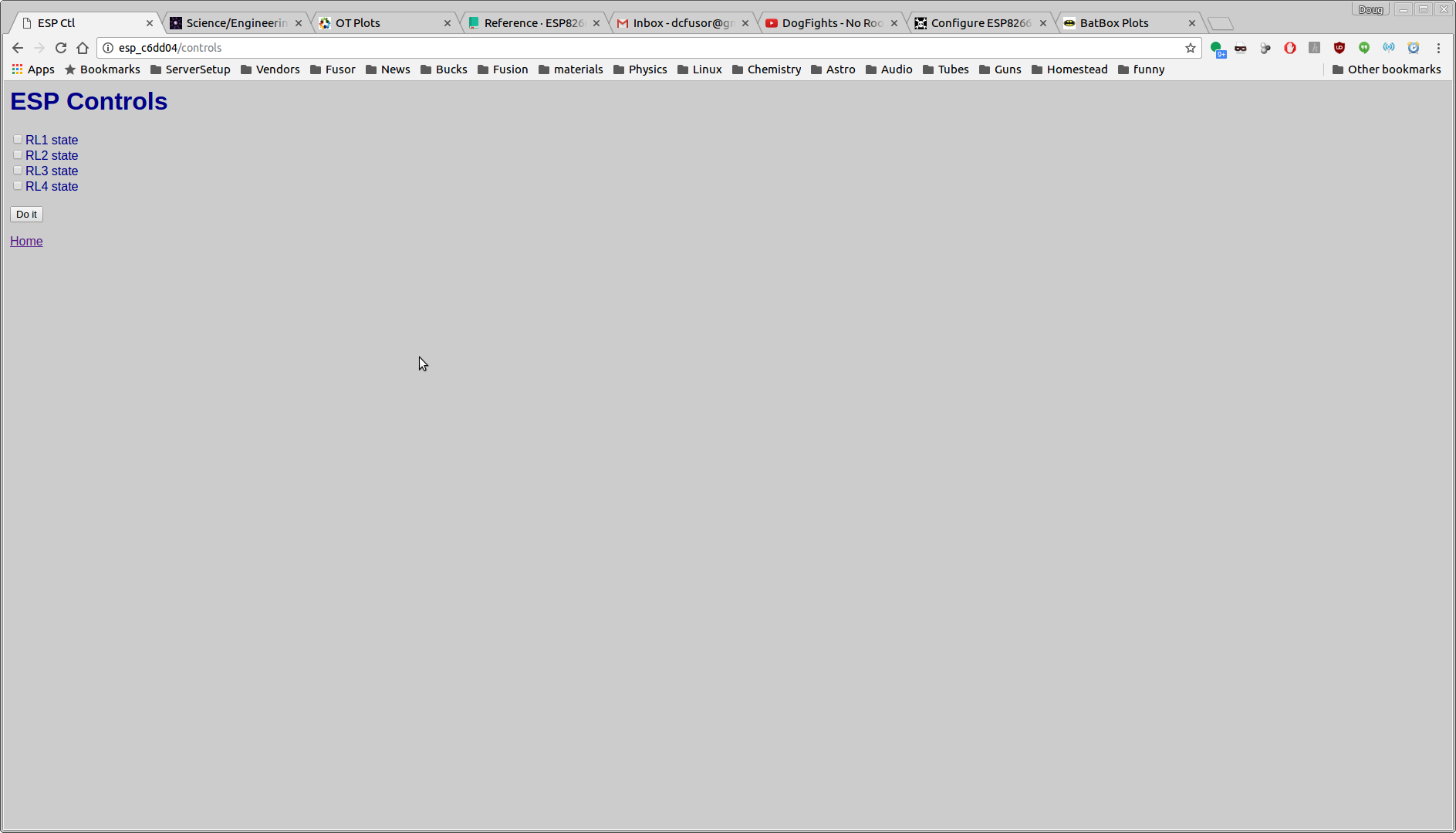

The actual controls page.  The logic lets you change more than one at a time, and not false-trigger just because you checked a box - you have to say you mean it.
