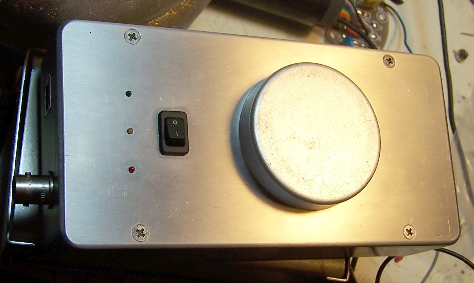

Standard counter, serial #1
This is a pancake geiger, shown here with the protective cover (and beta stopper) on the tube. It is USB powered, so it requires 5 volts on a USB jack to run -- and it's a lot nicer when you use it with a computer and plotting/logging software which we also provide. The particular pancake tube we've managed to get 10 of is optimized highly for beta radiation over all other types, making this perfect to count silver or indium after activating it with your neutron-producing device, and that's its main intended purpose. It's sensitive enough to count background, which it counts in the low 20's of CPM in a few locations I've taken it to, well off the ground (the rocks around here are a little hot). However, the specialty of this is superior beta sensitivity. While it counts less background than the larger Geo pancake, it counts a beta source a lot higher. The gamma to beta ratio is greatly enhanced in this, as I will demonstrate on this thread somewhere. I measured this using an "official" plastic encased Cs-137 .25uC source -- something that emits one beta and one gamma per decay (no alphas, and both the betas and gammas are monoenergetic). With the beta shield in place, this counts around 1k CPM. Without the beta shield, it counts closer to 30k CPM -- so it's about 30x as sensitive to betas as to gammas, making it ideal to count sample activations against a mostly-gamma background (the usual situation).

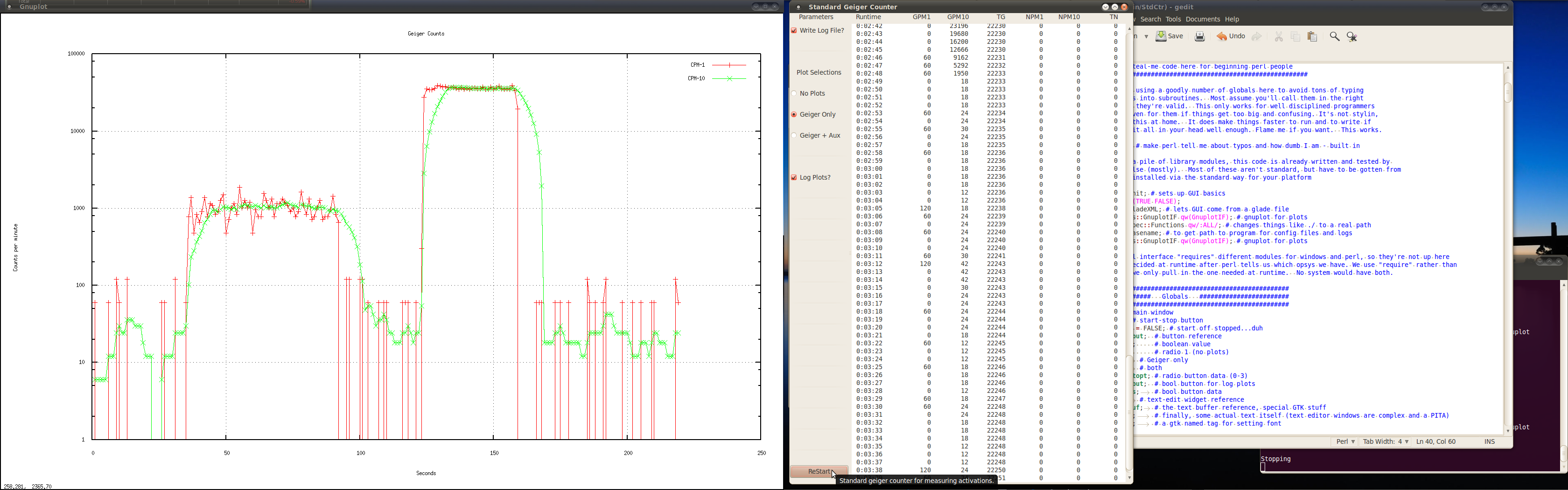

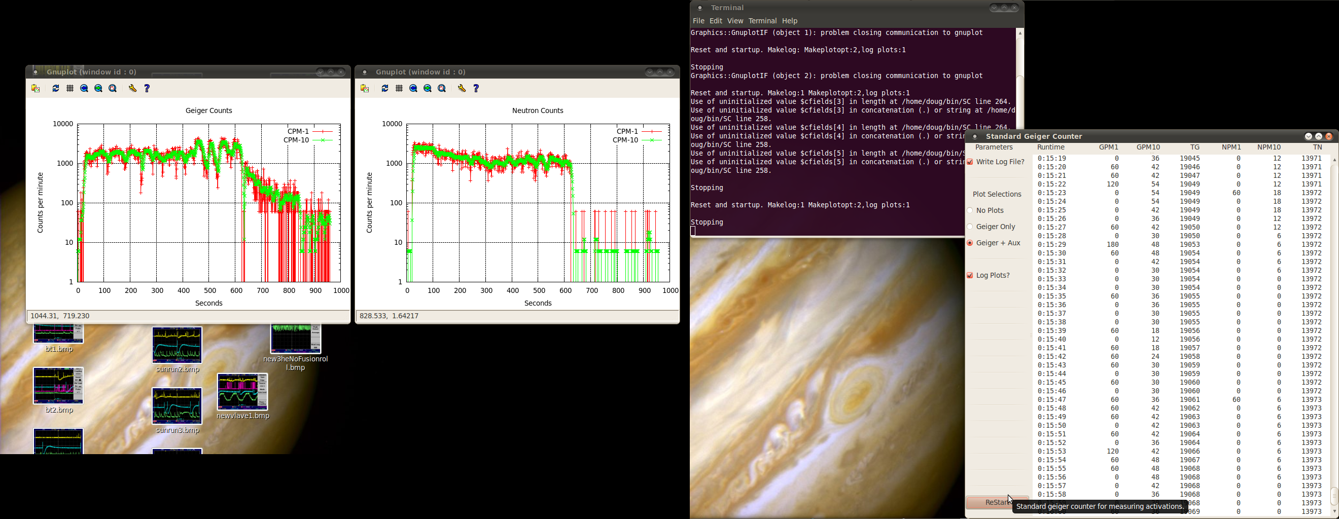

Here's what it looks like on my dual monitor setup.

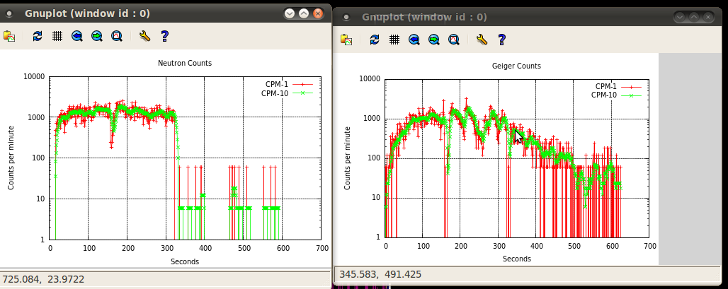

Screen shot of a demo run with background, and a source with and without a beta shield in place.
You can see when I did what easily on this plot, which is log Y so you can even see the background in the presence of the 30k cpm points. Gnuplot lets you get numerical data back by placing your cursor over a spot, and the cusor position, normalized to plot scale is displayed at the bottom left (I didn't do that this time). If that's not a good enough record, then it will also log the raw data from the standard counter.

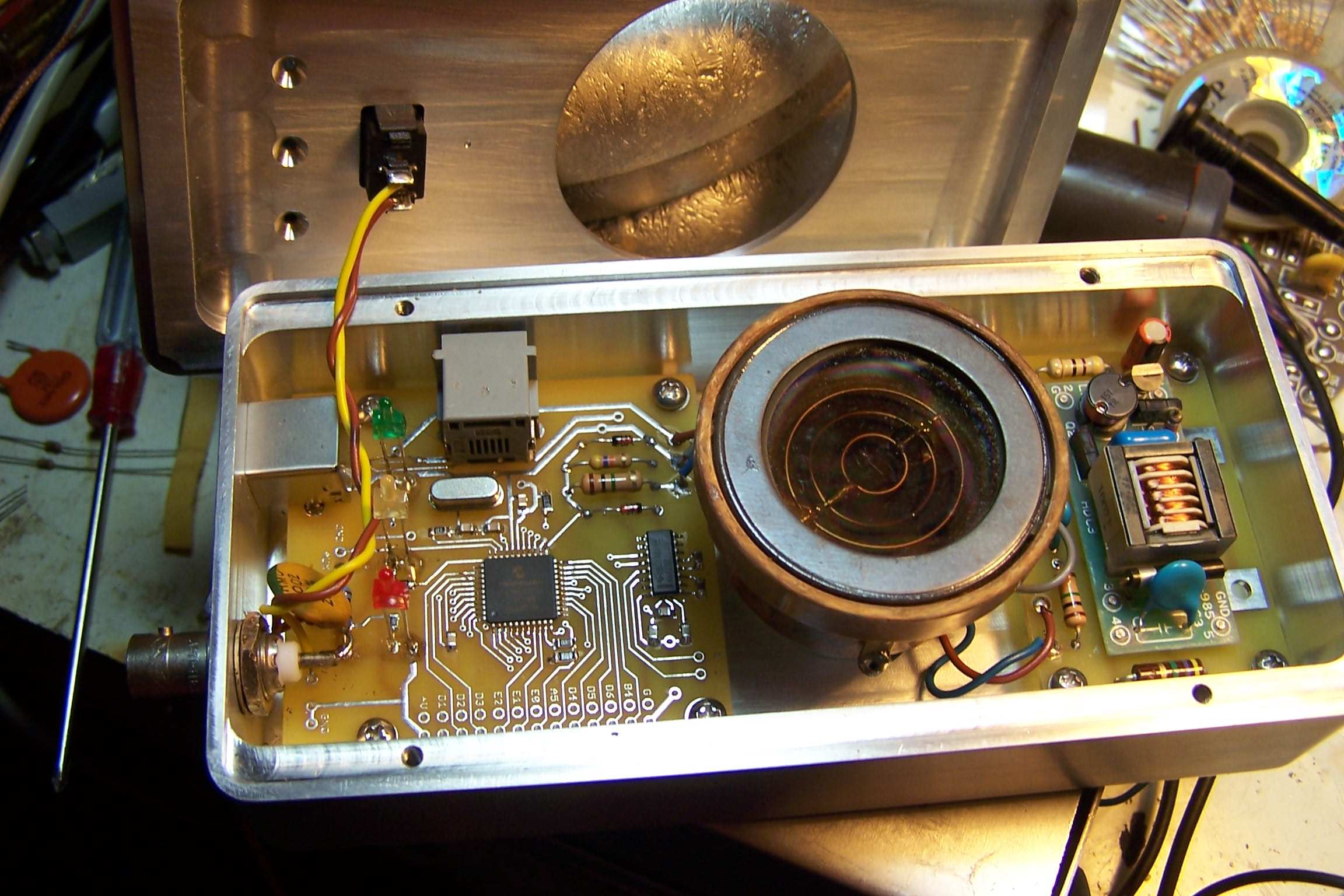

The guts
The guts
Note the dual row of "spare pads" on the edge of the board. Thats' the leftover IO from the PIC 18F4550. It includes regular digital IO, PWM outputs, A/D inputs, interrupts, I2C bus, and power.
This board can be plugged onto application specific other boards, and either power them or be powered by them, providing a uP and an PC interface that can really move some data.
You'll notice that we designed this in modular fashion -- all the geiger-tube-specific stuff is on its own board, so if that should change for some reason, you only change that part.

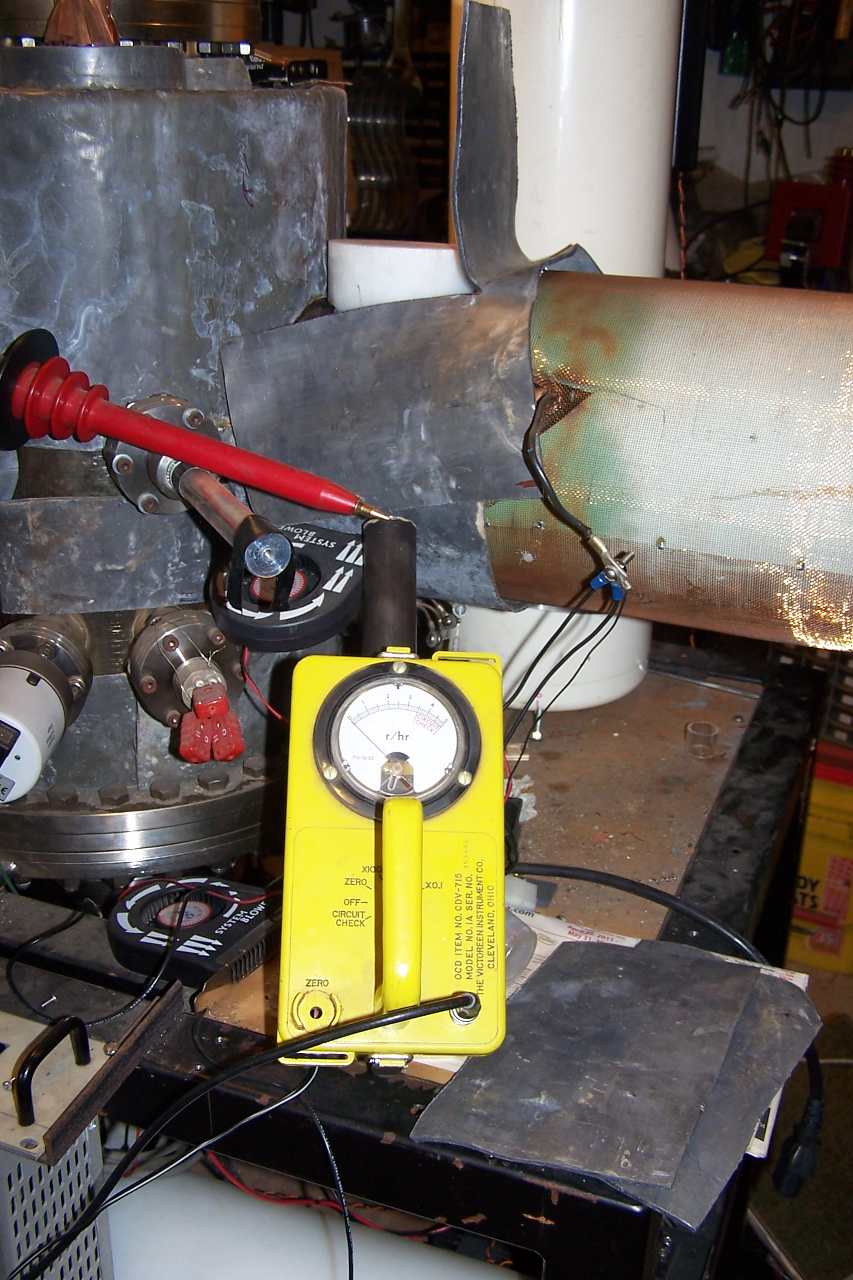

In my case, all I have to do is keep it outside the lead. Here's what it looked like for this run.
Hornyak detector pointing at fusor core

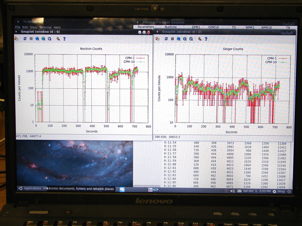

OK, here we go with a real decent fusor run. Just about exactly 10 mins, but no guessing, because the log file shows all :mrgreen:
Screenshot of standard counter info, good fusor run

Fusor conditions:
1.6-1.9 e-2 mbar on pfeiffer pk251
Ion source in use (so I could run the lower pressure)
power 48-53kv, 15-20 ma
You can see the X rays dip -- that means dropping power supply voltage as something outgasses, and then I hit the gas remove solenoid, and they (and neutrons) come back up. I had to let in fresh D a little once, but basically I was running on what's on the tank. Right about 10 min 25 seconds I stopped the fusor (for about 10 min run, since I didn't start it till about 20 seconds into the log), and put the silver on the standard geiger at about 10:35 to watch it decay.

You can see a general trend in the neutrons downward. Phosphor fatigue? Phosphorescence buildup that shifted threshold? Or did the neutrons just sag as impurities outgassed from other things in the tank as they got hot? Still more to learn, but this is the tool for that, by gosh. And, with only a little more code and a few more connectors, it could have been logging main volts/ma and tank pressure...maybe we should make that an option for people? All the required hardware, except any signal conditioning and connectors is there already -- the PIC has spare a/d inputs we are not now using, plenty of spare CPU cycles, and so forth.
This is plenty sensitive enough for any working fusor. It won't quite see the neutrons my ion source probably makes (neither do the 3He and B10's), but that's so down in the noise anyway as to not constitute "working fusor", though it looks a little like one, it's just a tiny extra grid way out in the big part of the tank with 15-20kv on it at 10 ma or thereabouts. If it's making neutrons, nothing here sees them with good certainty. It does allow me to run lower pressures and more stable in general, so it's worth having in there -- these numbers are a lot better than the last run earlier today.

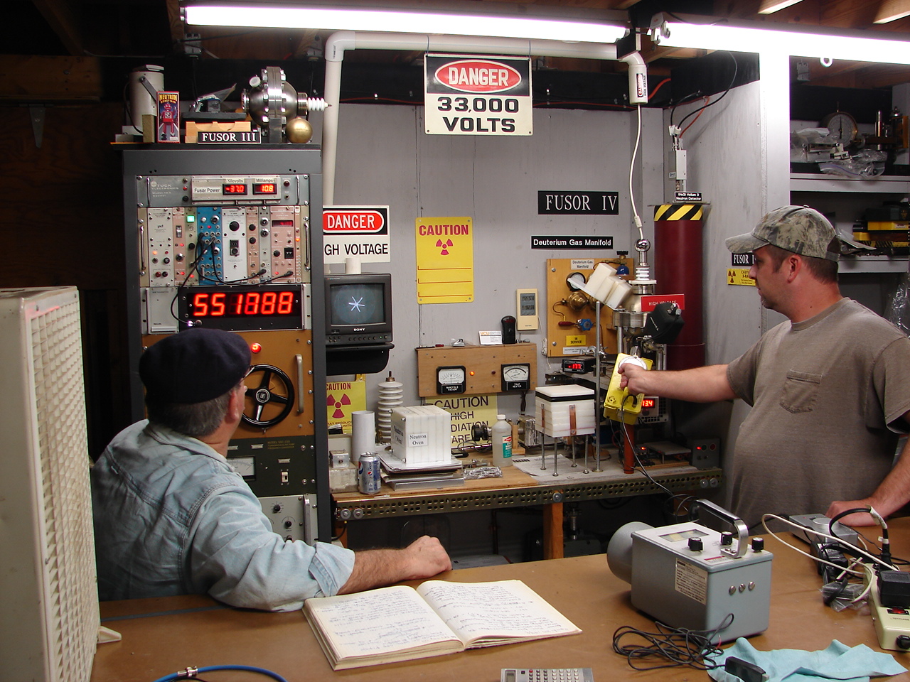

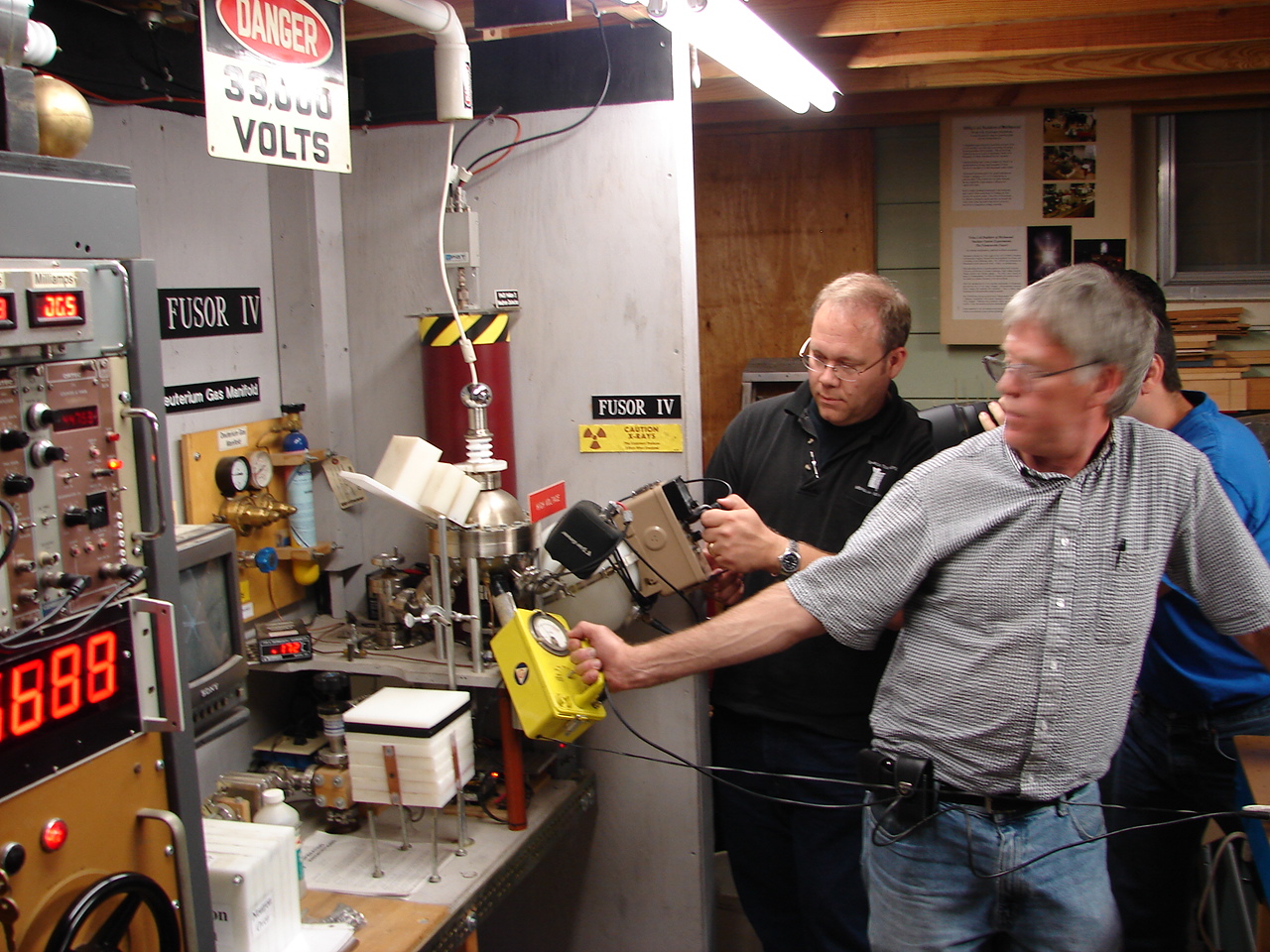

Though I didn't make it, Bill Fain and Joe Jarski went to this year's HEAS, and used our counter to document some of Richard Hull's fusor runs. Due to how tight things were there, they wound up actually holding the Hornyak up to the fusor by hand to get good numbers, and take some exposure themselves. Some good data was acquired (more of which I'll post when I regenerate the plots from the logs), and a very good cross-lab calibration obtained. Richard's unshielded fusor makes a lot more X rays in the room than mine does, according to this data, which was taken with the geiger portion of the counter a good bit farther away from his fusor than I do here. I'm suspecting some of the variation seen in the X rays (when not counting activated silver) was due to humans being temporarily interposed between the fusor and the counter. We see variations here too, but not so much, and those are usually tracked by neutron output here.
Bill braving the X rays
Joe getting a tan
Joe getting a tan
Results of one run
Results of one run

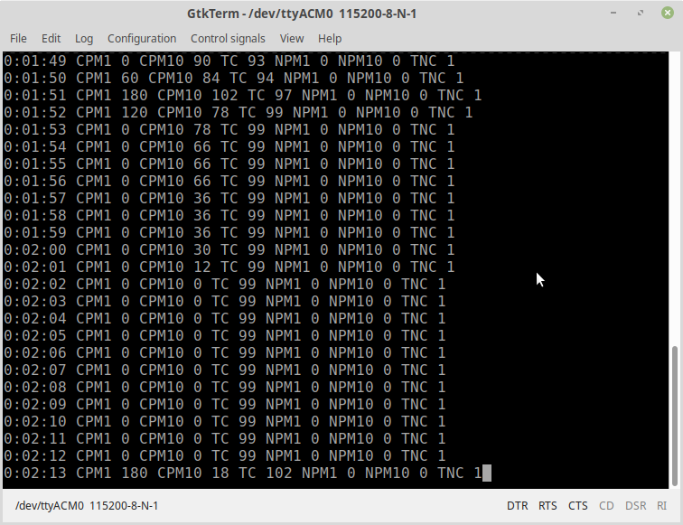

Someone asked for the output format for this, so here it is.
It's a USB serial port, 115200 baud, 8n1, and uses linux line endings (not crlf like windows). Most terminal programs will do the conversion as an option.
Here's a screenshot of some output I just took here.
Serial output
Serial output
The first field is uptime, as H:MM:SS
Then the label CPM1 - which is "counts per minute for this sample" - really it's counts this second times 60, since everyone uses CPM but often doesn't want to wait a minute.
The next pair of fields is CPM10 as a label, followed by an average 10 seconds - useful as low level radiation is really random so some smoothing is nice for the human to read.
TC is total counts since powerup. So if you really want to know a long term average, you can use this and the time to compute it.
The next set of fields, which only occur if something has put some input to the BNC connector (TTL-like levels, a low pulse counts - it's not real picky but don't blow in 100's of volts).
They're the same format, but the N means "neutrons" as at the time, that's what we were hooking up to it - some sort of neutron counter. It's able to handle pretty fast counts.
