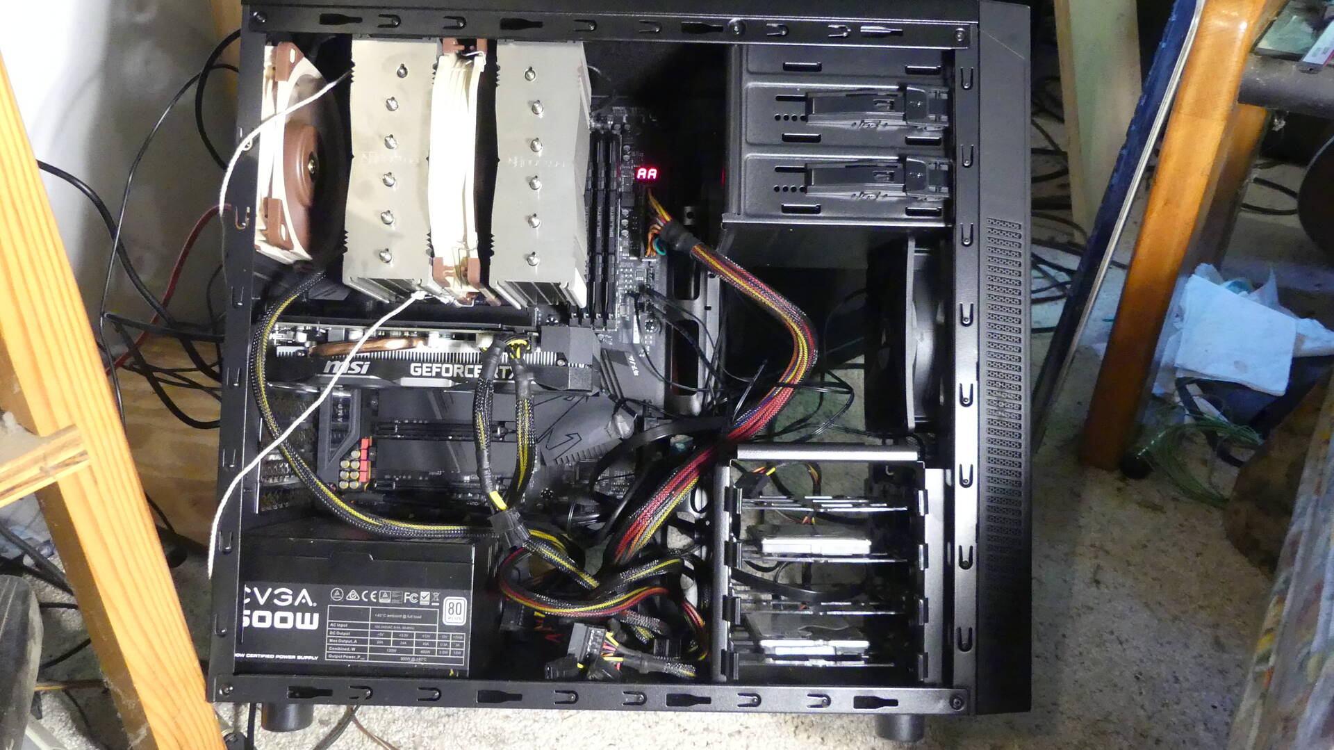

In the immortal words of Bill "Grumpy" Jenkins - purty don't make it run good.
ProTip - the strings are on the fan clips on that huge Noctua cooler, it lets you R&R the fan when the fit
is too tight for fingers, as here. It was easy to do then. Overkill, but it's nearly silent as it's loafing.
You mean there are actually people who care what it looks like inside?
Running really stable so far, even DaVinci Resolve is super fast. NIce.
I added a couple more tb of laptop drive to hold raw videos and transcodings to make them work with various programs.
Just happened to have one left over from an old LOT pi replacement.
