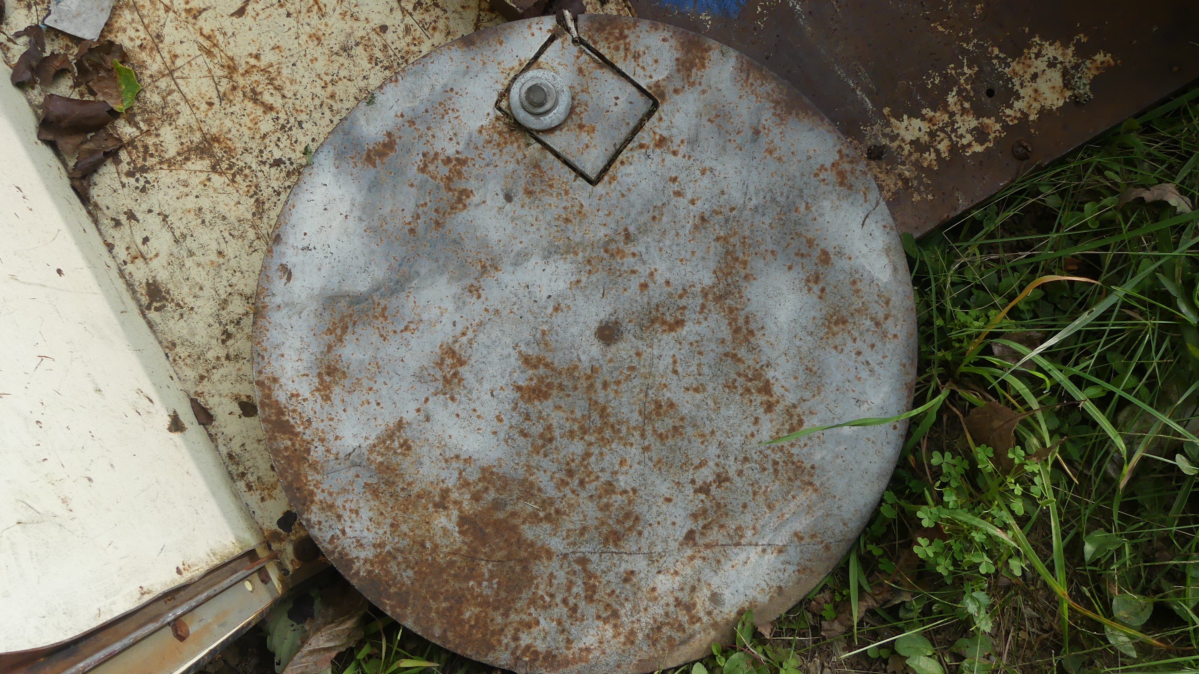

Bill had recently brought me a nice ~ 2' steel plate I drilled a hole in and hung up on the target stand for close in rifles at around 70 yards.
For fun, I put a round in the CZ and took a shot at it. OK, I'd been thinking about it and did calculate the likely 14" drop of .45 hardball at that range.
See picture. That's one of those "I'll never wash that hand again" kinds of things - and yes, of course it's luck, I'm good but not THAT good. It was, however, the end of any d*ck waving at the range that day. No place to go after that! No way I was going to take another shot and probably miss the whole target...and no one else wanted to try either. After that, we shot

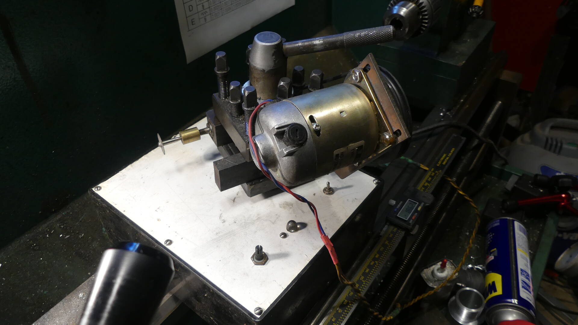

The only sad thing about replacing the original toolpost on my lathe was loss of use of my homebrew toolpost grinder, which I used to cut and chamfer quartz and alumina tubing, as well as drill accurate tiny holes for grid making.
That loss couldn't be allowed to stand....
That's a 1/8" ball mill (!) in the pic. Lots of cool tools around surplus, solid carbide, from the PCB industry, cheap. Also cheapo diamond bits that wear out quick but are cheap (horrible fright).

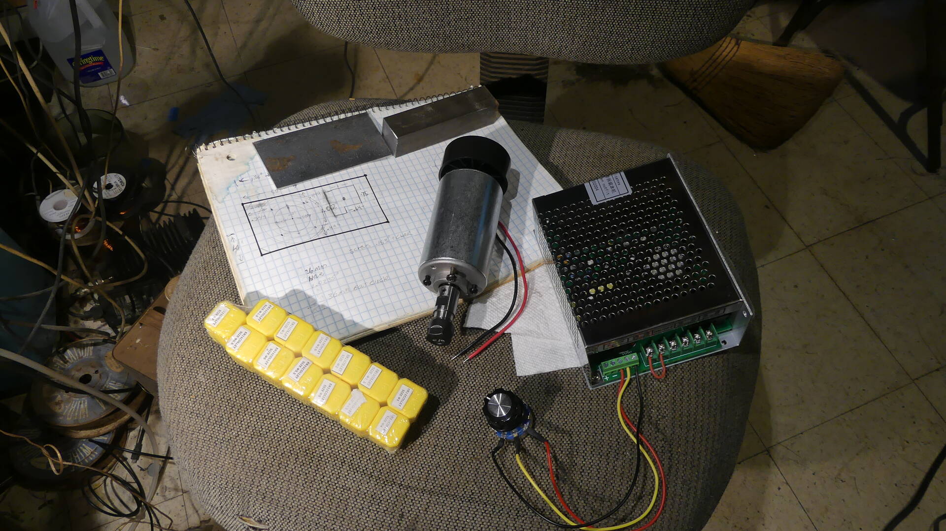

I know I keep promising videos and I've got a lot shot for the gun stuff and for this - try #1 was a real comedy of errors ... broken off taps, welding machine got misadjusted by people brushing against it and I didn't check, you name it.
Some are even partly edited. It's just taking longer than I thought, I'm at the beginning of the learning curve on both shooting the right stuff (and planning) and editing...
And FWIW, the power supply that came with this little kit should be sent to bigclive for a real aghast video - the motor terminals are at 1/2 line volts +/- one diode drop - as is the speed control pot. Not that little leakage the old filters used
to add via small caps to either side of the line - this is amps....as long as there are no insulation failures anywhere it's maybe OK but surely illegal as hell to import.
The motor is all you need anyway, er11 collets are cheap, and it comes with the one you always need - 1/8".
Here I'm just running it from a 30v bench supply and it's fine, I have a 60v one coming soon. Runnout is really good....
The good part.
The kit looked nice till I checked out that power supply - comments on Amazon prompted me to measure first, and I'm glad I did this time. I thought the don't tear this apart label was kind of amusing... 'The kit might be worth it depending on if you need the nice clamp and the collets and can't find them cheaper. Just ditch the power supply.
The whole kit. https://www.amazon.com/Beauty-Star-Spin ... GYQSXBZS3T

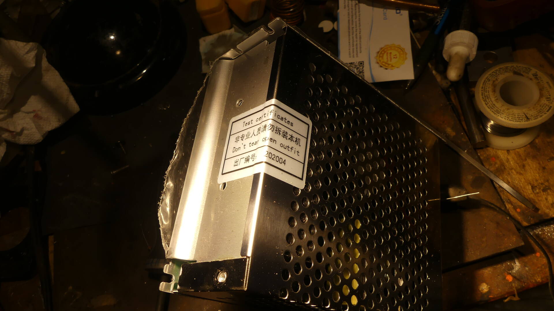

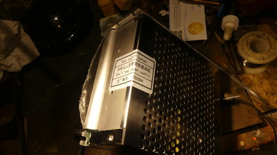

Danger!
The good part.
Danger!
Cheap copy of a Meanwell SMPS. At least that what the photo on Amazon looks like. Actually there is isolation between the AC and DC output, it's the ferrite core transformer that's driven by the power oscillator that runs directly off the power line bridge rectifier and big filter cap. Then again, you don't know about the build quality and maybe your sample is different. What the heck! Take it apart!

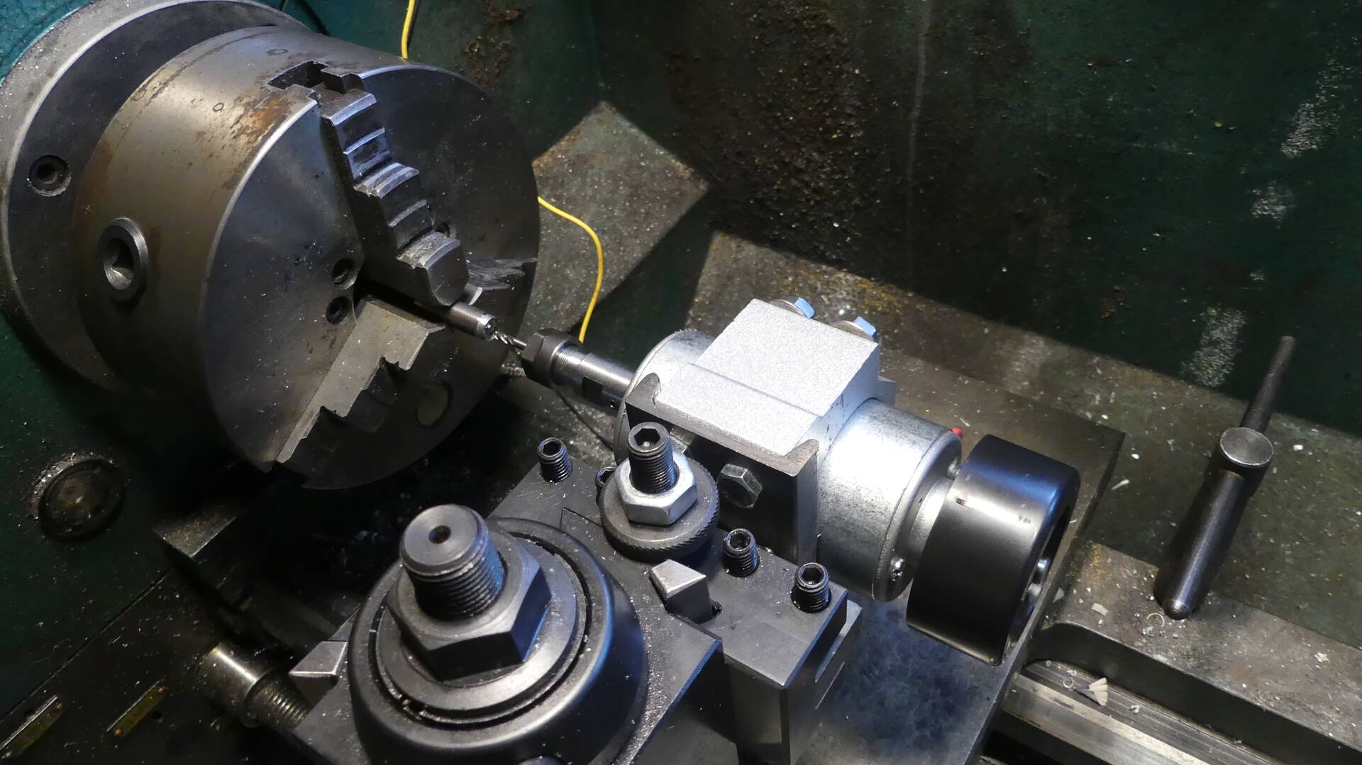

Congrats on your new lathe add-ons. Looks good.

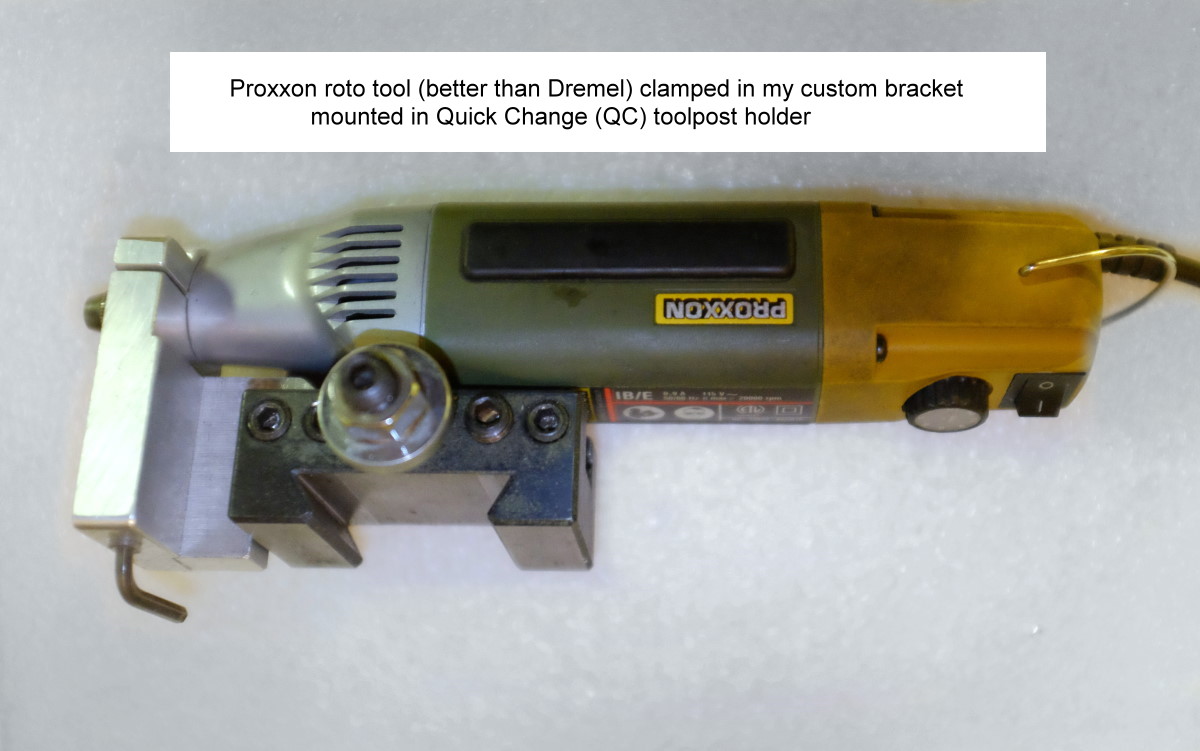

About 15 yrs back I bought a used metal lathe. A 1980's Taiwan 11 x 36. OK and within driving distance. Owner had added a quick change toolpost (BXA size) and a Sargon 2-axis DRO. Both are now things I would never want to be without.
Quality toolpost grinders seemed way more expensive than my uses could justify. But something like that was desired. A while back I bought a Proxxon rotary tool, like a Dremel but better quality. I thought for my needs it might be good enough.

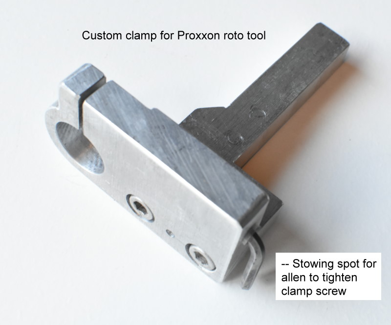

I made a holder bracket that fits in a BXA holder. Here's two pics...
It has met my needs so far. One use was cutting thick wall borosilicate tubing. I used cheap ebay diamond cut-off wheels. One issue is clearance of tubing passing the rotary tool body. Because of that I had to use 60 mm dia diamond wheels but it worked with a little water as cutting fluid and slow manual cross slide feeding.
I made a couple cylindrical fusor grids based on your great design. I used this rotary tool setup to drill the tiny holes for tungsten TIG rods. For that job I also made an adapter for a degree wheel mounted in the outside end of the lathe spindle. I rotated the lathe chuck by hand and felt that angular accuracy within a degree was good enough.
Here's a link to a zip I made of that process. It's mostly just a bunch of pics.
