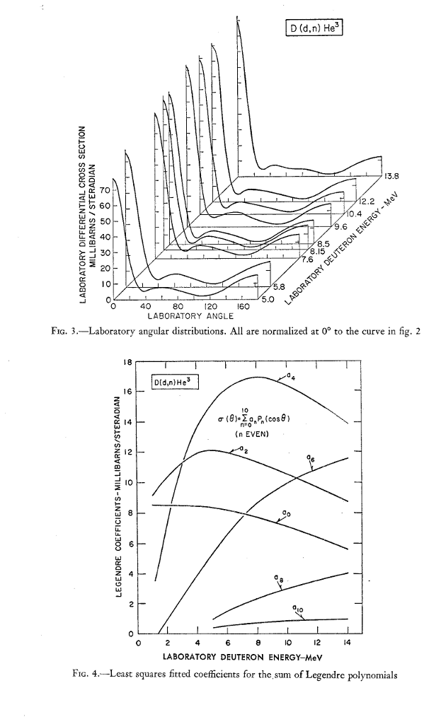

The plot below is from some beam-on-target work at higher energies that seems to show that the output from the reaction is not isotropic at all, even up to energies well above the Q of the reaction, so the effect might be even more pronounced at the lower eV inputs we are using (here it is usually about 50kv).

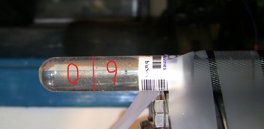

I have indeed seen this, I have attached a picture of a recent run in which there is a hard cut-off line in a bubble detector where neutrons appear to no longer be. I had some instrumentation damage that I'm repairing so I haven't had a chance to investigate this further, but in the coming days I will do this more and see if it can be repeated in other locations, and more dramatically with more bubbles.
