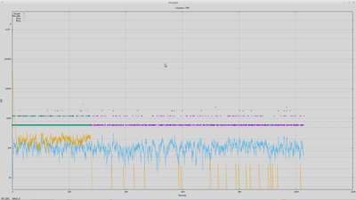

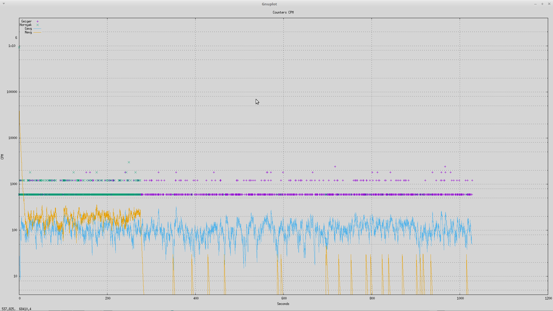

Well, interesting day. Got the fusor up with the RF drive, way NOT optimized, but got some decent neutron counts. From the scopes and the data, in this mode it's a little lower Q average (see the grid heating, and this is on ~360w input to the driver, so less to the grid) but some really good peaks when it drifted into a good timing.

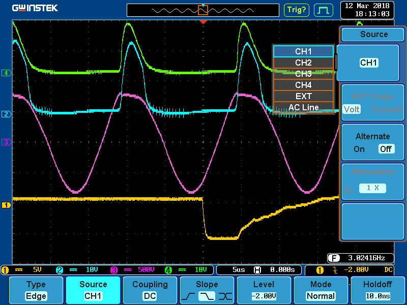

big scope
big scope
Green is the furthest faraday, which has a semi loaded ion grid "in the way" - the DC ion supply is wired up, but not on, shielding this one a little bit I'd guess.
Blue is the near faraday probe - the one that looks like a 2.4 ghz antenna (it is that too).
Violet is an ac coupled pickup a few inches from the end of the HV feedthrough (near the tank end).
Yellow is neutron (hornyak). When this is clipped, like here, it seems to mean a neutron burst.

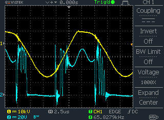

Yellow is HV probe on grid.  Blue is xfrmr input one side.

I was running 60 to 65 khz in this (before the DC PS fried). It looked to me like about 1/3 of the grid volts were positive, and 2/3 negative, corresponding very roughly to +10 kv and -20 kv here.

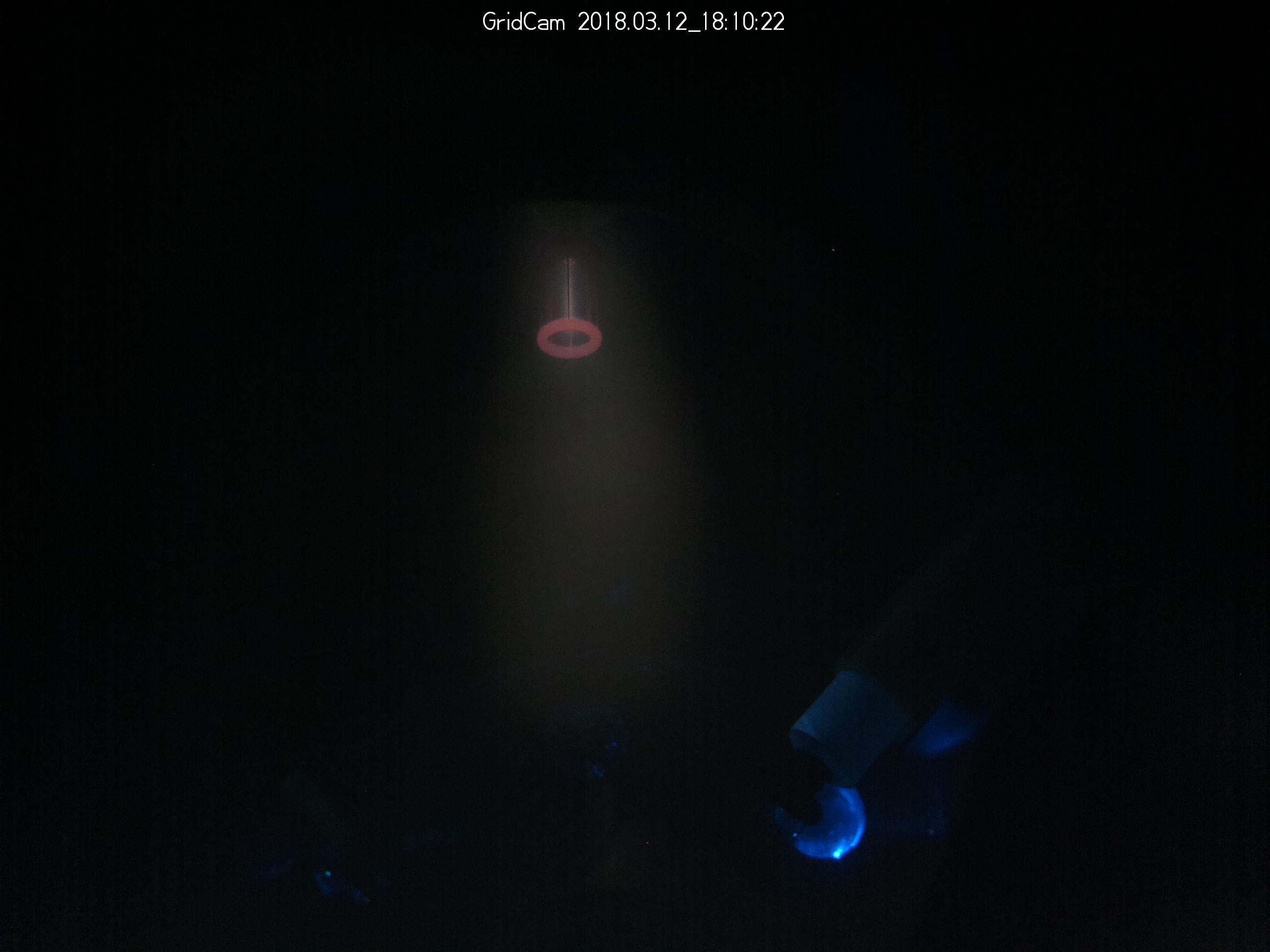

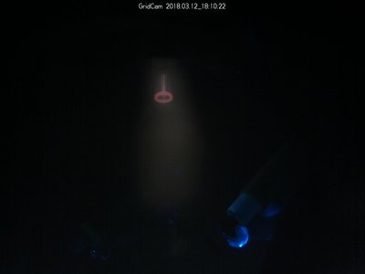

The grid got pretty hot - hotter than it does with the normal DC conditions for the roughly same drive power (here I only know what I put *in* to the stepup xfrmr, or that minus the wires from the PS, which get warm...)
The grid at equilibrium
