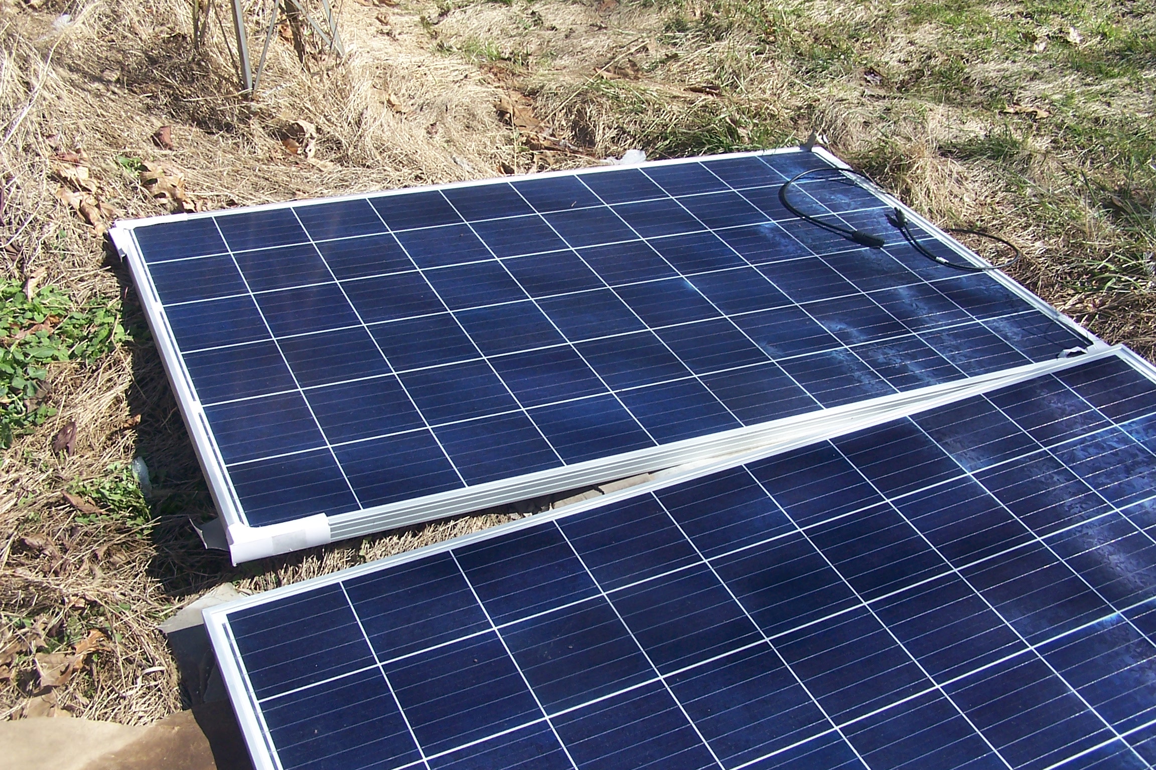

Doing some roof repair on the old trailer I now live in. No better time to replace what are nearly the oldest solar panels I own...so...
I had originally planned to put these on two racks of 3, and wire them that way for ~ 90v to the controller, this in part because these are pretty far from the shop where that lives.

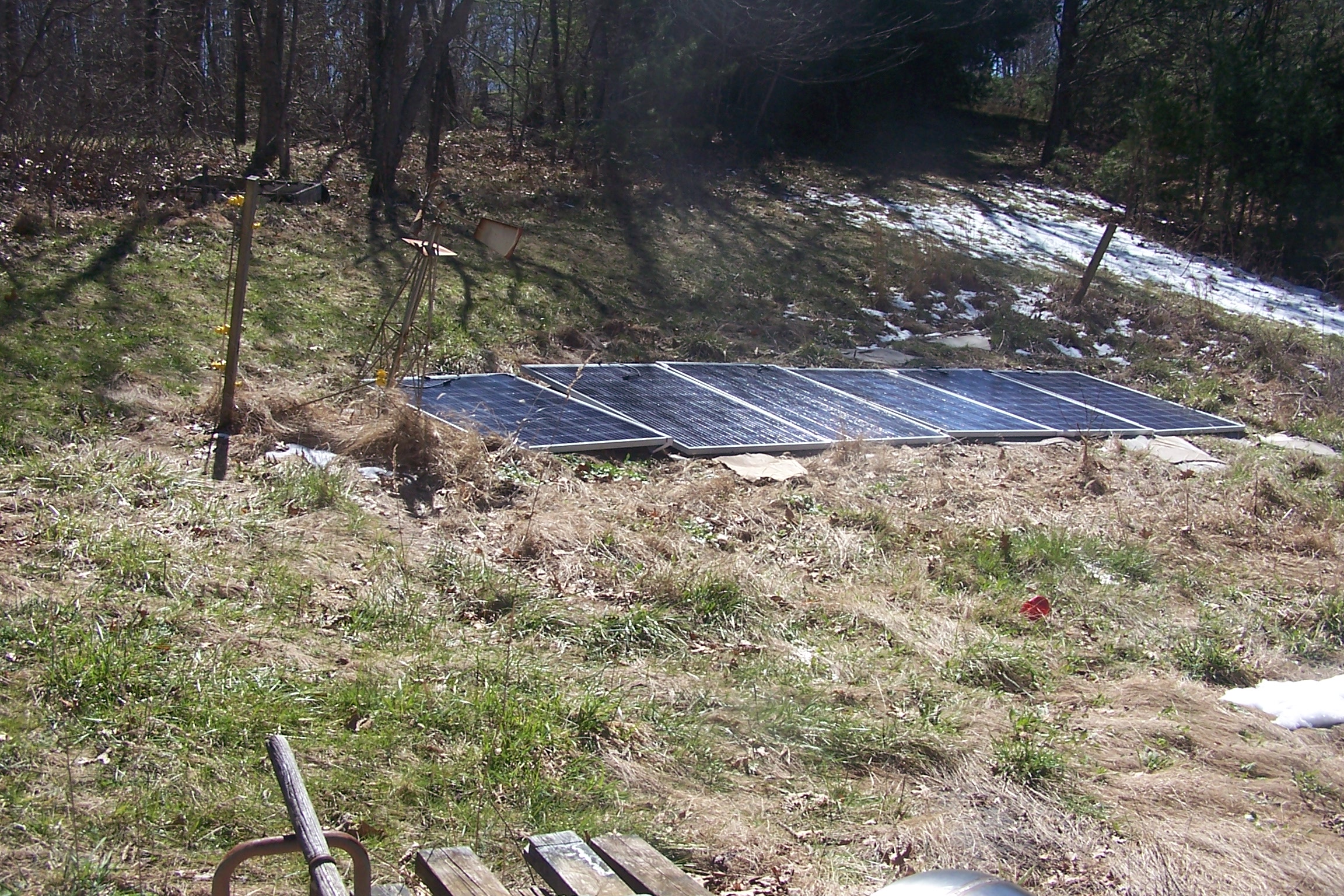

This is "the spot" that gets by far the best sun in winter - when that matters most. The shop is close to the road and there are some trees I can't cut there. No big deal in summer, but...

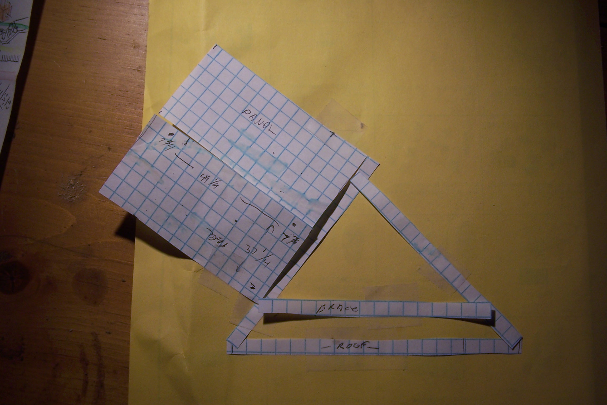

At any rate...I made some to-scale cutouts of 2x6x8' lumber and pieced it together "on paper" to see how that looks. The bottom piece is actually the 10' wide roof, and the mount points just under 10' to hit the wall supports...we'll see.

This will replace 3-400w of really old stuff with 1500w worth, more or less. I may move the old ones over to another building on campus, along with the batteries I'm replacing (even really good ones get weak in 25 years...).
