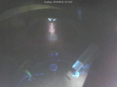

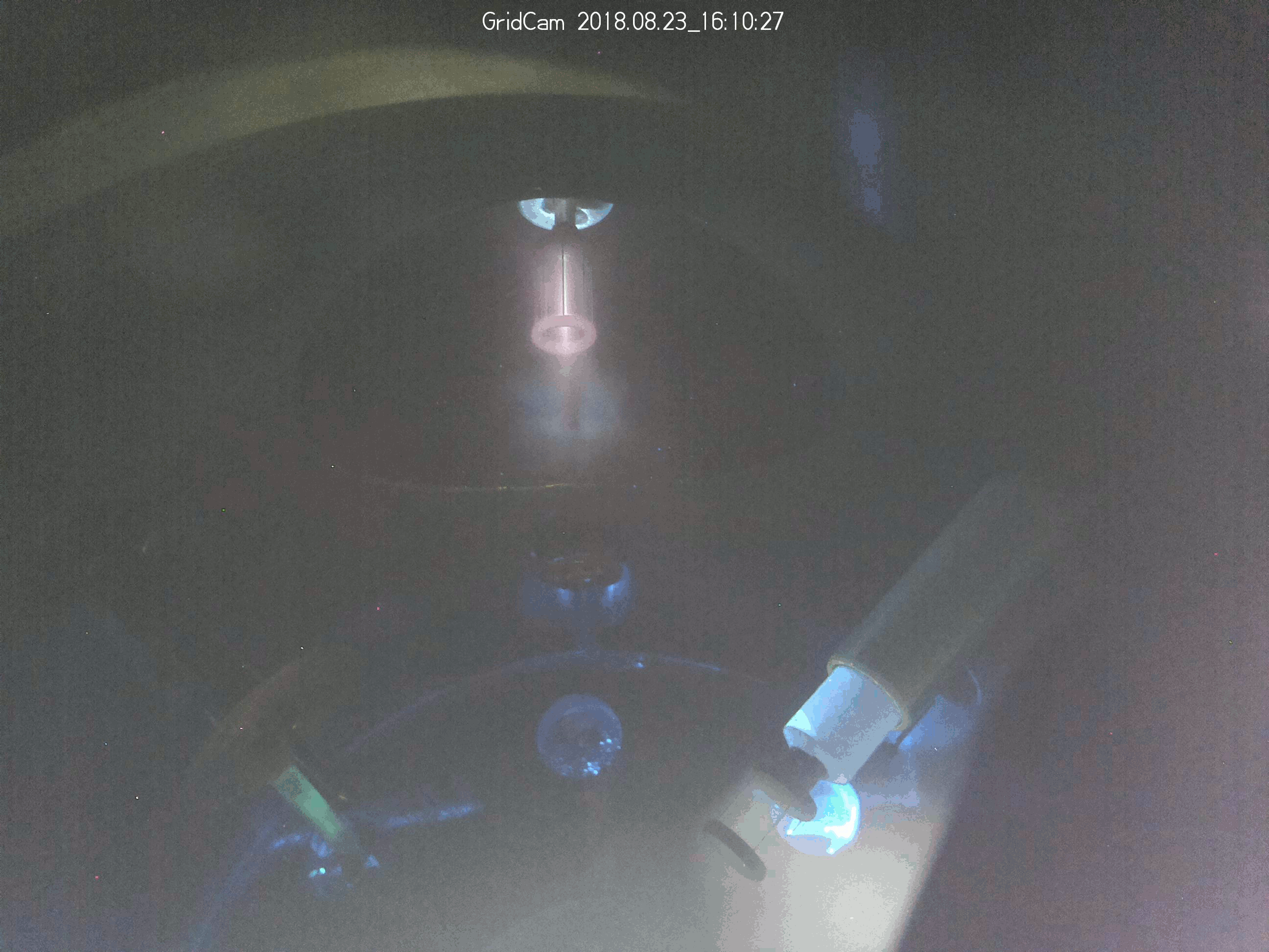

I've improved the gridcam a heck of a lot, using longer exposures (it's not like taking a sports picture, after all) and getting many times the light sensitivity than it used to have. The first frame in this animated gig might as well have been totally black to the naked eye...nope, nothing was glowing red hot there either.
These are at 5, 7, and 12 ma. The lower currents went with somewhat lower voltages too - we were current limited (@ around 30kv) till the last one.
An interesting effect is that the ion grid doesn't show the usual poisser here - it's just a blob of plasma, or so it appears. Further, the faraday probe nearest the main grid showed a sine wave (capacitive coupling) till things lit off - then clipped at ground with only positive pulses once it did light off - the drive is simply directly connected to a transformer secondary which is driven around 42 khz. Not only that - note that it moves with varying main grid power (no other changes...).
Normally if we have even one DC driven grid in the tank, that's it, all the faraday probes see a large negative net charge. Here, the opposite is true, the faraday I was looking at (the left one in the pic) went to ground, but never negative at all...

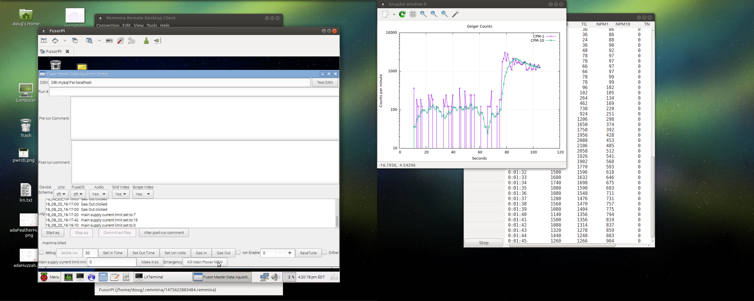

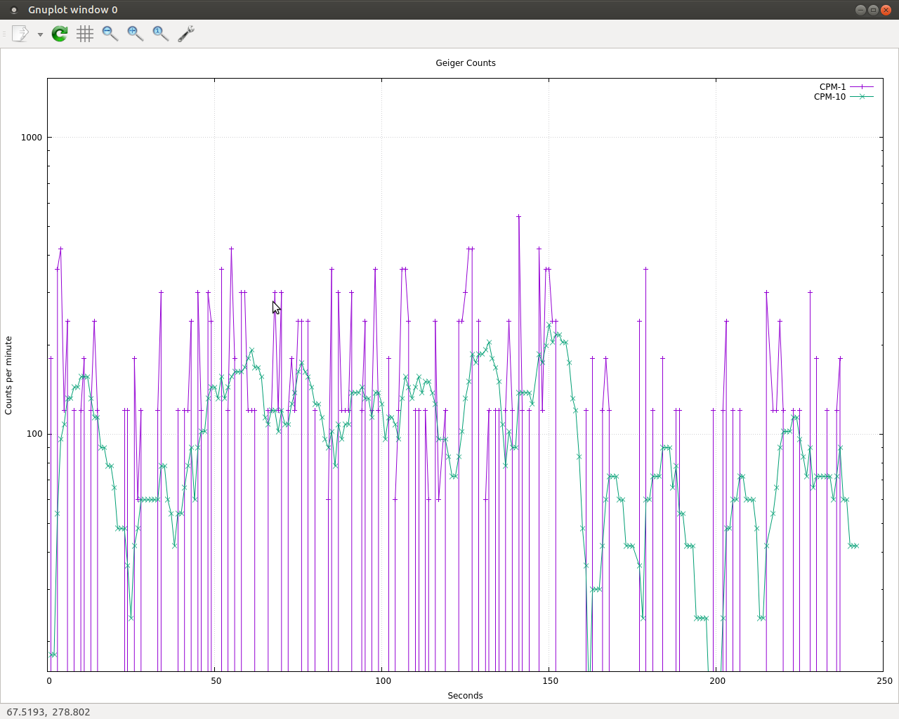

One of my other counters is a little flakey, but I'm sure that when it takes data at all, it's correct (tested with a cal source) - no rest for me for a bit, I'll have to chase down why that locks up sometimes, but I got a couple of pix as screenshots...
Then I restarted it after it locked up, but put on the indium. Our normal background is ~~ 80 cpm on this counter.
