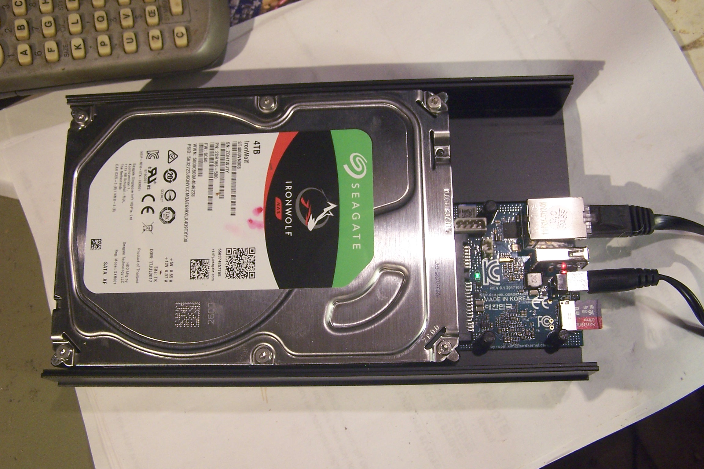

Finally there's cheap hardware out there that kinda fits the bill for what I want. A little more power than a Raspberry pi, but FAST. This would be the Odroid HC series. 1 Gb ethernet, built in SATA, nice package with heatsink (passive)...and compatible with the Odroid XU4, which I have, and which is a bonus to getting set up.
Here's the thing: https://www.hardkernel.com/main/product ... 1505170472
Amazon has these too, at a somewhat higher price (but shipping..). It's a nifty little box. 8 cores, 2 gB ram, 2 gHz clock...fast.

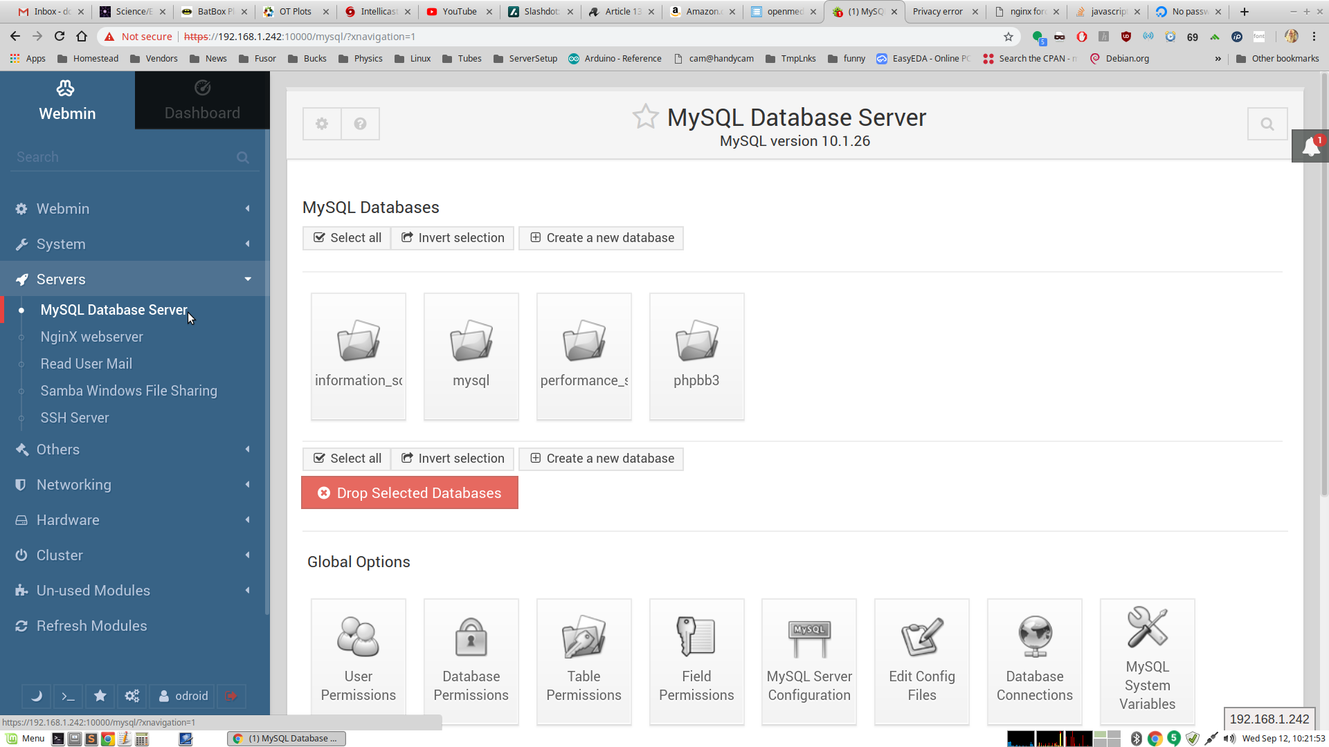

MySQL (actually Mariadb but we won't quibble)

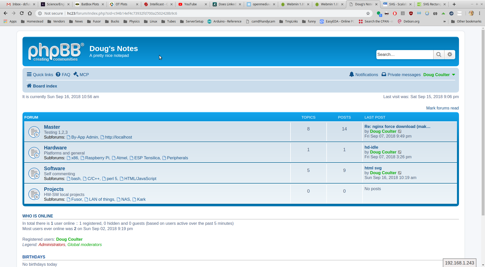

phpbbBB - yep, the same software that runs this board
phpMyAdmin - for the database
Nginx - nice web server, with (obviously) fastcgi for php - and for perl, which was a little trickier (I have a script somewhere)
And some add ons I thought were cool. For example, I'm not using phpbb here for a grocery list (but it would fit) - I'm using it to back up my work, my thoughts, do useful things in the middle of the night (down and uploads come to mind, as well as "layered deep backup between NAS instances".
So the limitations of phpBB started to chafe - it has some limits, which you can change up to the limits php itself has - and no, changing the .ini doesn't fix it - on handling huge files (like a backup of the NAS distro I built). So...workarounds for things like that.

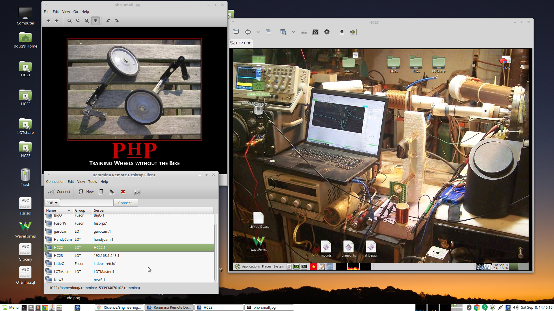

Teaser - here's the desktop of one of them with the other shares mounted on it too (that deep multi location backup enabler I mentioned), the Remmina viewer, and the webmin webpage it emits (among several others, but only one screen in a screenshot, right?). So, something to do with all those 4tB disks I took out of the synology (after backing it up, of course).

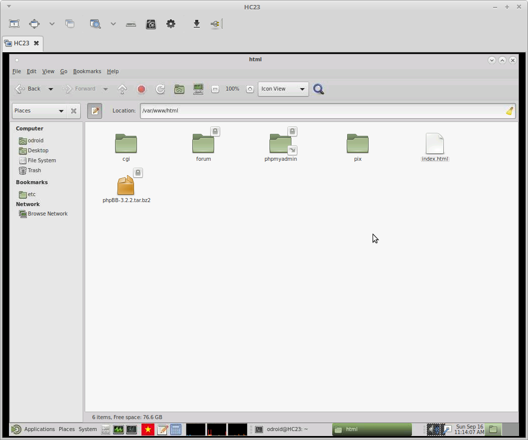

This will install NGINX, the PHP CGI junk, and the perl CGI junk. It will create a tiny website in /var/www/html you can surf to on localhost/ or from elsewhere in your LAN. It doesn't have all the bells and whistles at this point - but it is enough to check if the two CGI languages work, and until they do, there's no point in progressing.
The only configuration I've needed to change for NGINX is provided her as boilerplate, and it goes to /etc/nginx/sites-available/default - this is the one you'll edit. The major built in boiler plate is elsewhere and I've never had to edit it, though I've looked at it.

Once we have a working web server (and for non CLI lovers - VNC) - and this one seems best for this platform - we can go places and do fun things...

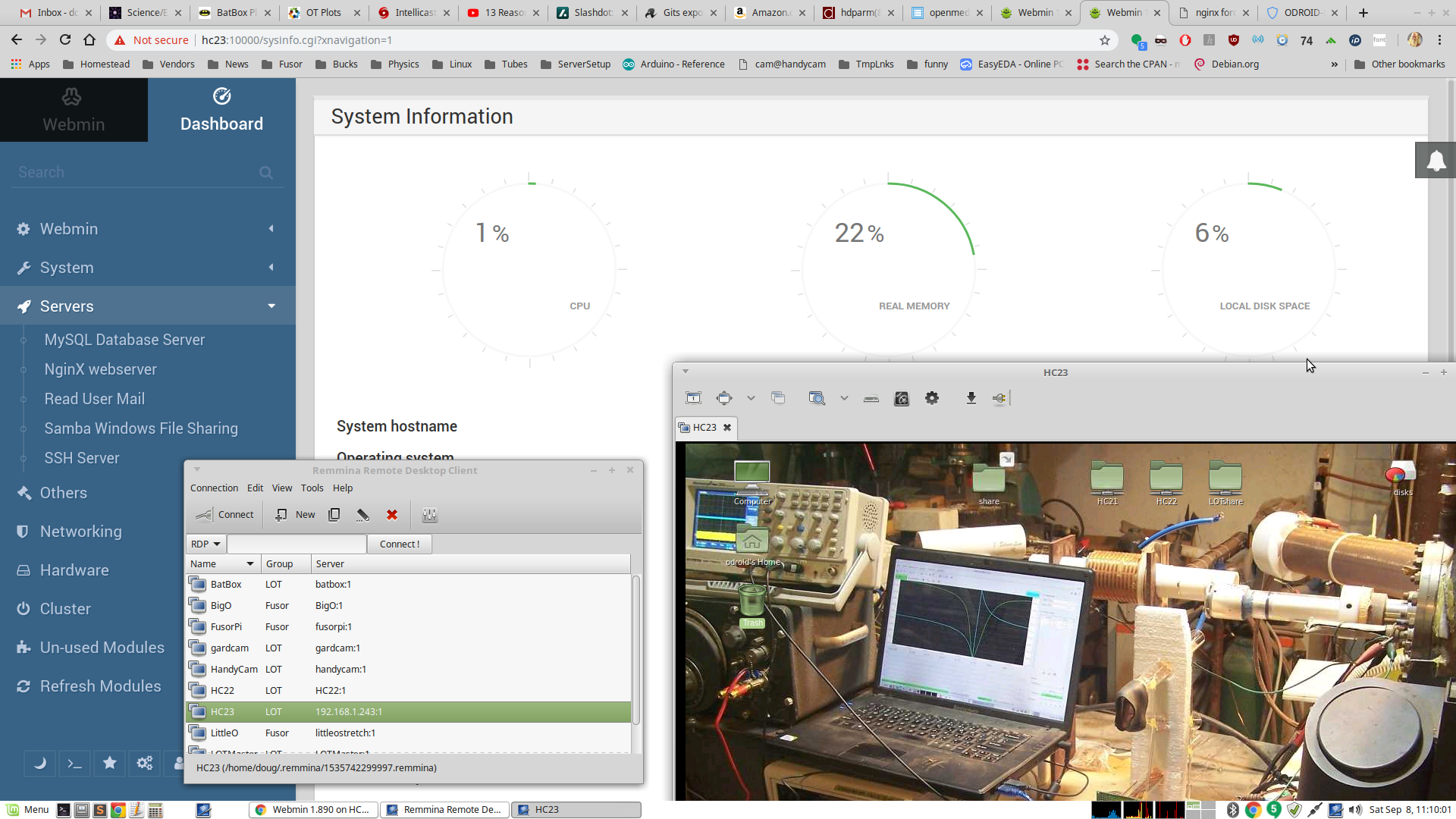

Two decent ways to manage a (probably small) database are phpMyAdmin, and Webmin. I generally have both, but usually use phpMyAdmin for management and debugging my LAN of things programs that feed and read their databases, and Webmin for general sysadmin of DB and lots of other stuff - when I don't just use VNC or SSH (rare, I feel blind with CLI only).
The php stuff assumes Apache and mysql, mostly, so we get to tweak a little to use this better stuff most effectively.
To put in webmin, I use the instructions here and go ahead in install the dependencies mentioned first. It seems to go in very easily and just work, the only
caveat being that it serves HTTPS with its own server but doesn't have the usual certificates, generating a warning in Chrome...I just ignore that since it's on the lan anyway - and remember that it's serving on port 10000 (see screenshot) You can add the nifty plugin for NGINX from inside the webmin configuration page. Neat.
Webmin manages this, samba shares, NGINX, NFS shares...and a lot of other stuff easier and better than most of the other tools, including the ones that "come with" the other apps. It "just knows" the syntaxes....

Well, I'm really enjoying building up a "knowledge base" on my own share here - if events permit, I may put it online for all (probably using another, better web host).
I'm liking the newest version of phpbb, which is fast even on an Odroid - essentially a couple generation old phone SOC.
I am using version 3.2.2 as shown here in the screenshot from VNC of the web root on the box. phpBB installed fine once I'd done the fix in the /etc/nginx/sites-available/default file shown above. Of course, you have to have put in MySQL or the moral equivalent as well first, I don't think it can install that on its own. Then you have to do the usual setup of phpbb with an admin user which at least a few people here will know about. There's plenty of online help for that.
The local site looks like this, and it's for my own internal sysadmin and programming info at the moment - not many posts as it's new just now.
I'm planning on using it for a version control system, much to the disgust of a friend who wrote his own, which is only slightly less weird and hard to use than git, and completely inappropriate for what I do myself - I like using phpBB as I can put in all the critical "what was I thinking" stuff more easily and obviously, and by using a regular thread I have the whole history I can revert to should I (happens really rarely) need to revert.
And in the next thread over, I can have code samples to steal from - my own 'stackXXX" kinda stuff, but specialized for my own interests and issues. I have some hundreds MB reserved for this kind of thing, and also access to the entire 4TB drive for "side loaded" files in the main share the board can cause to be downloaded to the surfer by clicking a link. Could be worse.
So the front page of that looks like this: I even just learned how to make this stream my own video content back to me...and with the real compact ones I can make with vokoscreen, I might even use that.
There are times where showing how it works when it's right - or just how to hold your mouth when doing something, is valuable.

Till I get the video made and up here - here's the star of this show - I have 3 of these...I'm going to use disk drive #4 as an offline/offsite backup (Well, a different building anyway). I guess I'll also share the tricks to have these mount one another for backing each other up...I'm doing a setup a lot like timeshift in linux (or time machine in apple, if I understand that one). Automated. Even Gb ethernet seems slow when there are TB involved...
