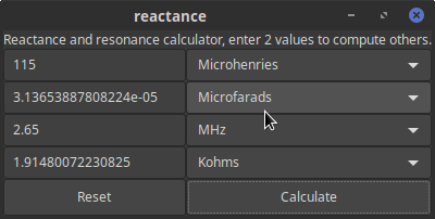

What it looks like running

The title and tooltips mostly say all you need to know. But there are a couple special tricks that you'll either love or despise - let me know.
This computes all four of inductance, capacitance, frequency, and Z of an element, from any two of them being known and entered. 1 won't work, and 3 is over-specified and will get you a humorous error dialog and a start over (well, maybe I have a lousy sense of humor).
Special things include - typing enter while in any edit box also pushes the "Calculate" button. Typing escape in the same boxes will clear them all in case of oops - a shortcut so you don't need a mouse to work this (tabbing, mousing, and so on work as usual in GUIs).
Changing the units in the dropdown before all four are filled in simply changes how the thing interprets your inputs - handy as you can say, for example 1 tab dropdown microhenry and it'll work as you'd expect.
After all four are full, probably via doing the compute - hitting the dropdowns will change the numbers. As if you had 1 henry in the L boxes - and change the dropdown to millihenries - the number will change to 1000. Handy if your first guess as to what magnitudes are going to be is a bit off...

Note in the above I put in real numbers for my fusor - 115 uH (measured) and 2.65 MHz measured - and hit Calculate, and it came up with the capacity of the fusor grid in exponential notation because I didn't spec the unit nicely - but if I had put the dropdown for C into picofarads either before or after, it'd have come out right and easier to read as 31.365 pf instead.
Which I think is cool, YMMV :mrgreen:
