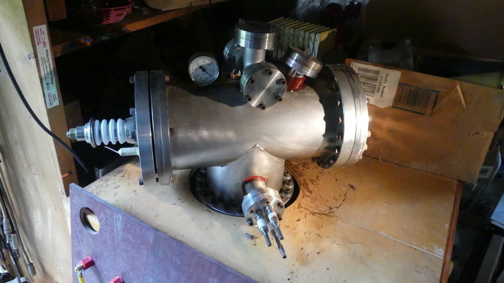

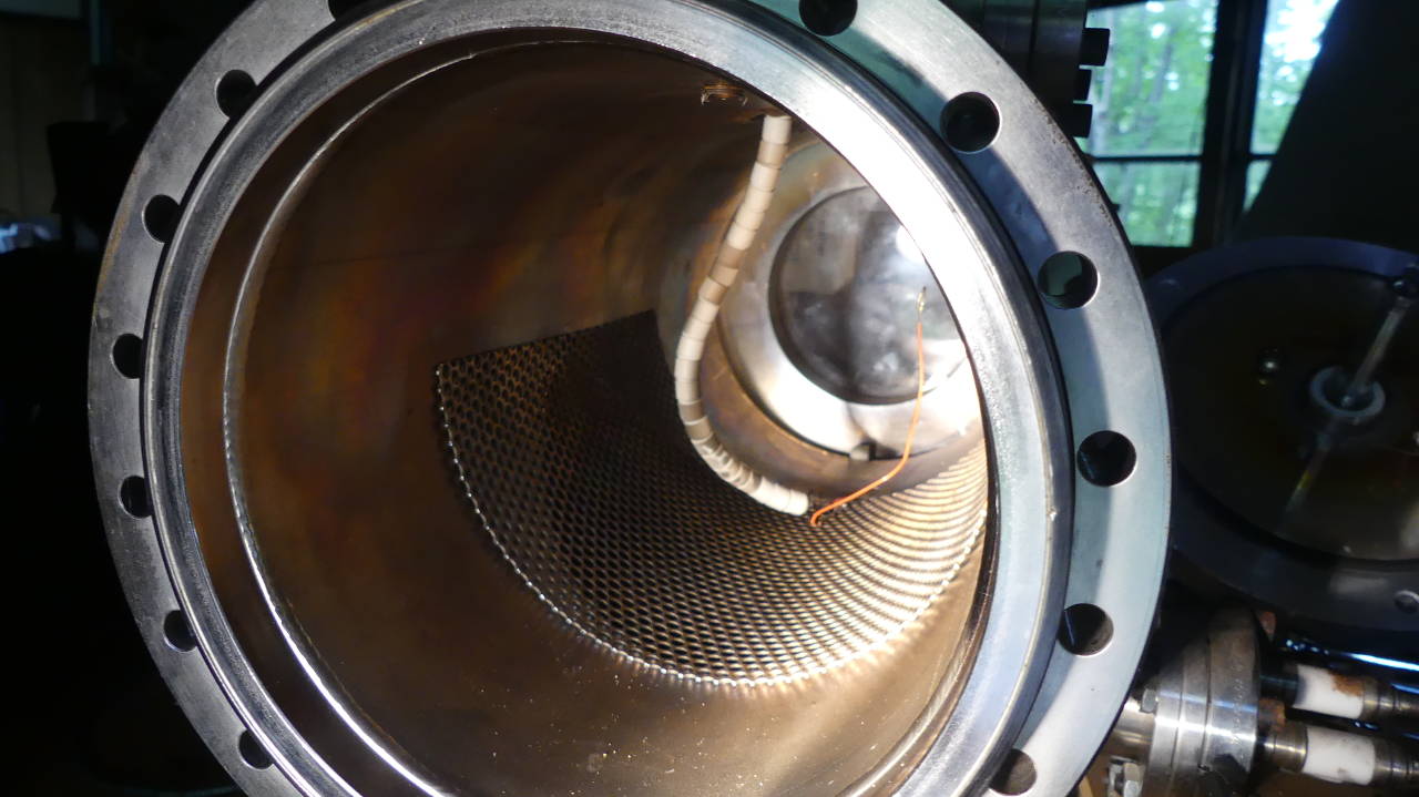

Bill's old fusor tank, which needs some work, but basically is good.

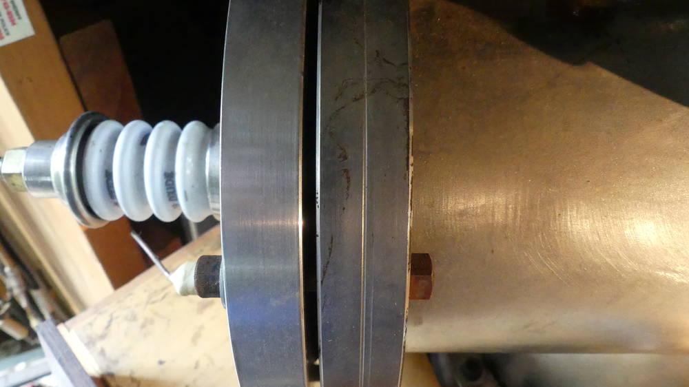

The flange with the HV feed thru is one we made way back and O ring sealed as the CF flange was dinged up at 3 and 12 o' clock. Now that I have some more confidence with my tools, I might just try to fix those dings, and put a modifiable real CF blank back on there - these experiments probably won't need extreme volts, and if they do, well, that's not that great a feed thru anyway.
Closeup of the back flange.  The big gap accommodates an O ring.

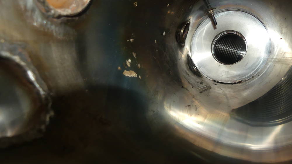

There are dings in the knife-edge at 3 and 12 o'clock
But if I put on my Clickspring hat and make a couple of custom tools....I might get this back to CF and lose a bunch of inches of water vapor-diffusing viton.

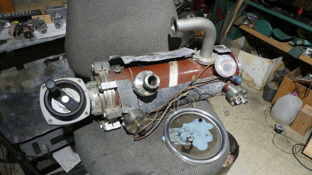

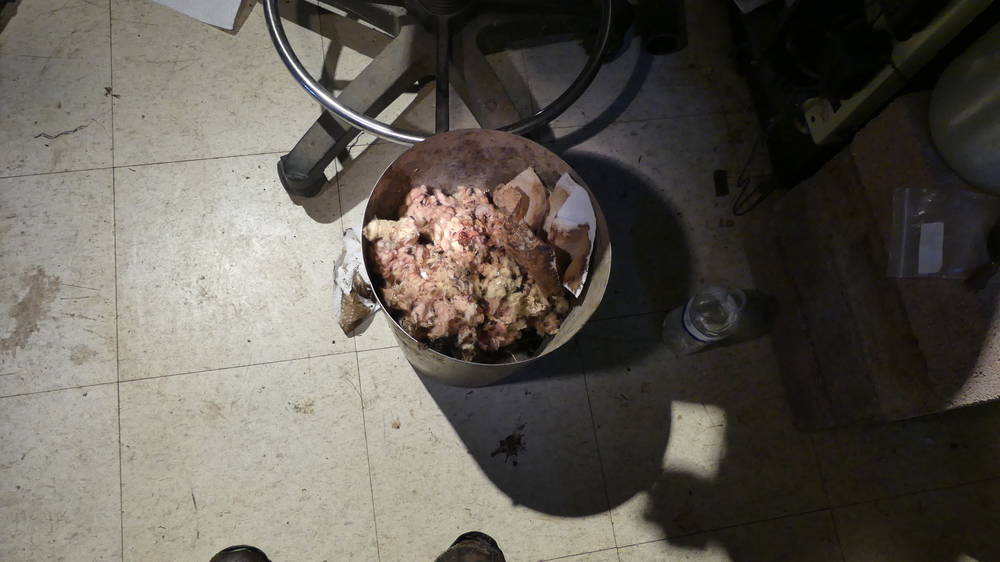

I'd wanted to reuse this, but..
The nicer part of what was inside for a year or two
Just too nasty in there, even after a simple flush and wipe.  That'd take a week to really clean up.

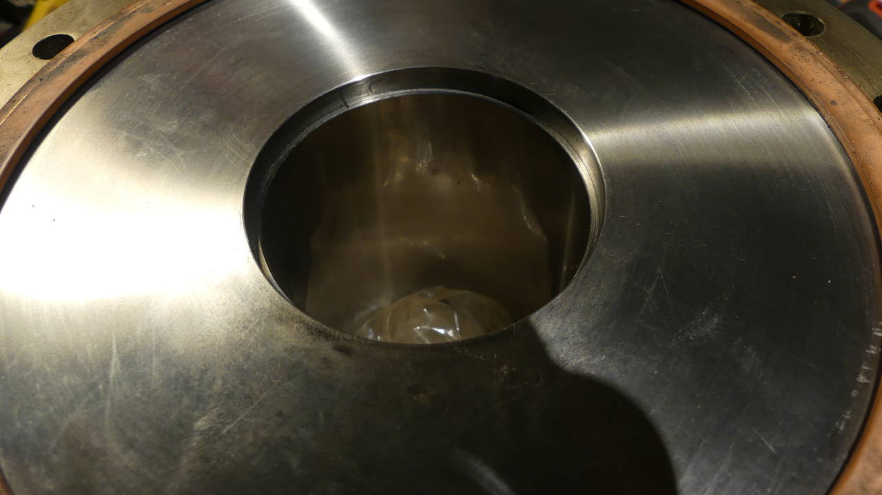

So, I got out my big-boy tools, and re-bored the hole in an 8" to 4.5" CF flange adapter to accommodate a KF nipple for welding. For me, that was the first time changing a cam-lock chuck on my lathe, not as big a deal as I thought other than cleaning things up a bit as too-long disuse had left a bit of corrosion on it, and I gained a whole new level of respect for guys like Abom79 and Keith Fenner being able to zero in a 4 jaw chuck in under a minute - I got to 2 mils pk pk runout in under an hour...sigh. I needed to take off just 20 mils (10 mil cut) on that center hole partway through to allow the ISO nipple pipe to enter the hole...Gee, I think I'll practice my TIG welding on thin to thick too before I weld this.
Came out decently for a first try.

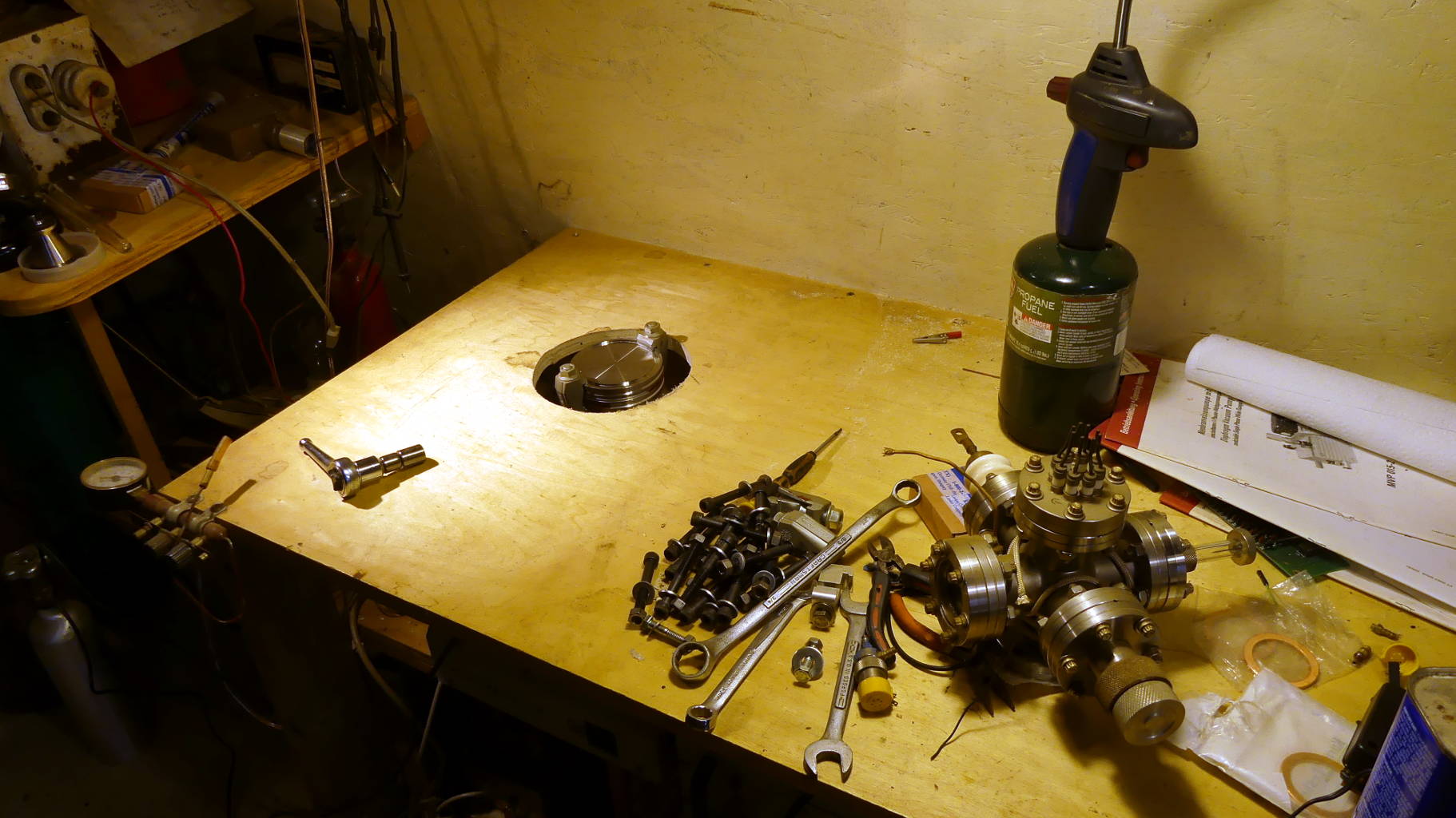

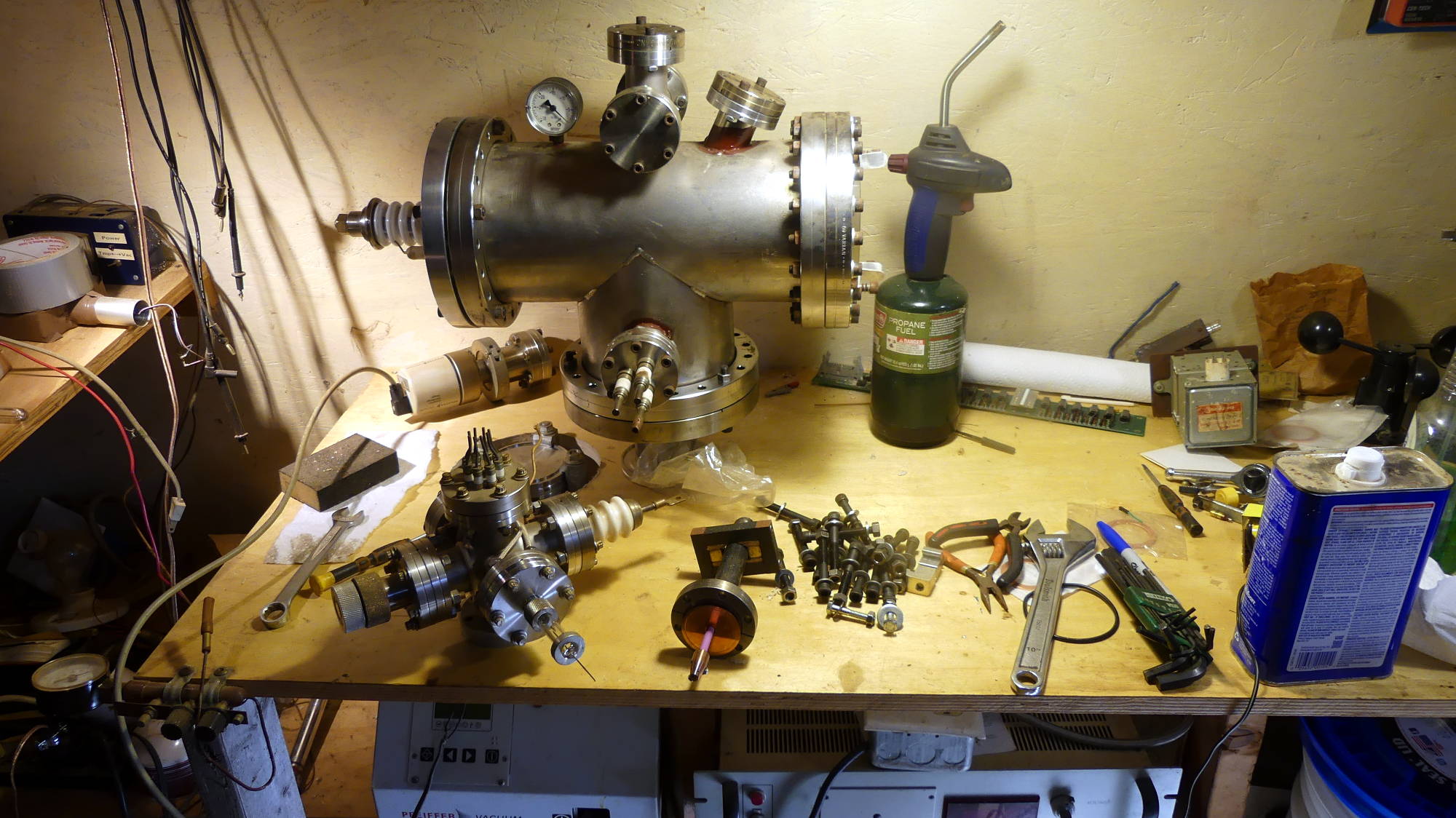

Oh, lookie - there's a new hole in my bench upstairs, and a flange in it that connects to vacuum!

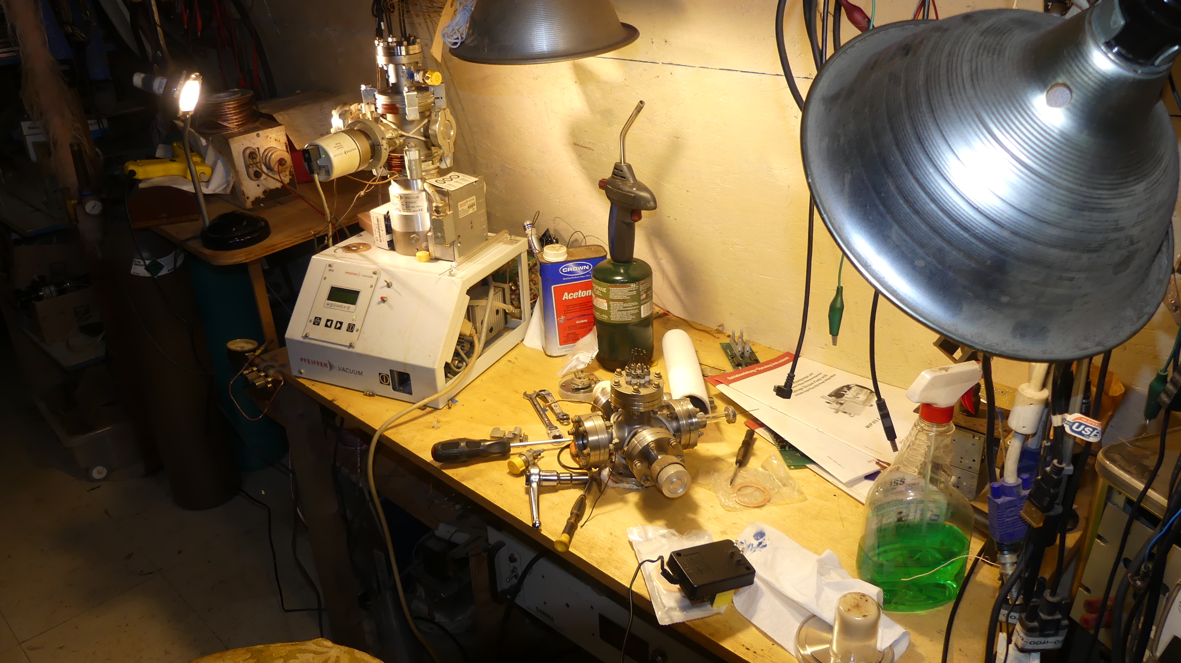

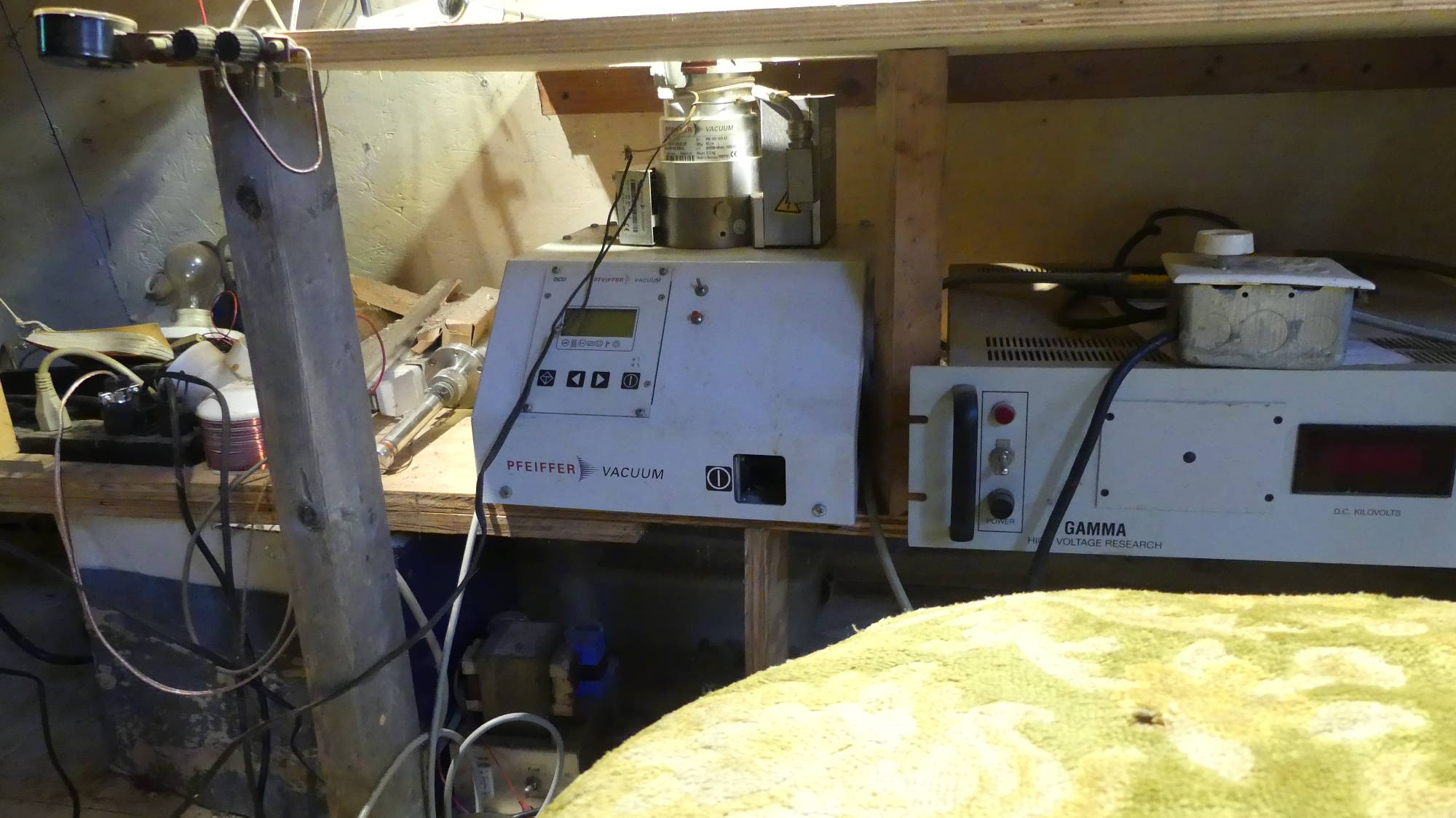

Moved the pump station to the under bench shelf
The pump moved down to the shelf under the bench.
Now at my feet, still convenient.
Which makes room for more cool stuff up at my working level.
Partial mockup.
Partial mockup.
Basically, the adapter to the pump station needs to be welded, and the niftier stuff from the 6 way cross on the bench transferred to what is now going to be the experimental tank, and I may even put in that funny looking thing I built sitting next to the cross. It's a mechanical push-pull-twist manipulator using really strong NdFeB magnets. Not sure how I'm going to do gas inlet. My sub 1 bar regulator is on the big tank and even at 1/3 bar, the smallest pulse of gas I can put in is "too big a chunk" in the big tank - takes about 8 pulses from hard vacuum to get to 100 times where I want to start this set of explorations, and this tank is to say the least, a lot smaller (the big guy is 16" by 30" or so ID). Otherwise, all the right stuff is here, and I do have a regulator with the right type connection for hydrogen, just not a fancy super low output pressure one (and really, I need much lower than the fancy one from Massey anyway - or a truly amazingly small leak valve. After all, I want to start around e-5 or so mbar...that's not a lot of gas. I have the same solenoid valve gas "outlet" between the turbo and the forepump as on the big guy - it's just that this turbo is 60 l/s and the big boy is 512 l/s..

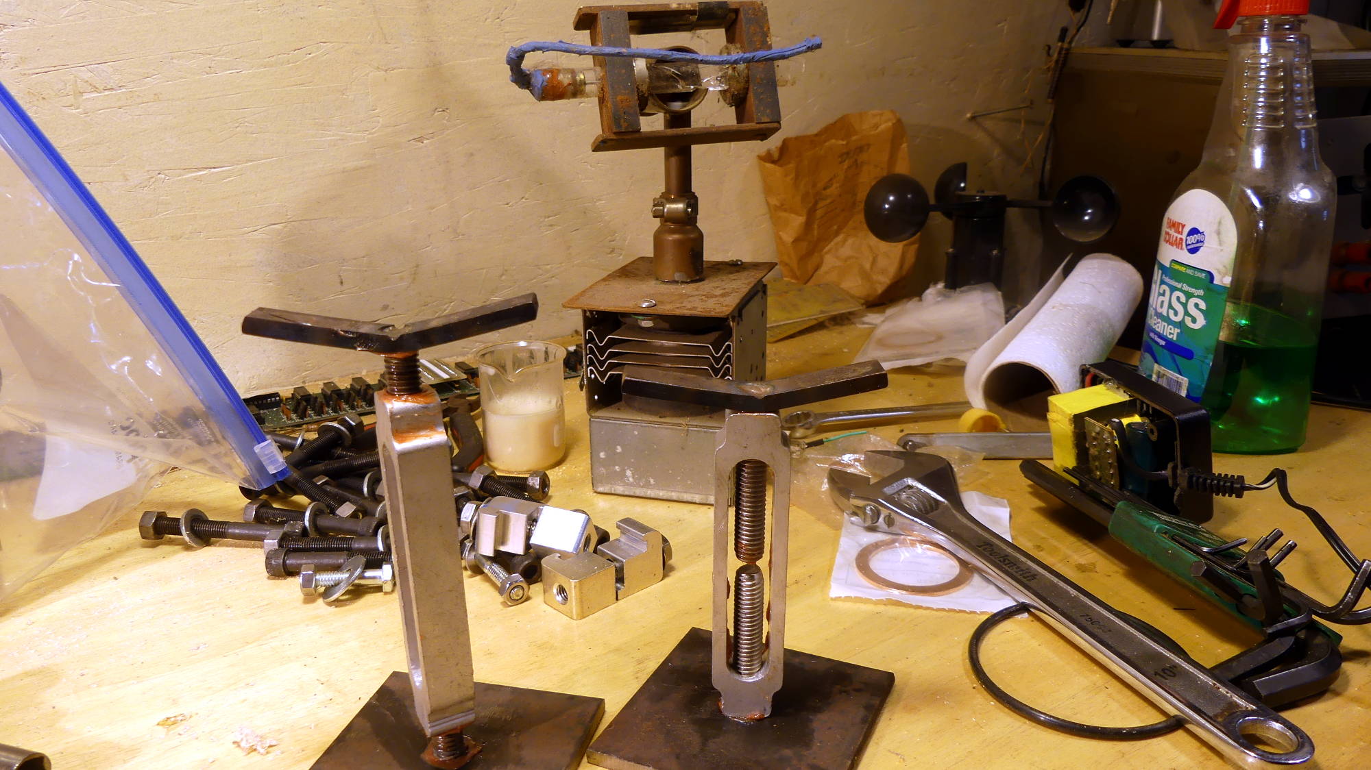

Now, there's no way that little pump station is going to be happy holding up that Tee, which weighs in the "bag of concrete, will not lift willingly" range. So, while waiting for consumables and looking for an excuse to practice TIG welding before doing the all important adapter - I modifed a couple of turnbuckles that had been hanging on a peg here for nearly a decade, cut the chain hooks off the end, and TIGed on some metal to make little vacuum oriented machinist jacks, so the weight of all those 8" flanges etc can be mostly supported by the table instead of the turbo pump mounted on the sheet metal top of that pump station.
These can go under the ends of the tee and hold most or all of the weight.
