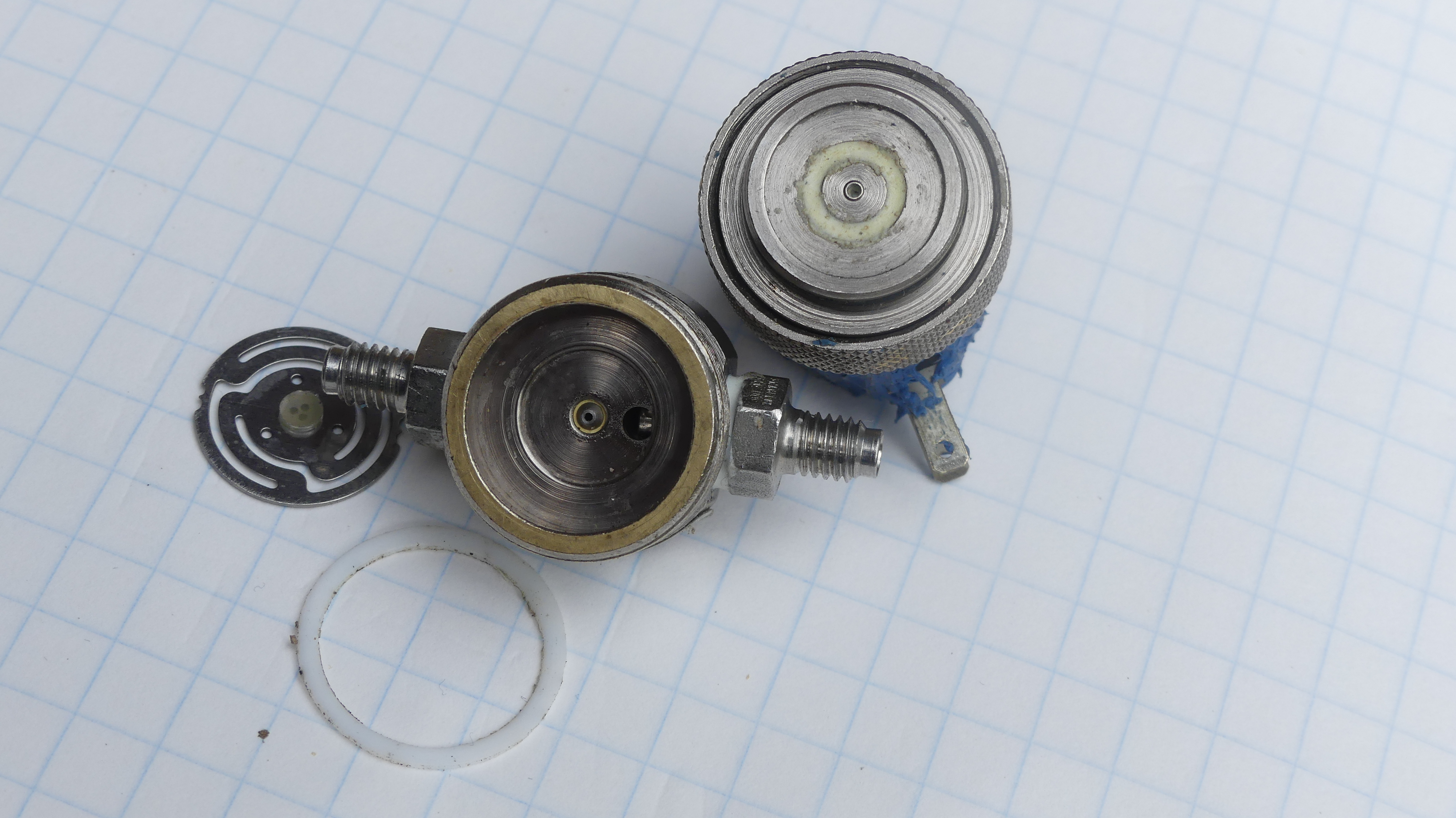

This is the inlet valve I plan to use - substantially the same as on the big system, with a little more tweaking.
The pieces, partway through the modifications.

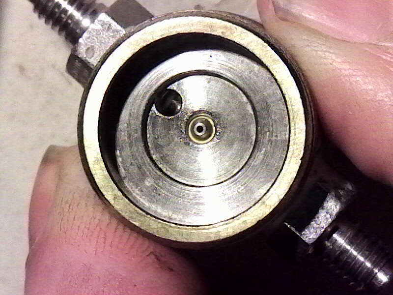

This is a surplus piece that was used originally with single acting small air-hydraulic cylinders. A solenoid pulls a disk with a bit of rubber in the middle off of a tiny orifice, connecting one port to the other, or at least that's how it is now. The air cylinder used to be on the side of the body cavity, and that hole in the middle of the solenoid (on the right, above) vented to the atmosphere to let the cylinder spring collapse again. That hole has been plugged for this use, and the normal operation direction reversed, so the supply gas is on the body cavity side, and the vacuum system connected to the other end of that small orifice. The orifice sits a little proud of the body, so the rubber seal can form around the valve seat a little without interfering with the body of the valve.

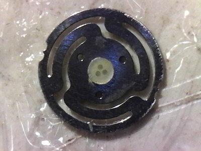

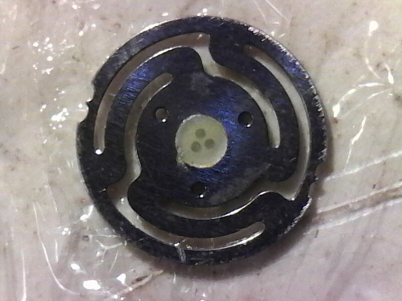

In making the mods for a new one, I noticed that the rubber seal formed on the disk had not only become hard in storage, but that a permanent indent, a little off center, had formed. This meant that taking the valve apart and putting it back together would pretty much always make it leak, even if it was fine before (leak hunting in vacuum systems is fun, just keep telling yourself that).
So in this modification, I replaced that with a little piece of gooey LDPE glued on instead. The glue isn't strong bonding, but here the joint is under compression from spring and pressure drip almost all the time, and only needs to hold the weight of that tiny bit of plastic when the solenoid pulls it off the seat, so I think that will be fine.

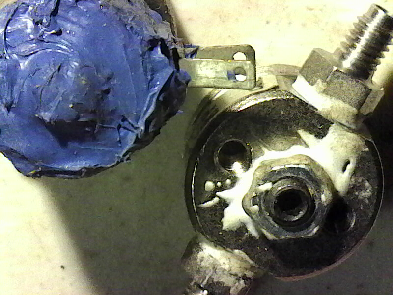

The other issue is leakage across the O ring seal between the top and bottom pieces. It's already got the fattest O ring I could find at McMaster-Carr that would fit, but it seems a little porous. A 10cc reservoir and gage leaks up to atmospheric from vacuum in a few days from that as it is now. I made a PFTE ring to be a gasket there, and since that spot isn't fixed - gap, may have to go to blue permatex silicone to really get both sides leak free - after all, there will be far more gas in even a capillary supply line and whatever cavity on the output side of the regulator than an entire fill..I'd rather not waste it.
The solenoid center post was originally sealed via another O ring, but never did have to handle any real pressure drop and a bit of leakage didn't matter. That white ring is Hysol epoxy.
The blue stuff is "sensor safe" permatex, one of the only silicones that can work in this sort of application - it's not the acetic acid cure type that creates corrosion, and in tests, has negligable vapor pressure once cured - systems I have it in easily get below 10-8 millibar.

Here's some closeups of the parts. I got a bag of these from Burdin's surplus center for a couple bucks each. The 1/4" orifice solenoids I use on the foreline side of things are everywhere and cheap.
I think the ones I got were originally for refrigerant from heat pumps.
The spring diaphragm with the new plastic seal
The valve chamber, orifice is in the middle, the fittings are 10-32 threads.
The ugly sides.  Various leaks plugged with sealants.
