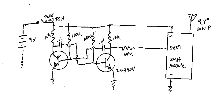

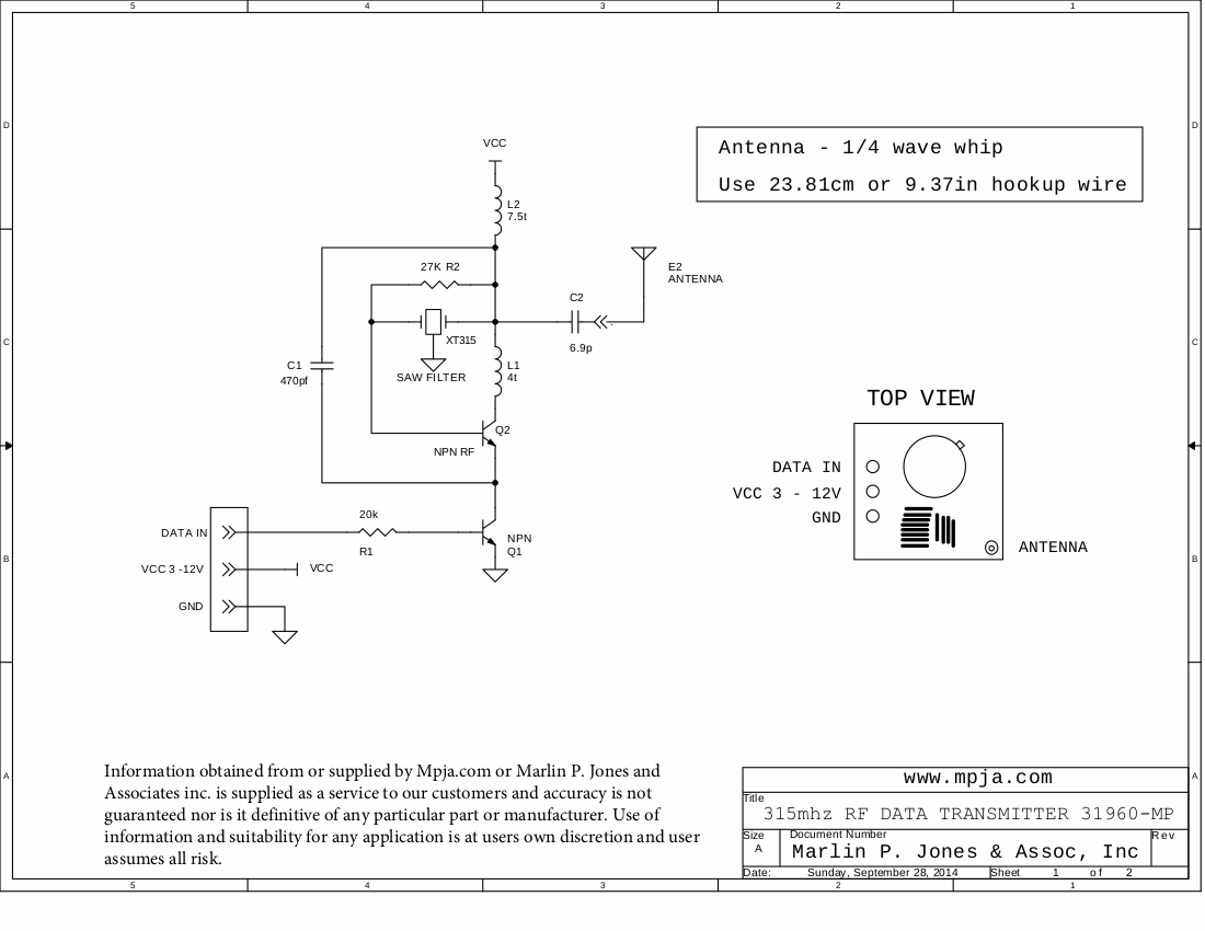

Here is the transmitter circuit.
Simple power oscillator with on-off modulation
Basically an AM transmitter with on-off control. I'm running it from a 9v battery here. Current drain is on the order of 10ma when operating CW. Due to issues in the receiver, this needs to be modulated to provide a signal that can be reliably told from the noise at the receiver end. There are a ton of ways to skin that cat, but I was out of 555's and didn't want to get complex, as in an Arduino Uno clone. I also didn't want to have to come up with a stable frequency if I didn't need to, and use special components to get there. So I settled on a really simple discrete multivibrator. This does produce a somewhat variable frequency depending on supply voltage, temperature, phase of the moon and so on, but for this that's fine.
Unlike some other possible oscillator circuits, this one swings right down to ground, so it'll turn off the transistor in the modulator fully.
simple...just make some predictable noise
Parts are:
a couple of generic NPN transistors, I used 2n3904.
10k collector resistors.
100k base bias and output current reduction resistors. You don't need the 1% ones I used - I buy the stock values in bulk and they are super cheap.
.01 uf tuning capacitors. This gives around 650 Hz output, it's not critical in this design.
I didn't even use any power bypass caps - a little noise makes it more likely to reliably start oscillating. I'm switching this on and off with a standard alarm system type magnet and reed switch pair, placed so the mailbox door opening turns on power. This is the opposite switch sense from most alarm uses, as for those, the circuit is closed until the door opens. So look for a switch that allows that, for example: https://www.amazon.com/Magnetic-Switch- ... 583&sr=8-5
The range for these is listed as around 200 meters. I'm betting that double that is easy, based on signal strength measured via my RTL-SDR. If you know RF, just do the antennas marginally correctly for 1/4 wave whips over ground and you're going to be good. As used here, at something over 100 yards and with an intervening small hill, it overloads the SDR using rabbit ears on receive.

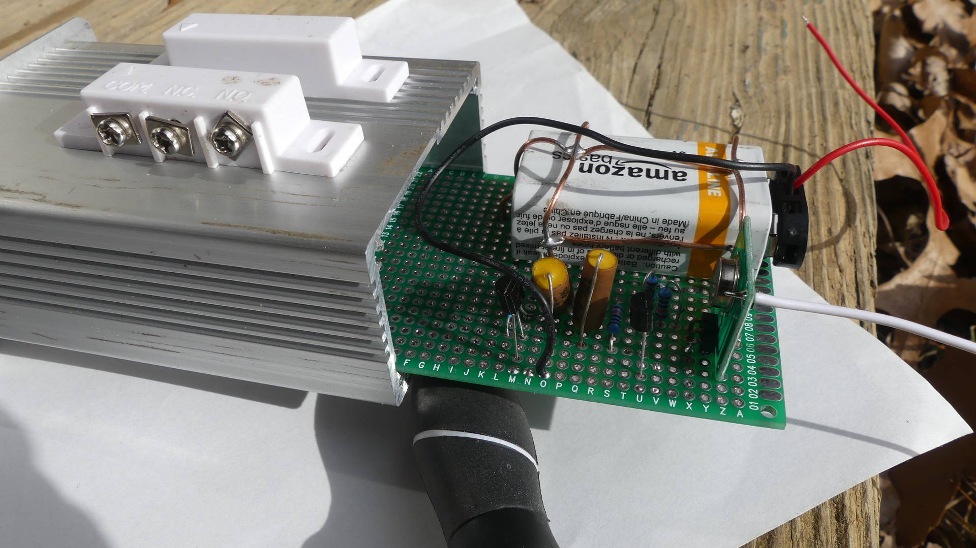

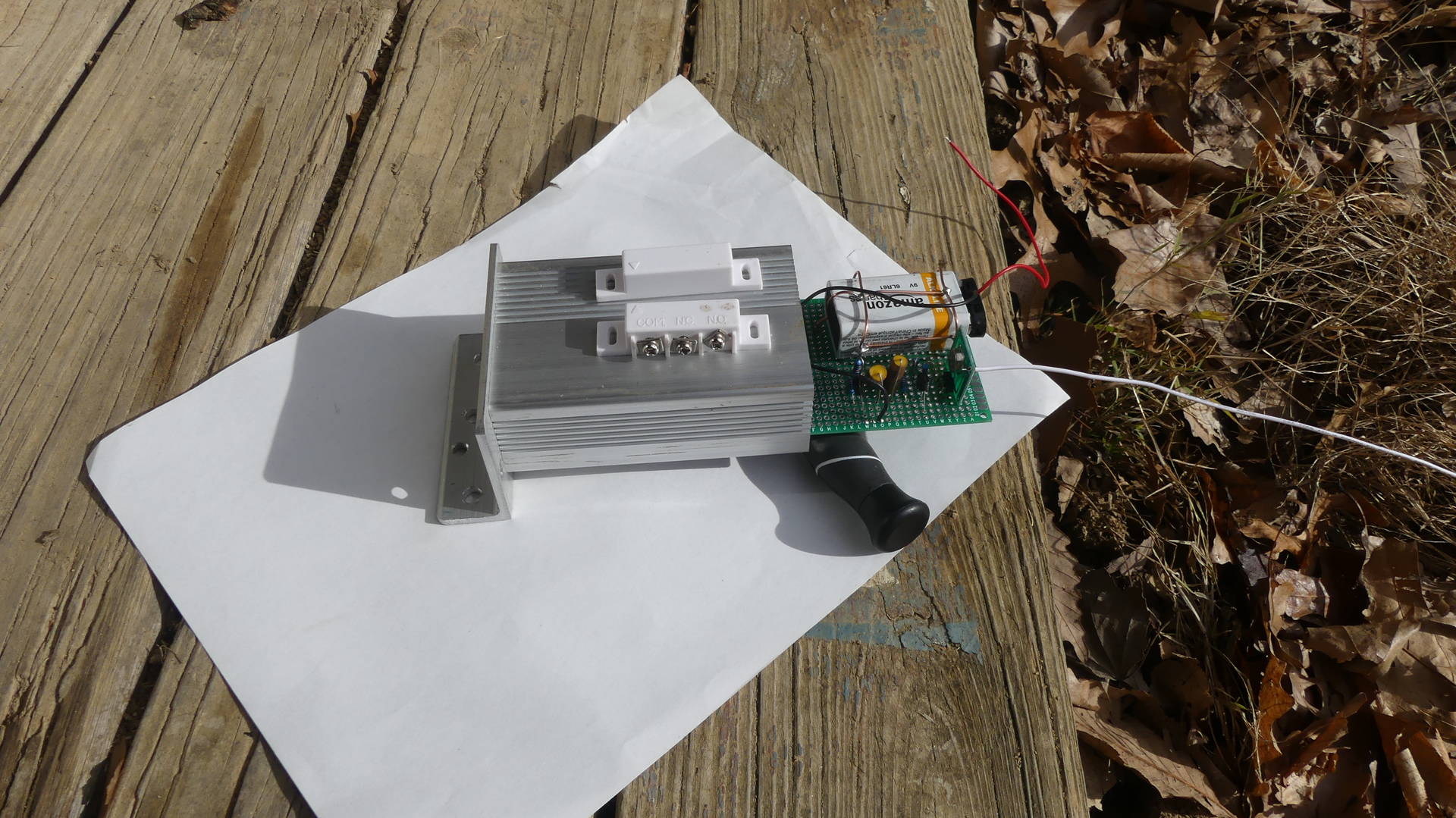

Some pix as it is. I used a nice box from Marlin Jones, which happens to perfectly fit a standard perfboard I got cheap from some Chinese vendor at Amazon. I made a bracket to replace one end so as to mount this up under the mailbox out of the weather. I made a little battery guide for the tight fit.
Ready to deploy
Ready to deploy
The antenna is that white wire coming out on the right

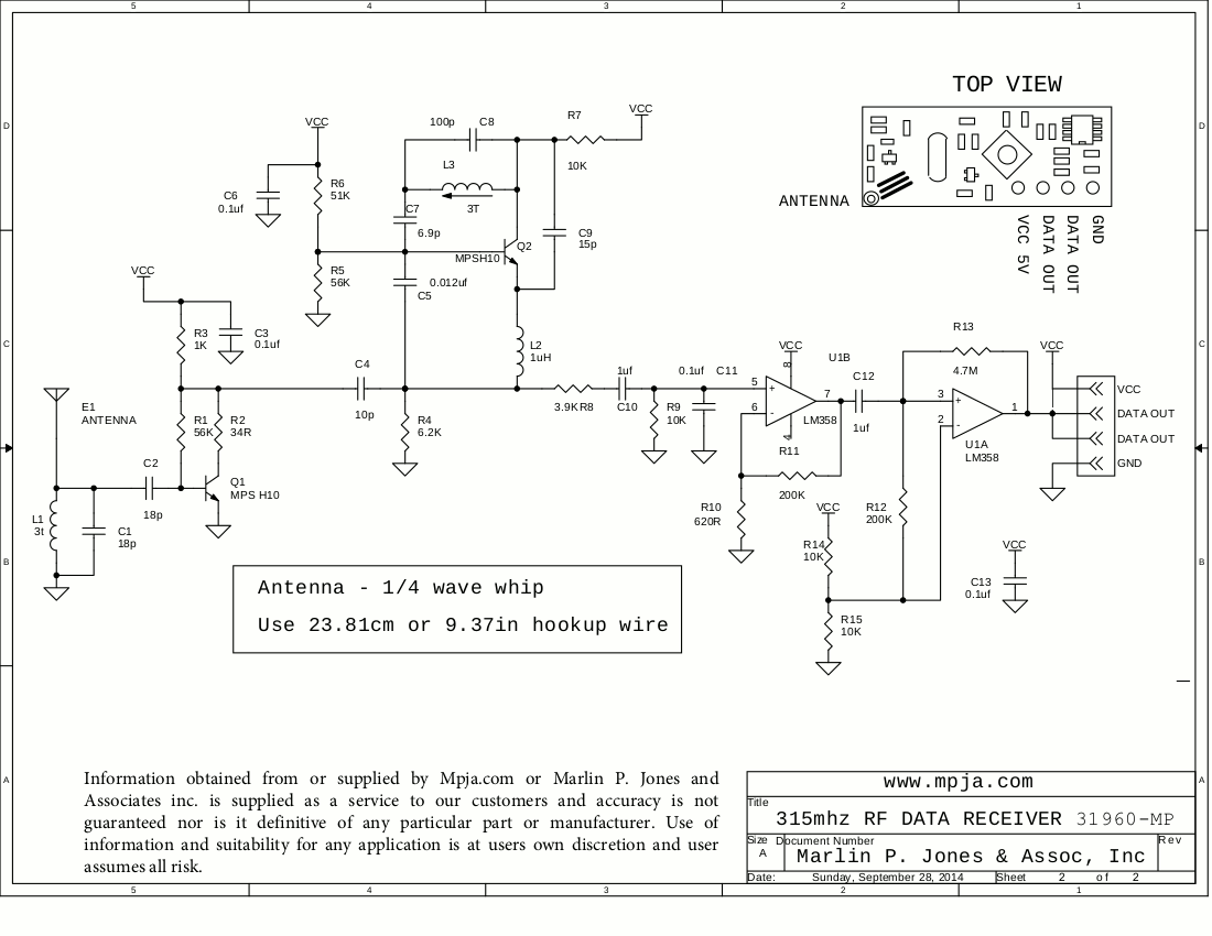

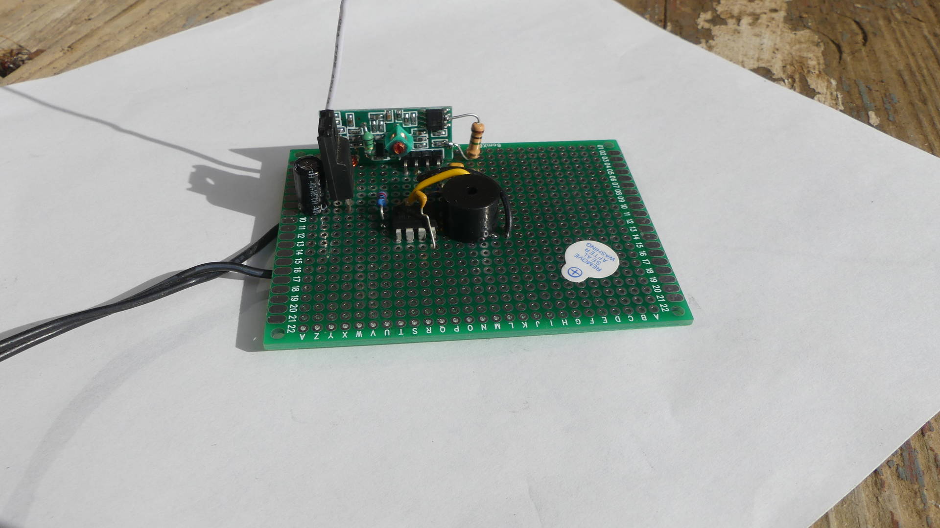

The receive side of this is a little trickier. The module is an RF stage, then a super-regen detector, followed by a gain stage that is AC coupled, followed by a comparator with a little hysteresis, also AC coupled. The net result is that as-received, the output toggles randomly when there's no (deliberate) signal present. There are a couple of ways around this, read on.

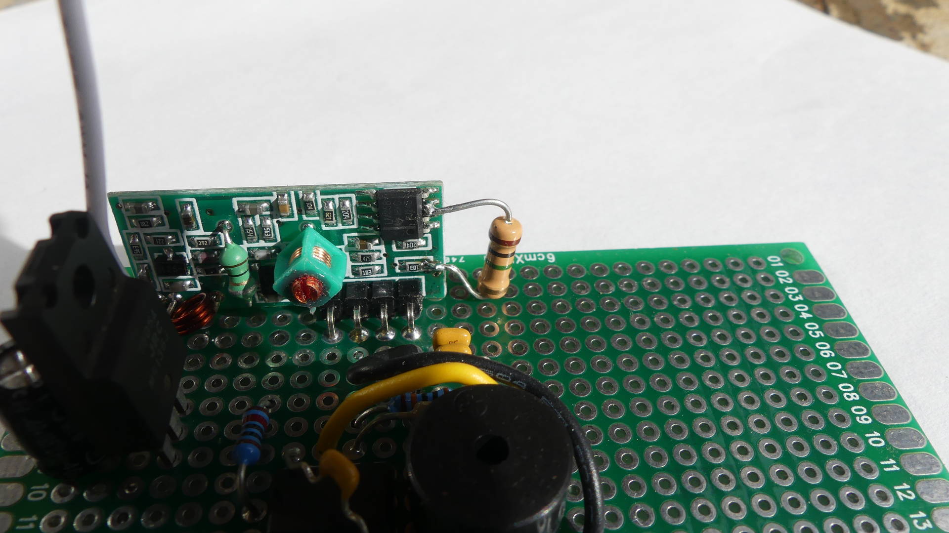

Here's what's on the module:
As-shipped to me.  This wants a 5v supply.

Plan A was going to be putting in a filter tuned to whatever the transmitter modulation frequency was. But that didn't work well unless the Q got pretty high, and then the drift range in the transmitter end would push it out of band sometimes. That thing is outside in the weather, on top of having a variable supply voltage - without a lot of effort, it's not going to be real stable.
It could be that adding more hysteresis would keep it stuck in one state with no signal, I didn't try that. It's not obvious what state it would stick in after the capacitors charge on power up.

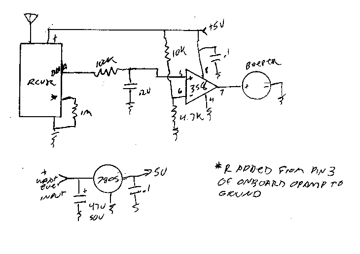

So what I did do is to bias the comparator so that it rests in the low output state with no signal. It still toggles, but rarely enough that some simple post processing handles that case easily.
The bias is added via putting an additional 1 meg resistor from pin 3 of the onboard opamp to ground. I didn't have a cute tiny one, but even a big old tech one managed to fit and cling on there.
Following the module, I added a lowpass filter of 100k and 2uF to ground, which averages out the little bit of random toggling in the no signal case. In looking at this signal, I (re) discovered a quirk in the LM 358 opamp - it has a slightly strange output stage, being one of the first "single supply" opamps out there, and this stage doesn't pull to ground very well at all. The result is that with this load, the one on the module acts as if there was a diode in series with the output - the capacitor in the lowpass filter tends to charge up to a couple of volts when the output is toggling with a 50% duty cycle!
Well, then, the rest is simple - just put another comparator on the output of the lowpass, and bias it so that it fires when it sees that couple of volts. That stage can then be the real output, and here I just hooked it up to one of those 5v sounder parts - which in fact is almost all the power consumption of the thing. If you wanted lights or memory, you could add a flipflop so that the output going high would clock a one into it, add a LED and a reset button... But I don't think I need that, I mostly need to know the box is open when I'm home anyway, so I'll go get the new goodies, help the mail lady carry that case of V8 and soup they shipped all in one box...whatever.
Since this is for my living room, I just added a 7805 series pass regulator for power - there's already a power supply for a basement vent fan in that corner of the room, so I just piggybacked on that.
The quiescent draw is in the 10 mA range, going to around 30 mA when beeping. Most all of the 10 mA is the regulator itself. The square wave oscilliator in the sounder thing makes enough noise that it can latch on ... so this one did get a supply bypass capacitor.
Here's the buzzer I used: https://www.adafruit.com/product/1536 These are loud and annoying, which is fine for this. It's not like the mail person leaves the door open all day.
The schiz - KISS!

Added 1 meg resistor - sloppy but effective
This can just lay in the corner under the coffee table, no fancy package required.
