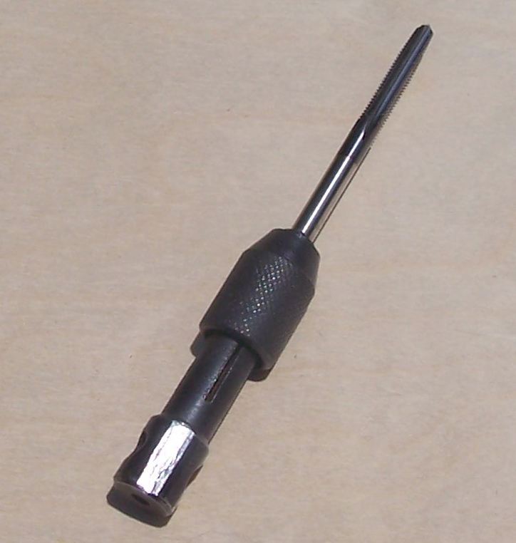

Make a special loose tap holder. I took a hardware store one, removed the cross bar, and ground three flats on it so I could chuck into my Makita or Ryobi battery drills. You want a little play here, so you won't as easily break off the tap if you hold the drill a little crooked. You can then see how to hold to get a straight tapping job as it goes along.

Attached find a file of drill sizes correlated to taps, and a picture of the "special" tap holder that makes this all work. Since the taps have a square end, I don't tighten them into the tap holder all that tight -- you can usually pull the drill/holder right off a stuck tap with no damage to anything. A little play is what makes this trick work. That is a 10-32 TiNC coated tap there -- don't use a TiN coated tap on Al, it will bind -- use the carbo-nitride or plain tool steel for grabby stuff like aluminum.

Picture of quick tapper tool
