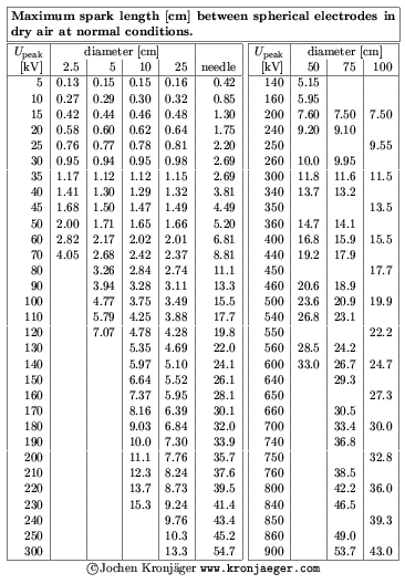

Will this work for finding out out Distance Vs Voltage?
Thanks, Bill Washburn
Re: Measuring high voltages
Ah, the (in) famous table. It's ok as a last ditch measurement technique if you have no other choice. Dumb things like surface finish topology at tiny scales, humidity make this vary around a lot, but it will always or nearly always get you within factor of a few -- if there's a bunch of series impedance in the supply, that will affect whether a corona streamer can go to a spark or not if the R is high enough to drop the actual voltage at the gap during the streamer. I'll have to do that thread soon on CW multipliers off CCFL, just been too busy with a bunch of other projects to get to it yet.
Digikey and others sell 10 meg resistors, 1/4 or 1/2 watt so cheap it's hardly worth worrying about -- you'll have to order something else to help amortize the shipping. You can use the ones not recommended for HV if you keep the volts across each one down, say 50ua apiece at full scale. It just takes a lot of them, but then you get a lot anyway for not much money.
Without extreme measures you're not going to have a lot of digits precision no matter what, due to things like corona, but if you get it repeatable, that's generally good enough.

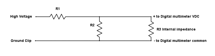

Somewhat of a trivial issue, but something that has been bothering me for a long time - my inability to measure over 40kv.
I have attempted to build a KV probe on two previous occasions, and both attempts have failed with wildly fluctuating and inaccurate measurements. I have finally sorted this out with attempt number three (by carefully following the instructions in this post). The result works great! Here is the schematic:
For R1 I chose twenty 50 meg resistors, each one capable of holding off 5KV. So the entire string in series should stand off at least 100KV.
The multimeter's internal impedance (R3) is 10 meg, and R1 is 1 gig, so to keep my multiplier to a nice round number, I chose R2 to be 10 meg as well. So I guess the total resistance here is R1+(R2||R3) = 1005 000 000 ohms.
At 100kV this should draw 99uA (that is 100 000/1005 000 000), which is a heavier load than I would like, but I could not really afford higher value resistors.

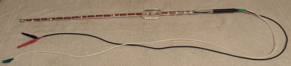

I recently tested the new probe, together with my old probe (which tops out at around 40kV). The two probes track together to within 1% up to 40kv (I have to multiply the reading on the new probe meter by 200 to get the actual voltage).

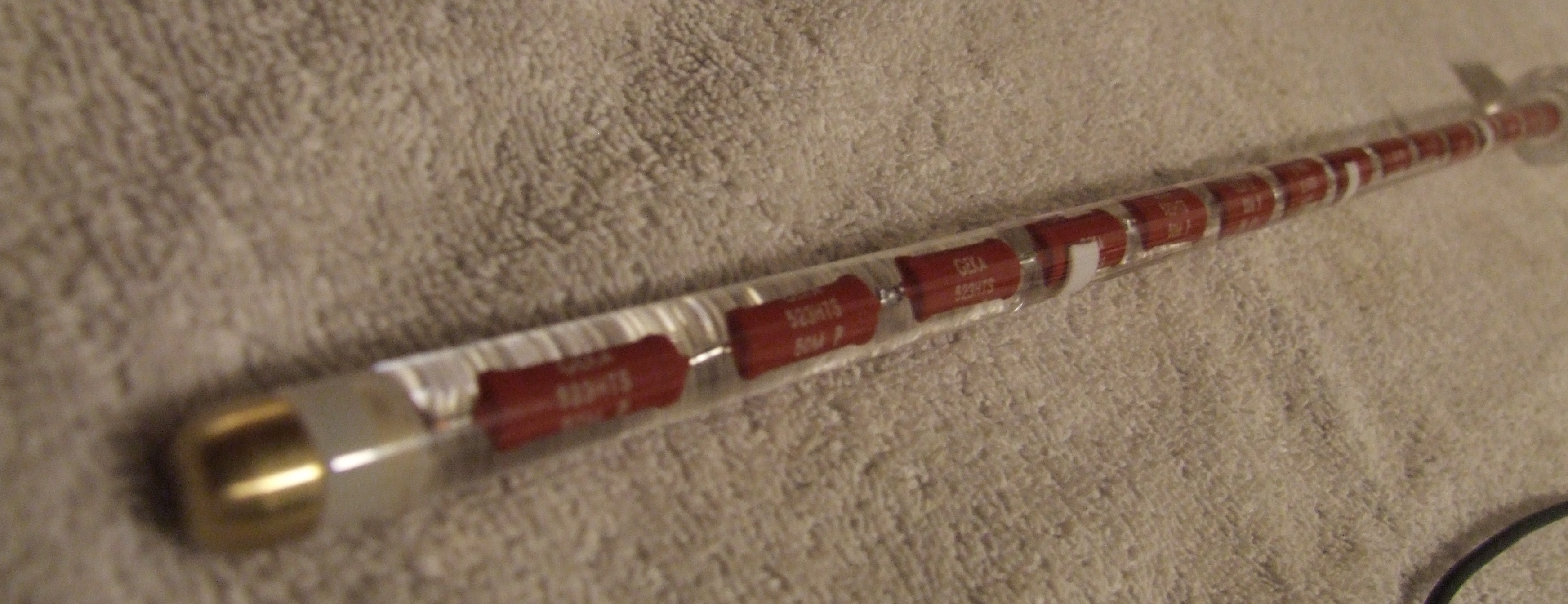

Results = -10 = -2KV, -50 = -10KV, -94 = -19KV, -222.3 = -45kV
I pushed it up to 56kV whereupon corona leakage off the power supply obliged me to go no further, but the probe itself was fine :)

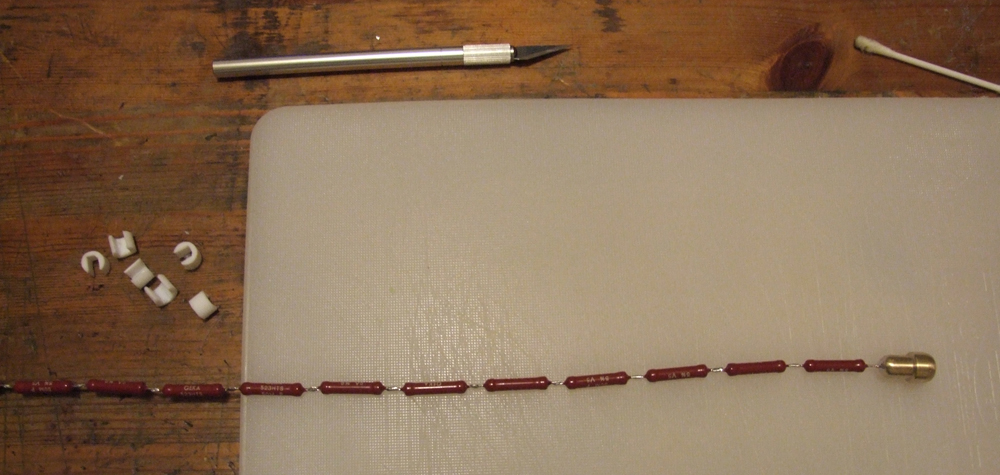

Teflon spacers were added to keep the resistors away from the glass

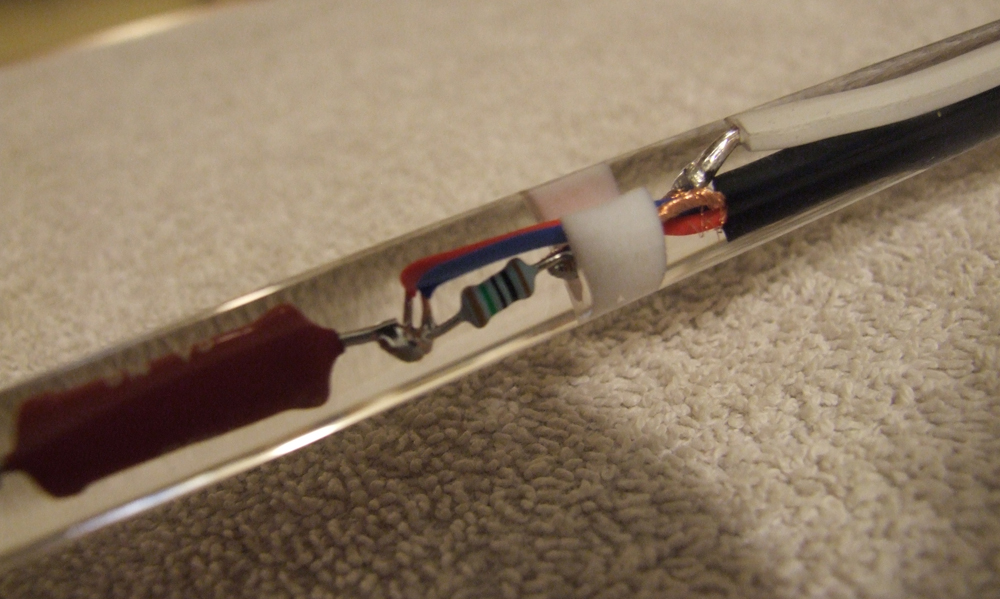

Two lengths of glass tube were joined by an acrylic coupling to achieve the correct length
Probe tip was lathed from brass rod and rounded
Care was taken to keep all solder joints smooth and rounded
Great job Jon, keep up the good work! This really isn't as trivial a problem as most believe.
