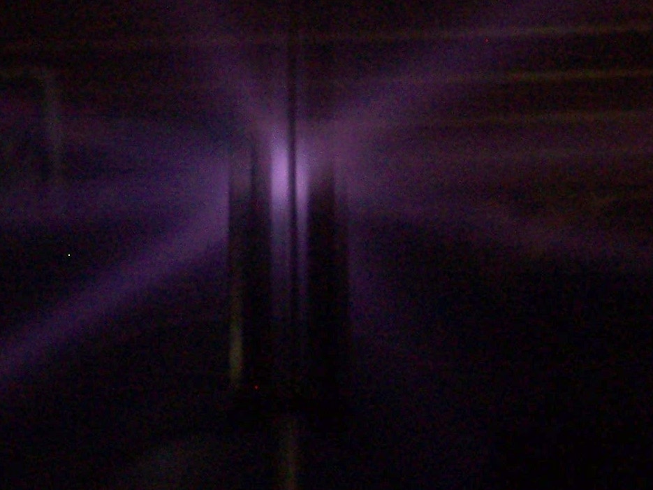

I finally found a way to go though my roughly 3k photos and find some of these, been meaning to put them up here for awhile and comment on the things we've tried, and how well they worked.
So far, it's been a near monotonic rise in "goodness" and I'm going to try to start near where we did and progress to where we are on this thread. Y'all -- add yours too!
I skipped our first nasty looking grid and run that made neutrons, if there's any requests I'll add that one, but it wasn't all that interesting, except perhaps to prove you can make it work "ugly".

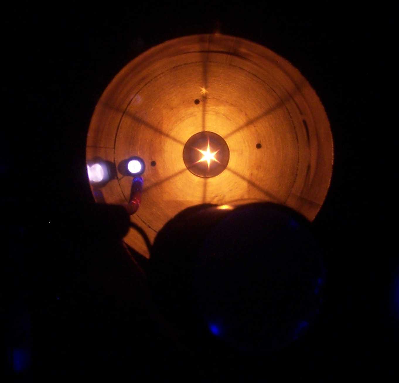

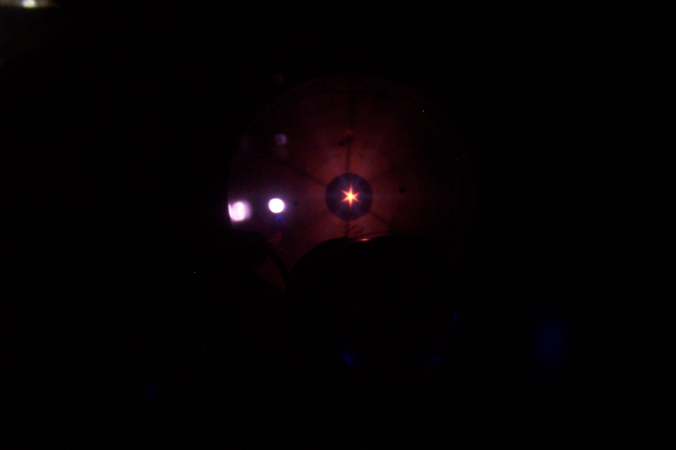

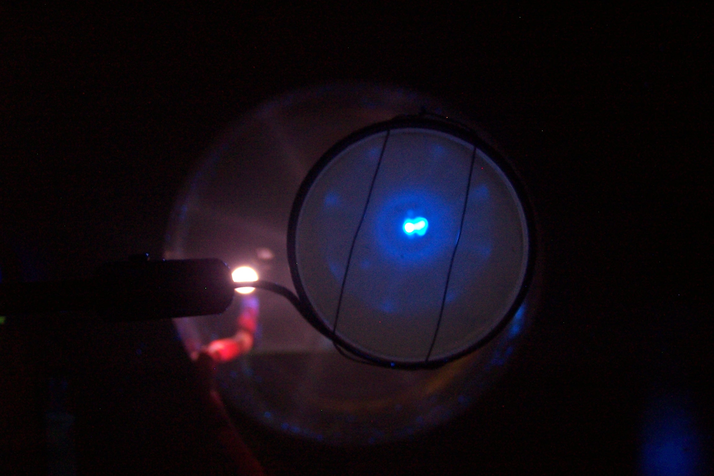

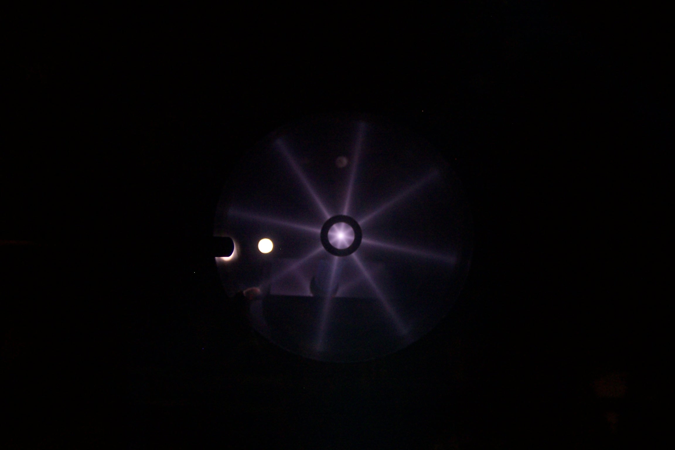

This one shows something interesting (this one is in BillF's fusor). Note the stream of ions coming out of the end of the grid, through an insulator with a big length to hole size ratio.
We have, in effect, pressurized the grid center area, and I'm supposing some sort of pressure or Coloumb repulsion is responsible for this. This run was in He gas, not D, which is how we were doing our testing before we got D in a bottle, instead of heavy water we had to deal with. This grid did make neutrons fairly well, it's about 3/4" by 2.5" and will show up in another picture.

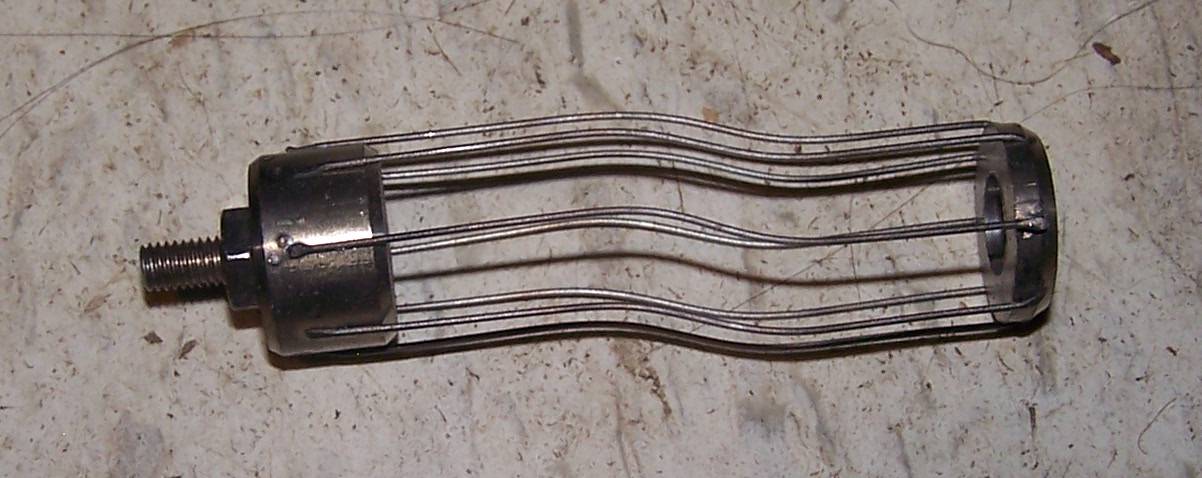

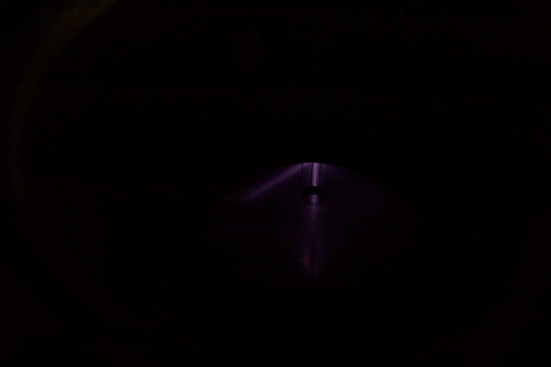

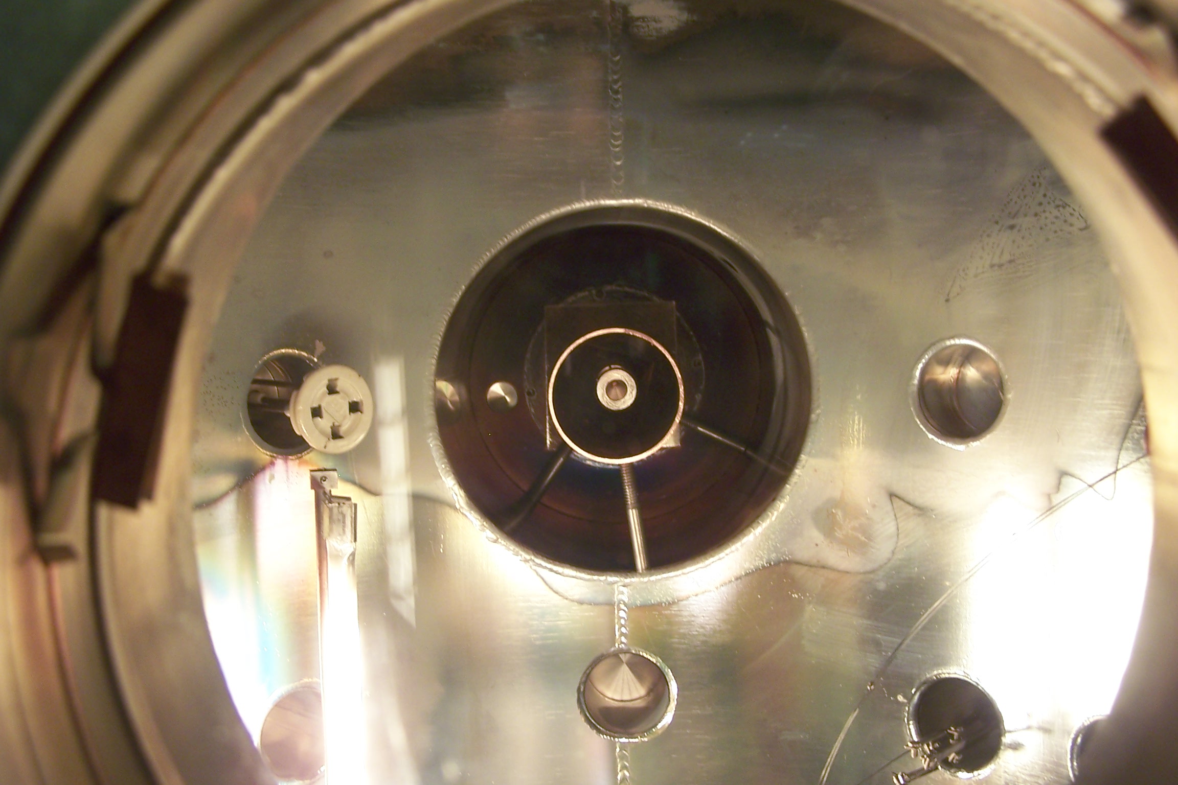

Here's one of our early Ti grids. Trying to brute force things turns out not to be either effective or very wise. Making the end of a bit of Ti rod was dumb, it weighed too much. It took almost yellow heat to make this slump. And by the way -- it still works and makes neutrons just fine.
As we learned, I started focusing on, well, focus, and thought that perhaps something that looked more like an electrostatic lens design would help. Well, sort of. But if you are depending on the normal dynamic equilibrium and whatever ion recycling to happen, it hurts. This is an example of something that will work well with AC drives to make things work out right. This is one vane grid inside another. All is Ti metal, except for some fancy spacers and mountings which need more design work so they don't short when Ti gets sputtered onto them. Very do-able, just wasn't done yet. The idea here was going to be to have the outer grid relatively low voltage -- this way, any ions that hit it haven't had a lot of energy invested in them. Just didn't scale some things right for the conditions. Kept these for later use when I get that nice video amp built up to drive it correctly. Probably the most notable thing in this picture is the window it was taken through. I used the lathe to cut an o-ring slot in a flange adapter, and used a window blank from McMaster (cheap) and a couple of clips to hold the window when vacuum isn't doing that job. Super fast and easy way to get in and out of the tank, and the O ring appeases the tempco force monster just fine.

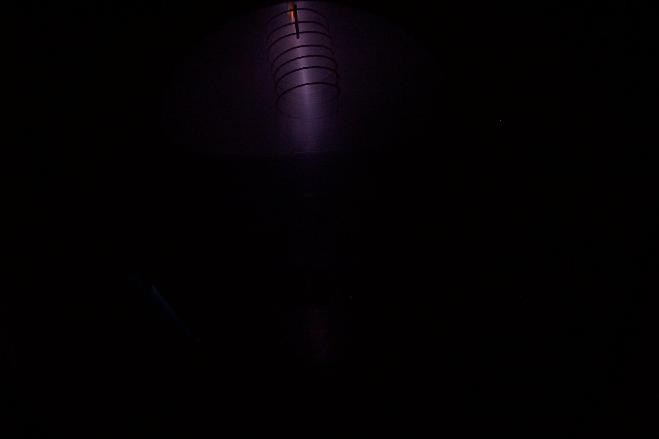

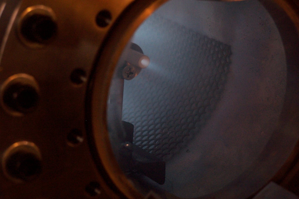

Because owning the lathe made it easy, we tried a spiral grid. This totally stank, and this is the best picture it ever took. Very few neutrons ever came out of this. It also embrittled so badly that I broke it when removing it.

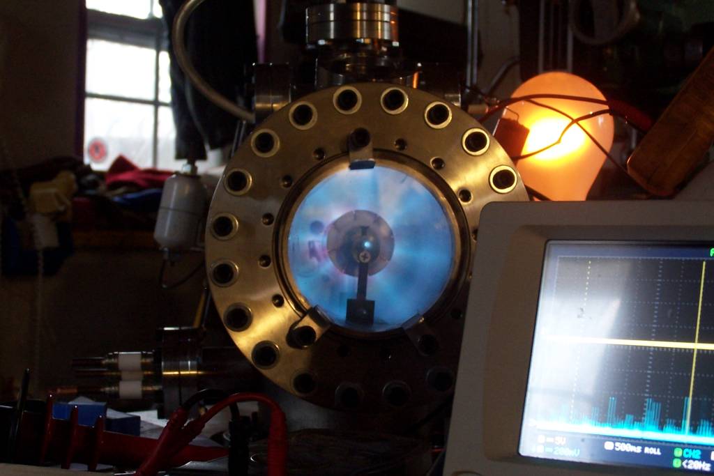

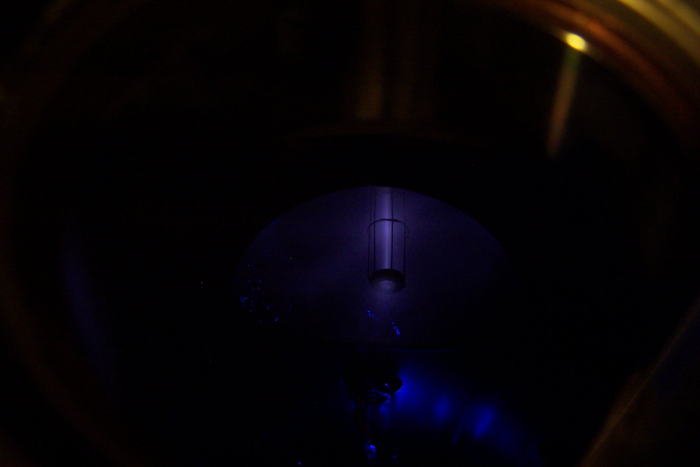

One of the nicer things about the big tank is that all this runs in a sidearm, and I have a lotta windows, so I can get pictures from various angles that show us things I don't see how we'd learn with the spherical geometry. Note the lack of well defined rays. FWIW -- also lack of neutron output.

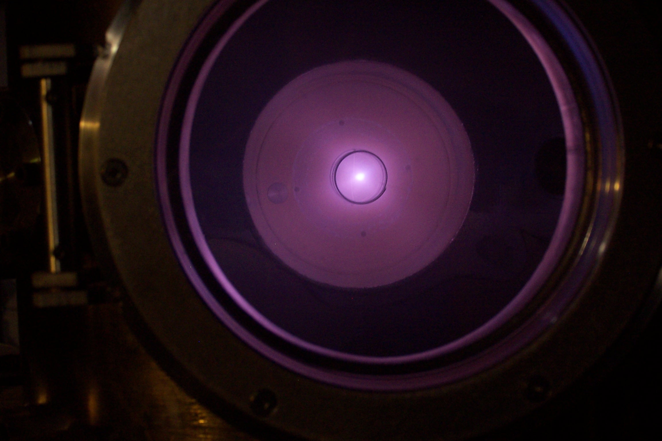

More! We started learning how important it was to have at least decent precision in grids, that Ti was a decent material to make them from, and about what aspect ratio seems best for a good "kernal" for lack of a better word. I still want to try making a really long one and see if I can get more than one kernel, perhaps by dividing it up with a girdle around the middle. But our first try with a girdle wasn't so hot.

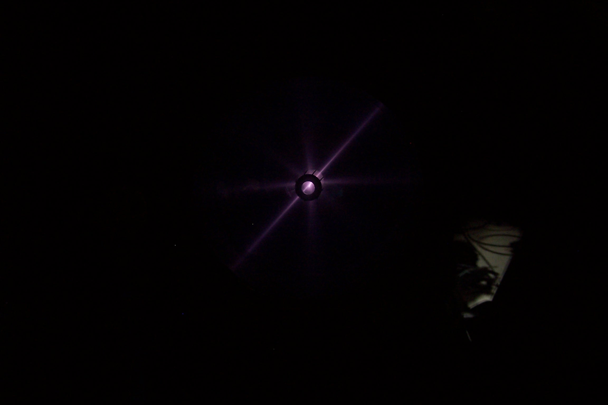

Now we're cooking for real. This is the one that made the "neutron club" certain, and got us about to the point of equal output to anyone over at fusor.net. Sadly, the camera doesn't show just how good this is -- it blooms on the intensity of the core and doesn't show how fine the focus really is on this one. It's about like a mechanical pencil lead to the human eyeball.

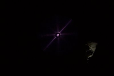

Here's a shot from above. We don't see this much, but obviously the field at the end of the sidearm is a little different from that deep within it. We have found, and this is pretty interesting, that small changes in how far the grid sticks out towards the main tank has an enormous effect on this, and how many neutrons it makes. As in, the whole range of interest is less than 1/10" inch, there's one heck of a sweet spot in there. The theory, and that's all it is (really, just a guess) is that we are somehow taking some advantage of Paschen's law here with the longer path out to the main tank opposite wall...but only a guess. The supposition is that's why the rays aren't coming out at 90 degrees, which they usually do -- this was one of those "it happened once and I got a picture" kinds of things. It hasn't replicated with other grids or other placements. I am guessing that with a cylinder grid arrangement, active drives will be required to actually get a good linear reaction area of hot neutron production, but I need to test that assumption when I get my one pixel neutron camera going before I'm going to sweat this one much. Right now, as both I and Tyler have noticed, the neutrons aren't coming out isotropic at all, from any of our setups, and his is the standard spherical thingie. So we really don't even know where the reactions are, though U of Wis has some ideas there for their own fusor.

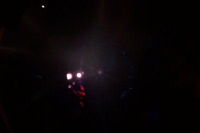

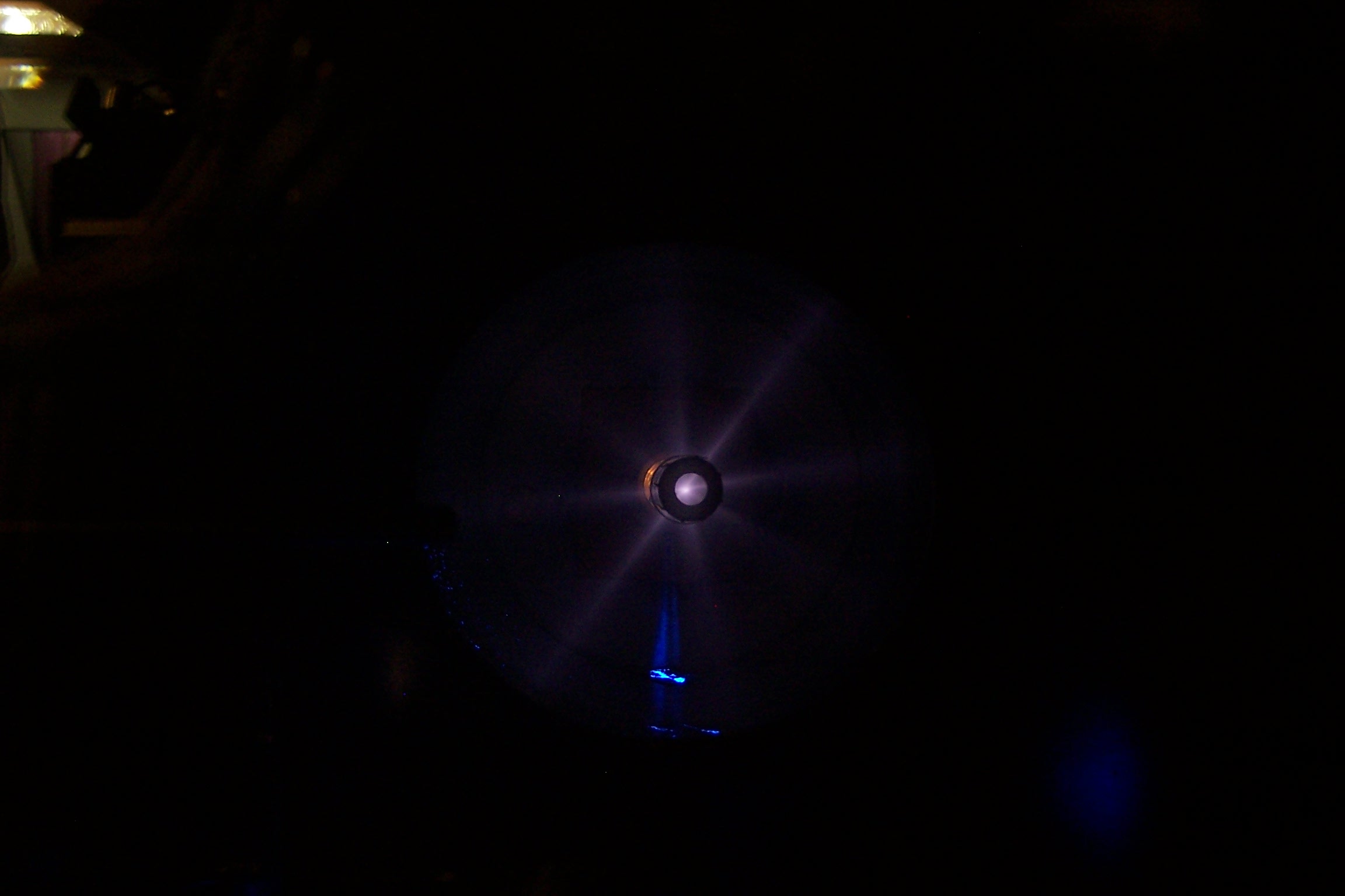

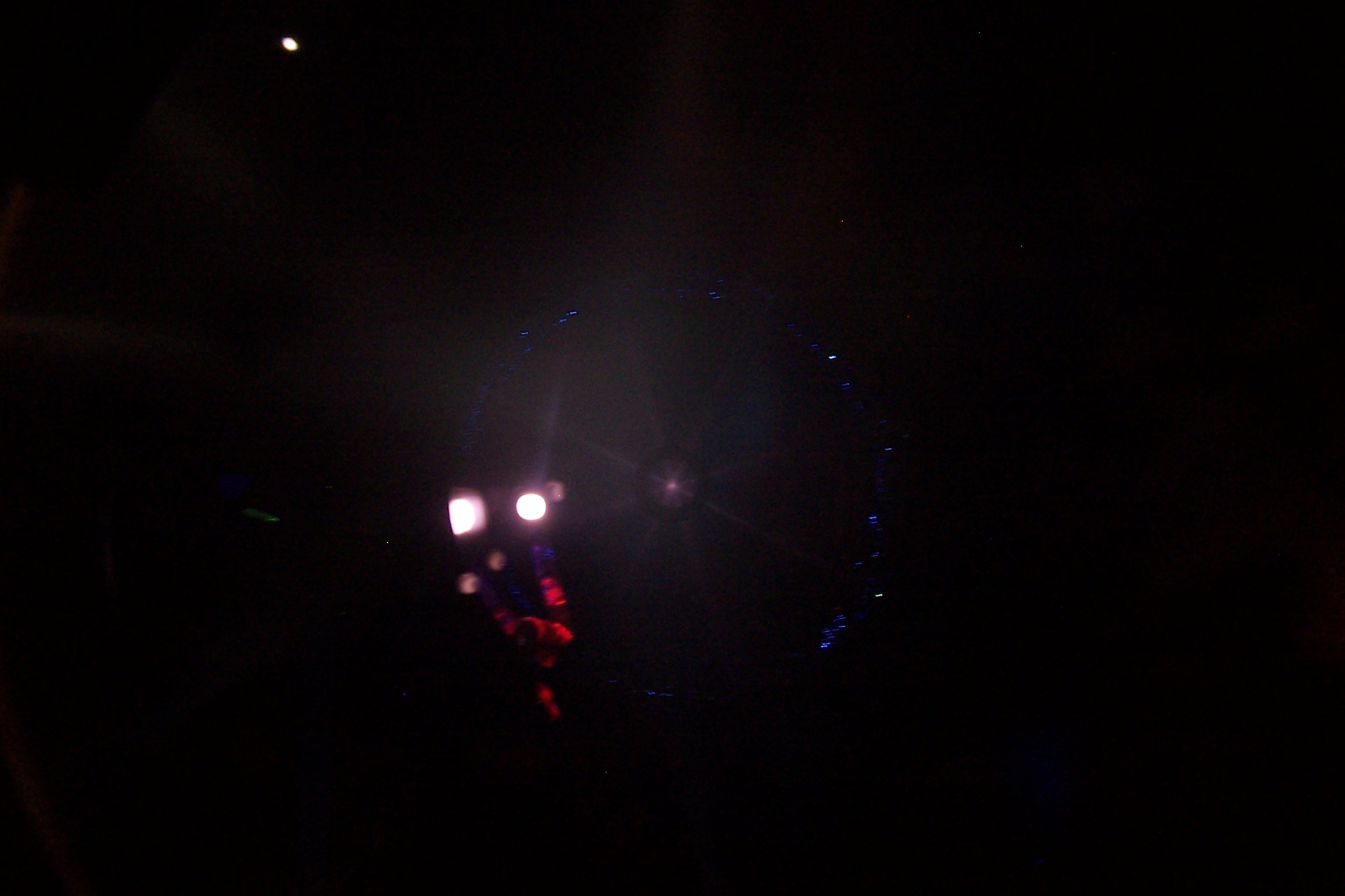

I promised a view of that grid that made the space charge stream in the last post. Here it is in different operating conditions, out in the main big tank (14" ID by 26" high tank).
At the time, we didn't realize a few things, but we've since gone to using a grid about where that one is shown as an ion source, very effective at lower pressures, as it has longer paths for Paschen's law. Note lousy focus and poor evident recirculation (not many neutrons either). This one is pretty long and pretty skinny, I'd expected more action along the length of it, but obviously the rays want to be in the middle only. I didn't exercise this through the whole set of operating conditions, so maybe at the right point, things are different. I've kept this one as I plan another use for it later, as well as the larger outer one that it aligns with.
Just for giggles, we tried adding a wire girdle to a grid, right where the rays normally are. This is the result. Almost completely killed the neutron output! The same grid sans that girdle works fine. And here it is, working fine.

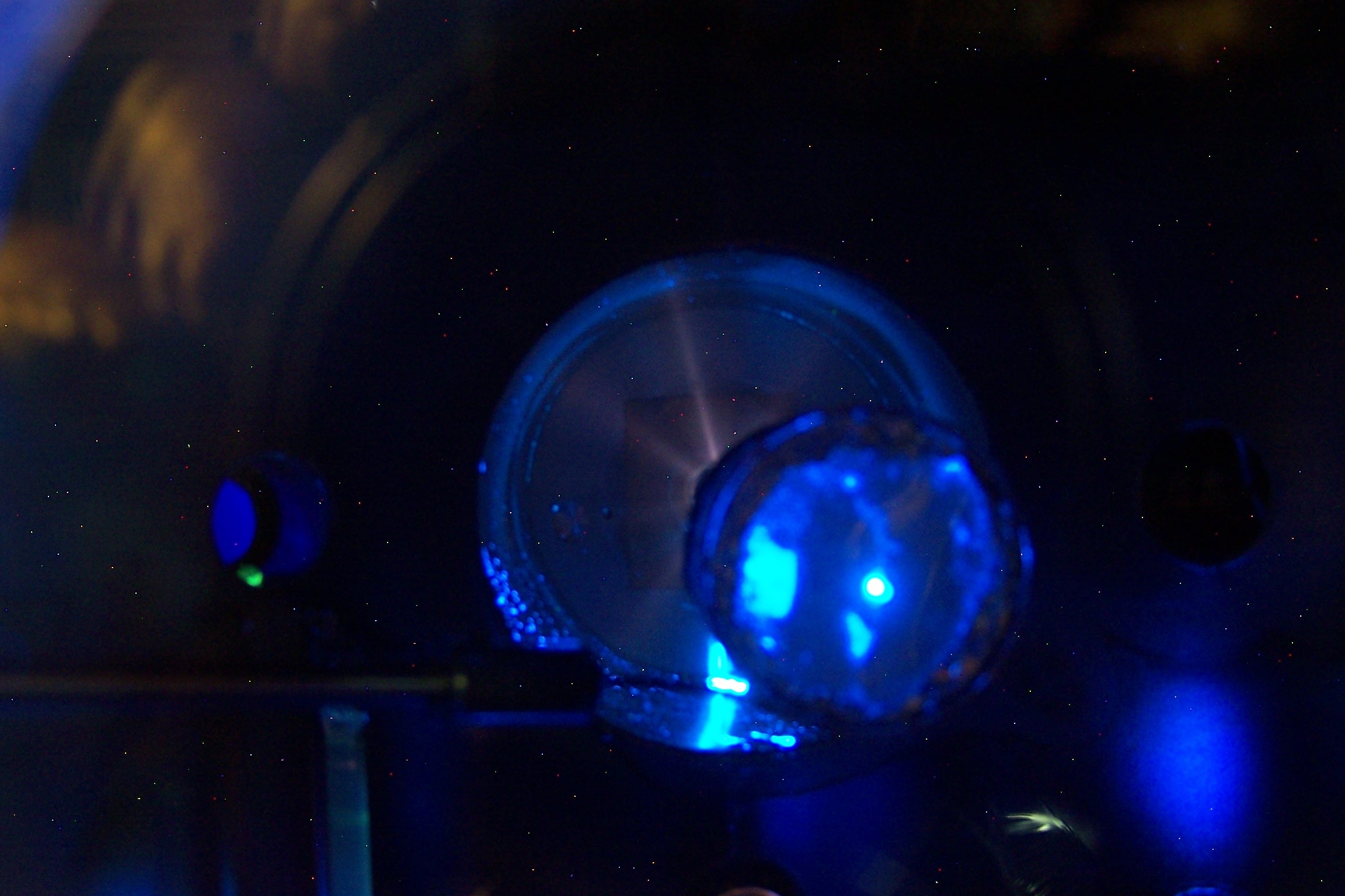

Of course, once we equaled the best amateur fusor output from fusor.net, we just had to beat that, but didn't want to do it ugly (though I have to say the response we got was fairly unpleasant).
We wanted to do it from a basis of really knowing what was going on, and started to get much more serious about metrology, which is still where our focus lies, as we haven't found out anywhere near enough to please us yet.
This helps. We made a pinhole camera, and still have a lot to learn with it yet. I should probably put the details of how it's made on a thread of it's own, but it's pretty simple. We got some ZnS:Ag from Eljen, mixed up some with very dilute sodium silicate, agitated in the beaker, then added about 1 drop of vinegar to make the silicate set, and left it overnight for the ZnS to settle evenly onto the screen, took it out, dried it, baked it, put it in a pipe with lead over one end, and drilled a tiny hole in the lead. It's mounted on a bellows type wiggle stick.
What we don't know that this tool could tell us, is what we are seeing -- charged particles, or X rays -- could be either and is probably both. So I need to add a magnet I can turn on and off to bend any charged particles so we can see what part of the image is what. In real life, this is camera limited again -- the real image is much sharper, but the camera doesn't like this range of contrast. To the eye, the dot from the grid center is much tinier than the one from the ion source seen on the left of the picture (but on the right in the pinhole camera image).
Interesting to say the least. I dumbly soldered on the support wire, and operation melted it off, so it needs repair at this point. Things get real hot in vacuum with no way to lose heat but radiation.
Ok, now we are getting serious. Depending on whose numbers you believe, this grid is the current amateur record holder for output, and by far for Q, and is what's in the tank right now.

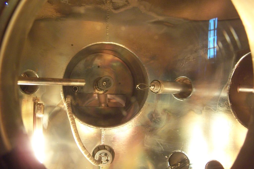

Oops, almost forgot. We did play with the attempt at spherical geometry for awhile, since the sidearm we were running is kinda-sorta not completely unlike a sphere.
This is as good as it ever got, and I doubt it ever made it to 100k neutrons/second. Trying to push it resulted in the next picture.
The trouble with any attempt at a sphere is that "you can't tile a sphere with any simple set of shapes that give equal spacing" which determines focal length of the effective E lens you're making. And of course, at the end of this one, where the wires all come together....the result is obvious. You'd have to at least make a bucky ball to even get close, that's a bit much for me.
