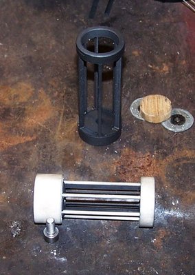

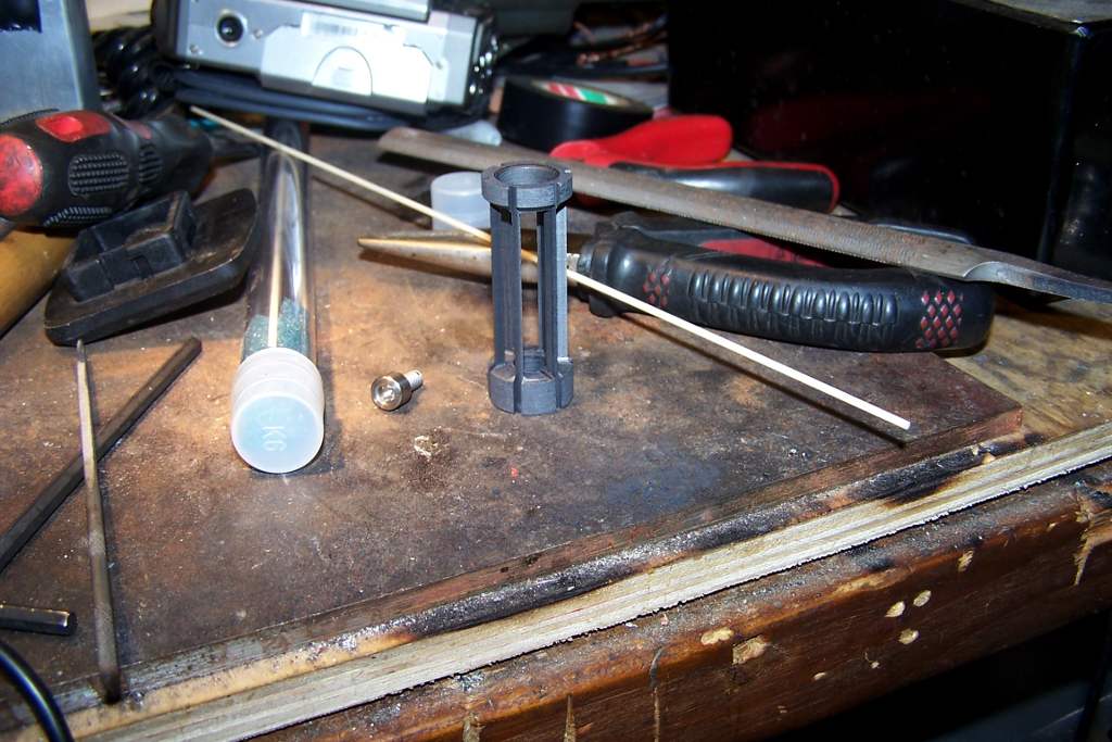

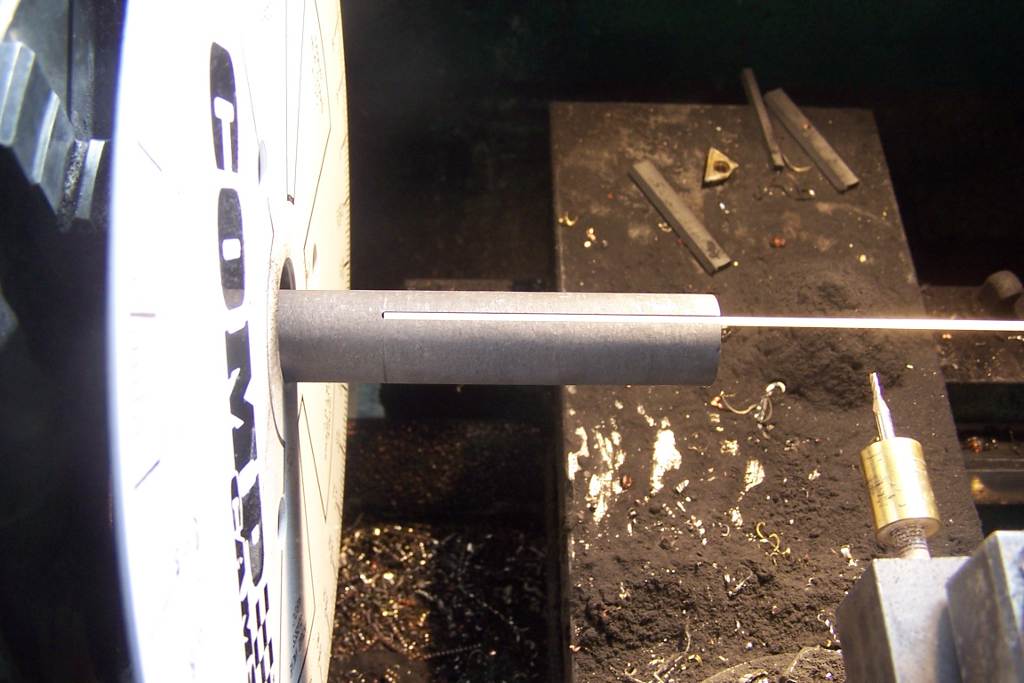

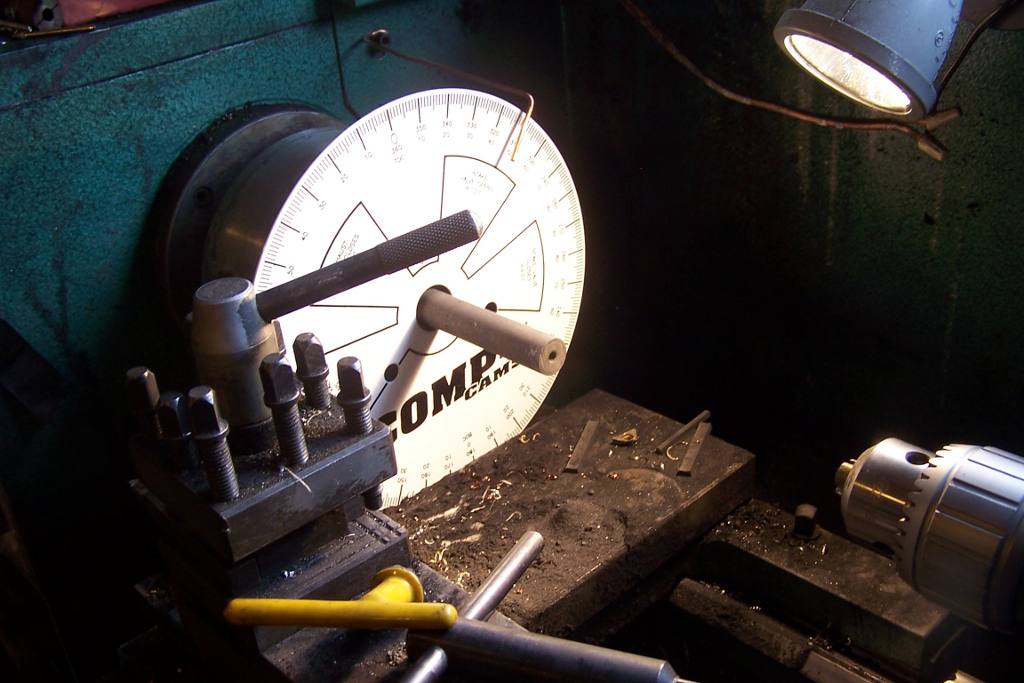

I've been thinking about grid designs as incremental (not revolutionary) ways to improve fusor Q somewhat, as I have found that doing so even in the worst "static" modes, that doing that also helps the higher Q pulsed modes work better anyway, and it's easy to test. I think that electrons released due to fast ion impacts with just about any conductive grid material are most of the losses, along with mis-focus, so improving both grid accuracy and reducing electron emission should help, I believe. Here is what I currently have in mind, and since it's not really hard to try, I'll be trying it fairly soon. Sigh, things never move as quickly as hoped...so the definition of "soon" is a variable here (and everywhere else, it seems).

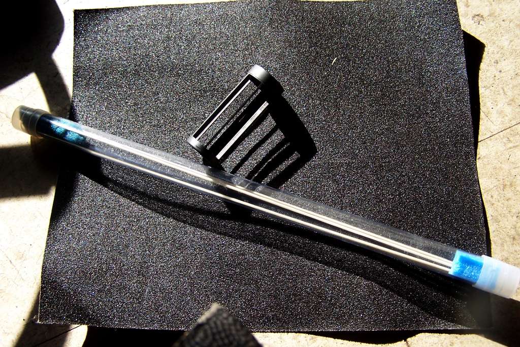

First of all, I've found it's not insanely difficult to machine pure graphite, which has one of the lower secondary emission constants of conductive things, at least when hit by electrons at kilovolt levels -- I can't find data on responses to fast ions anywhere, so there's an assumption that is untested so far. The one pictured has a mistake in it, but I'm going to try it in the tank as my second grid anyway -- you never know what you might find out doing things like that. The mistake is an imperfect symmetry of the vane spacings. Sometimes that helps things, so who knows? I will, soon enough.
Shown next to that are some 1/16" pure alumina rods I got from Accuratus (I have ones half that diameter on backorder, they've got to be hard to make!). The idea here would be to align these along the vanes on the outside around the grid, and cover the inactive ends with larger alumina tubing so there's simply less stuff for an ion to hit head on that is carrying a big excess of electrons due to the power supply input. I'd think that the ions will still see plenty of attractive field from the sides and inside ends of the vanes so it should still work. This would make most electrons released be set free inside the grid, where they might actually do some good, instead of instantly flying to the tank walls to make heat and X rays, or so I'd presume. They'll want out of there, of course, or -- if there's enough positive charge in there, maybe not! Seems worth a try, at any rate under the meme of "try the easy stuff first", so that's the plan.
To make this, I first make another graphite grid, presumably this time without the angular spacing errors (but more on that later*), only first I cut a 1/16" deep and wide groove along the length where each vane is, before I machine out the inter-vane stuff. I could then lay the insulating rods in the grooves, and hold the whole mess together with a couple of tight fitting alumina rings at the ends, which would also get rid of the ions that hit those to at least some extent. The thickness of alumina I have won't hold off the full supply voltage, or so I think, but it may still insulate some, and not so readily supply excess electrons when collided with. Or that's the hope.

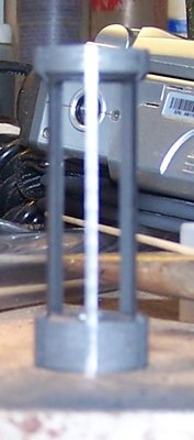

Here I'm hoping that the alumina is a good enough insulator to just limit the current that can resupply it from the power supply with more electrons to knock out, and it's the only insulator I've found that isn't pretty quickly ruined by hot D hitting it. I got the graphite rod today of the right size to fit inside the alumina tubing I got from accuratus, so I'm going to try and get going on building that guy. Going to do that other test we thought of on the fusor first though -- for whether I see lines at 5,6 when not having run fusor main power, as it's easy to do and important to know. Hopefully I had all my other emergencies for the week already, it's been crazy here.
The net grid dimensions should be:
Graphite 3/4" OD, 5/8" ID, with I think 6 vanes instead of my usual 8, because that's smaller than my usual 1" OD and I want to keep the hole to vane ratio similar in the smaller size (should have gotten some ceramic tubing 1" ID, but didn't think of it, and that stuff is very expensive from that source -- 100 bucks a foot more or less). When I ordered it I was thinking of using it as the outer for the feedthrough, but really pyrex works fine for that one, and is cheaper and easier to handle too. You only need the alumina where ions are hitting it hard, which I've figured out how to get with just a little bit of ceramic, the rest pyrex (near ground potential) and quartz (for most of the inner insulator) Just the tip of the conductive stalk needs the alumina protecting it, not the parts down inside the feedthrough.
Pure alumina (vs the stuff that's easy and less than half that price) must be a real bear to make. Without a binder, you have to get it over white hot to make it stick together. I assume that's why it's expensive, as is that graphite (which requires pressure while white hot). The binders in even 94% pure stuff reduce to metals under bombardment. I don't know if there are other substances that are immune or not. Super "hot" H is a pretty good reducing element.

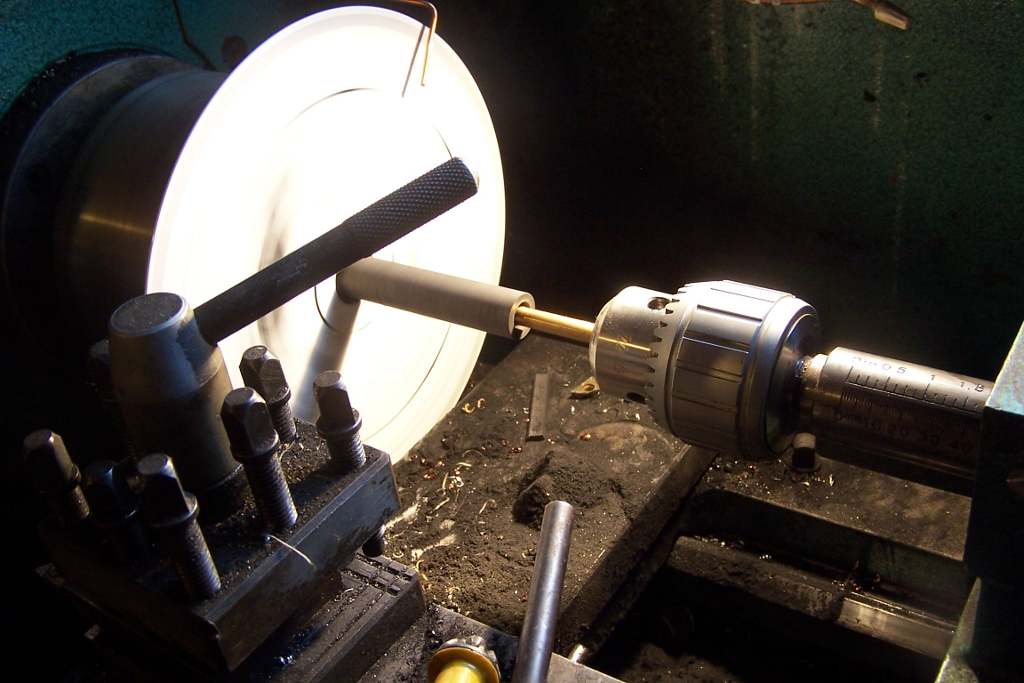

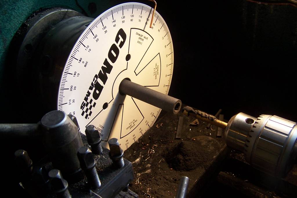

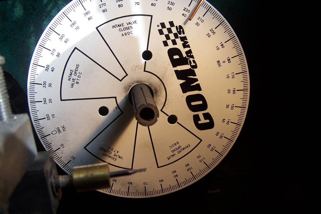

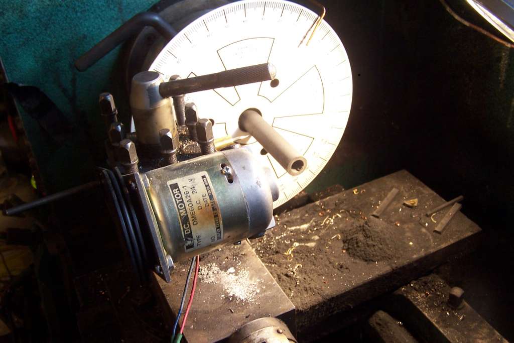

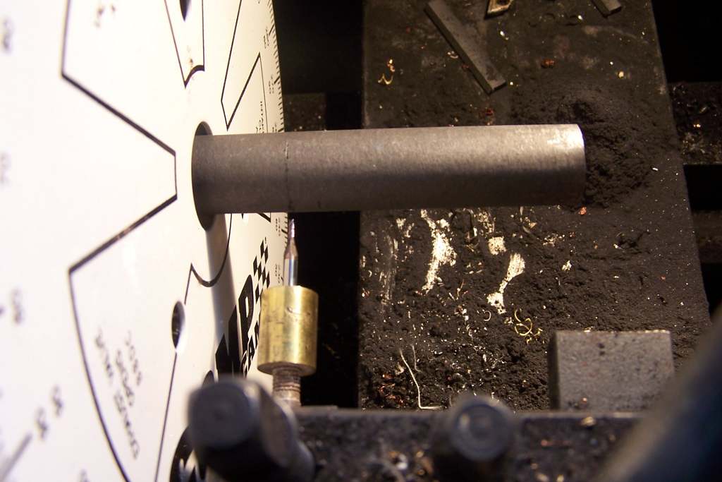

While I was fooling with the mass spec here, there was a lot of waiting involved, so since I'm having a jones for working in the shop after a hard week, I worked on this some. Here's some pictures I took, which I guess could be in eye candy, or machining, but they are about this thing, so here.
Any machinist will know why I did these things in the order I did. The small hole first (new straight drill), then large hole, then the rest. This is to keep the most material there you can while doing the work on it, because this stuff is fragile. Some people would have bored the big hole first, with the idea that the big drill might make a straighter hole, but I liked doing it this way (drilling the 3/16 hole for the mouning screw first) because it was the first use of that drill -- it's straight, and this way I have a pilot for the bigger forstner bit I used to make the big hole flat bottomed. The circumferential mark on the rod is the cutoff point where the small hole reaches. I maybe should have made this shorter, but a first try is just that. One thing I discovered is that the 1/16" mill I used isn't .0625", it's closer to .06", so I had to jigger slightly and make an extra pass to clear the slightly bigger .0635 inch ceramic rod, those tend to be a little oversize. I suppose they thought you'd have more chatter in the mill than I had and pre compensated. I did all the boring at about 200 rpm, not because you can't go faster -- this stuff likes speed, but then you work in a cloud of graphite dust and it cuts easily anyway. The boring was done with a light, constant torque fingertip touch on the drill drive, and proceeded in a bunch of little spurts as hard and soft parts were hit.

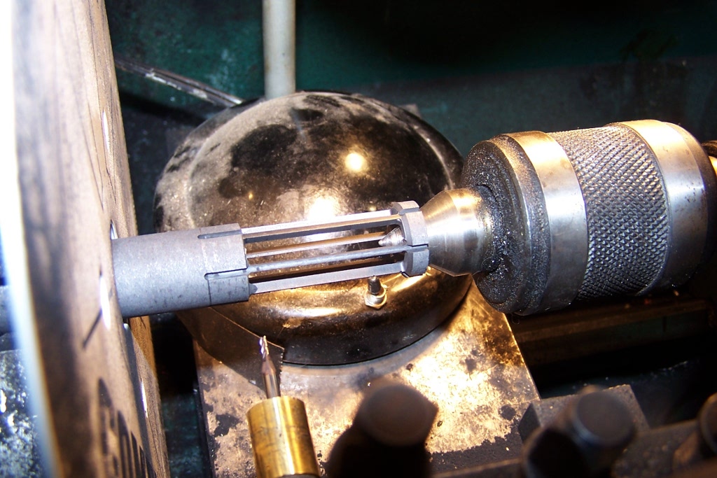

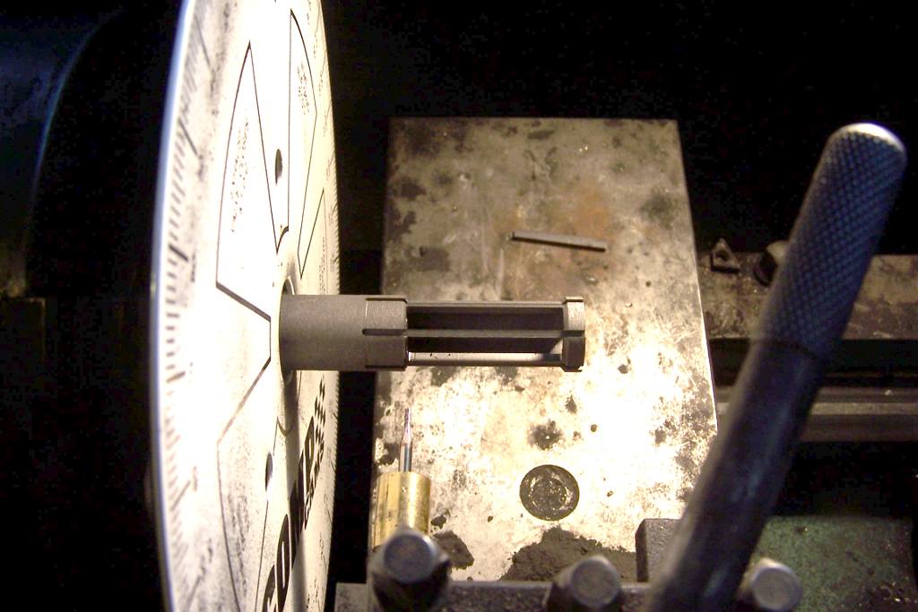

The hard and scary part is yet to come. Now I mill out all the places where those slots are not, those will be the beam holes, and that has to be done carefully as this tool doesn't like making that cut full depth, so it will take awhile. It's something to do after a couple beers, slow, steady, careful, not when excited or hit the wrong control and bam, no grid.
This grid is a lot smaller than the smallest one I've had good luck with, so we'll see. As there is a few hundred buck minimum at Accuratus, it might be awhile before I get more ceramic in a bigger ID. Jerry had the idea that maybe I should just try and metallize the insides of the rods, and forgo the graphite. That's an interesting thought, but I wonder how long the metal would last too. I could perhaps sputter something onto them from the inside, but I'd still need a way to hold it all together. The plan here is to cut some short rings of the ceramic tubing to slip over the ends and hold things in place. Which will also keep inactive but highly charged electrode-stuff from being exposed in the tank to ions, which should help, but who knows? That's why we do this!

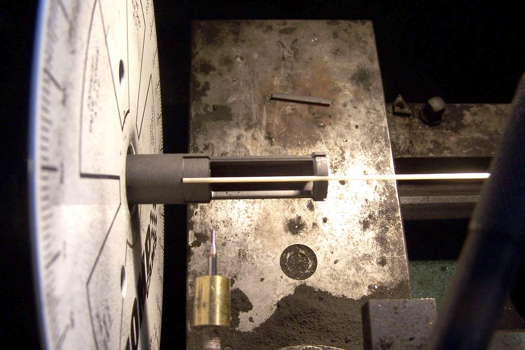

Re: A grid design idea -- more progress

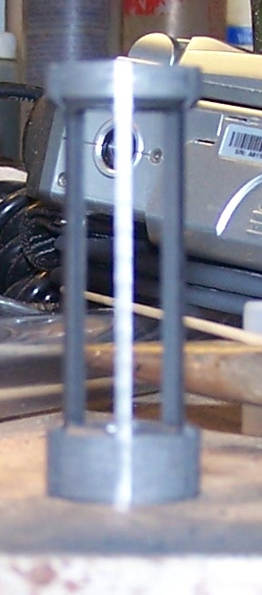

Almost done. Just have to cut some ceramic. I took my own advice and turned the middle down some so there'd be less to cut out with the mini mill. Even though it was an interrupted cut, no problems, and it made the rest lots easier. I'll do that first next time. No real issues cutting out the holes, either, except near the end the thing started to mechanically resonate with the tool, so I stuck the center into it lightly.
See pics. This is going to be the most accurate grid I've ever made, though also the smallest, and that may affect things. Next time get the right doggone size ceramic tubing! Sorry about focus on that last one. Anyone tried taping a reading glass lens over a camera lens?
So, I expect to probably make less neutrons due to the smaller size here, but at lots less power input, for net improvement in Q, but of course, a test will tell all.

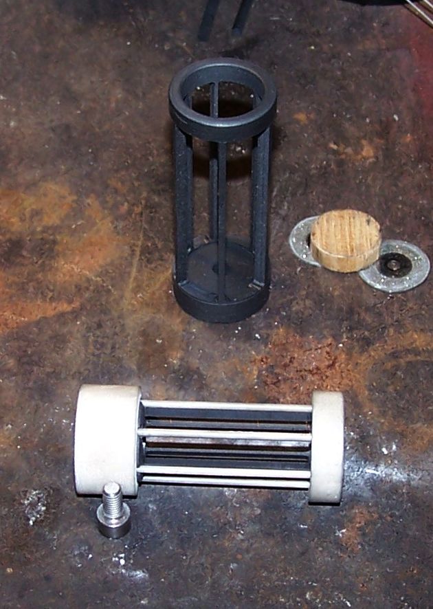

Here are some grids, one of the new design, another one I mis-machined, but will use as a second-grid ion source.
Now, does anyone know a good way to get graphite off of ceramic? Chemically perhaps, or will I have to sandblast or something?
