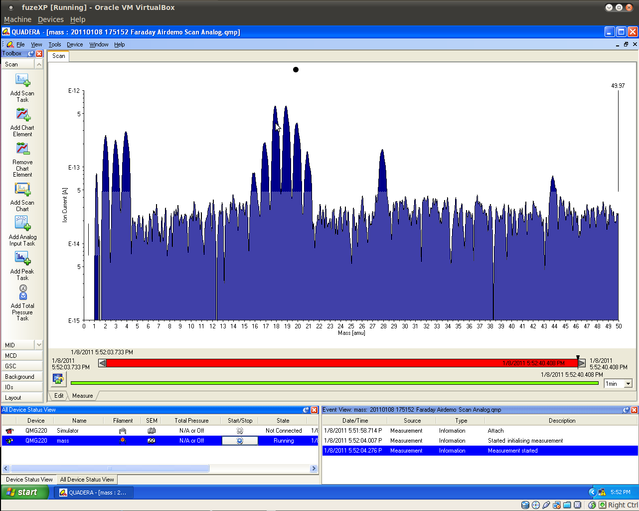

I didn't get the best and final D purity in the video, but I did get it in a screenshot, which by golly, you can actually read the numbers in.
Note that a line a 6 appears when I let in the D (along with some air and water, yuck, but I get most of that flushed out). No power other than the ~1kv levels in the mass sweep, 100v or so ion source, has yet been applied. I've never seen this before and I've checked this gas for purity basically at least one time for every time I fill one of the little bottles I use. But there it is.

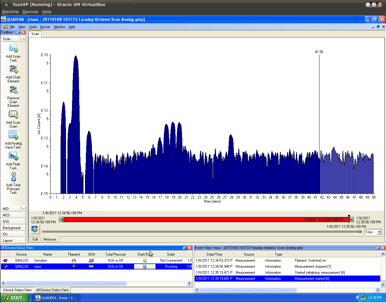

Heres the stuff after running a discharge for 10 minutes or so, roughly 5kv at roughly 10ma. The neutron tube did click a time or two, but not enough above what it does on cosmic rays to say this made any neutrons.
And a screen shot.

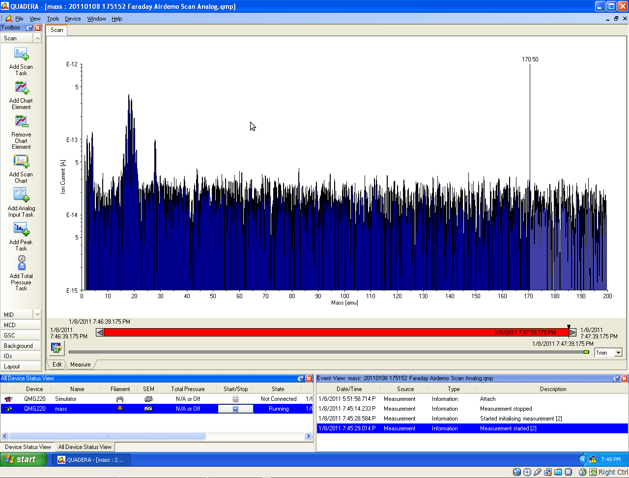

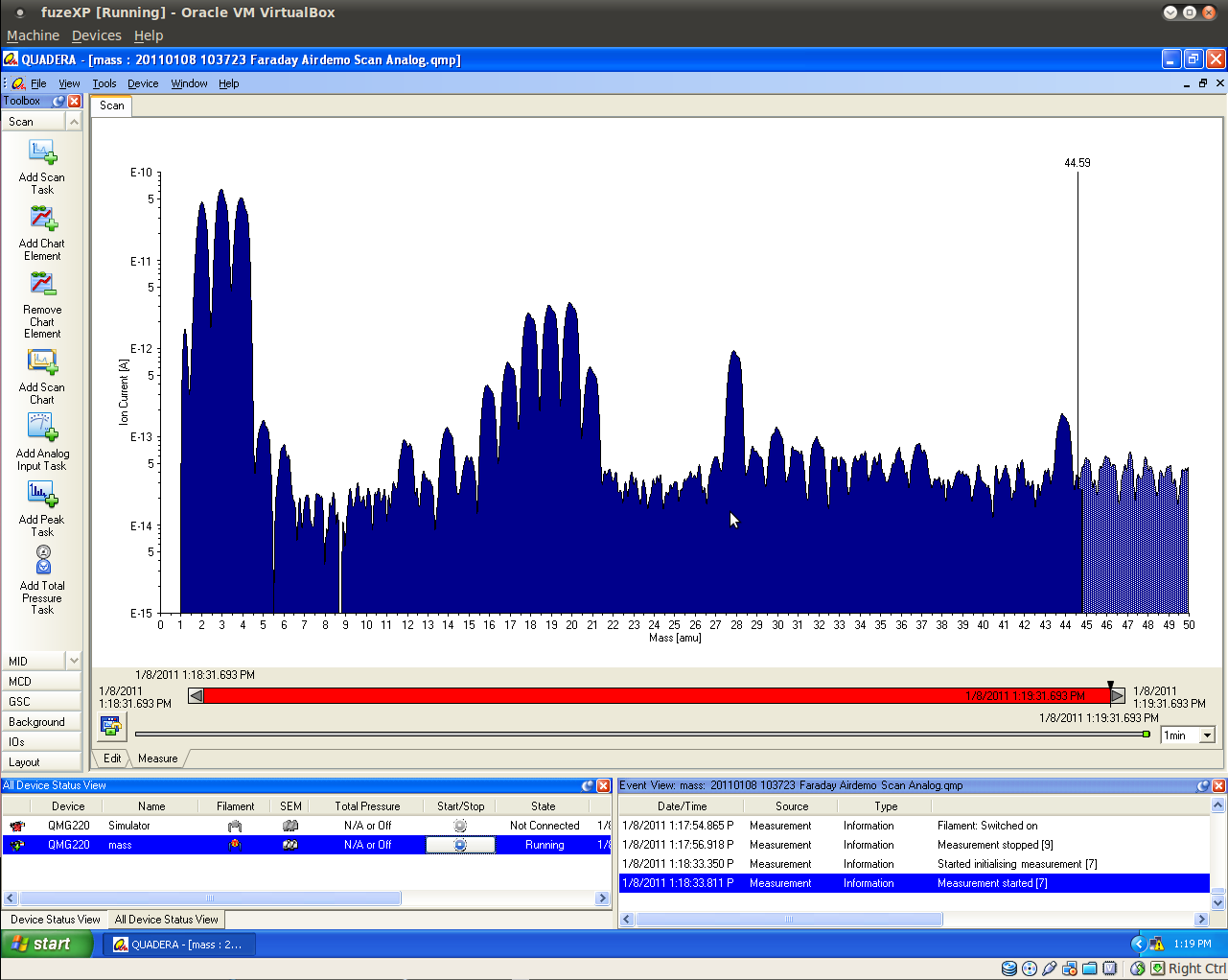

For completeness, here's what it looks like right now (a couple hours of pumping I guess, no baking)
I caught this right at the end of a sweep when it was doing that screen color flip you see in the videos. It nicely shows pretty closely with lines are likely "real" -- coincidence, but after this week, I'll accept luck.

Well, I'm still editing the original post at this point! I have some screen shots where you can actually read the numbers. Sadly, I have no source of pure H without spending real money. It's considered so hazmat that my welding gas guy can't even get it! Electrolyzing gives really crummy stuff, and though we have a purifier someplace, it's the size of a small car (well, a steamer trunk) and in storage, and needs a couple hundred PSI input to work. So I won't be doing that one soon. I'll get some screen shots up in that original post today or tommorow (they're on the wrong computer and I'm not sure what directory they went to, so I have to do some looking) and we can look at those. They are a lot more readable than these movies.
What was interesting to me, is yes, the 5 line, but also the fact that as I pumped on down, the 6 from this run just disappeared instantly and it didn't on the fusor run. So perhaps it's the mass spec itself making d3+, but only under some conditions! That is what I expect, but I can kind of show that by doing a similar movie after a real fusor run. Which I'll do at some point, real soon now. If for no other reason than to make sure I can trust my memory of what I saw last week! I try, but you know how it is.
I note that we should also notice that the O in the original gas largely went away, and without looking (because I'm on the wrong computer now) I'd bet the water lines did something -- the O probably got eaten by D to make some heavy water. That'd be another place to look for T, as well. There's always some water!

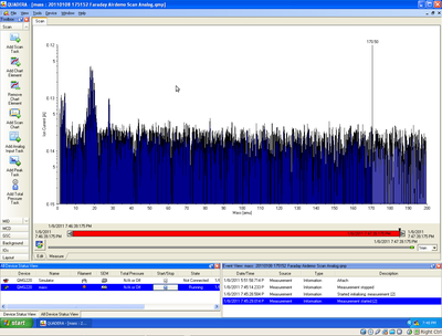

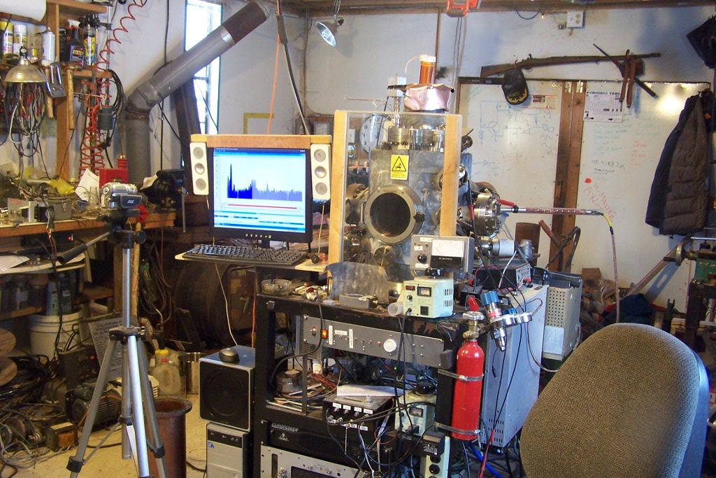

In order to keep the data up here, and most of the comments below, here's some pictures I took while doing this. Sigh, close focus failure again. I was trying to get close enough to get fewer reflections off all the layers of glass, but failed at that too. I used my second, pear shaped grid for the discharge, out in the main part of the tank, so I could get a discharge at lower pressures, but it's too close for the camera even on macro mode. Going to have to try some things with low diopter optics, I can see that coming.
One last pic of a full mass scan, all the way to mass 200. Heavy stuff doesn't fly well, as you can see. Looks like 1/F noise to me and kind of defines the current noise floor. The gage was reading 3 e-8 mbar at the time. It'll probably be tomorrow morning to get to 1e-8.

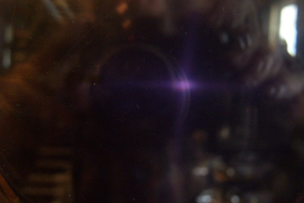

Back in the day, the old masters would almost always make a little discharge tube, and put it in the foreline (where the pressure is high enough for it to work) and observe that to know if something odd was going on. I've done it, and it's really useful. Price/performance ratio for an observant person is really good for that one. I finally got a middling good optical spectroscope, but darn, it's hard to use and doesn't have a marked scale, which would make it a lot more useful. One of those things sold for high school physics teachers. A good one of that ilk would probably be ideal -- I don't see needing a "real monochromator" for that kind of thing.
