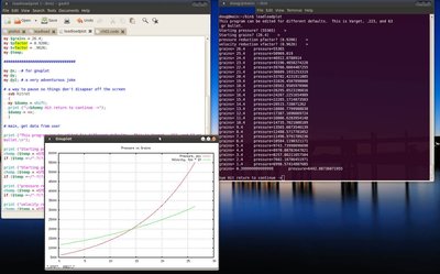

This is just a duplication of his work, but instead of an Excel spreadsheet (which he didn't publish) it's a perl/gnuplot program that's a little slicker anyway.
leadloadplot.zip
zip file (linux text format) of perl code.
Windows users get the Activestate per download and gnuplot/GnuplotIF the hard way...
(1.44 KiB) Downloaded 403 times

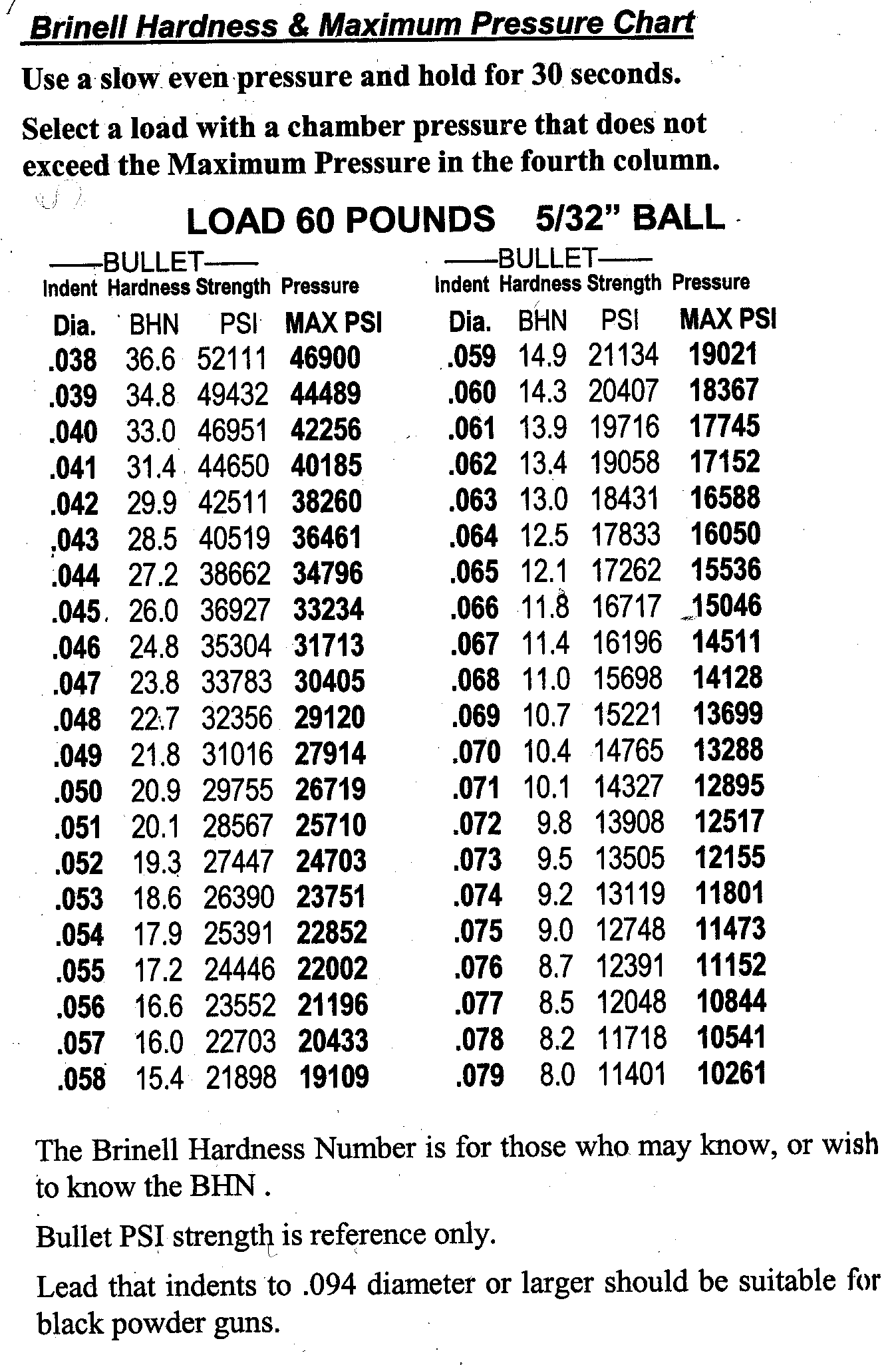

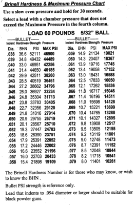

Table of BHN vs PSI for lead alloys
The pressure in the rightmost column is the one he's determined is best for a given hardness alloy (and of course, Lee sells a kit to measure that).
He likes about 25k psi for linotype (good rifle alloy), and about 14kpsi for pistol alloys.
Screenshot

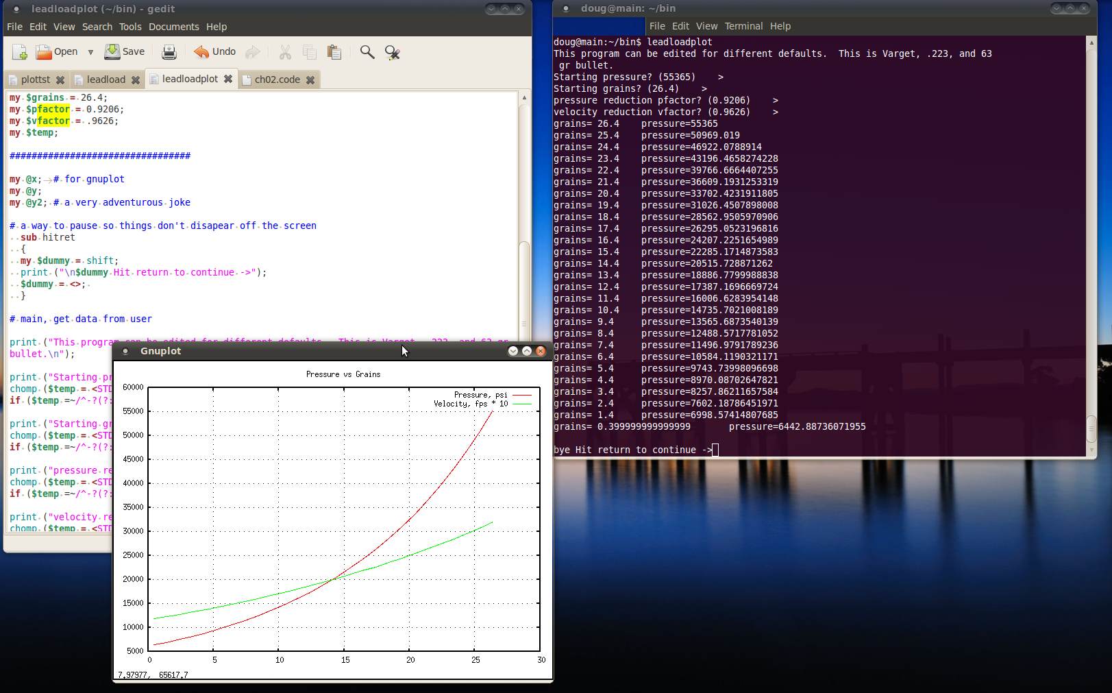

The idea behind this code is it removes some of the less useful search space for you, so you are not testing with too many variables. Lee transformed the art of lead bullet loading to a practical science, my kind of guy.
I niced it up a little overnight, here's the latest. Just better plot labeling and junk like that. The real issue is finding those "factor" exponents to put in there. It load books give two loads and two pressures, you can back-figure them, usually; Lee's book gives many of them outright and makes that easier.
leadloadplotv2.zip
Cleaned up version
(1.52 KiB) Downloaded 379 times

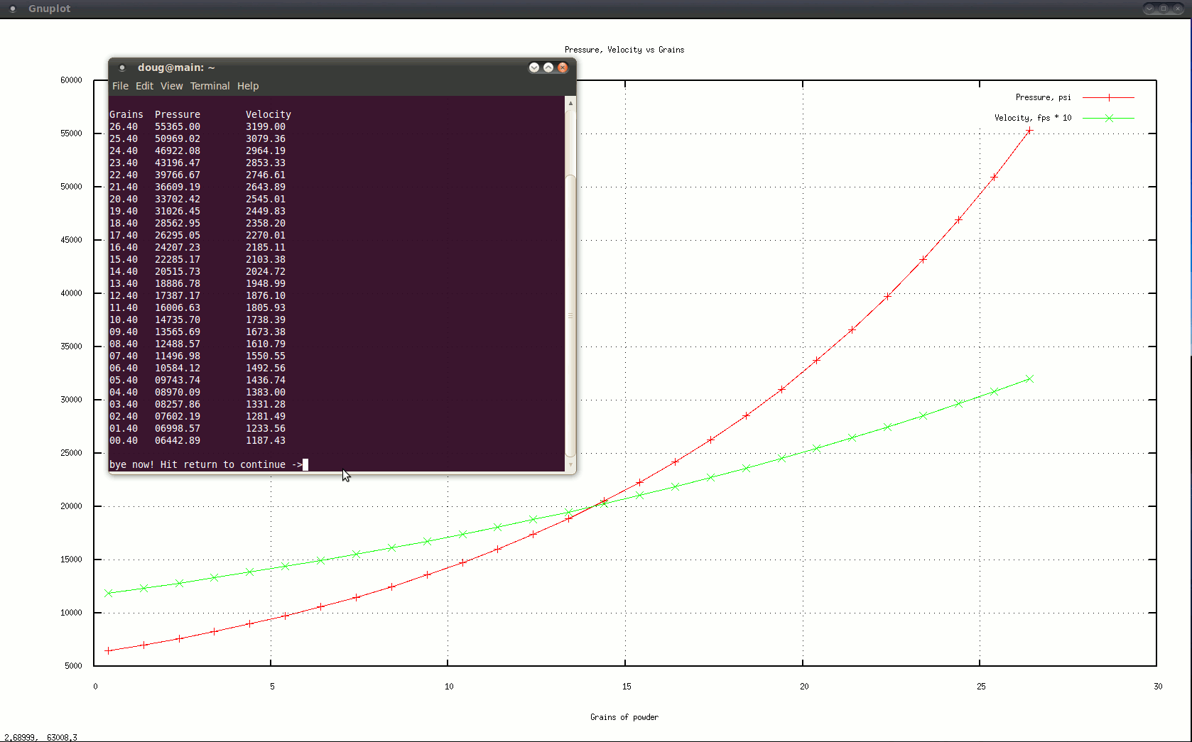

This is an example of the linux "toolbox" philosophy. I don't need to write a plotter - it's done and done well in GnuPlot. I just used a little perl "glue" here.
(check out the gnuplot demos on their site -- stunning 3d stuff, and fast). To make gnuplot "stick" to perl, I used a perl module, GnuplotIF, which made the plotting part an afterthought. I believe there are windows versions of all this, which finally makes writing cross platform code reasonable to do.
screenshot
screenshot

Just to add, in the fairly likely case you don't care about loading with your own cast bullets -- likely, what this really does is show an easy way to get into pretty-plotting data in a pretty cross-platform way. I've a long way to go to exploit all the "free and easy" you can get with this toolset, this is just a beginner tutorial (as much for my own benefit as anything). A nice simple template on how to get going to plot data that interests you, which we'll be using for the fusor data acquisition database, to show the results of any "data mining" we can think of to do.
Having done this sort of thing in MFC, GTK, Tk, QT, you name it toolset (and gawd, OpenGL), on both windows and linux -- this is by far the easiest way to get a picture on the screen that is useful.
