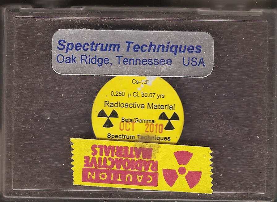

I have been on the lookout for a distinct spectral source to test out gamma spectrometry. Is this a good one to pick up, or are there better things to go for?
Re: Test Sources
Cs-137 is "the" calibration source to have for a gamma spectrometer, most of them require one for setup. It has two lines, conveniently spanning the range, and is very clean otherwise. It's why we were looking for them ourselves. Bill bought an "official" one outright, but at nose-bleed prices, and it has .25 uCurie activity in the "new" state. Geo says these are down to .3 microcurie as yes, they are old. That's still pretty loud, the .25 uC one we have is plenty loud on the standard counter. What's nice about this is that even after time, no new lines from daughters appear.
Anything much hotter than this I wouldn't keep around the house, even in a lead pig. There's probably some line smearing due to the envelope, but I'd bet very little (and you could take one apart anyway if you cared).
One of the lines is 662 kev, and the other is (I think, but I'm checking) about 30-something kev -- so you have nice single lines at both ends of a spectrum for calibration.
