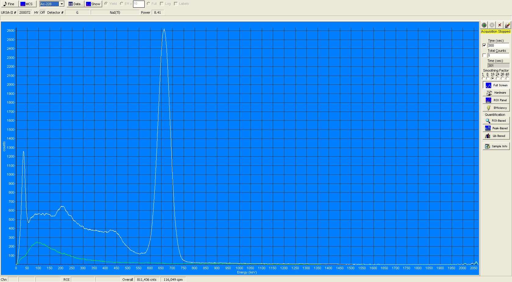

But, once warmed up, this produces some nice looking spectra. Here's one with a Cs-137 source on the big Harshaw NaI.

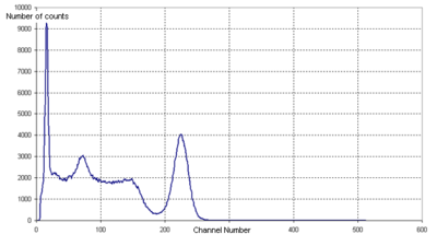

Detectors matter. Here's about the same thing but from a smaller, thinner NaI head (STOE)
Just a note of intrest. The lower peak on the STOE head IS the right peak for the low energy Cs-137 line. On the upper one, that lower peak is just noise. The STOE is super quiet, but can't handle the high energy 662 kv peak -- it's the most far right one, and that larger one below it is from photons that had some energy scatter out of the thinner crystal. In the first picture, from the Harshaw (5" diameter by 3" or so deep) that high energy peak is correct.
So, we learn something here every day, or try to. Maybe with a decent preamp, better wiring, I can get the correct low energy peak out of the otherwise bigger and better detector head. I'll be trying that. PaulS over at the manufacturer wants me to rewire the phototube base and try it off the URSA power and I'll try that when I find the parts to do it, maybe this weekend, maybe I'll have to order some. I don't usually stock tens of high value high wattage resistors in high precision around here, and that's what it needs.

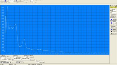

For pure eye candy, this is a lot of fun. Richard H says with U ore you look for goldilocks and the three bears. Well, on this Cadillac head, we have 5 bears!

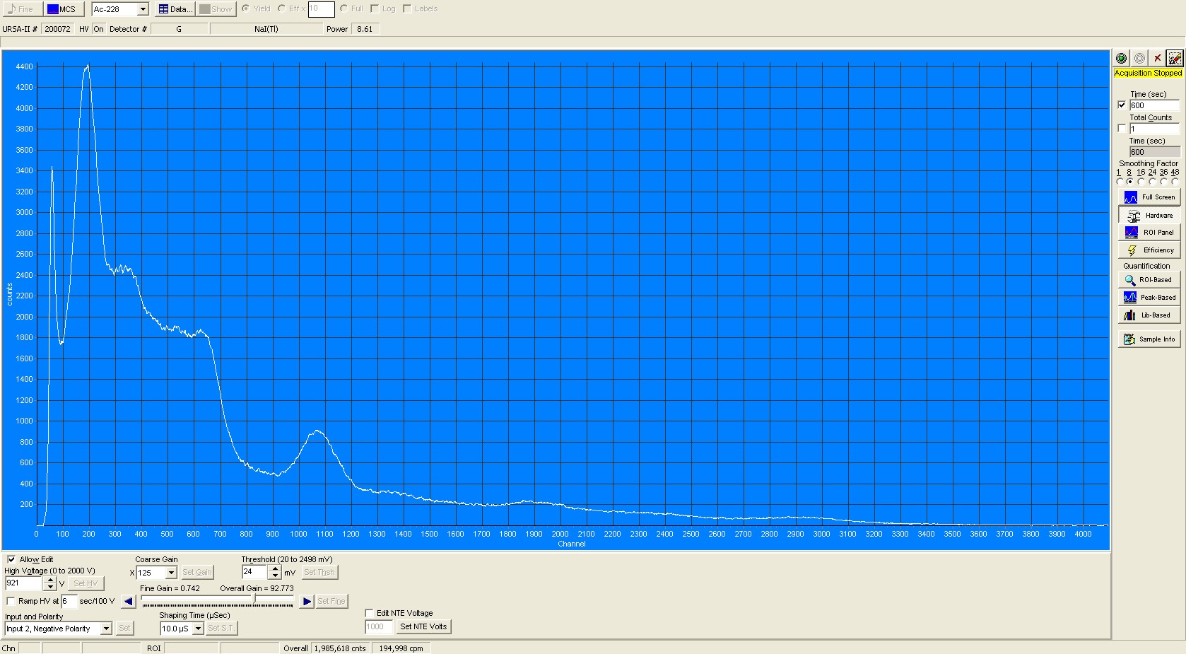

On the other hand, more recently refined U metal has a simpler spectrum -- fewer daughters.

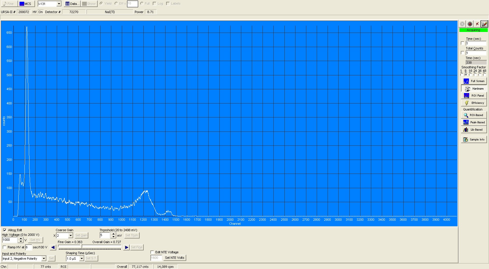

An old Ra sample has plenty of daugthers:

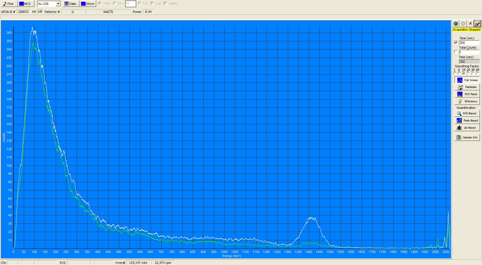

One of the advantages of this site is that we can use it to store a little information where it's hard to lose (or at least, it's in another place to look in). I just completed a rebuild of the phototube chain for the new Harshaw big NaI:Tl, and took a background and a Cs-137 spectra, overlaid, with all the setup numbers written down, so here it is:
These numbers might not mean much to everyone, but if I ever need to get back to my baseline with this, well, I have them stored here too.
Conditions:
Benchtop, no castle.
Room temp 85 deg F
CCFL input 9.4v, 130 ma, output 1834v DC-
Anode load 10k ohm
Gain 17.637 (FS is 5v on this URSA II unit)
Shaping 4 us
threshold 10 mv
ch numbers for Cs-137 lines 76,991
Detector - Harshaw, our #2, socket rewired for focus electrode 2r and bypass caps
Compare this to the one on Wiki: The reason I have a bigger high energy peak is that with this huge thing I have a lot less loss to Compton scattering, not that I 'm not seeing the smaller peak as well, as the comparison with my background on the upper one should show. These things are really outstanding as NaI detector go (eg, hard to lift). In this case, size matters, and these are big.
So, nothing really special to see here, just a "note to myself" for the next time I need to make sure I'm set up the same for repeatable results. Putting that shield can on there, and the extra supply filtering let me set the threshold a lot lower but still out of the noise, and run lower HV so I could see higher energy without clipping on the URSA. Those peaks way up high are cosmics, which I assume are not resolved -- just stuff that clipped at the limit of the A/D -- because they look about the same no matter where the other parameters are set.
And now I can go have some fun with this, and know it's telling me the truth for sure.
