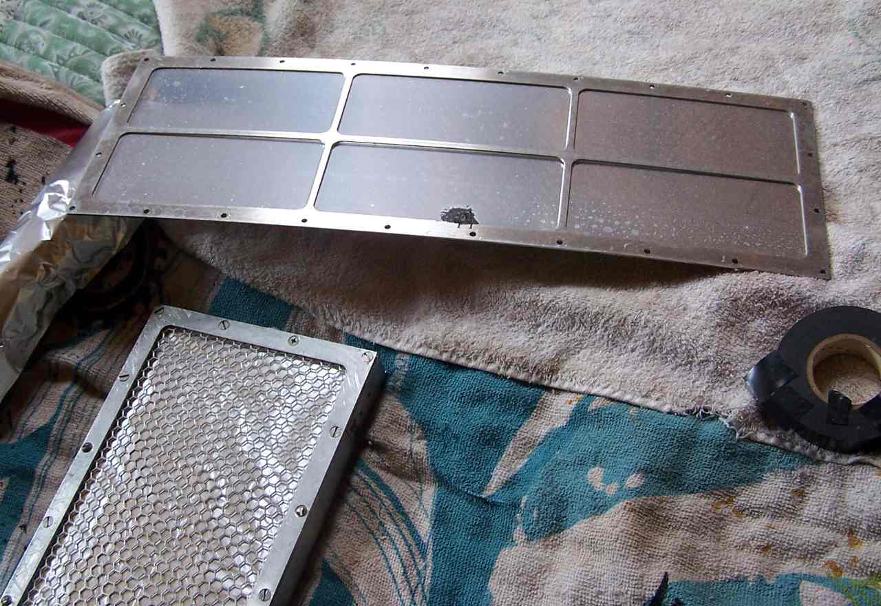

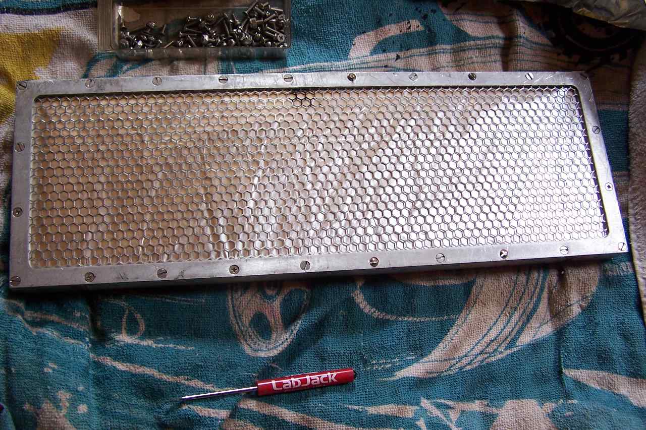

Bill recently scored a number of large flat ionization chambers (kind of) that were originally mounted on the bottoms of carts to check for contamination of floor surfaces in places that handle nasty things. As such, they came with very thin al-mylar diaphragms, and being old, they leaked. They were designed to run at STP with flowing gas, and maybe hold a charge for an hour, but these were pretty beat up, repaird with scotch tape etc -- which of course blocks the alphas anyway. So I put a new thin Al diaphragm on one for testing it further w/o alpha sensitivity. It was no big trick finding super thin Al foil -- go to the grocery store and get the cheapest stuff, which is about 1/5th the weight per square of the good stuff.
Here's what they look like:
Det with new diaphragm.
Old diaphragm
Old diaphragm
