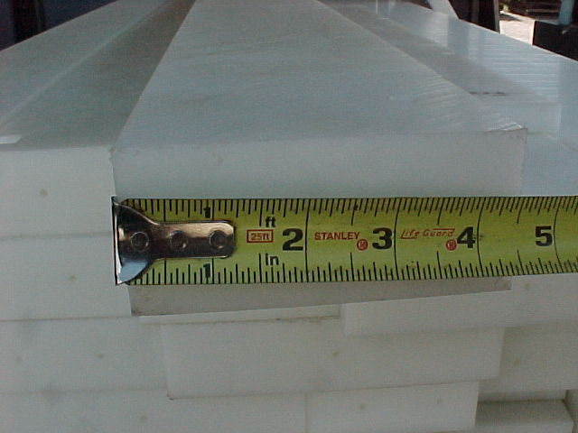

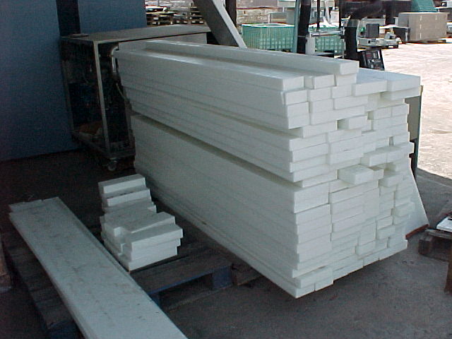

I like HDPE.
I need to learn how to cut the long pieces shorter.
Paid only $2 per pound but shipping was steep ( by truck)
Geo
2" thick stock.
2" thick stock.
HDPE Stock (removed form homeland security neutron scanners using BC 704)
