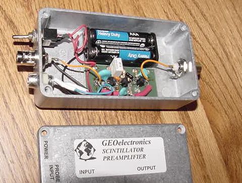

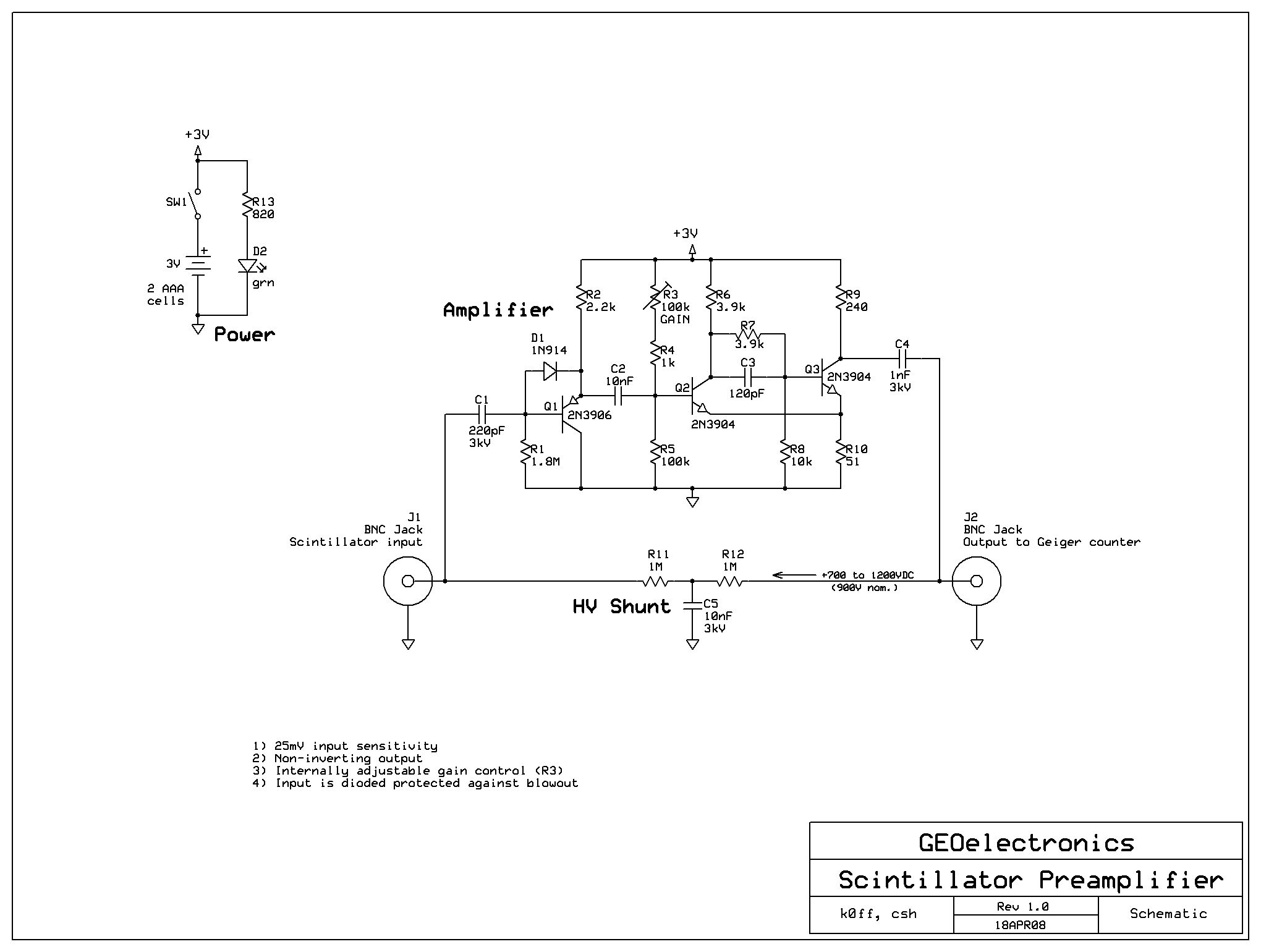

Post by George Dowell »
Geiger Counters designed specifically for GM tubes have an input sensitivity in the hundreds of milliVolts.
This is fine for GM tubes as they can provide a signal well into a few Volt range, and there is no need
to add system gain which increases system noise.
When using scintillator probes on such meters, the gain needs to be increased to the 30 to 50 milliVolt range, otherwise
the smaller signals from weak energy sources can be ignored.
The design I developed works fine to convert CDV-700 and all other GM only meters for use with scintillators, giving them an effective input sensitivity ( a.k.a. LLD, Discrijminator,Threshold, Gain) of 25 mV.
Geo
Inside the preamp
Inside the preamp
Schematic
Schematic

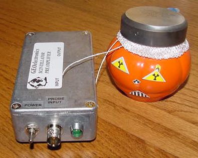

Preamp Finished
Preamp Finished

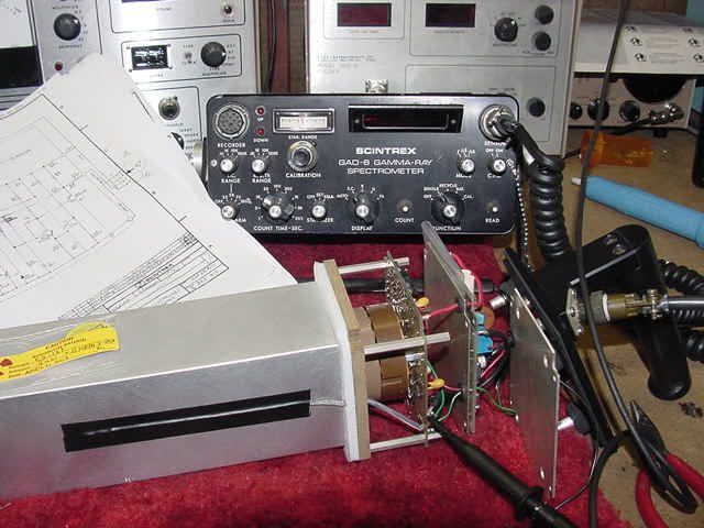

One last thing while I pause for discussion. Sometimes we use a scintillator with MORE THAN ONE type of
detector in it, reading say Gammas and Betas, or Alphas and Betas at the same time but independently. This is accomplished by pulse height detection.
The picture shows a typical Geologists Gamma Ray Spectrometer with remote probe, servo loops for temperature feedback and "downhole" HV generation and pulse shaping. With these we look at 5 things at the same time. 1- TC or Total Counts of all energies, #2 U window - we monitor the Bi-214 line at 1764 keV for Uranium , #3 Th channel We monitor the Tl-208 @ 2620 keV for TH 232 , and the K-40 line (1460 for K-40). The last channel is called a stability channel and is an artificial channel introduced by either an isotope or a small LED lamp. The precise position of this channel is adjusted by HV electronics to keep the whole system calibrated. There are a number of schemes, the newest uses onboard K-40 for continuous calibration, the fraction added being removed by software.
Geo
Geologists Gamma Spec

Today I finally got time and energy enough to start board assembly for my pre-amp. The one thing I have come to ponder over is the connections to implement the method we are both using to feed the signal back down the HV line.
The thing is, if we look at your circuit, as the HV voltage comes onto the line, it will lift the capacitor, C4, until such time as the resistors R3 R4 R5 and R9 charge up the capacitor, or otherwise through R9 and the resistance/short down to ground in the 3V supply. The cap charges up through these resistors. RC is still very low, micro-s in duration, but do you think there is any need to put in some diodes so reverse condution can charge up the cap if the HV comes onto the line too quick?
My output is from a CMOS chip output so will be even higher impedance on that side of the signal coupling cap. I'm just wondering what I should do about it. That being said, I did run the circuit before and nothing 'blew up', but it seems we are leaving it to the God's of incidental resistances.
(I also have a 220k resistor between the coupling cap and the HV line, which slows the charging down on the 'HV' side of the cap.)
I'm thinking that maybe I need to stick an inverting pnp in there, so that the coupling cap can be connected to the low side held to ground for power-up/most of the time.

Re: Preamp for scintillator probe use on GM Geiger Counter
The circuit is stable and there have been hundreds of examples built up but only after thorough bench testing of the design. .
Input diodes have been added with good results, but by and large we find they are not needed. Variations of the HV + Signal Splitter Combiner circuit is also well represented in the field in the form of "adaptor boxes" for using two wire probes on one wire electronics and the reverse.
We tend to test at the front end, then stick closely to the design in production.
Geo
Post by chrismb »
Can you clarify what you mean by 'input' and 'front end'?
I'm just pointing out that if the HV input from the scaler flies high(/low) very quickly, you will pull Q3 high(/low) with it, as there is nothing to directly charge up C4 (viz. that holds the 'ground-side' low). It looks like you're relying on the transient immunity in Q3 to deal with any such possibilities, maybe it's good enough for the job.
I'd say that unless your crate simply switches HV hot, from an already fully charged internal filter cap, that there would be no problems with this, particularly if the 3v batteries were switched in at the time -- that 240 ohm will take care of charging the cap fine without much overvoltage. You have to pick up a sense of perspective about "fast" vs the other time constants involved here. There's a big difference between "too fast to see on a voltmeter needle" and "fast enough to make any real current through a .001 uF cap". Most transistors will turn on and draw some current in a zener mode if nothing else, and not hammered too quick. Anything like this the provides the HV through a sense impedance so it can also see a signal on the same wire has, you know, that sense impedance in series with the HV drive. It's usually from 10k and on up - 100k more typical, I've seen 1 and 10 megs there in some things. You should probably make tests, then comment, since Geo HAS made tests.
