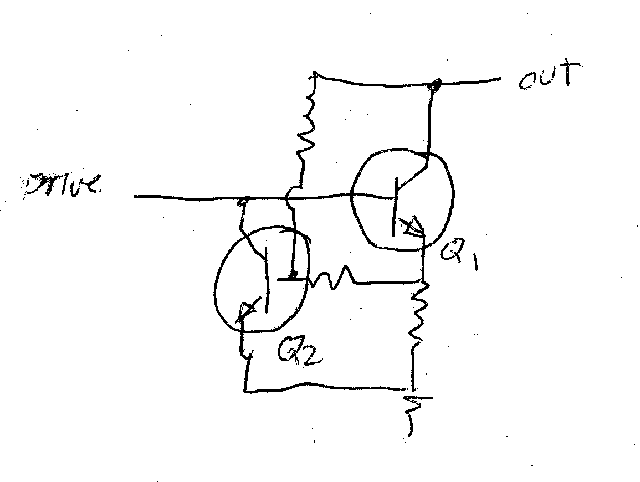

Here's a horrible hack Dan Meyer used to try to keep the output transistors in the "tiger" inside their SOA's. Q2 senses the voltage at the emitter resistor of the main output, and the collector voltage, and if the sum through the resistive divider is greater than a Vbe, it shorts the drive to the power transistor....
