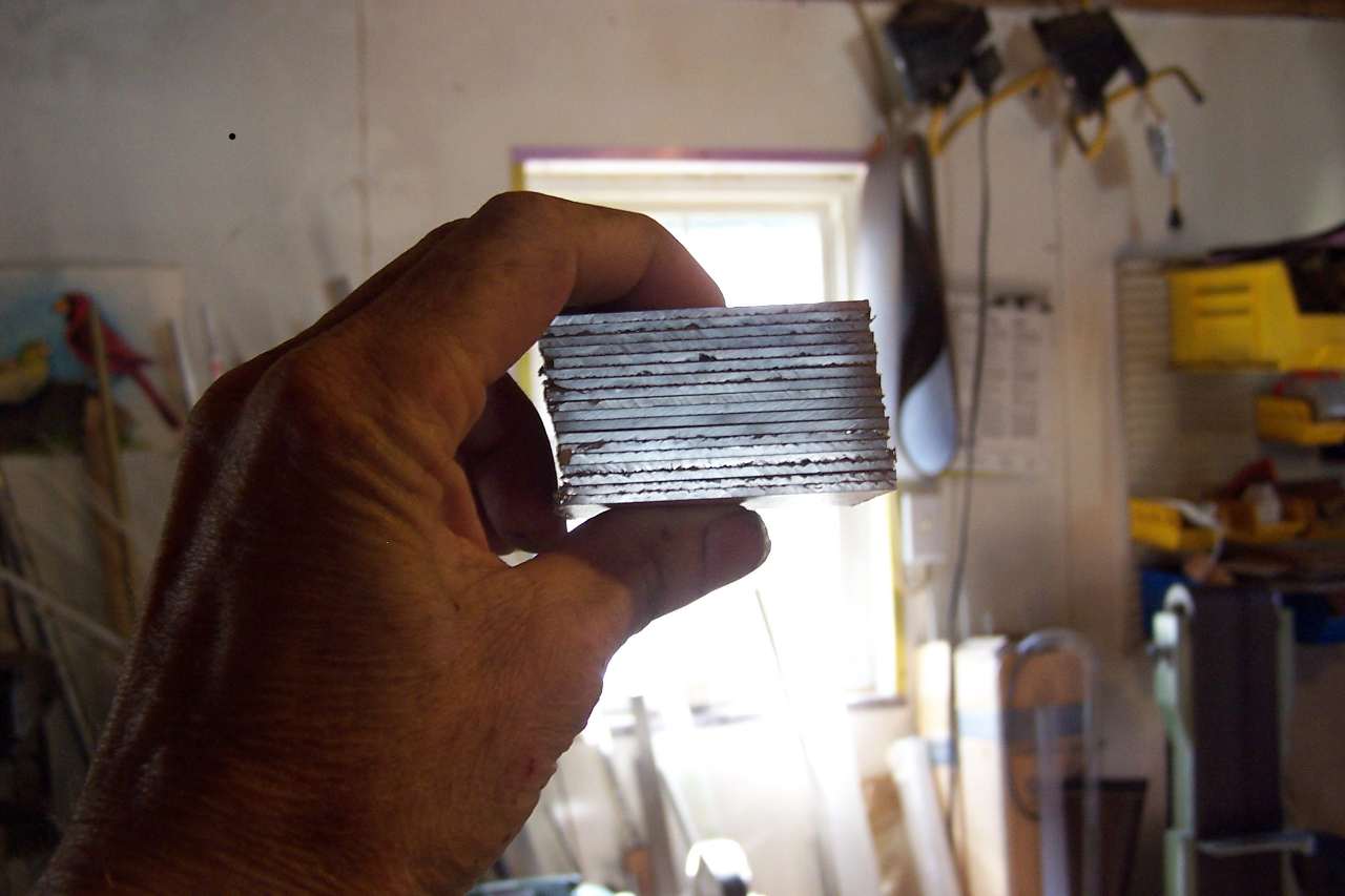

The plan is pretty simple. I will cut up a bunch of 2" sq pieces of 1/16" thick plexiglass for light guiding. I will stack these up with phosphor/epoxy slurry between them, and harden this under pressure in a jig, so we will have alternating layers of ZnS:Ag and clear plex light guide. This is required as ZnS:Ag has such a large index of refraction that there's nothing you can cast it in that will result in the unit being transparent to its own light output. A standard Hornyak tries to get around this by interleaving rings of phosphor/resin with just resin in a bullseye pattern.
That's hard to make, and it doesn't permit too many layers for a given phototube face size, here desired to be 1" (so the tube is not expensive or rare -- those are common from old PET scanners and easy to find). I plan to make a 2" by 2" by 1" thick one, then dice it up into 1x1x1" pieces to get 4 made per run on the glue jig. After polishing the plex edges, I'll coat the non phototube facing ones with something reflective, like space blanket material. This actually works better than white stuff, or metallizing the plastic, as if there's a tiny air gap, you get total internal reflection in the plexiglass for the angles that works for, wheras if things are touching, they can suck light out and only return it with some losses. (This is well known in detector lore, I'm just repeating it here for the non experts). Plex and most casting resins or epoxies have an index of about 1.5. ZnS:Ag is in the 4's, which is why it always looks white when cast into things, and Hornyak worked hard to find the right mix for best performance. Later, someone else came along with the interspersed light guide idea, and I'm doing my own version of that here.

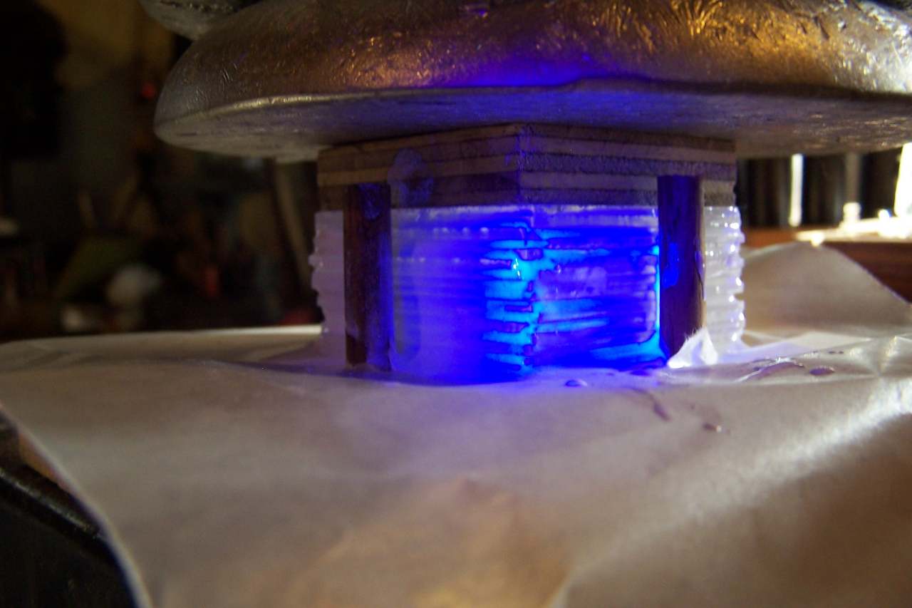

So, I've already cut up some plex, now I'll make a jig to hold them in alignment and under pressure while whatever I use as the adhesive gets hard. I plan to go for a fairly heavy concentration of phosphor in those layers, since the rest is clear anyway, and I'd never have a working thing with that concentration low enough that much light would get through the dispersion inside that layer anyway - it will have to get out into the plexiglass and go to the tube from there no matter what.

Even with unpolished sides and the brown paper on there, light gets through this stack just fine.

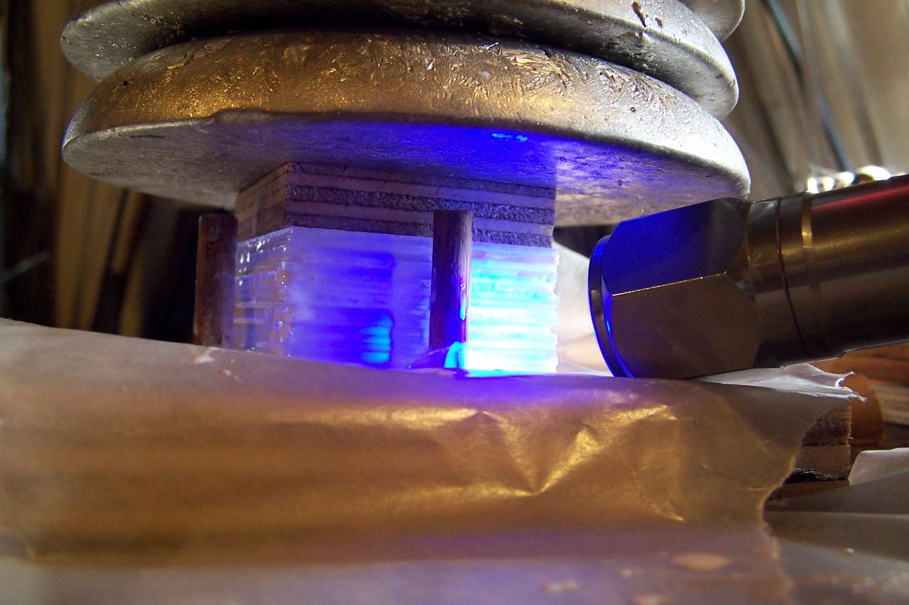

A few pix of the process. I tried one layer with 5 min epoxy and what seemed like a lot of ZnS, but it took a ton of pressure to squeeze out, and only got to about 30% opacity. So I mixed a batch of casting resin (much thinner stuff) and used a LOT more ZnS in that (darn, it's not exactly cheap stuff) for the main effort. It squeezes out easily, hopefully not too easily. Still takes some decent pressure to keep the edges from sucking air back in, so I hope that's not so much as to squeeze it all out in the long time it takes for this stuff to cure. (over night min).

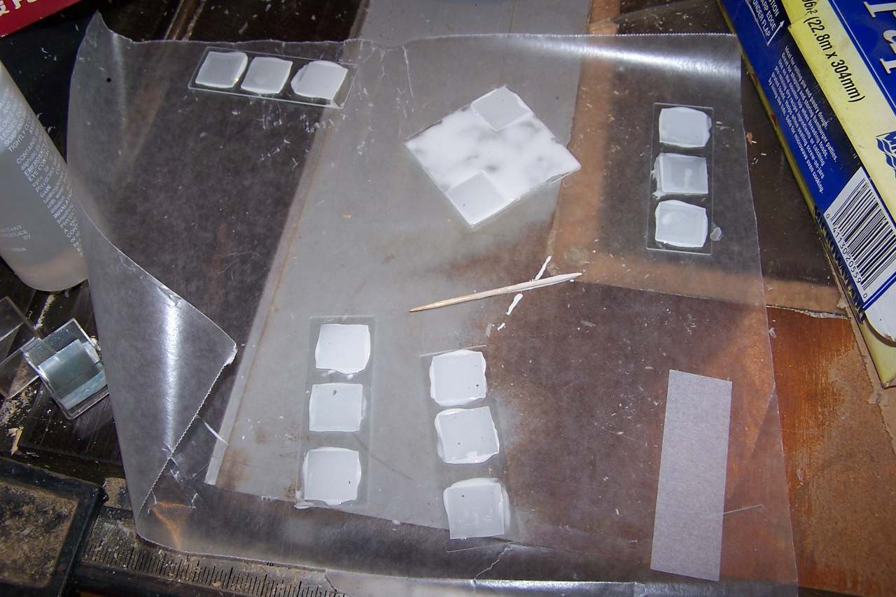

Had some leftover and squeezed out so I improvised a quick possible use for it with some microscope slides and cover slips to make the thickness uniform. Previous experience with the pinhole camera underlined how important that is.
This should be solidified enough to play with tomorrow night, though they mention 72 hours for a full cure. I may need to replace some parts in my fusor, as the last run it started arcing badly near the end of the feedthrough. I've had this kind of "self repair" before when things cooled off, but this might actually require breaking vacuum and putting in new parts. At any rate, once it is running again, I'll have a test horse for the blocks I'll cut from this blank. I have a standard holder for a type of phototube we got a bunch of, so I can switch these into a known working thing.
However, with ZnS, even ZnS:Ag which is the faster decay version (ZnS:Cu is very slow) you have to wait nearly 24 hours for it to get quiet in the dark before it really works right.

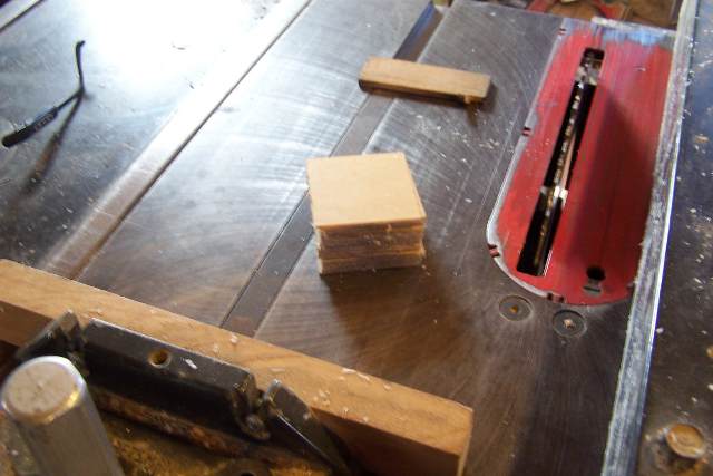

Well, I hope they are promising. I've since cut the edges on the mill to get a feel for some of those issues. Seems I got the phosphor layers pretty uniform, if on the thin side. The beam of my UV flashlight gets about 60% of the way through, sideways, and the emitted light does come out the faces nicely to the eyeball. Interestingly the plastic is so clear that almost none of the light comes straight out the face, but at the angles a little off center where you are viewing the whole phosphor layer on either side, eg a double humped angular distribution. That won't affect a phototube of course. And yes, these will have to be at least relative-calibrated off say the original one, for which we have some good numbers from our own and HEAS runs.

Another variable not yet optimized is how "long" to make the diced up sensor heads. The commercial ones are about 1/2" long, the theory I think being that longer than that and the plastic has moderated any neutrons below the energies that will give useful further light in the phosphor from knock-on protons. If that's the case, I get almost 8 heads out of that one big blank I made (saw kerf might cut that to 6 or so, and I'll probably bork one doing this).
