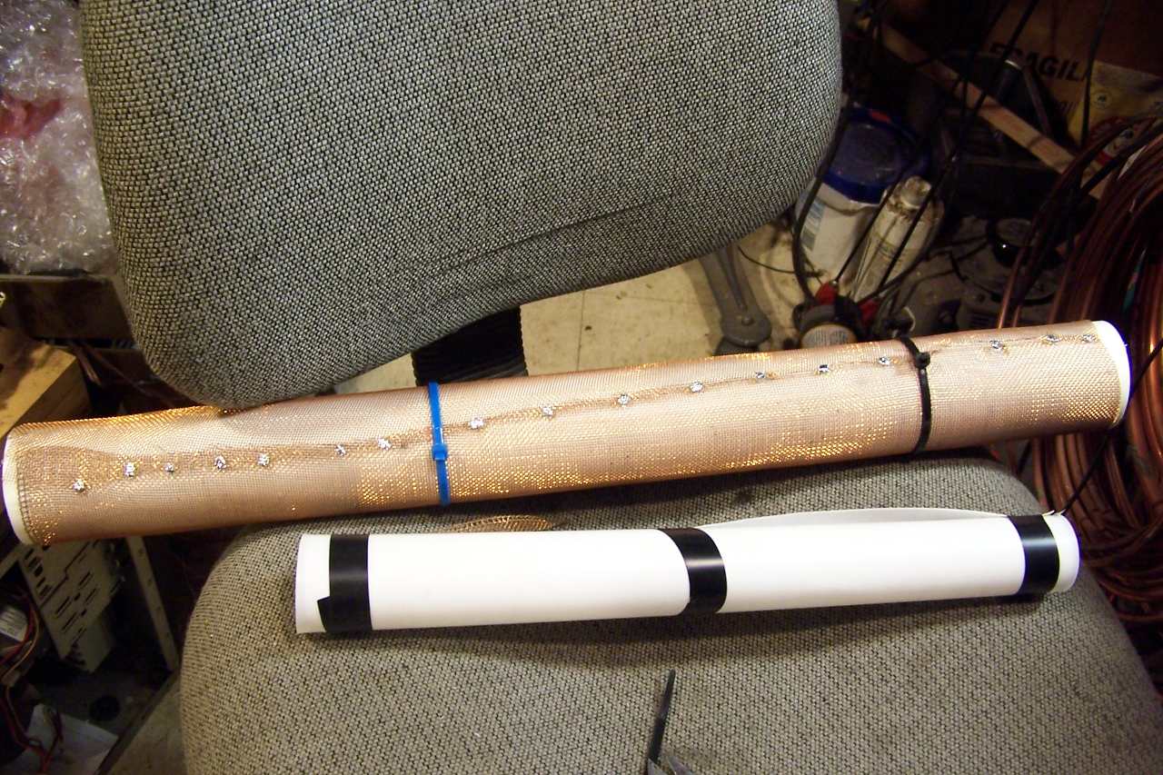

While I was waiting for the air to get into the tank through the slow bleed valve, I made a shield for the #2 grid (ion generator). Since sched 40 pvc won't quite stand off the 40kv max that one can see (it's usually run closer to 10kv, but "stuff happens"), I made a teflon sheet wrap for the otherwise uninsulated resistor while I was at it. I don't care if that tape melts - it just lets me fit it into the pvc without trouble when putting it together.
Shield for the aux grid HV feedin

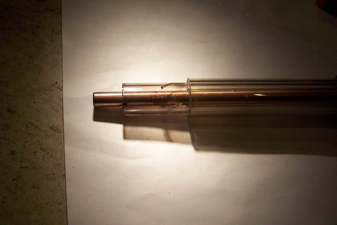

The proximate reason to tear this down was some arcing in the main feed through. I'd run it brutally (53 kv, 30 ma, 20 minutes) awhile back, and that toasted it - even my big grid got orange hot in the middle of the rods for a long time in that one, and I almost got the end red hot. I'm using pyrex and quartz for the insulators, either of which can be reduced to its component metals by hot H - and this stuff is as hot as it gets...When I put this together, I'm trying another scheme to protect this. Here's what the damage looks like:
Note cracks in the quartz...
I had a mirror under this so I could watch it fail (this has been an ongoing issue). What's interesting is that while I could see arcing, it was fully contained in the quartz, right about where the pyrex outer tube ends. No spark out to the tank, and no spark into the center conductor either - just inside the quartz. I'd presume that it picked up enough charge on opposite sides of the thickness to just arc through, and the damage was done by energy stored in the capacity of the quartz, but that's a guess. Since more or less nothing can really stand this gaff - zillion degree pre-ionized deuterium hitting it, I decided to simply put a grounded pipe around the entire mess and let it take any hits - but since it's grounded, it doesn't attract ions. This seems to work, using the paradoxical Paschen's law in my favor -- the distance between the end of the grounded pipe and the grid end is too short for a discharge to occur there! Doesn't satisfy p x d :)
