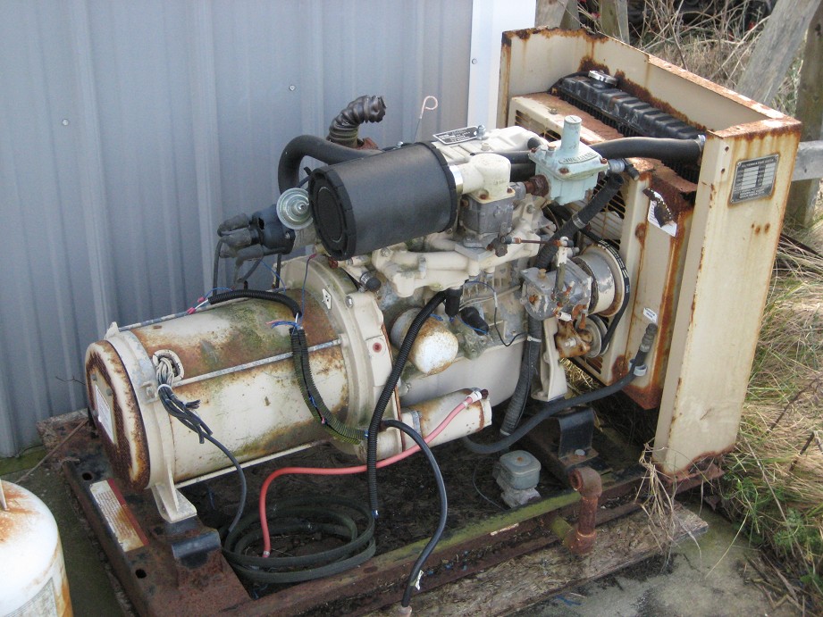

A neighbor has that Generac, I might be able to borrow his manual for you. His only troubles with it are carb icing in winter, and well, what it costs to run it.

This is my Generac generator. I could probably find an aftermarket regulator for it to use in a new system. I'll have to work on getting it apart to check the overall condition.
