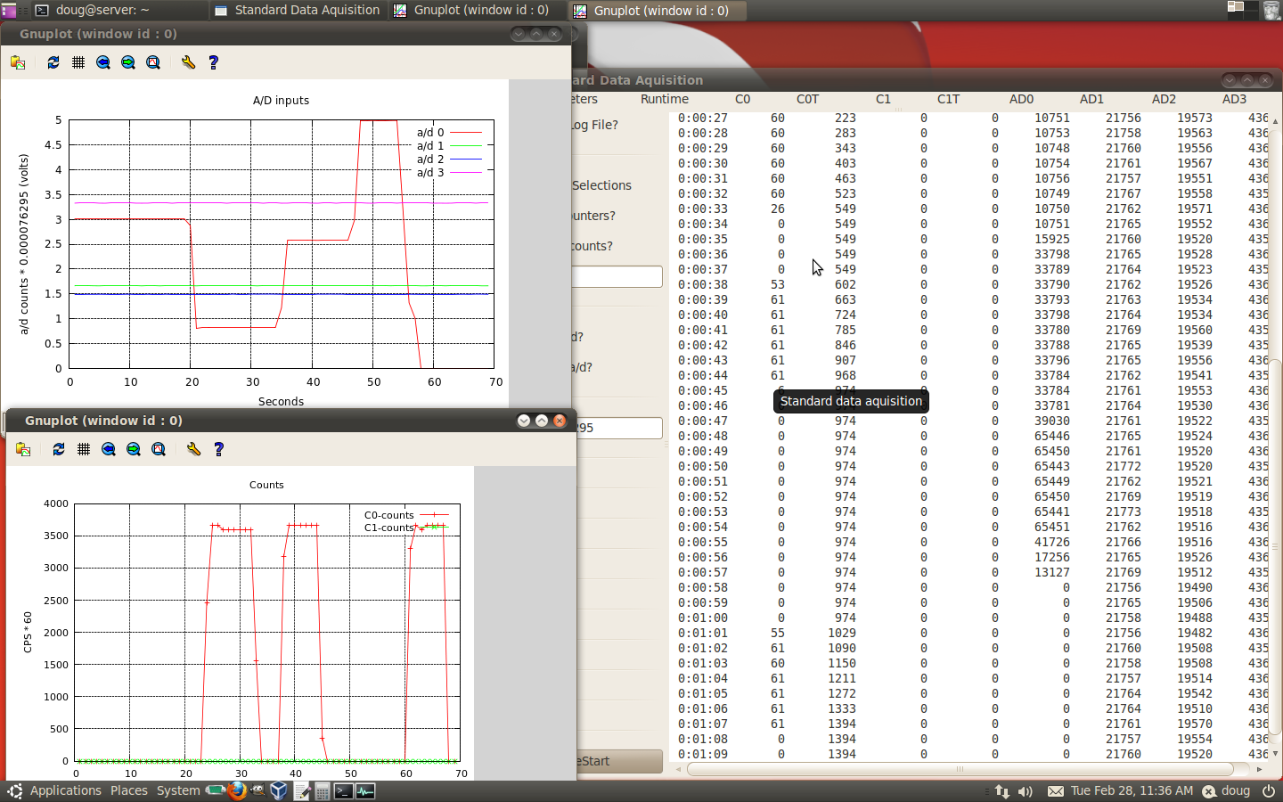

And here is the promised screenshot, kind of small as it was taken on a small screen, duh.
On the small screen of my dev server
As you can see, I'm turning one of the a/d inputs up and down with a pot across the supply, the others are hard wired to various references, and I touched a floating cmos counter input a couple times to pick up the power frequency. More impressive if I had a CCFL on nearby, but I've replaced most of those now with LEDs that don't make the big signal at khz. I allow you to type in scaling factors for counters and a/d, and the defaults are conversion to cpm for counters and volts for a/d.

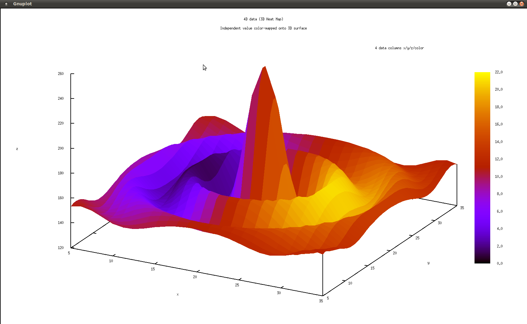

Just to communicate where I want to wind up here - here's a 4-d plot...which would nicely cover say, volts, ma, pressure, and neutrons out of a fusor. This is a kind of dumb example, and a scatter plot (rather than smoothed contours) is more like what I have in mind - along with the possibility of combining more data from multiple runs and so on, but this is kind of what I'm seeing in my head while working on this.
4-d plot
4-d plot
This took only a few lines fed to gnuplot to generate, since it's just plotting some numeric functions it can calculate itself.
