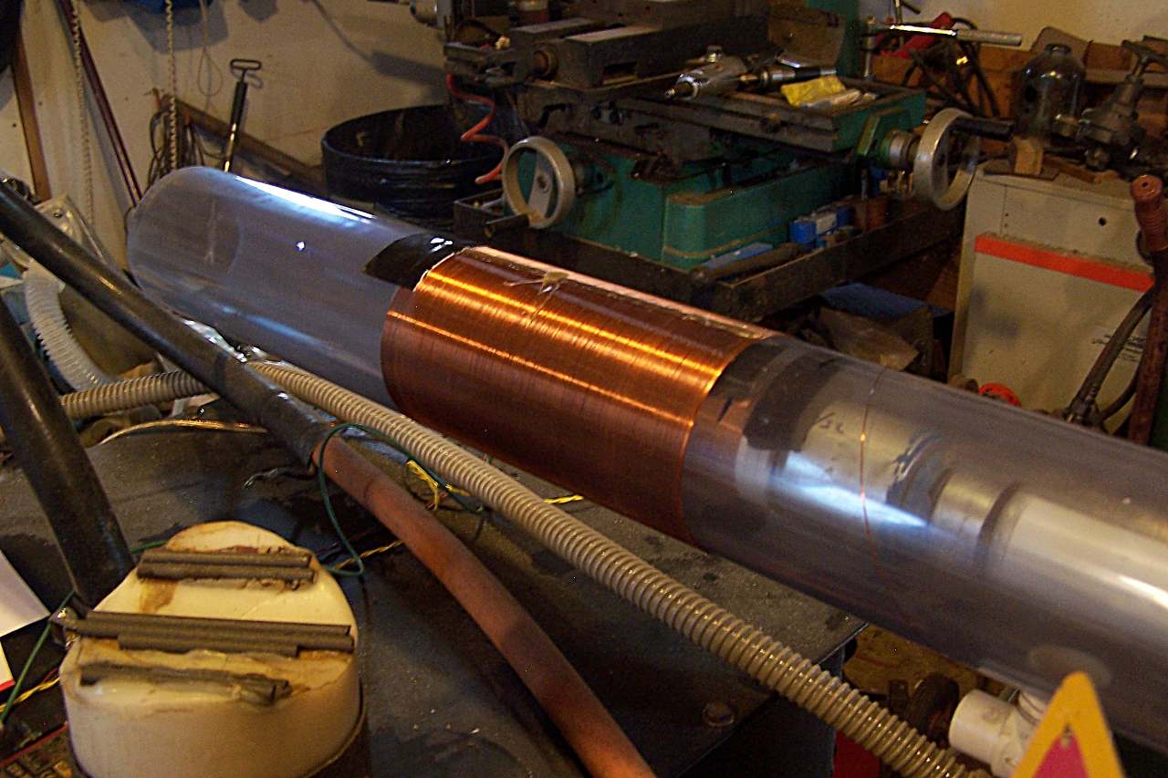

I just finished winding the secondary coil for the transformer. The primary is in series with the DC feed to the main grid. It has about a 3-4::1 stepdown (turns ratio anyway) and even though fine-pitch, may not go low enough in frequency to "go the right speed" - after all, we DO certainly have more than one species here - and we don't even know which one we want to be driving the oscillation! But we'll know...that's what lab time is for.
Since a picture is worth a lot of words and so on...
Obviously I have a little more to do before this sees power. The bigger pipe is sched 80, for insulation. There is an 8" diameter wire-screened outer pipe not shown - this whole mess is more or less the center conductor of a large piece of coax, to keep EMI out of my other stuff - it can get pretty fierce otherwise. The secondary here will be connected in series with the little supply (and ballast) that normally drives the secondary grid. Both supplies have a lot of series R, for safety. We have so much power gain, I'm not going to worry about the losses there for now, it almost oscillates by itself anyway, from coupling inside the tank, but at some wierd, very high frequency (working more like a regular electron tube it seems). This should put it more on a basis of us choosing the frequency and which particles are sloshing back and forth how far and fast.

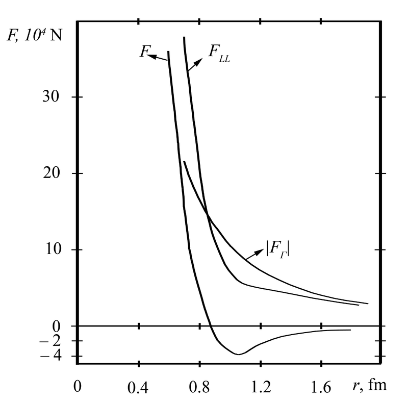

Here's the wiki article that's from: http://en.wikipedia.org/wiki/Nuclear_force
According to the wikipedia article (a lot of these have been getting recent edits that make them more useful, the timing is interesting here) - the very right edge, about 1.8fm, is where the nuclear force overcomes the Coloumb force for two protons. Well, our case is a little more complex than that, since we have deuterons (and other stuff I'll ignore for the moment- but be honest about ignoring it).
We have a pair, assuming the correct spin combo (50% chance) so the nuclear force is double what is shown in the graph, though the Coloumb is just what the graph shows, since tne neutrons in the D's don't have any. Outside 1.8 (or a little further due to the more-nucleons, but only a little) fM - we have to hope for quantum tunneling into fusion, which is a probabilstic thing with more probability the closer and longer they are together - and this is where the electrons might be helping us linger longer inside the area where tunneling might be able to happen - the probability goes up with closeness (it's 100% inside 1.8 fm) and time...
