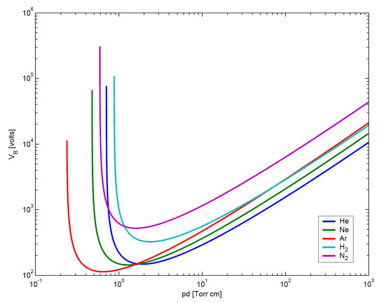

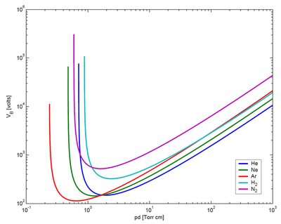

During one of the times I got drowned out, what I was trying to explain is that our secondary grid, out in the larger tank, could light due to Paschen's law allowing a discharge to start at a lower voltage due to the higher distance. This is counter-intuitive at first, because most people have been taught that electricity always takes the shortest/straigtest path. Well, it doesn't always - seen a straight lightening bolt?
Here's a picture of the Paschen curve:
From here, which explains why this is as well as I could myself. It boils down to electrons (there are always a few free from things like cosmic rays) either gaining enough energy from the field between collisions to ionize (knock an electron off a gas atom) or not. The X axis is therefore PxD (pressure times distance) and we are working on the left, steep side of this curve. Thus, even when 50kv can't "light off" over a 2.5" distance (outside of main grid to inside of 6" sidearm), it can light off over a ~14" distance at a lower voltage (5-10kv in our case) from our ion generator grid. For those into the actual numbers, we go out at around 2.2e-2 millibar, which is actually about half that if I believe the documentation on the PKR-251 pressure gage we use - it reads about factor of two high on hydrogen, according to them. For those really into numbers, there are 760 torr for one bar (atmosphere) so the conversion from millibar to torr is to multiply millibars by 0.76 to get torr. Going the other way, by 1.315789474.
Actually, for giggles (and learning) I just calculated. Our D is 6.35 cm. If I use that factor of two high, I can't make this work at all - looks like the Pfeiffer dox are just wrong when it comes to D, and the gage is reading right at 2.2e-2 mbar - then the Paschen's law calculation comes out as pxd = 0.106172, nope, oops, that's still off by factor 10 or so at the volts we have. Could it be some of the main grid field reaches out into the larger tank to get more D? Most good science doesn't come from "eureka" moments, it comes from "that's funny" types of things, this is obviously something I have to look into some more...We ARE pretty sure we don't have an even field distribution most of the time, certainly not when it's lit. But when it isn't - the place where Paschen's law works - we should have a fairly uniform one circumferentially, we work hard on making that true. And those lines are going pretty much straight up where the wiki chart stops bothering to plot...Could it be that despite our efforts to have real purity (our vacuum system base pressue hovers around 1e-8 mbar) we have a Penning effect? Now that one passes the R Feynman test - I can take it to the lab and test that prediction easily. And in fact, when we take the tank to STP so I can stick my hand in there to do something, guess what we use? Argon, dry nitrogen, or helium, depending on what's handy nearby at the time.

Why is the curve is U shaped? At high pressures, it takes a lot of field for an electron to gain much energy before it hits something, so it takes high voltages to "light off" a discharge. At very low pressures, an electron might go all the way across a tank and not hit anything but the other tank wall. Make sense? It also turns out that if electrons are going super-fast the chances of ionizing an atom they graze are less - they're just not around long enough to have much effect, which is partly why the left side of this curve is steeper than the right side.
