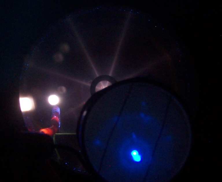

Just to start the ball rolling here. We've used a charged-particle pinhole camera as a diagnostic for the fusor (and we're lucky we didn't melt it back then). It looks like this in operation:
Pinhole camera, probably showing energetic electrons mostly.
At least back when we weren't making much fusion and/or putting in a ton of power - the fusor today would evaporate both the lead front and burn out the screen. Yes, I'm looking into other ways to make a more robust screen, among other things. This one lacked even an aluminum flash layer but worked anyway.
