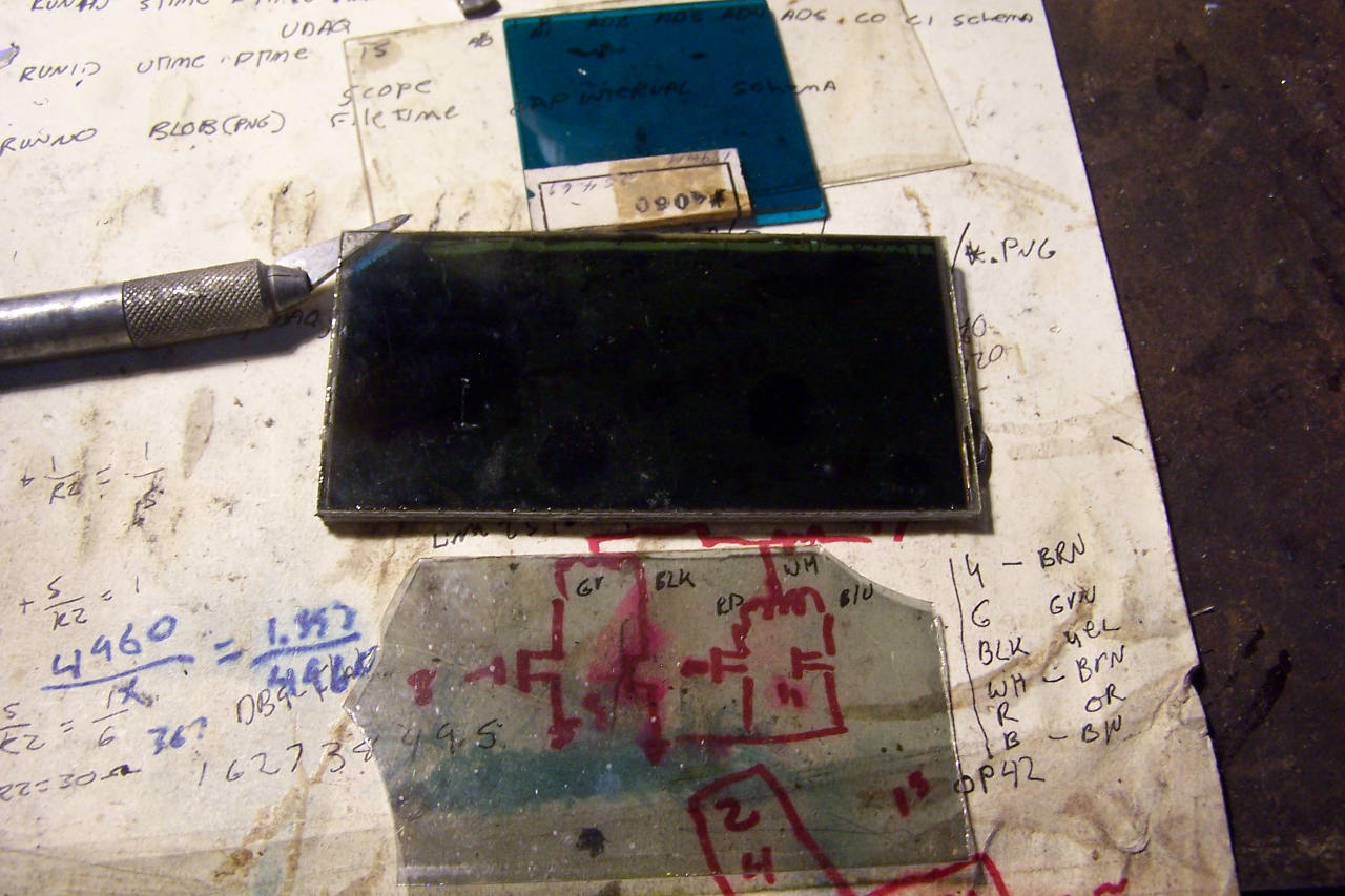

I had an old welding goggle glass, the kind that has a LCD "instant dark", which had gone bad, but I saved the many layer laminate for who knows what reason. Well, after some belt sanding around the edges to heat and remove some of the glue, I managed to pry off some small pieces of the thinner outer layer, which seems to be a pretty good IR block at the near end where it matters (the camera can't see my soldering iron cranked to 900f - that's far IR).
Doing this shattered the filter layer (that's what I assume it was since it works, kind of) into small pieces, but the pi camera lens is tiny...so I taped one over it. BTW, these are originally high rex pix that I severely cropped - the Mr Heater was 20 feet off.

Yes, I've been experimenting with a very thin, looks like an interference filter, carefully pried from a welding goggle "instant dark" LCD. Helps a lot with one layer. Thing is, these also block some normal visible - probably in the 50% range, and we have low light in the fusor, so multiple layers don't work out so well (and in fact I just tested that with the propane heater - it's a little better with two, but the "dark noise" goes way up). For fusion, any atom slow enough to still have an electron falling through the energy levels and giving off light is a lost one - this is something most people who look at poissers don't understand. You're only seeing the stuff that had no chance at all for fusion. The stuff that fuses has no electrons...thus no photons come off, and is moving so fast by comparison to everything else it won't pick up an electron either.

It looks like my problem is in the VERY near IR here, and most of the IR stop filters seem to start working at too long a wavelength vis the passband of the blue filter (or even the red one) in the cameras I can get. I really want to stop even dull red - from the very edge of what the eye can see, because I don't care if something is dull red hot or only visibly incandescent in total darkness, explaining my guess at 700 or so nM above as the short end. Silicon looks like it's really dead by ~1200, the reason for my other end of specification, but longer - no problem, I don't want any of that stuff, but the silicon itself won't let that stuff past the bandgap.
I believe the lower stuff in this picture, carefully separated from some defective welding goggles (well, I cracked it a little, it's very thin - .021") is more or less the "hot mirror" you are talking about, but I will go check specs on that too. This looks like a mirror on both sides at the right light angle, I think it's an interference type. Two layers are no better than one, but two block more of what I want to keep. According to John Strong's "Procedures in Experimental Physics" what I want is about what a 2% solution of CuCl2 in water 1 cm thick gives me - very sharp cutoff at the edge of visible. I might just try that, I've got microscope slides I can make a cell out of. That blue-green glass at the top of the pic is pretty good too, but obviously messes with the color balance in the visible. I can't even find specs on this one anymore "Corning #4060" is what it's marked - it was in a set of boxes of filters my master scrounger friend (BillF) got awhile back - it's probably around the same age as I.
Edit: Yeah, I checked Edmund...I think I've already got what amounts to the same stuff. Stops cutting while still in the range of silicon...down at the long end, and not enough cut at the short end either - too narrow for this, or so it seems.
I guess you'd need two filters with overlapping stop bands or something.
