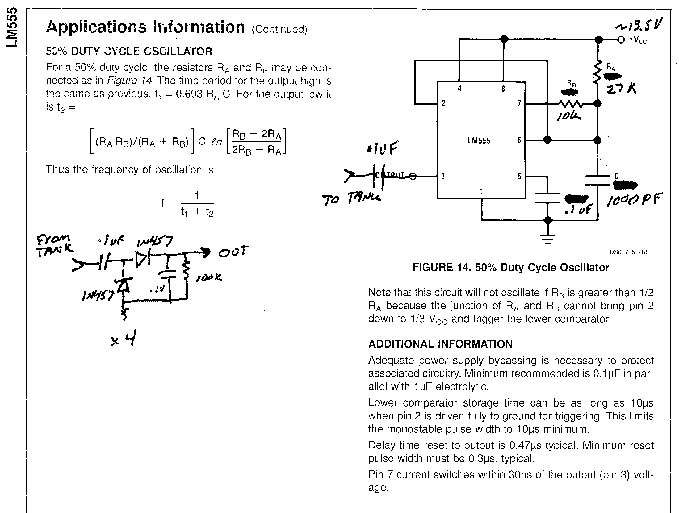

The circuit I designed (well, kinda a design, more of a copy) looks like this:
Just a mostly square wave oscillator and a bunch of volt doublers.
Totally old-skool. I even used a 555 for the oscillator, as I had a few new-old-stock laying around, and they seem like being available for another decade or more when I might need a spare. Also, I can run a fairly high voltage on these, off my 13.5v gel cell UPS system associated with my water pumping stuff - I use a 12v spot sprayer pump to pressurize plumbing. Other than being noisy, it's ideal (and I may add a reservoir designed to cut the noise). When you are dependent on rain, or going and hauling water, you want to know when the pump's going - you don't waste one drop on leaky plumbing/faucets and toilet ball-cocks. A drip can fill (or in this case, empty) an ocean. So the noisy pump is kind of useful for knowing if there's an issue, for now. I'm using all qest/pex these days - it can freeze and not break...nice. And it never, ever leaks, along with Kohler fixtures in the sinks etc. For the loo, I get whatever the hardware store guy says is best, and wind up putting in a new one about every two years. Life!
I did add some power supply bypassing to this circuit that isn't shown. .1 uF and 220uF at 25v.

I used 1n457 diodes. They are what was laying around and are super low leakage. I looked at germanium, as less forward drop might be better, but it looks like the odd 1n34a's I have are too leaky. Schottky might be fine or better. At 100k load resistance, I doubt forward drop is a really big deal anyway...

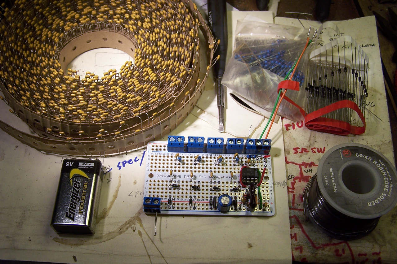

The built board looks like this.
Actual hardware
Actual hardware
It bench tests, less than 1/4" of the drive and sense electrodes make this put out cmos logic levels in a test basin on the bench - as in 5+ volts output. In the real application, since I want the other arduino pins for the DHT22's and driving valve solenoids and such - I'm using the a/d inputs for this, which will allow tuning the software vs having to fiddle too much with changing the actual wire lengths and positioning. There will of course be a lot more on this project...homesteading ain't for old guys and I'm getting there. It's like a race with time to see how much I can automate before I get too old to do things by hand.
