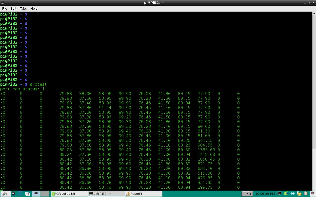

And here's some simple pi perl to look at it all:
ardtest.bz2
For the pi or pc (you'll need the Device::SerialPort module)
(1.05 KiB) Downloaded 508 times
Right now, it just prints out all the numbers - water level, then the two counters, then 3 temp/humidities, one temp from thermocouple, and the state of the two valve driver outputs. This will soon be going into a mySQL database in the pi, from which gnuplot will make plots and put them on a web page so I can see all this data as plots however far back I ask for on the CGI form....finally.
It should look sort of like this:
Screenshot from the pi
You can see that last temperature number go nuts as I held a flame under the thermocouple. That one is intended to monitor a wood stove, so it couldn't be a silicon type sensor.
