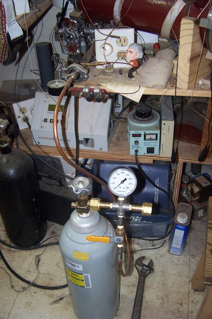

Yes, that was spendy indeed. You'd have liked what I did with the little hospital, tanks I think. I turned them enough to wipe off the labels and dings (but leave the stamped numbers), then powder coated them red. Bill had scored a bunch of CGA 350 valves for H, but they had tank ends that were too large and wrong thread for the O2 tanks. They had plenty of meat on them, though, so with some disassembly I was able to turn them down on the lathe and re-thread them to fit the tanks. I put them in with teflon tape and a teflon gasket, with a bit of fuel type pipe dope to keep them from screwing back out. I then put a few in my big vacuum tank with the valves open, and baked all day for a few days till I got back to near my usual base pressure. Then I backfilled the tank with argon, reached in and closed all the valves. That made them ready for my filling jig, which is a fairly simple affair.
Transfer plumbing
Transfer plumbing
The gage, and my sense of safety limit this to 400psi output (only three times the ball valve rating, after all). To control the rate of flow, I tapped the inside of the supply side CGA 1/4-20 and screwed a threaded rod in there tight -- and you still have to be a bit careful on the supply tank valve or it's too fast. The ball valve lets me take the argon out of the receiving tank, pull it down to maybe e-5 millibar along with the inter tank plumbing, then shut off and do the xfer. After that, refills are easy, since you don't have to evacuate the receiving tank again.
