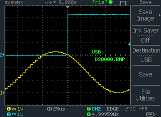

While I have not yet tested the A/D performance on the Teensy (coming up, one thing at a time) - the D/A is nicely quick, around 3.5 us/sample when fishing samples out of a table. I also need interrupts for this project, so I wrote a little test. I make a sine table of 50 samples at startup and push that out to the D/A, then wait 5uS and do the next sample. I set up an interrupt from timer one to go 10 Hz, and watched to see if there were any issues (like the famous "pentium pause") - but nope, after a couple days, they're still in the same exact sync as when it first powered up with this sketch. Not too shabby...I will go on to other tests and provide the code for those as well, but here's the picture - same one for about 72 hours of running, not one sample off. I had the scope triggering on the interrupt which also toggled the LED pin, so it's showing 5 hz, or a very close approximation - at that many digits, it's hard to tell which one is closer to the truth - this is darned good.
Scope triggering on 10 hz sq wave and showing D/A output as well.

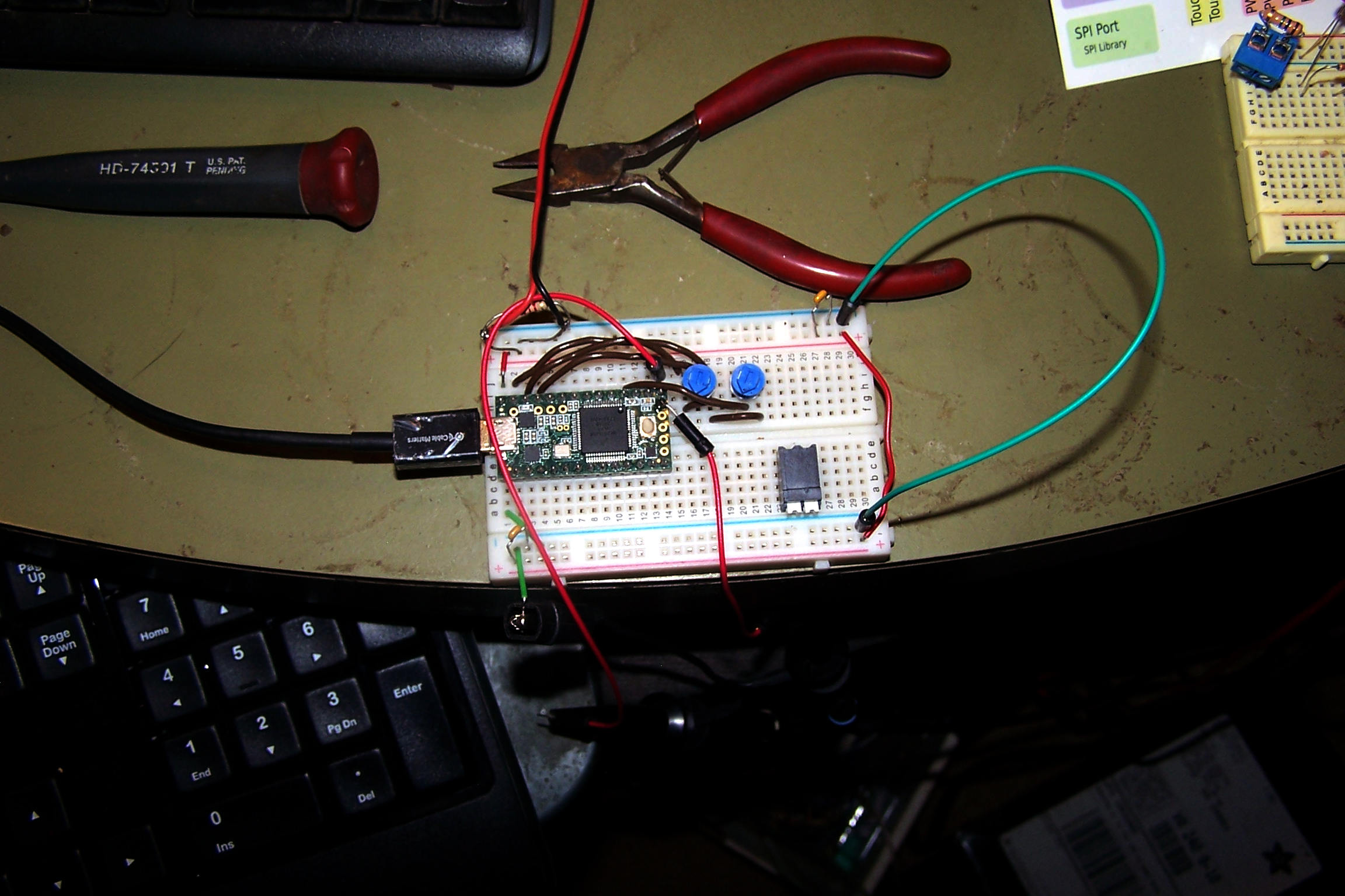

They named them right - here's my test rig for the current project, so I can test without having it in the (currently chilly) shop hooked up to all the big power supplies and so on. I'll be blowing a signal generator into some of the inputs to tune the PID to the point of it "being on the right page" - but the code allows for remote tuning as well. The tuning parameters are stored in eeprom under host command, which is convenient.
Code du jour is for an ion grid supply controller, which will at some point also control the gas inlet and outlet valves for the fusor - bascially, when the ion gun refuses to draw current, it will let in gas. When the main grid refuses to draw the desired current, even with the ion source off - it'll let some out. Kind of "if the PID loop for ion control hits a stop - do something else - get things back into the operating control range". This uses my now-standard human-readable master-slave protocol, which allows for "unit numbers" when used in a wired-or setup with a raspberry pi (or other serial) master as well. Unit numbers are not required so much when on USB, but it was easy to just copy the code from elsewhere and replace the commands with ones unique to this job, as usual - pretty much all (no exceptions so far) of the older arduino code just comes over, but some things are nicer if you use the teensy libraries instead, as the hardware has all kinds of nifty features...ring-buffer DMA A/D, you betcha. You do have to pay attention to one thing - ints on this machine are 32 bits, not 16 like on an uno - so you have to pay attention if you're using something that depends on a rollover or that size.
