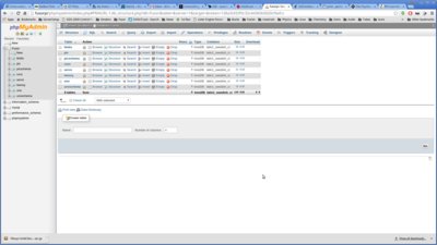

I decided to start with a relational database model. This defines what I want to acquire, what I store about how I acquired it (things like what's connected to what data aq input and scaling factors, units, you name it), and which data aq happens to be going on which run, along with comments and the usual other stuff one wants for documentation. Having done that, the rest is a lot easier, the tasks divide themselves up fairly well - I could even get software help to write some of the pieces now, not having to totally depend on "great mind runs in the same track" at this point, though for now, it's all me doing it. Along the way, I have and will continue to find gotchas and workarounds, which I will document here on the board to save others from some of the grief I've had getting this all going, there are a few oddball things one has to do "not quite like the web tutorials" say. Those may not go in this thread if they have more general applicability - I'll try (it's impossible to get it perfect) to put them someplace meaningful, given what they are about.

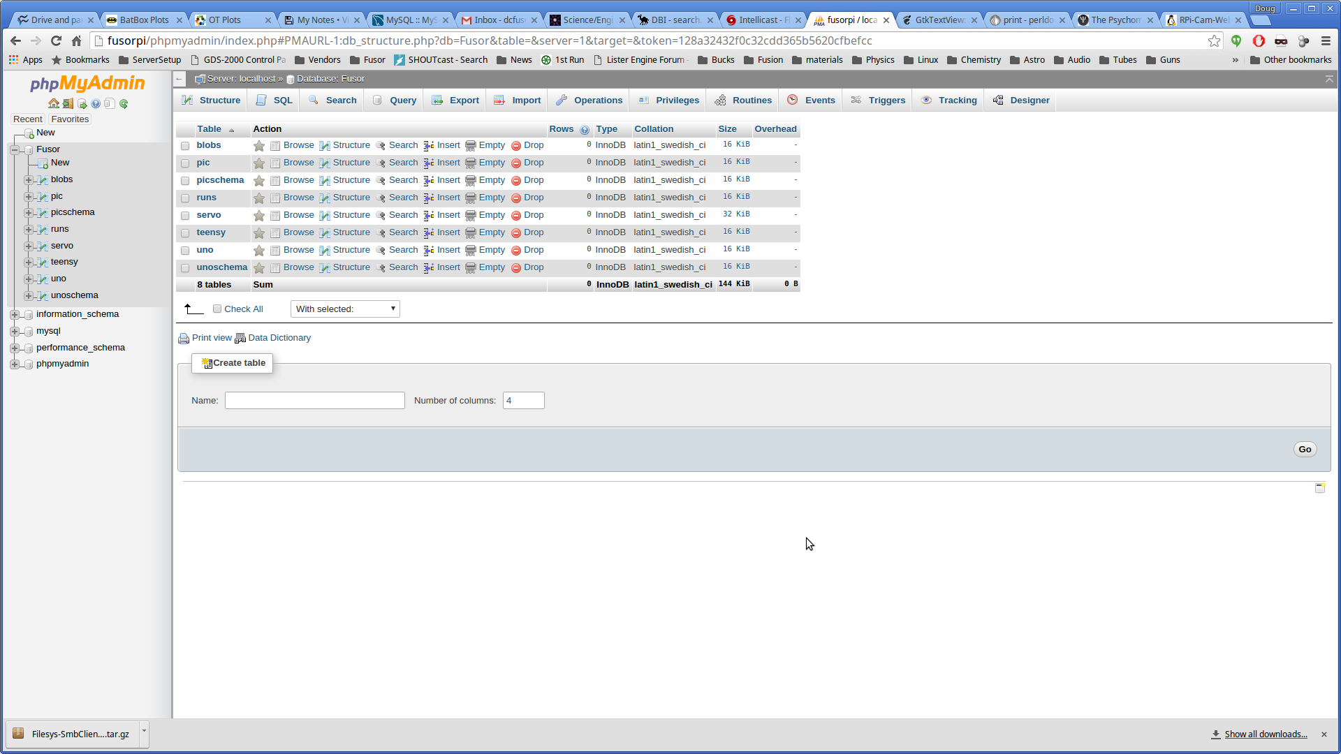

Here are some screenshots of the current state of things:
Database, served from fusorpi, overview

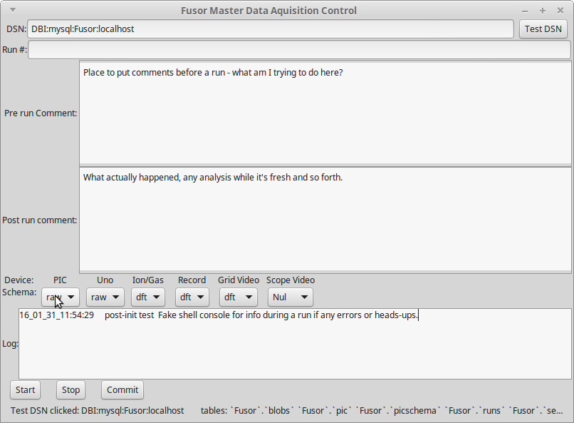

This is my main screen (not finished!) for the control room, running on a computer local the the room. In real life, it will run on the fusor-proximate machine and be used via xTightVNC.
Local program to control the stuff in the danger zone from a safe place.  Not finished!

Since all this stuff is in kind of a fluid state, I'm not yet posting the SQL for the database structure, or most of the code yet. If someone is in a hurry to see it, let me know, but you can count on it not being compete yet.

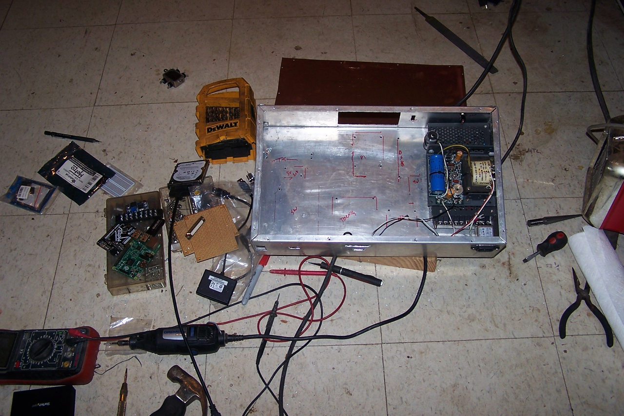

Bit by bit (heh), hole by hole...coming along. The new ops position is nice, and finally it's warm enough to resume hardware work in my shop without killing my heating budget (since I've moved to another building and the shop takes 2+ days of heat to get reasonable - all that thermal mass).
Not that pretty unless you just drilled all those holes and tapped a few in an age-old wrong-alloy Al chassis. You can almost cut this stuff with an exacto knife, but that's not a good thing when it comes to drills skating, burrs, warping...about the one good thing you can say about this 1950 alloy (inherited from my Dad) is that if you center punch one side, you can then see the bump on the other, re-punch and drill from the easy side after laying it out on the inside.
Already test mounted are two lamba power supplies. One 5v and +/-12, the other 40 and 20v for running solenoids in the gas control system (and to be switched down by "simple switchers" for other uses).
The box will contain:
1. Fiber<>100baseT converter - galvanic isolation from my LAN.
2. 8 port switch - for the internal pi, and two external ones that are basically just video cameras/recorders
3. an arduino uno (running off a separate 9v supply so it's internal 5v regulator is used for a/d ref - more stable than USB) - this is the main numeric data aq and will also do a geiger and one neutron (hornyak) detector. Using an uno for that fast hardware counter for the neutron detector - teensy doesn't have an externally accessible one, and if history is a guide, we have the need for speed - we can't just count interrupts.
4. a teensy 3.2 which is going to be the main pid loop controlling the ion source to keep the main grid inside set parameters for current draw, and also control the gas system to keep things in range for the ion grid control.
5. The local master Pi (with 2 TB disk drive), which runs all this, a mysql database, has a camera of its own, and can drive some servos for tuning "the magic". The sql database will be auto replicated to the op position here and be plotted from that in near real time.
6. A probably useless touchscreen for that pi. In real life, it'll be run via VNC from here. Too cool to leave out for later photos, though.
7. the 800v power supply for our standard geiger tube.
8. signal conditioning and various supply isolators to get clean power for this and that. Various servo drivers and things like reset signal generators to make various computers shut down clean, and a clapboard signal to get time-sync.
Big box, but there will be a lot in it. It's going to be stacked with our big Spellman power supply in what I hope is a fairly quiet EMI environment. Just in case, few holes, galvanic isolation from the LAN, and yes, that piece of copper clad board bolted over the box opening.

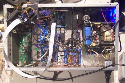

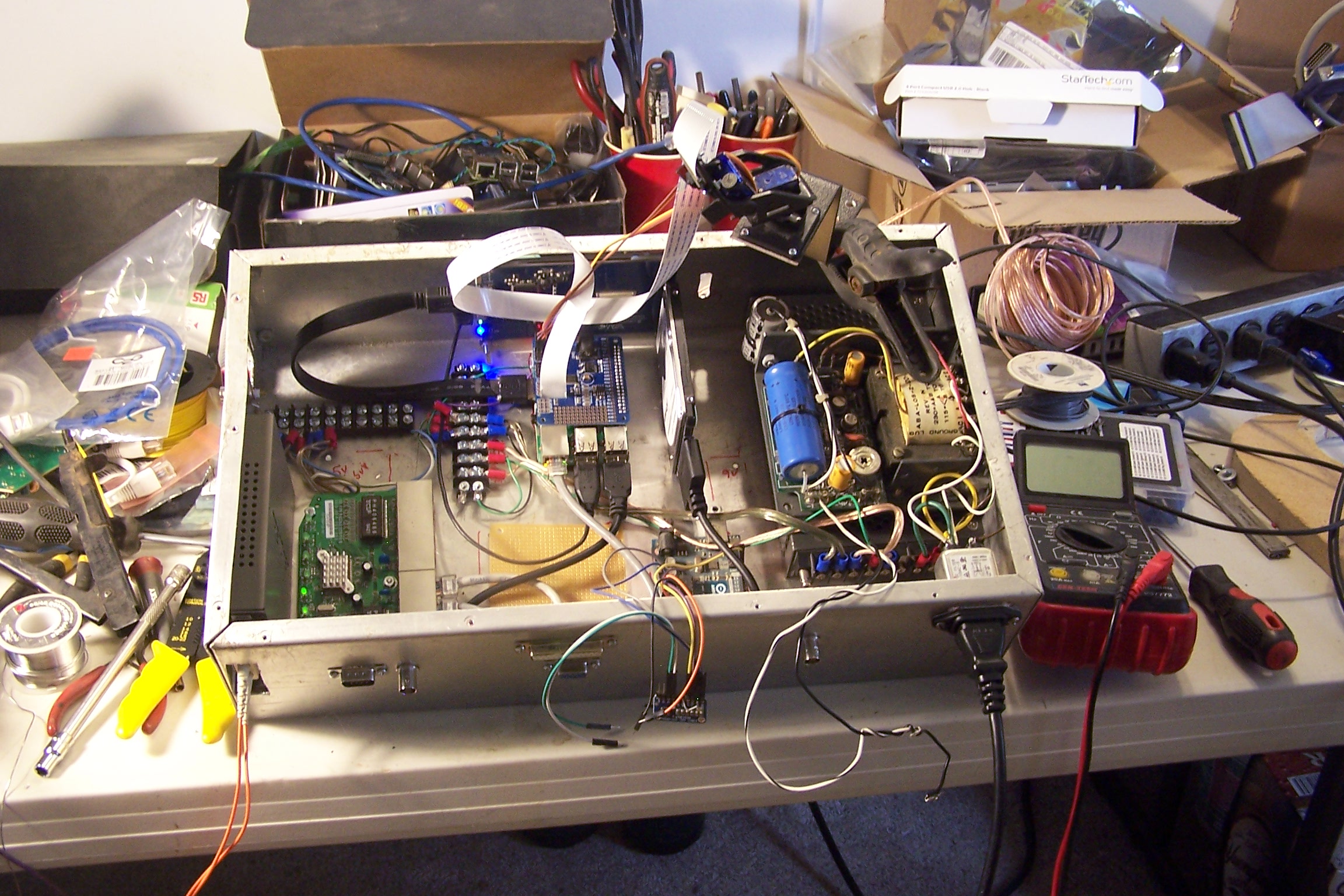

Little by little...burning some of this in before moving on to complete the rest. It looks like this now:
Remote controller, for fusor position
There are two Lamba power supplies to run this - one is +5v and +/-12v, and hiding it on top is one that is 24v and 45v, mainly to run gas control solenoids, but also I will be switching some of the 24v down with "simple switchers" for supplemental 5v and 9v for the Teensy and Arduino Uno that do the real-time work.
The Raspberry Pi in the upper center is to provide ethernet, a camera interface, and to control the real time uP's and put gathered data into a MySQL database - general linux stuff. There is a 5" touchscreen on top (the guy with the blue led) which I will use mostly for debugging and perhaps an emergency "scram", though if I need that, I shouldn't be in the room - the entire point of this exercise.
The grey box in the lower left is a trend-net ethernet to multimode fiber converter (100mbit as is all this in the box). I want galvanic isolation from the rest of my lan in the event of an arc or other EMI. Just to the right of that, with the green lights, is a generic 8 port ethernet switch, for this pi, the fiber converter, and two other pis that will have video cameras recording the scope and the tank insides. The main pi here also has a cam, with pan-tilt, but is just for looking around in the room - you never know what you don't know or will need, it seemed reasonable to provide for "what in the world is going on over there?". As in, should I shut it down, run over with a fire extinguisher, bolt cutters, what? All 3 cams will also be live-streaming to the operating position so I can watch it all and hopefully notice useful things.
The DB connectors on the bottom are for connection to two Spellman power supplies (main and ion source) which will be controlled by the Teensy, which is yet to be mounted on the brown perf board. One other db-9 is for some of the hard wires coming from the op position - for those "just in case" things if the network goes down - safety first. There are some BNC's for the geiger counter, the neutron detector (hornyak) and the tank pressure gage, which will be used as a backup in controlling the gas pressure and ion current (it will handle outlier cases such as a power supply shutting down without warning, so the control loop won't pump in more deuterium wastefully and so on).
The slot in the upper left is for the cables from the slaved pi cameras, including ethernet, power and force clean shutdown signals. The slot in the center right top is for the main pi camera cable and servo wires. Mounted just to the right of the Pi is a 2 terabyte laptop drive. The pi software (Jessie) is configured now so only /boot is on the SD card, the rest is on that drive, including all the data collection. More atoms per bit will be more reliable in noise and radiation flux, and the disk should provide just that. There's every indication this setup is very reliable - but we have belts on top of suspenders and a reserve 'chute just because - that's some expensive gear and I don't want to be helplessly watching it burn up from 70 feet away.
There is therefore also a buried, armored Telco grade 6 pair cable that will provide positive power shutdown to the entire rig, bring back realtime audio for recording at this end (it's getting tight in that box), and give me some other interlocks and indicators that work "no matter what".

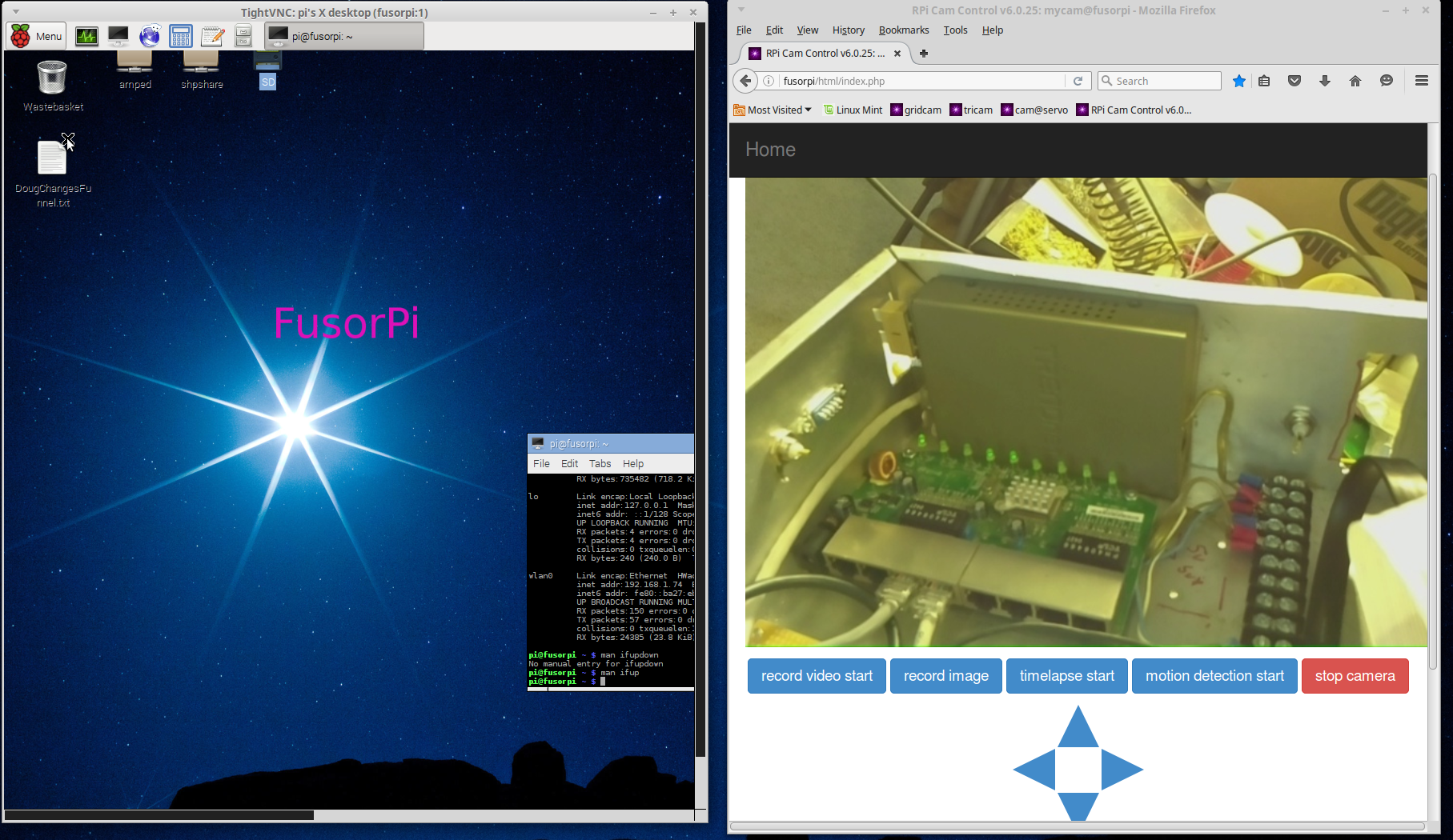

Looks pretty good from here at the op position (this stuff is in the next room right now).
VNC desktop and self-poitrait shrunk a little to fit on one screen.  In real operation, I have 6 high resolution screens - but that's a heck of an up or download to here.

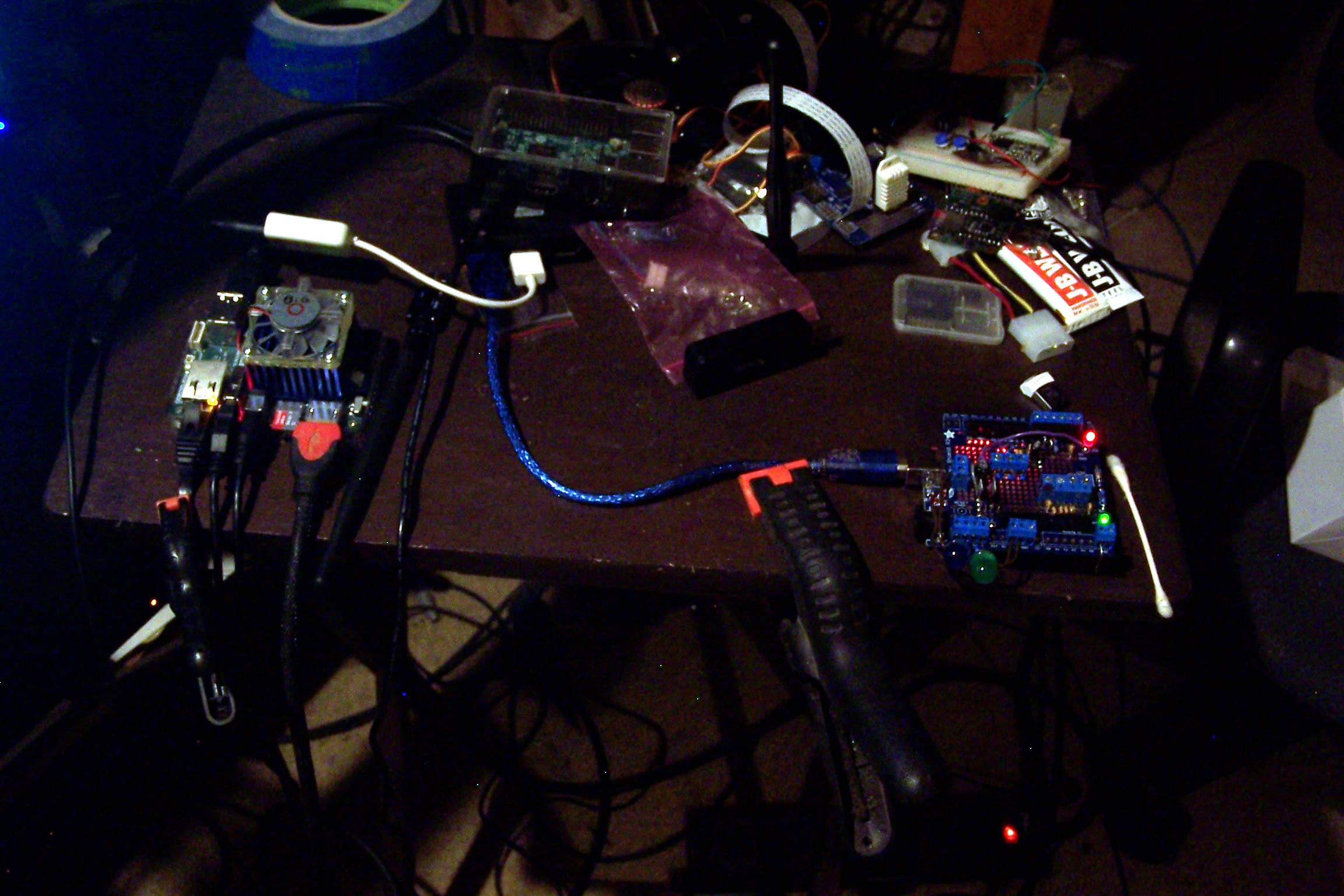

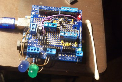

I'm doing the arduimo development on version 1.6.10 on an odroid XU4 running debian 8 - it's fine for that, and the same code will run on the pi-3 in the box, so I'll be able to make changes easily even after it's all mounted up and across the yard, from here. So I thought it'd be fun to take a pic of the dev system (sans display and keyboard which are on another table).
Dev setup, with some LEDs pretending to be solenoids.
Or just the arduino and ancillary parts on a "screw shield".
About ready to mount up.

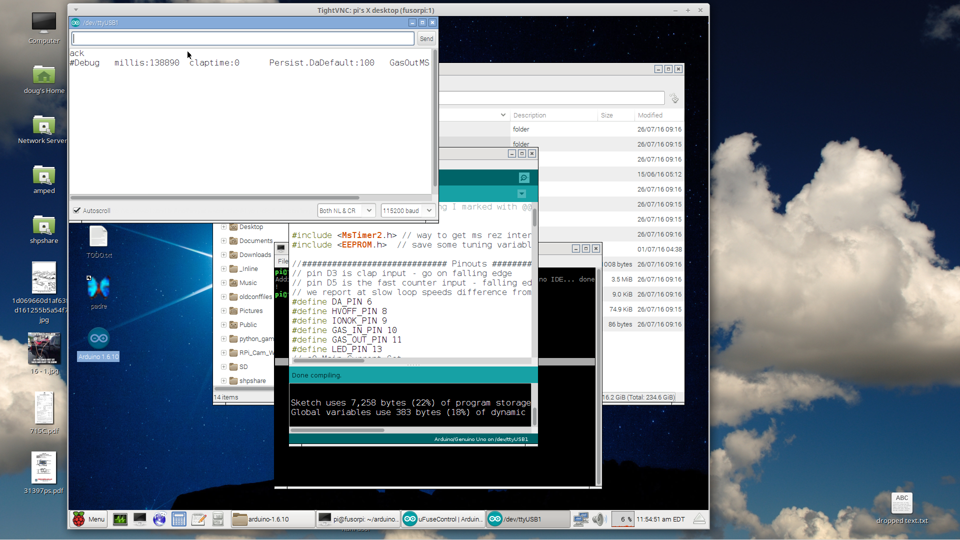

And now it's in place, though not totally wired up yet. A couple vanity shots:
Remote arduino dev on nuc via a pi in the fusor control box...heh.  A good worker gets the good tools going on.

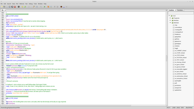

Edit to add this -you can see why despite it's few bugs and quirks I like padre for perl editing..Easy to navigate big things, and one syntax error and everything after that changes color to warn you that you've messed up. Good tools...
Good for finding stuff.  I use gedit too.

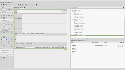

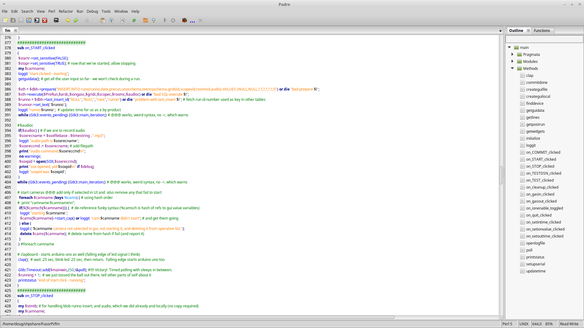

And this. I think one reason there aren't more decent GUI programs in linux is few master this tool and know what to do with the crazy XML it creates. Worth the effort for me. Not that this is a great GUI, just one suited to this particular user...
What I actually edit for a GUI - not all that nasty XML this makes.

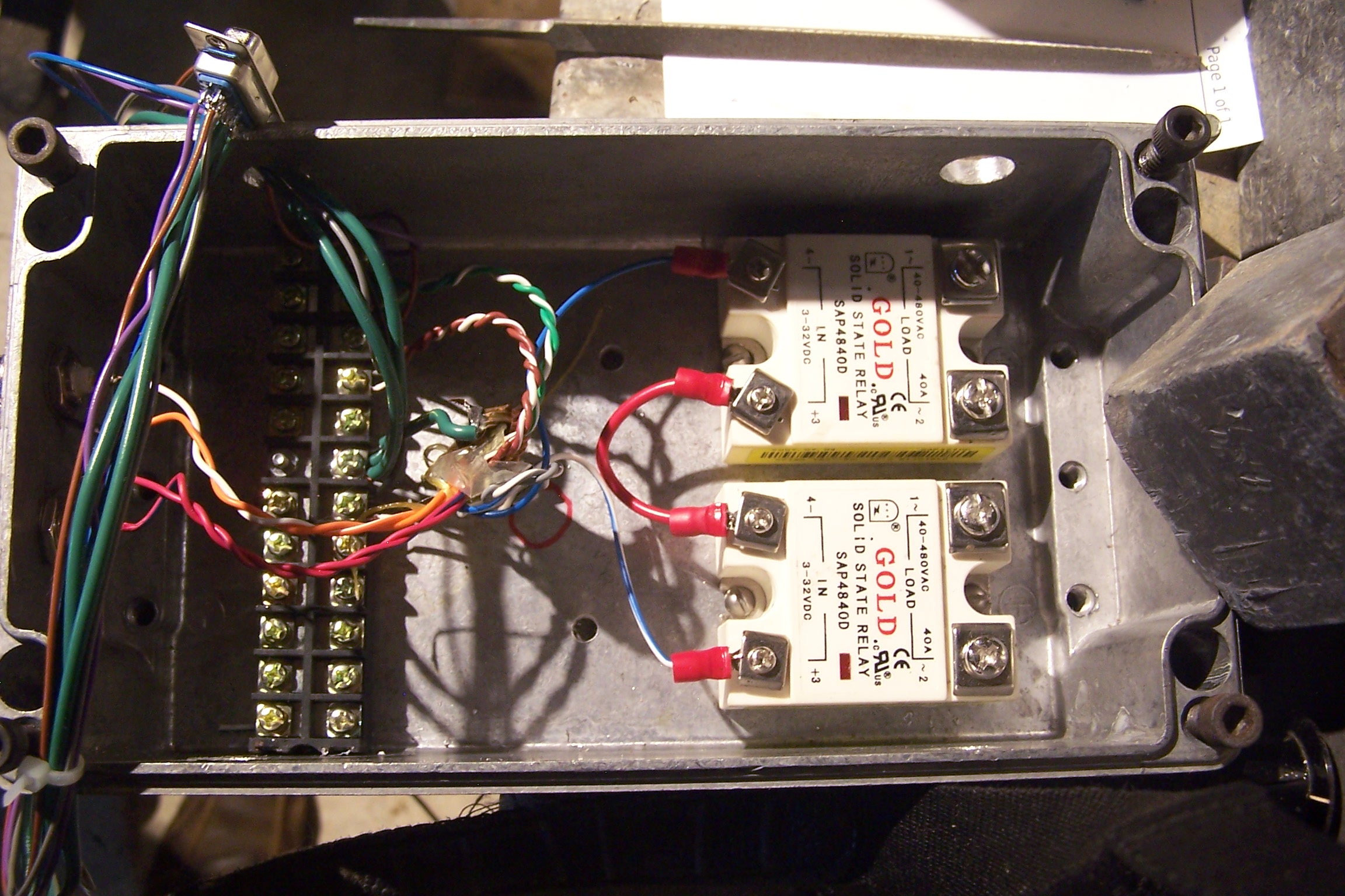

In addition to the more fun computer parts of this, I wanted a "no fail" backup shutdown. One serious exposure was enough. A friend (Thanks Paul) donated a roll of telco armored burial cable.
Bill helped me wire up the tedious parts.
Yes, this might be a little overboard on safety but...like a reserve chute, it's nice to have. I did my best to design and route the critical signals such that either an open or short to ground would force a shutdown, for example. Not quite fission-reactor safety grade, but working on the same kind of idea here - no matter what else should fail, shut this thing down. False positive shutdowns will be tolerated for safety (since I don't lose money, just footsteps on one, I can be even more conservative in some ways).
Doesn't look like much either on paper schematic or this picture, but it sure makes me feel better. There were some wires left, so we push back zero latency audio, and a few indicators from the front panels of the power supplies too. But the stars of the show are those two big solid state relays which sill be in series with the 240v main power - even if either one fails short - we're off when we want it, as nothing goes between a phase and neutral in this design.
This will be bolted to the floor by the fusor and inline with the power to it.  Connects to my manual control panel described elsewhere.
Sorry autopilot and IoT fans. I've been around computers WAY too long to trust my life to one. Even if I wrote the code and built the thing.
