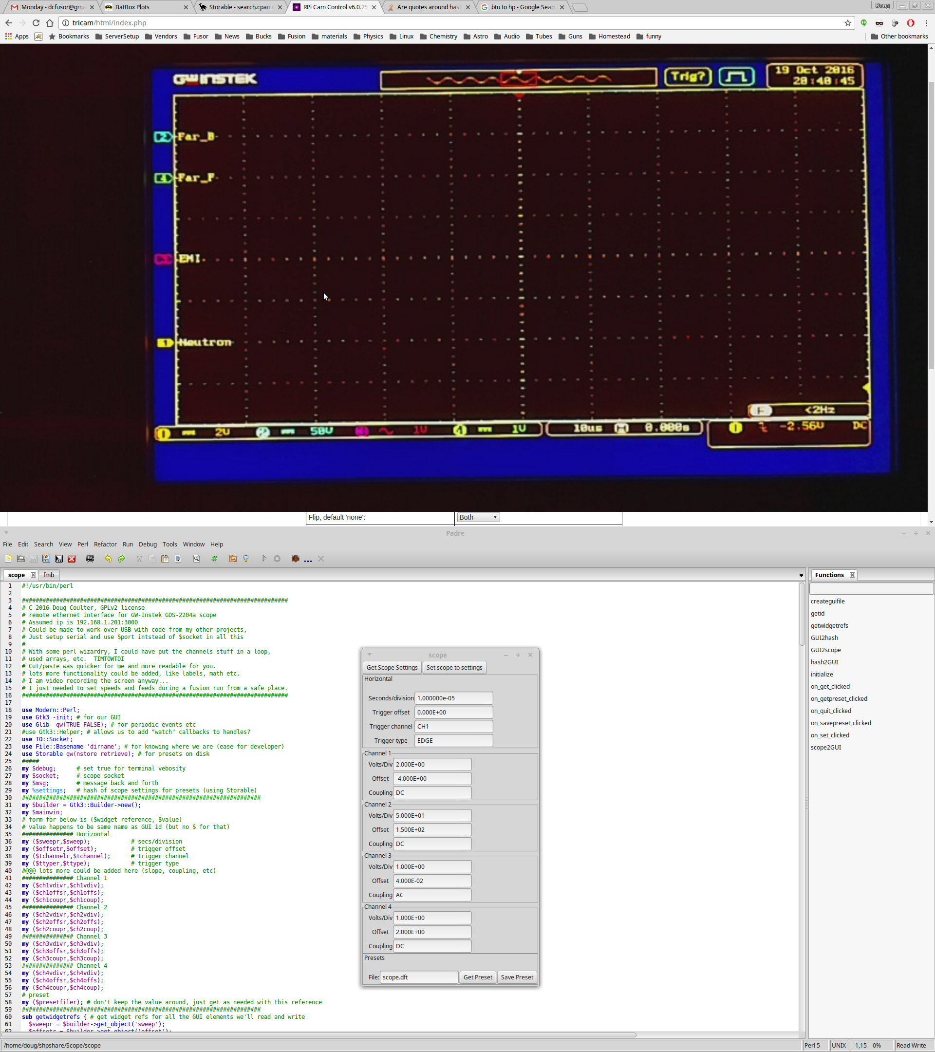

As part of the fusor data acquisition, we have a fast, 4 ch scope looking at some things were we want really good time resolution to tease apart causes and effects. So I purchased a really nice 4 channel 2.5GHz effective sample rate scope, a GDS-2204 for the setup. I also got the Ethernet and VGA addons for this so as to be able to both take video of what would have been on the screen (the built in screen is fine if you're in the room with it, but tiny for a pi camera), and control it somewhat during a run. By definition, I can't be in the room with this while the fusor is running, and last I checked, low noise scope preamp class gear that would let me send high impedance high frequency (in this case only 1 mhz) signals down coax to the operating position is around $2595 per channel (otherwise stated - more than that scope with addons, and it's faster too). [Citation Oct 2016 issue of Photonics magazine, Standford Research Systems Inc model SR560]
So! I wrote some perl (yes, I know, I have weird taste) to control some things from the remote operating position over Ethernet, and while it doesn't cover more than a fraction of the possible functionality, it's probably good enough for what we need during a run. We can always adjust things between runs too and save them remotely as defaults with this code. Or I can add more code to this, but even with 4 monitors, I'm not overwhelmed with extra pixels. The scope itself has a tree structure for many menus because there's only room for howevermany knobs (a lot). Same issues here, and I just needed good enough.
This code assumes Ethernet, 192.168.1.201:3000, but you could use my USB serial software and substitute port paths and $port for $socket in the code and it'd work that way too. Problem here is, USB isn't going to go as far as I am away from this when it's running. The main problem for anyone else to use this code is likely going to be getting all the perl modules it uses going with your linux distro (I recommend cpanminus and synaptic to get the dependencies sorted - in one case you need synaptic to get a C library's development version (see the cpanm build logs when you get errors). Sigh, it is what it is.
This software is in two files, one perl, one glade XML that defines the gui. It can create a preset file of any name you like, that will go in the same path as wherever the program files are (I use home/doug/bin, ymmv).
I have to say, that it's really cool to be able to develop this and watch it change things on the scope via a raspberry pi video camera over at the fusor - from here. Saves a lot of shoe leather.

On the other hand, this setup records, in a very tightly shielded Pi, the video, as well as showing it to me in a split-screen preview with other cams (hint, see the Vivaldi browser that lets you tile tabs).
What happens is that the pi cams record full rez and speed, and I send a somewhat reduced rez and speed preview to the op position, and all those cams fit on one monitor. The other 3 do plots, command and control GUIs I've written, and so forth. When a run is done, those external cams are commanded to copy their vids to the main pi, which then copies them, along with the SQL database it's been replicating all along - to the op position for later analysis. Thus I have a bit of redundancy, which in this case seems a good thing. It's just amazing how well you can shield both ends (the source of EMI and these data aq computers) and still crash them. Of course, EMI isn't the only game here - we are making enough neutrons for disruption and transmutation, and all the fusor-local computers are considered "sacrificial" as a result (and backed up out the wazoo remotely for quick replacement). This setup crashes a PC using ddr3 more or less instantly by corrupting its memory in the absence of any EMI my scope can see - just neutrons/gammas knocking electrons around...turns out running out of "rom" or at least larger capacitors in ram is not stupid in this environment.

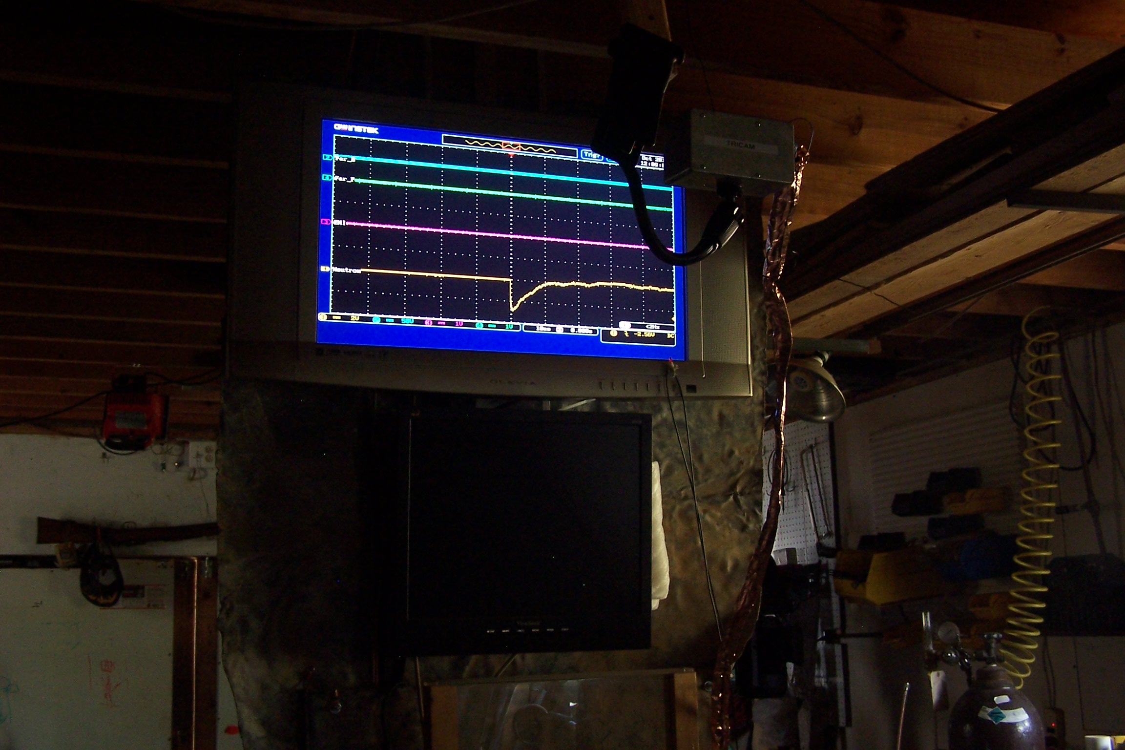

Here's the remote end.  Note, you can't see the half pound of ferrites we had to use along with the shielding to keep from violating the "mere" 500v or so common mode limit on ethernet.  Can't really use wifi here - too much noise.  A wire that long might as well be an antenna...
The led you might notice on the lower right of the display is for time-sync. The grid camera has one too. One problem I had was mere 2n4904's and 2n3906's wouldn't make a low impedance enough drive for my "clapboard" time sync signal such that emi wouldn't "re start" all the timing. I recently went to a 6 amp fet driver chip for that, which so far has been bulletproof.
