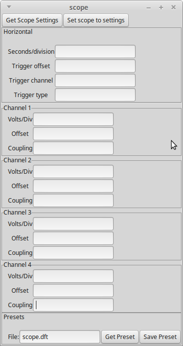

Oops, forgot to show a screenshot. Modified to fit your scope (eg channel count etc) this should work fine with most GW instek scopes which I think more or less emulate Tek scopes.

What I see.  You can get or set the scope to the GUI, and get and set a preset file (any number of them) to the GUI (and hence &lt;&gt; scope).
What I see. You can get or set the scope to the GUI, and get and set a preset file (any number of them) to the GUI (and hence <> scope).
