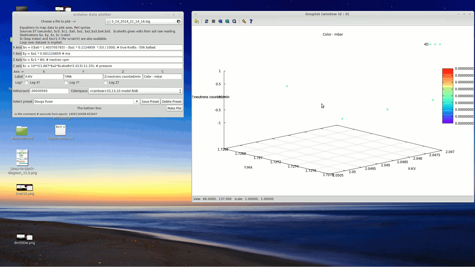

As I get ready to take the old data aq out of the fusor system and replace it with this project, well, the nice plot program that could eat the log files needed an upgrade to handle the new (still human readable, which also means you can edit them with a text editor, concatenate them and so on - we still use a # at the start of a line as a comment character that means "ignore the rest of this line") ascii log files, so I modified plotdat and it's now called plotudat. Yes, it's perl, for linux, and assumes you have or can install a few perl modules, though it should run on windows if you get perl and gnuplot and so forth. Put this in your youruser/bin directory. I have some presets still there from the old version, mainly just to make sure that presets work - you'd have to change them to fit your setup (would have had to anyway). Now you can map any of the 6 channels of a/d and 2 counters onto 3 axes plus color, in a scatter plot, from the arduino basic data aq. This is what I use to analyze the data myself, the other stuff helps you just acquire good data, but doesn't and can't know how many a/d counts mean what...this is where you can write a line (or few) of perl code to do that kind of mapping of chnl X to kilovolts and so forth.
You can pretty much put any chunk of perl code into the edit boxes for each axis, since unlike more-modern fad languages, a semicolon ends a line of perl, not a linefeed and tabs, so multiline mapping functions still fit in a single edit box, though you might want to cut/paste them from a "real" editor to get them in there.

It looks like this when you get it running. This is fake data, just putting some inputs in and using the old presets - meaningless, but it shows how it should look.
How it looks with sparse and fake data
