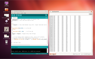

So, I wrote a sketch (their terminology) that acquires all the a/d inputs and uses the one available counter (they grab the others for themselves, more or less) as a counter. Seems to work well as long as I run it off a wall-wart. Even blinking a LED makes enough noise to mess up the A/D, and the amount of noise on any of my machines on the USB 5v (laptop is by far the worst) is a couple a/d bits worth...so, we run from wall-wart.

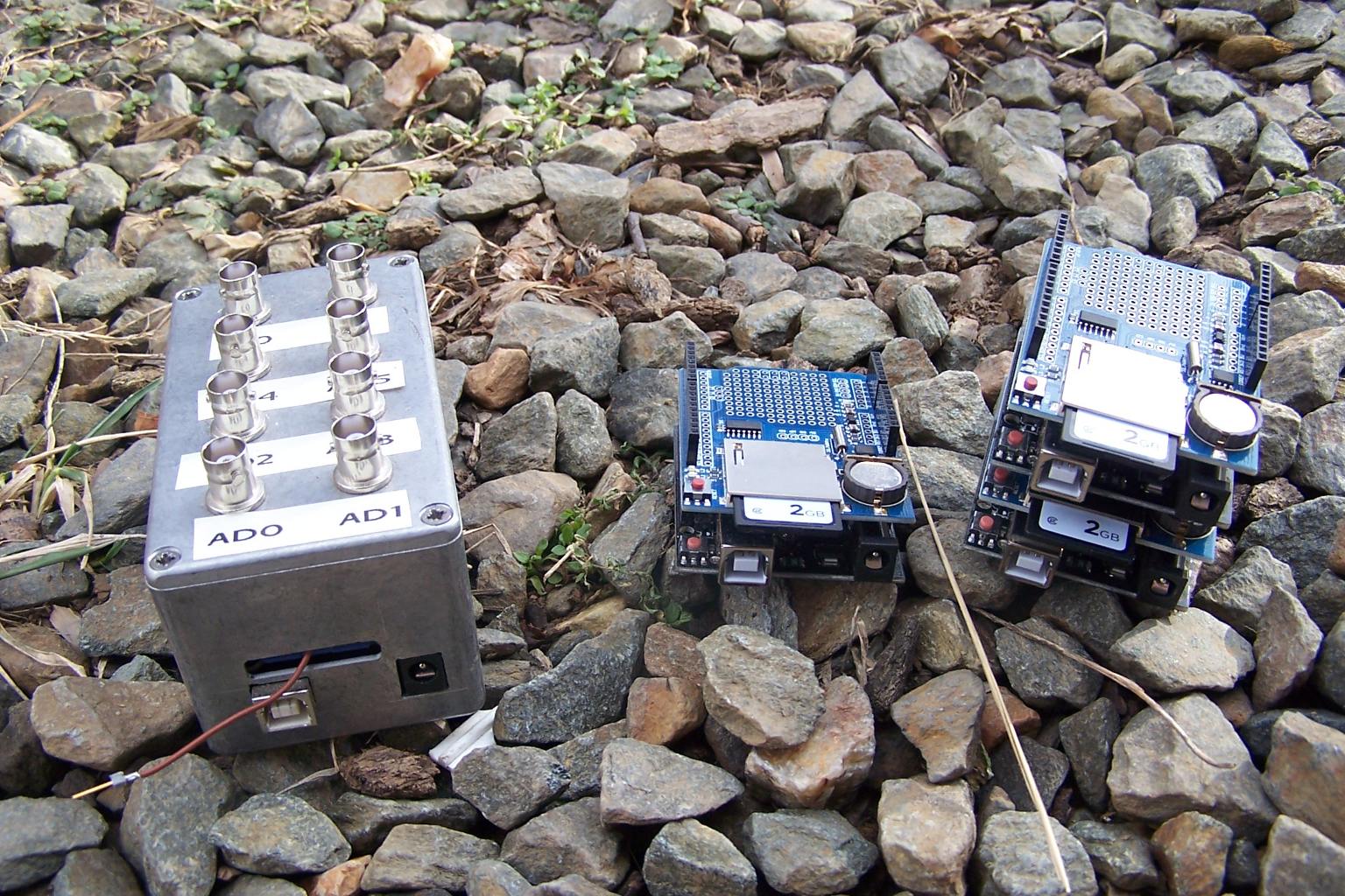

Here's what it looks like at the moment:

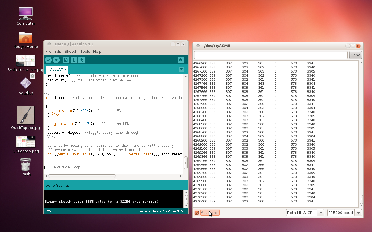

In the serial monitor, the first number is milliseconds since last boot, the next 6 are a/d channels, and the last is counts since last report. I have it set to run every 100ms (more or less), and have the counter counting a pin I toggle each time through the main loop - so that number is half the number of times loop() was called in 100 ms (10 hz) - as you can see, it varies, timing isn't real deterministic in this in the same sense as my multi-threaded interrupt-drive PIC opsys, but hey, looks like 60-70 khz worth of times we get called per actual time to do something, so I'm not wasting a ton of cycles, and neither are they.
I have channel 1 digitizing a 1.56v alkaline battery, channel 4 to ground, and channel 5 digitizing the on-board 3.3v regulator. The rest are just floating and showing you noise plus the inter-channel leakage that's normal for a floating pin in cmos.

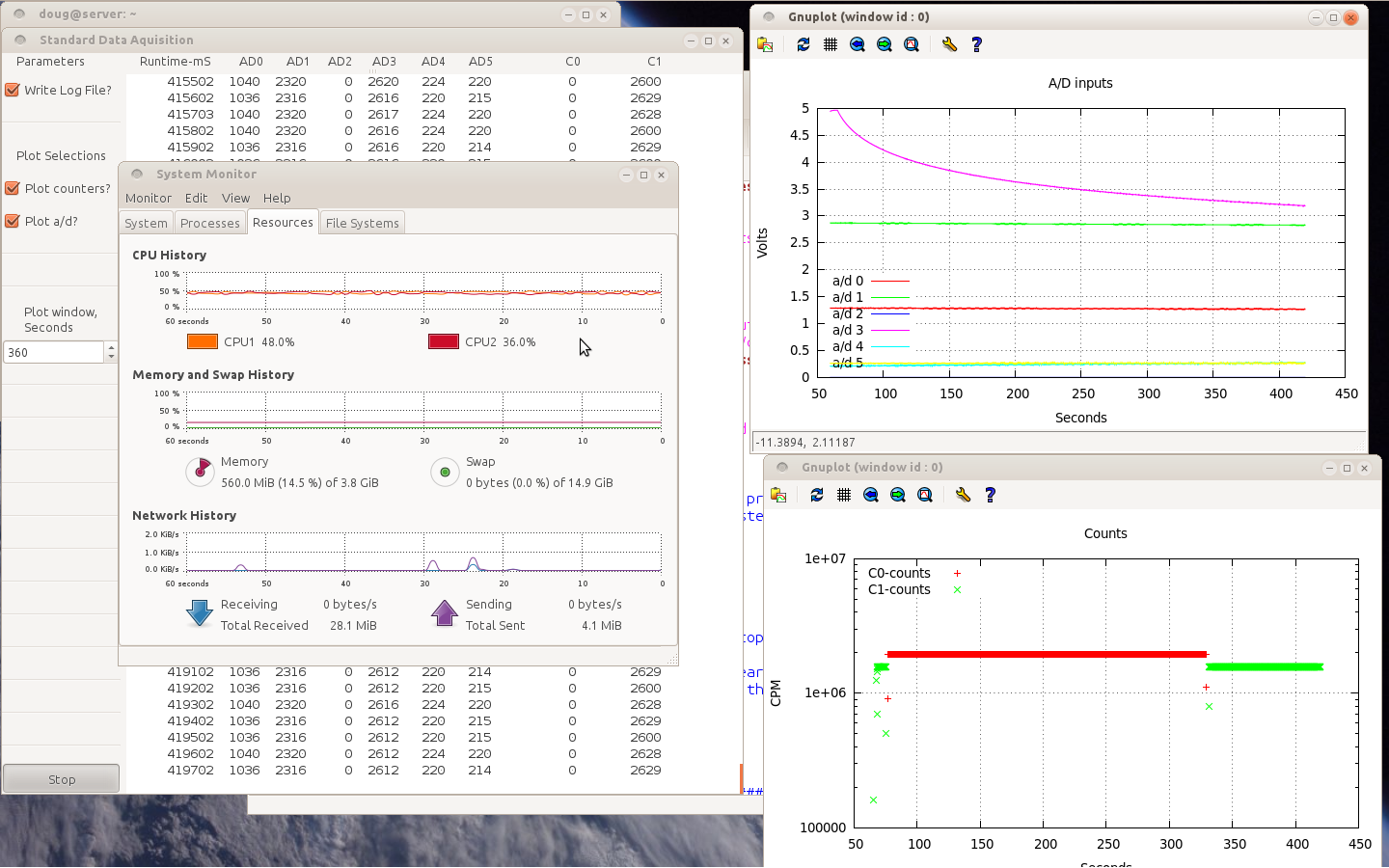

Here's an updated version that is much more useful. In the zip file attached, the DataAQ folder should be placed under your arduino sketchbook folder, it's the code for the UNO and will then show up in the IDE under file/sketchbook.
adaq is a perl program, at the moment, linux-only, that talks to the arduino, and logs and plots the a/d and counter data in a format that a lot of other programs (including some I'm about to (re)write for data mining.
Sadly, it needs a bunch of non-standard perl modules, you'll have to install those using perhaps synaptic or unbuntu software center. Put adaq in your home/bin directory (make one if you haven't already) so it will be on your path next time you log in, then all you have to do is type adaq into a terminal and it will run, probably complaining about each missing module in turn - you can use those error messages - paste the name of the missing module into one of the software source programs and use them to install them. I'm working on an automatic installer....but it's not here yet. I plan to do that after I do the equivalent of "plotdat" I use for data mining my other data aq - 4d plots(!), and I might extend that to 5. I get x,y,z plus color now, and I might add "dot size" as yet another axis for this.
You will need to install gnuplot as well. The version signed off on by the usual linux distros is fine - you don't need to get and build the very latest one (and in fact, I've not tested with higher than v4.4).
There's also a sort-of manual about adaq and the system, in odt format (open office, libre office).
A little tricky to get going that first time, but after that - the price is right and this stuff works well. Consider this a beta, though, as I plan to start burning more cycles in the arduino to do some DSP and improve the effective a/d resolution and other such things pretty soon. We will also be offering built-up hardware - arduino as a loose board isn't that handy, but in a metal box with some BNC connectors and perhaps an SD card, it becomes a very nice thing to have in the lab. I will of course publish the design for that too - it's not rocket science at all, just some RC lowpass filters on the a/d inputs, and protection diodes and R's for that odd bolt of lightning often encountered around my fusor. Getting more bits out of the a/d will probably change the format and effective full-scale values a bit. We can use the UNO 10 bit a/d as the "one bit a/d" in a delta-sigma a/d converter if it turns out we have the time and cycles to get that done, so I am planning on at least trying - it worked out great in the PICs.

Hi Doug - does the photo mean it's on the rocks?

Tee-hee, nope, just my driveway often has the best light for pix. My first machine had only 256 by 13 (bytes were way into the future then) and was really intended as a smart PHA for nuclear work. I still have a nybbles worth of the core I hold up on vid chats to shut noobs up. You can actually *see* each little ferrite ring, and I remember at the time (late '50s or so) we were still amazed how those Japanese girls could thread these 256 or so in a 2.5" square...x,y and Z sense wires...

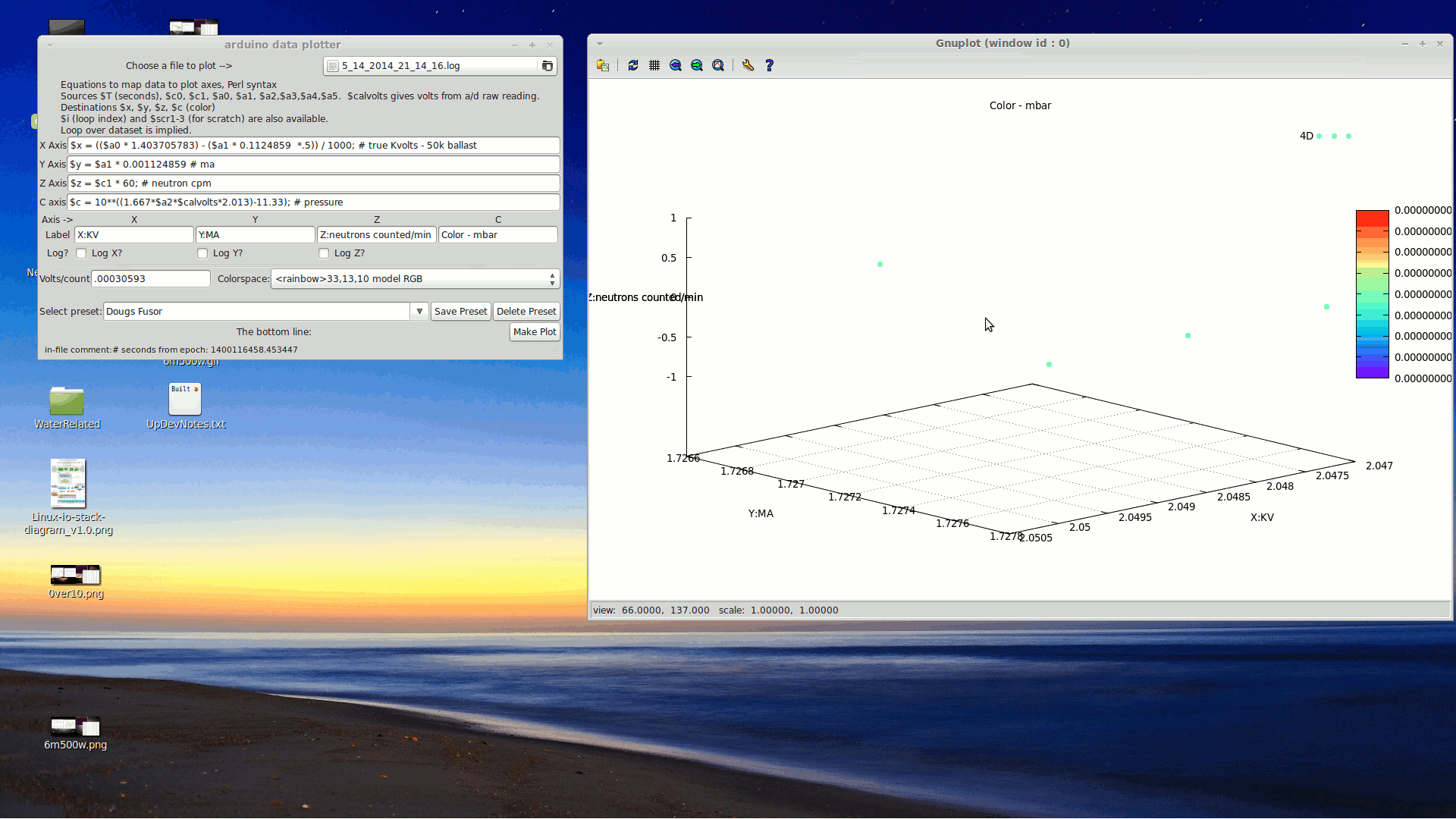

As I get ready to take the old data aq out of the fusor system and replace it with this project, well, the nice plot program that could eat the log files needed an upgrade to handle the new (still human readable, which also means you can edit them with a text editor, concatenate them and so on - we still use a # at the start of a line as a comment character that means "ignore the rest of this line") ascii log files, so I modified plotdat and it's now called plotudat. Yes, it's perl, for linux, and assumes you have or can install a few perl modules, though it should run on windows if you get perl and gnuplot and so forth. Put this in your youruser/bin directory. I have some presets still there from the old version, mainly just to make sure that presets work - you'd have to change them to fit your setup (would have had to anyway). Now you can map any of the 6 channels of a/d and 2 counters onto 3 axes plus color, in a scatter plot, from the arduino basic data aq. This is what I use to analyze the data myself, the other stuff helps you just acquire good data, but doesn't and can't know how many a/d counts mean what...this is where you can write a line (or few) of perl code to do that kind of mapping of chnl X to kilovolts and so forth.
You can pretty much put any chunk of perl code into the edit boxes for each axis, since unlike more-modern fad languages, a semicolon ends a line of perl, not a linefeed and tabs, so multiline mapping functions still fit in a single edit box, though you might want to cut/paste them from a "real" editor to get them in there.
It looks like this when you get it running. This is fake data, just putting some inputs in and using the old presets - meaningless, but it shows how it should look.
