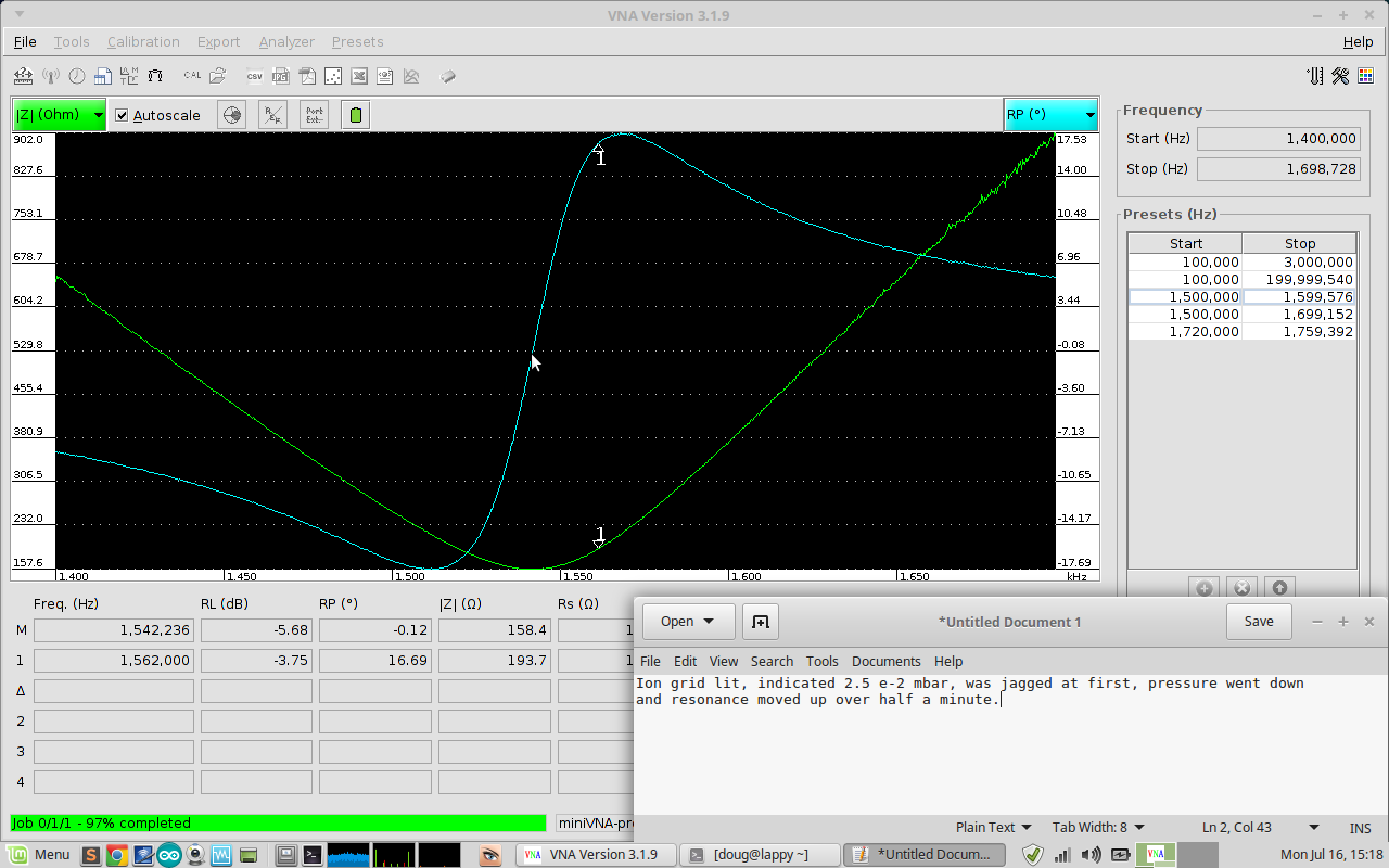

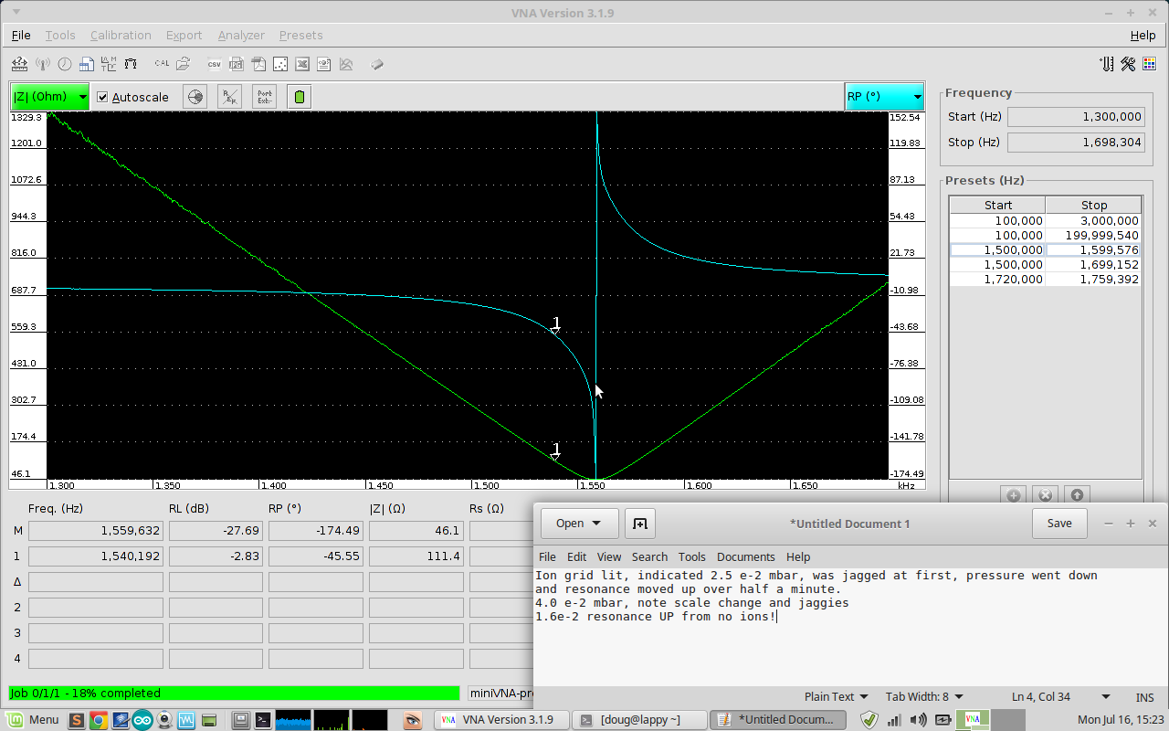

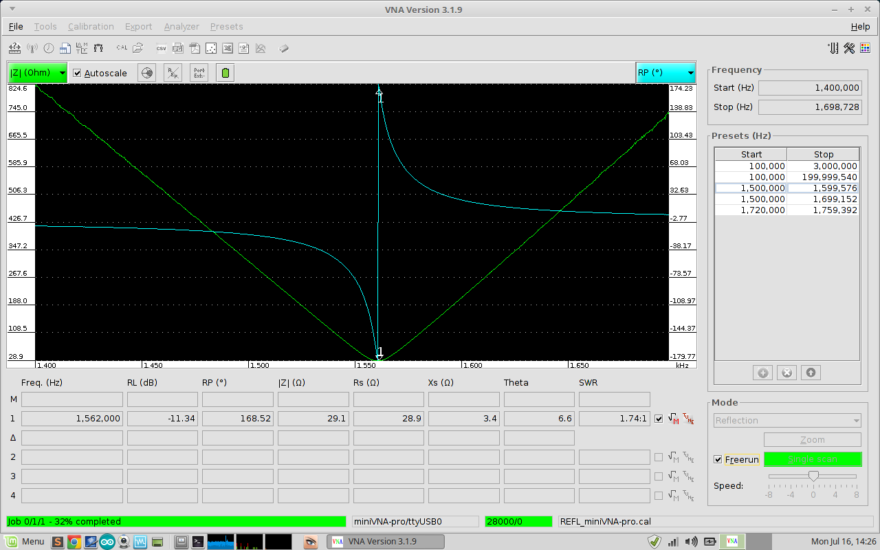

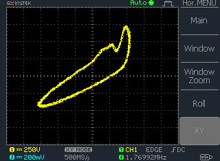

And here we have some measurements of that. I showed the basic setup in eye candy. I then let in some gas (no change just doing that) and then turned on the ion grid. "Jaggies" appeared on the swept impedance plot, which in the case of the fist measurement, slowly went away with time (maybe half a minute or a minute) while the apparent resonance moved up somewhat from what it was at first. So, I tried both more and less gas with ions on. The upshot is that more gas means it looks like a larger capacity, and for the most, those jaggies didn't go away. (I was using fairly decent DC on the ion grid from a Spellman 250w supply). The VNA signal isn't enough to keep things lit on its own, and in fact this is why I got that Analog Discovery 2 from Digilent - I plan to use it to drive a power amplifier and get the same (more or less) measurements "at power", which will also be interesting in terms of "when do ions/electrons start hitting the tank walls" kinds of questions.
I got faked out by the marker (listed as #1 onscreen) moving because a trackpad accidental click instead of the drag I was going - I hate trackpads (and they do clicks even with that function turned off often as not), and in this case, the darned unreliable human observer didn't notice the reference mark moving and took wrong notes in the screenshot!
So pay attention to what the VNA plot is saying, not my little window with text so much. I was wrong - it's pretty much a case of more ions, more capacity (or at least lower resonant F). Now I added some gas and turned on the ion grid with DC, a couple mA on that, voltage depending on amount of gas (current limit situation). Incidentally, I noticed a net negative on the faraday probe, which is normal for DC ion generation. I should try with RF (well, 45kHz) ions, but that would probably drive the VNA completely crazy. And so on, more and less gas, and while I did write that correctly in the gedit window in the lower right, I failed to notice my reference mark for resonance/no gas moving on me, so I told a lie there. Which I note that despite my incorrect note taking that where we usually run with pure DC drive - doesn't affect the AC impedance much at all....
Which could lead to all kinds of speculations...I think looking at the Q (in the RF jargon sense) is important, and this looks to me a little like how a mass spectrometer goes south with higher pressures - only here we only start to see that at ~~ 10 times or more the "pressure".
It's that effective capacity I'm interested in here mainly - it means I can transfer energy to and from the ions, both....scattering should show up as plain old loss, right? But this means if I can set up a recycling situation, I can get a lot of the input energy back from the "flywheel" that is ion motion in and out from the center....we'll see, early days yet.
Edit: note impedance in the last one is around 2x what it was at resonance in the first one, even though the resonance wasn't much different. Losses due to ions/electrons...now we can start to
do some interpretation.

Re: Ions look like a lossy capacitor
It did, but the thread title seems obvious now. A plasma under an electric field should act like a capacitor. At least in one direction. Right?Which could lead to all kinds of speculations..

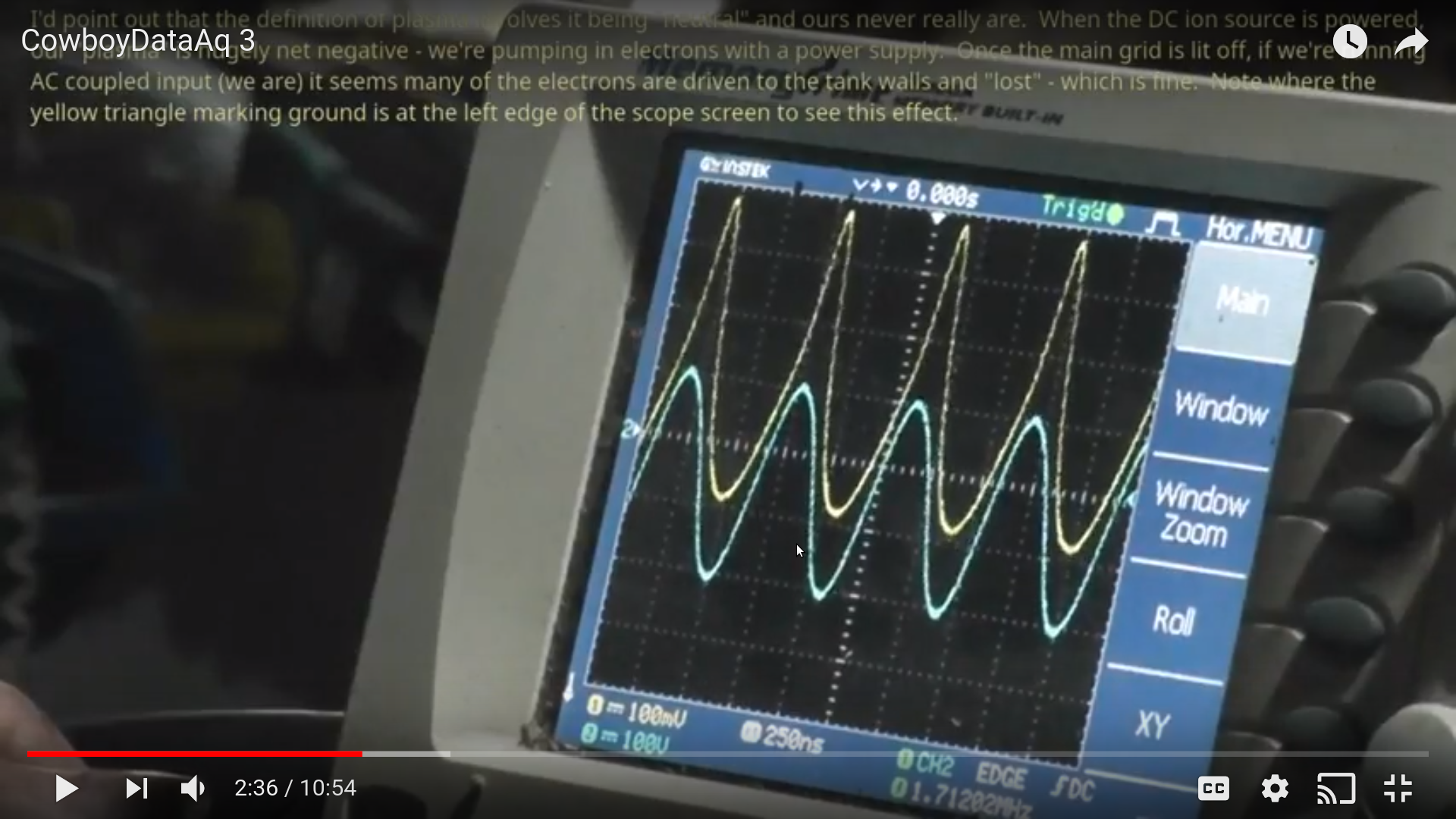

I don't know enough yet to make good speculations.

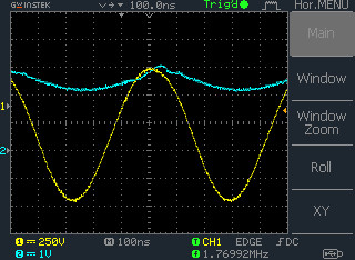

For example, I can measure a time delay between driving the main grid and another probe about 6" out pretty easily, a delay that is there when ions or plasma is there, but no delay (capacitive coupling) otherwise. (speaking of transit time here, not a load on the main grid that "looks like" a few pF capacitor)
Now - when the main grid goes positive, and a little later my probe does, is it because:
1. main grid repelled positive ions and that's the flight time to there
2. main grid sucked up electrons (we see current draw) and therefore the whole plasma became more positive after n electrons were sucked up.
3. main grid made a field that polarized the plasma - all the + stuff of any deuteron/electron pair went one way, while the negative side went the other and it took time for the rotation to happen.
Or, all of the above - still sorting that all out. I know what I think, but in this game it's what you prove that counts.
Paul, I don't think so...But that's why we do the lab work. Remember, mean free path is right around the size of the box here - funny things happen - the interactions are weak, not like a fluid with the concept of "pressure" at all - grey area between ballistic and viscous, more on the ballistic side. Of course, mean free path is really defined for uncharged stuff. We've yet to have that - or even a neutral plasma, we usually have a huge excess of electrons unless I put RF on the grid, and only that grid, then I see closer to neutral as the positive peaks on the grid draw current and take the electrons away. This is a real pronounced effect.
This one's kinda hard to explain.. Note that some time - a long time - after the ion grid, around 6-8" out from the main grid end (ion grid in the big tank, main in a sidearm) - we get pulses of fusion -top scope trace is the neutron detector (crappy circuit that has dc blocking issues, but the negative pulses are the neutrons). We had DC on the main grid, and an NST hooked to the ion grid via a capacitor - and you just can't drive a grid in there positive much unless you have a LOT of current. This circuit fries NSTs really fast, they don't like those positive pulses on the terminal when they're at peak negative in the cycle(!).
The timings look more like heavier particles, and yes, you're reading that right - the effective C and parallel R both go UP with density, to the point where as soon as we get anywhere near what most people think of a plasma density that would have ...waves, visible light, and so on, this effect is gone and it looks like a resistor to the grid terminal - with, at slow speeds, the usual negative resistance characteristic of a neon bulb. In other words, it starts acting like a more conventional plasma that might indeed have waves and stuff in it - if we went to those same pressures, we get those same results as the rest of the world - good thing in my view, I know my measurements aren't bunk.
I think we have something new here in the sense of working right between molecular and viscous flow, could be wrong but that's what it looks like - and I can't find any lit that works in this region, it's no man's land. Other measurements hint at ridiculously (ludicrously even for deuteron e/m) long transit times for what we think are the voltages involved, but have been hard to make and be sure of. In the dc + "put an impulse on there so you can measure times" mode, we're seeing at most 5kev on the deuterons by measuring speed - when we have 50kv applied. Sloooooow - and it does point to a more conventional interpretation of a plasma with waves and shielding and all that - or, looking at the geometry and the fact that we don't have the same density everywhere - not, hard to measure, this isn't a fluid in a tokomak, not even close. At 50kev if it were electrons I wouldn't be able to measure the transit times with my 2.5 ghz sampler! They'd be getting relativistic and my distances are short. At any rate, I did try to dupe the measurements I see in the lit for the plasma resonances and no dice in this pressure region - it's just not there. Shielding, dunno, probably yes from what I see, at least some.
I will have to crack the tank (which would be first time in ~3 years - it's REALLY CLEAN in there being pumped to e-7 or e-8 mbar between uses, continuously. What I need do to get those measurements is to have more probes at different distances from the thing I'm driving. Luck of the draw has it that they're almost all close
to the same radial distance, so doing the old distance/timeA-timeB = speed doesn't help me much - the distances are so close to the same I can't be sure of measuring them through the window by eyeball..no way I'd trust that. I'd rather have something like 3,7,20,25" distances or something like that. Which I could have in this tank - the main grid is in a side arm with the end about flush with a pretty big tank "drift space" if I want to use it like that.
In short, we have a far longer mean free path than works in the standard plasma equations stuff that assume hydrodynamic kinds of behavior.
Calculating from the Miley/Murali book1 for plasma resonance I get around 8 mhz and this should look like an inductance, but nope. At this pressure, "no mans land", there's just not enough interaction for that stuff to apply accurately, you can't assume a smooth fluid kinda thing.
FWIW, I'm saying indicated pressures as when in the lab, it's easy to write that down. Depending on which Pfeiffer document you look at - and here we're in no mans land between where the pirani and ion gages switch - the true pressure for unionized deuterium should be around 1/2 or 1/2.5 the reading. Complicating that is that already-ionized D reads a little higher...just an observation here, they don't mention that.
Now, at the low voltages, (3-4kv pp here) I don't expect this to look the same as at the "Real" voltages I plan to run to get velocities up to hopeful fusion levels. The reason for using this frequency band vs some other random one is that I should (heavy SWAG) be able to get to the tens of kv without hitting tank walls with D's - if I go faster, I can use more HV, slower and I hit the walls with less. Back to the low volts - at this scale, using the math I'm using (ion trap Mathieu stuff) the grid size itself is significant, which messes everything up somewhat. I want to get to 10x anyway of this so I know that's less of a factor and am working on modding a little Ham cw xmitter for that purpose now. It should also allow me to turn off the DC ion grid source, and use that as another faraday probe for timing measurements.
I could alternately drive that around 40 to about 80 khz but that adds a lotta monkey motion to account for in the other test results. Kind a high price for getting rid of the extra electrons, which I *think* higher drive on the main grid will (is) do anyway - and will do better when there aren't so many as the drive on the main grid along will keep it "lit". We have noticed, which I think is in favor of the more "plasma" interpretations - that medium HF takes a lot less to light off, or stay lit. This could just be the usual de-ionization times you see in say, thyratrons, but dunno, haven't checked, hours in the day and all that. We are at lots lower pressure than they so it should be longer...
It seems no math works right in this no man's land pressure range that we have "on average" and "outside the grid" and "away from the time/space of the focus region" which is why I'm doing this lab work in the first place.
We do note near-instantaneous response from the electrons when we try and drive the grid positive, it's a good diode to ground and fast enough that at this frequency range the phase lag is zero (as it should be). I will be taking more measurements of lag time to probe 6" away with drive voltage, all else the same, next run I hope - I need a better RF source, which is in progress. I also have huge, kW and multi kW stuff, but I'd like to work up to that before making too much $moke!
Next test will be with a mere 10 times the power of the last, a reasonable binary-type search, eh?
Probably the most interesting from my POV is that while my mass spectrometers, running at nearly the same speeds/feeds, barf out at around e-4 mbar, and here we're fine at e-2 - 100x higher pressure. Now, if I double that a time or two, this barfs out itself, but there's a pretty big space of ??? behavior in there. And right where I think I want it.

Someone might have been under the misimpression that this was a transmissive measurment - I'm not the worlds greatest communicator. Nope, this was the impedance on the driven electrode alone, not what happened after some distance out (like Landau stuff).

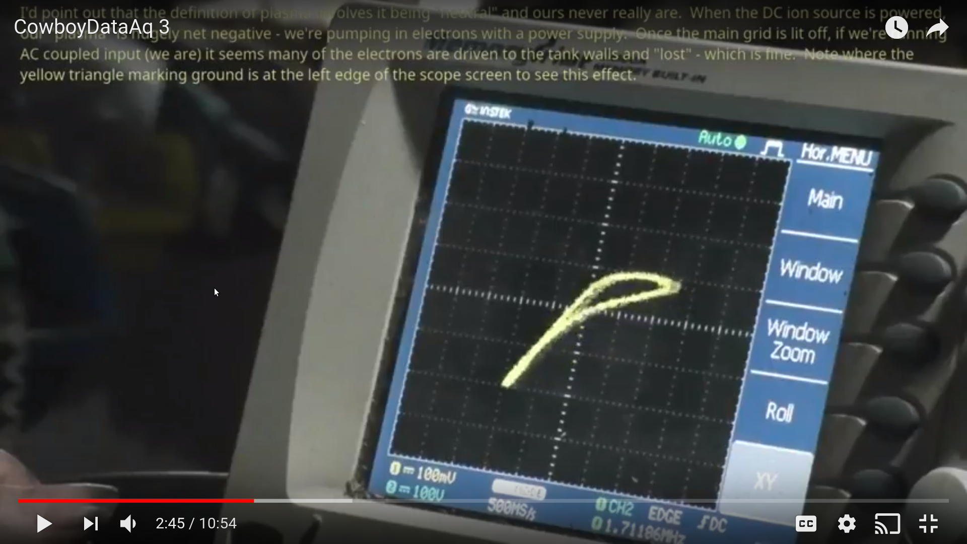

When I did grid vs probe out in the tank - I got the opposite effect, also - I got narrowing of the peaks! So, bunching, not dispersion. Probably does around the same thing as in a klystron drift tube - things go in and out of phase...I need more probes in there!
https://youtu.be/DKfnZM0VTlM?t=2m36s - on channel the drive, the other a faraday probe, maybe 5" away diagonally from the grid axis.
Here's two pix of screen grabs of that. The blue channel is what's on the grid itself. Note that this is DC coupled and not zero average - we are using a 750pf series capacitor here, and this draws
(more and with less transit time) current on positive peaks, thus putting charge on the cap and biasing the thing negative on average.
Going back and looking that this again (why do you think I take video?) I note that the yellow, probe trace is WAY off ground, and is also DC coupled from the faraday probe - it's off ground some amount that's about the same as it's peak to peak height (eg 1 pkpk + the ac too for 2 peak times the ac peak alone).
This also slid down seriously with only slight detuning - that wasn't me moving the vertical position at (whatever time that was - 1:50 or so).
Vert position is the little triangle at the left, same color as the trace. At one point I bring it off the bottom for the yellow one just to see how much *positive, not neutral* this plasma happens to be. With the DC ion source on (it's negative on another grid out in the tank) the whole mess goes negative on the faraday, but not on the main grid so much - but I should look closer than I did here. Sometimes we do this stuff just to notice what we've missed so we can go back and get it right.
So this is data that any hypothesis has to fit - at the volts here - about 3kv pk pk drive - electrons should be going considerably faster than this? They sure are at these volts in RF tubes.

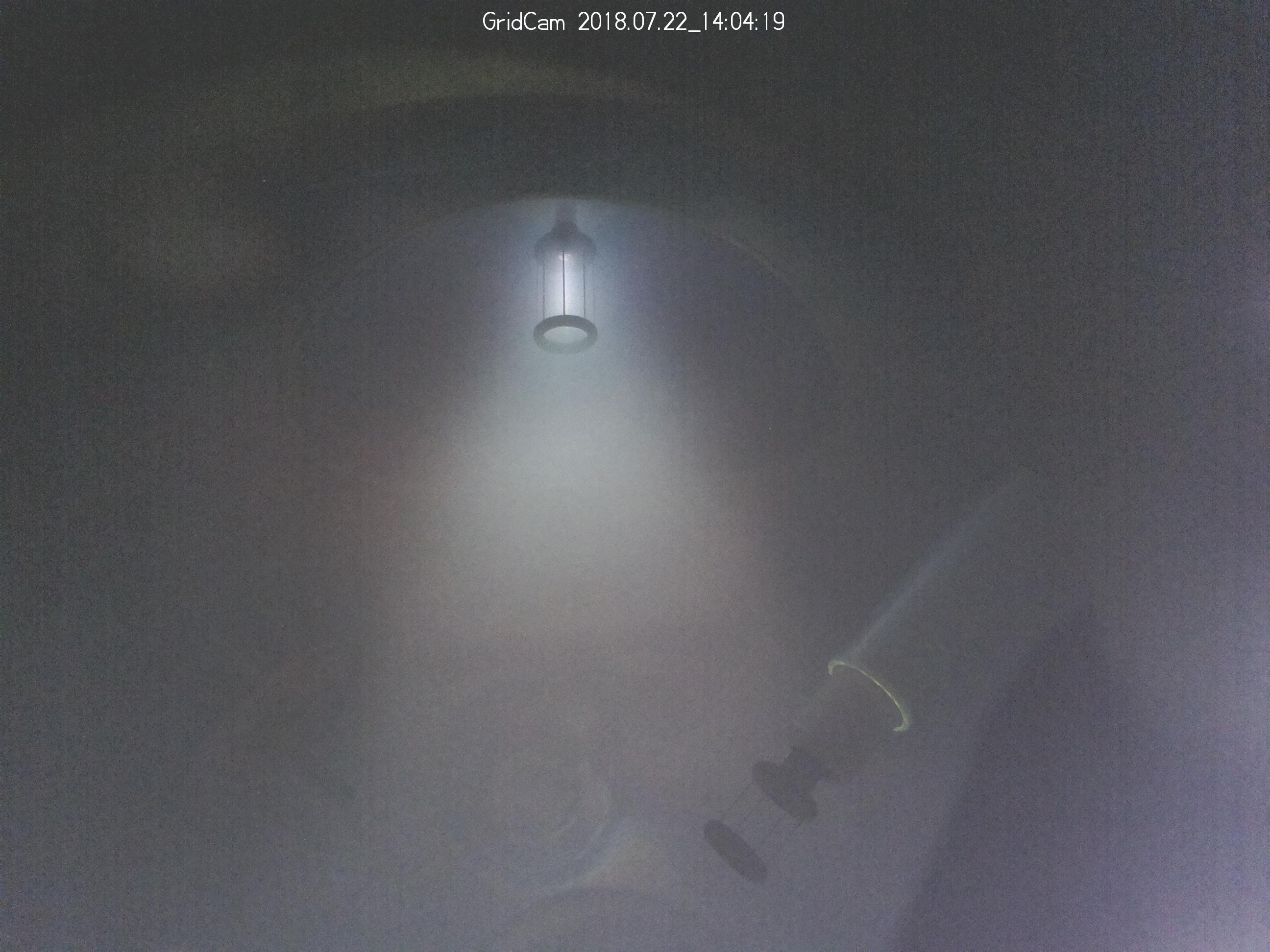

Just some as-yet unanalyzed data I got today with a bit more powerful RF source (around 30w).
The pic is a long exposure - this is barely visible to the eye. The scope is that same xy but I reversed the channels. Note additional notch in the faraday signal. On the scales, the faraday probe is that 2.5ghz quarter wave antenna used as a probe, loaded with 100k and the scope screen volts are correct.
On the HV drive you multiply the scope by 9 to get the right answer. You can bet my proximate Ne2H bulb nearly exploded at these levels. Couldn't really get reflected impedance with this setup - it's what I bought that analog discovery thingie for, but haven't lashed that up yet. Since I have to keep tuning the RF source to keep stuff from melting, it's always zero phase at that spot - I can do a better test with the AD 2 as it has more inputs to look at stuff with and should be "fast enough".
