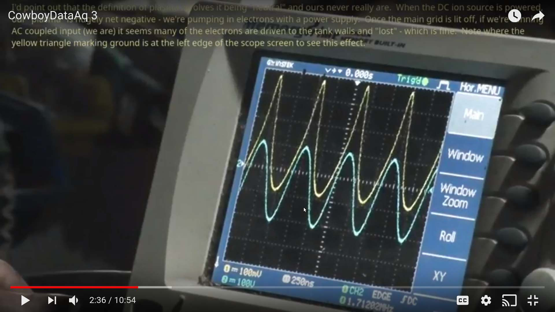

When I did grid vs probe out in the tank - I got the opposite effect, also - I got narrowing of the peaks! So, bunching, not dispersion. Probably does around the same thing as in a klystron drift tube - things go in and out of phase...I need more probes in there!
https://youtu.be/DKfnZM0VTlM?t=2m36s - on channel the drive, the other a faraday probe, maybe 5" away diagonally from the grid axis.
Here's two pix of screen grabs of that.
Note "bunching" of positive peaks on probe channel
The blue channel is what's on the grid itself. Note that this is DC coupled and not zero average - we are using a 750pf series capacitor here, and this draws
(more and with less transit time) current on positive peaks, thus putting charge on the cap and biasing the thing negative on average.
Going back and looking that this again (why do you think I take video?) I note that the yellow, probe trace is WAY off ground, and is also DC coupled from the faraday probe - it's off ground some amount that's about the same as it's peak to peak height (eg 1 pkpk + the ac too for 2 peak times the ac peak alone).
This also slid down seriously with only slight detuning - that wasn't me moving the vertical position at (whatever time that was - 1:50 or so).
Vert position is the little triangle at the left, same color as the trace. At one point I bring it off the bottom for the yellow one just to see how much *positive, not neutral* this plasma happens to be. With the DC ion source on (it's negative on another grid out in the tank) the whole mess goes negative on the faraday, but not on the main grid so much - but I should look closer than I did here. Sometimes we do this stuff just to notice what we've missed so we can go back and get it right.
As an XY plot - I should have reversed the channels, though, it'd be more clear
So this is data that any hypothesis has to fit - at the volts here - about 3kv pk pk drive - electrons should be going considerably faster than this? They sure are at these volts in RF tubes.
